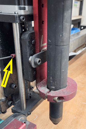

follow the IHS wire where it goes into the Z axis and make sure the wire is tightly connected. I post a picture of this location on the forum before but i can not find it now
There will be one on each side.
The OP DM me this msg.
still not resolved and waiting for the post limit to be over.
You might also check to make sure the IHS is closed with the torch in its resting position with gravity by testing with VOM (volt-ohm) across the two connections.
Apply the probes when the torch is at rest and it should measure connectivity (low ohms).
Now push the torch upward so the contacts break connection. That should show infinite resistance or no connection. If you have high resistance when the torch is resting, the contacts may be dirty.
Blow some air in the area chelanjim pointed to in the pic… could be metal shavings messing with the switch as well.
And in addition to what Joe suggests with the air blowing, don’t be afraid to manually push the torch up against its spring to open the contacts so as to assist the air cleaning.
You supplied a better picture than what I suppled :man_facepalming:

I wonder if the ihs switch is lazy? Correct me if I am wrong the switch stays closed and open when it touches off. Either way it is supposed to signal fire control when it touches the material. Then goes to the pierce height. Maybe it is stiff or sloppy.
Yes, it opens the contacts when the torch touches down. The torch continues to descend slightly more then reverses. At the point when it rises and the contacts close, that is when z=0 is set.
That is the way I thought. Maybe it is sticking open.
Or if somehow it is maintaining a connection without breaking: such as when the torch does not find anything to push against. That causes the IHS to assume a wrong z=0 point, as well.

In the g godes the z axis is programed to move down 5 inches or until the ihs trips. I agree I think I would focus on the ihs switch to start with.
