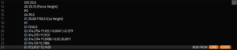

I am using a hypertherm 45xp, crossfire PRO, and post process with Sheetcam. I upload my program in FireControl and the torch goes to start the cut, touches down on the metal but then goes about 1" into the air and fires the arc.
I have the ground directly on the metal, and also tried to connect to the slats. I can not figure out what the issue is.
There is slack in the torch, and everything seems to be plugged in correctly. Disconnected and reconnected.
Running FireControl 21.1.5, updated firmware for THC and machine. Both running 1.3 and 1.1.
Any suggestions?
@manmademetalwork
Welcome to the Forum
Can you copy and paste some of the gcode your were running as text here ?
Not sure how to grab the text from in FireControl… here are a few screenshots
open the actual gcode file and copy/past it here.
Here is the first 50. I never get past around 25 because I stop it to save consumables.

I don’t see anything weird in the code
