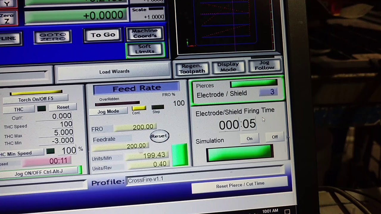

This is the latest Mach3 screenset that I have put together, it shows a pierce counter and a timer that keeps track of how long your torch has actually been firing.
There are 3 files that you will need to download, the first one is named Modded Plasma.set, you will copy this one to your Mach3 folder, then there is a m3.m1s and a m5.m1s file that will need to be copied into your Mach3 macro folder in the CrossFire-v1.1 folder. Be sure to copy your original m3 and m5 files somewhere safe in case you don’t like this screen. If you are one that has modded your screen already and have added any code into your m3 or m5 files then you may want to just copy and paste the code into your already modded files.
After you have copied the 3 files into the correct folders then you can open up Mach3 and under the “View” tab up top then you can select “Load Screens” and choose the “Modded Plasma.set” then you should see the new screen with the pierce counter and firing time, there is a simulation button that when you turn it on the numbers will be saved and the led below will flash until it is turned off at which time the saved numbers will be put back into the boxes. You can also clear out the numbers when you turn it on in case you want to run a program without your torch and see how many pierces or how long the torch will be firing to check your duty cycle time.
There is also a new tab up top called “Misc” right next to the Diagnostics Alt-7 tab, this is where you can enter your own numbers that will trigger the alarm for the pierce count.
Under the Feed Rate I put the Jog Mode button there to toggle between Cont and Step, mainly because I got tired of having to hit the tab button to change it.
There is a “Reset Pierce / Cut Time” button in the bottom right corner that will clear the numbers or you can just click on the boxes with the numbers and enter what you like then hit enter and they can be changed like that also.

Oh, if you up load some screenshots, the folks who haven’t been following this might see something that makes them want to do the mod or helps them verify it’s doing what it should when they make the mod.
That is correct Sir, never messed with Mach3 until about 3 months ago when I ordered my crossfire, most of the credit goes to one of the users at machsupport forum that showed me the code to use for what I wanted. I was able to do some of it myself by downloading and looking at other screensets that people had posted.

Here’s how mine looks now…
Glad to see that you are making use of it, I uploaded a newer one this morning that will make the pierce counter led flash green/yellow for caution then the outside box flashes red when the max number is reached.
Looks good, hope it helps with your OCD, lol I like numbers and once I looked at Mach3 like an excel spreadsheet it got much easier for me, except for the code.
