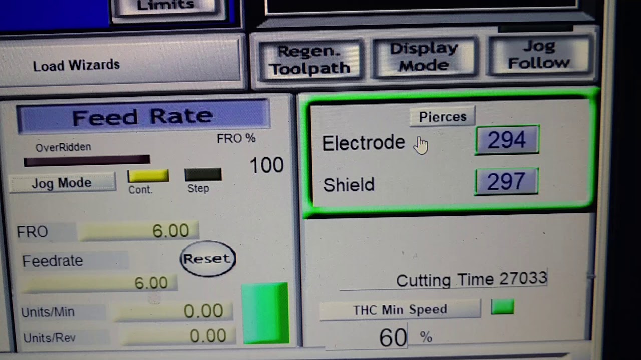

Worked on the electrode and shield counter some more tonight and finally got something that I think will be useful for me. I had to create a button on the bottom of the screen that I will remove later, it simulates the M3 command when you run the G code. I haven’t found a way to run the G code without my crossfire plugged in for feedback, so if there is a way then please let me know.
In the beginning of the video I show the Jog Mode that I moved to the front page that I like probably as much as the counter.
Right now for testing I have the red flashing LED Boxes set at 300 and you will see that when the number hits 300 the red will start flashing around the number and for the second warning you will see that when the Electrode count gets to 310 then the border around that section will start flashing. I also put the button that says pierces at the top so that you can make it stop flashing, but as soon as the m3 code runs again the boxes will start flashing again if the count is still above what is set.
To reset the counter after you change either the electrode or shield you simply click on the numbers and hit 0 then enter.
I believe I have actually worked longer on learning how to modify the screens and getting the counter working than I have actually cut on my crossfire, it’s all fun but this part is making my brain hurt.
As soon as I verify that it works when cutting then I’ll post the code that I used for anyone that wants to use it.

I got some more time to work on the Pierce counter and cut timer and I got it working just not exactly like I wanted but I will keep working on it as time permits. It is displaying the cut timer in seconds and I’m not sure of the code that I need to make it show in minutes and seconds so if anyone knows I would appreciate the help. I am putting a link to the 3 files that I have modified in my drop box for anyone that wants to look at it. Please back up your original if you try this, I put them on my second computer and they worked like they do on my laptop but I had stock screens and stock M3 and M5 files so if you have modded any of those then using mine will most likely lose some of your settings. The Plasma.set goes in your mail Mach3 Folder and the other 2 go into the Mach3\macros\CrossFire-v1.1 folder.
It isn’t perfect, and I already found a problem with the cut timer, it seems like sheetcam is adding a line at the bottom of my post that has another M05 and a M30 and both of these add the last cut time to the timer. I know why it is adding time again when the M05 code runs because that is the file that stops the counter but not sure about the M30? It is an easy fix, I load the code into Mach3 then I just edit it and go to the last line of my code and replace the M05 and M30 with a G30 then my torch returns back to the home positon after cutting and no extra time is added. Example below, I only have to do this once and then it saves it like I want.

I also added a reset button that will clear the pierce count and the cut count both at the same time, one for the Electrode and one for the Shield.
What else do you wish that was on the front screen? I use the Jog button more than I thought I would, and I have that on the front screen so no more TAB to get to it.
