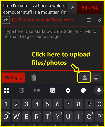

We have experts here on the forum. On the bottom right is a box with an up arrow. If you take a picture on your phone while composing a thread, just hit the arrow, and you can download the picture off your phone.
I do thank you for your help. It won’t be the last time I’m sure. I’ve been a welder for years but the computer stuff is a mountain I’m going to climb.
This is the arrow BigDaddy is referring. It appears after you open the reply box:
