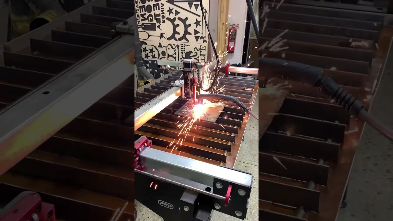

Hi, I followed the troubleshooting flow chart but nothing solved the problem, i dont know if theres a bad parameter in Fusion 360 or something wrong in FireControl:
What parameters are you using in fusion?
Pierce delay
Pierce height
Cut height
IPM 20?
What material are you cutting?
Steel?
1/8?
From the video it looks like you have set your nominal voltage set to 135.
How did you go about choosing this number?
Have you try smart THC by setting nominal to zero?
Does it register anything when you do set it for smart voltage?
How is your THC wired?
What plasma cutter?
Razerweld45?
Does fire control read any voltage during the THC
test?

I’m cutting steel 1/4
I didn’t know about de smart voltage, i changed it but it didn’t work
My THC is connected to Razorweld Razorcut 45 with 50:1 divisor (CNC port)
Fire Control doesn’t read any voltage during the THC test.
Hi Sergio,
The steps in the flow chart are very effective at determining why voltage is not sensed. There are many possible causes and the flowchart inspections check for all of them. Id encourage you to walk through it again. The steps require the use of a digital multimeter. The voltage checks are especially critical for diagnosing the issue.

Hi,
thanks, i was messing around with the piercing feature and by increasing the delay from .06 to .09 it worked. i appreciate the effort.
