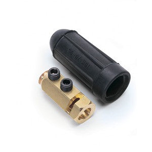

J27 - Positive twist mate connector
Work Clamp
J28 has multiple leads going into the torch connector (typically the main power legs on the torch) - thus negative.
Volt meter when making a cut will be the tell.
