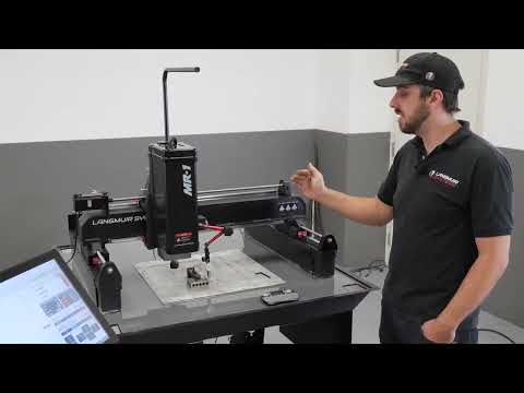

I dont understand, because i did all this- and it does run square to block…this is the exact video I followed.
Unless you are telling me to hand screw the ball screw on y2 until they both touch touch the hard stop, and then try to square it- but that doesnt make much sense to me.
If its running square along X and Y now, what is there to adjust or redo?
I just mean what else can I redo from this video alone? All due respect, i appreciate all feedback. I will try to find more measurements relative to this issue and provide more clarity maybe.
