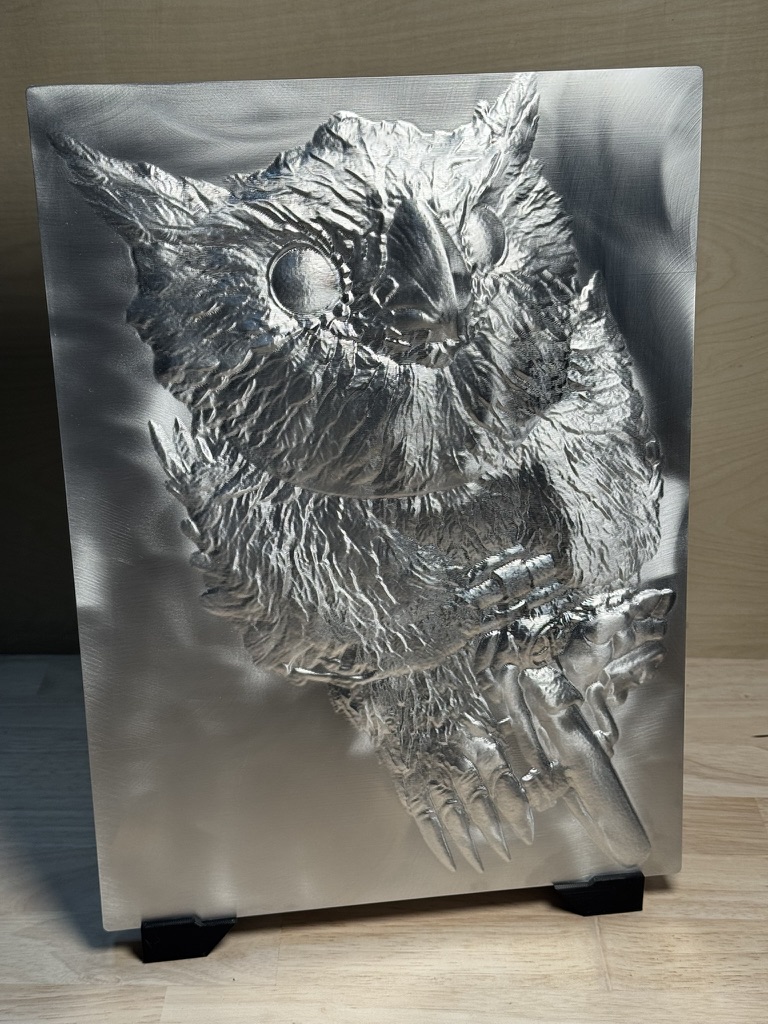

where did you get this CAD? I need something cool like this for a video.
I license 3D models and then pose them (which involves composition, perspective distortion, etc.) and run them through a custom bas-relief pipeline.
I think this was the original source model: https://platform.stlflix.com/product/tyran-t-rex
Still on the sculpture train… this piece is about 12”x19”. 14 hours of machining.

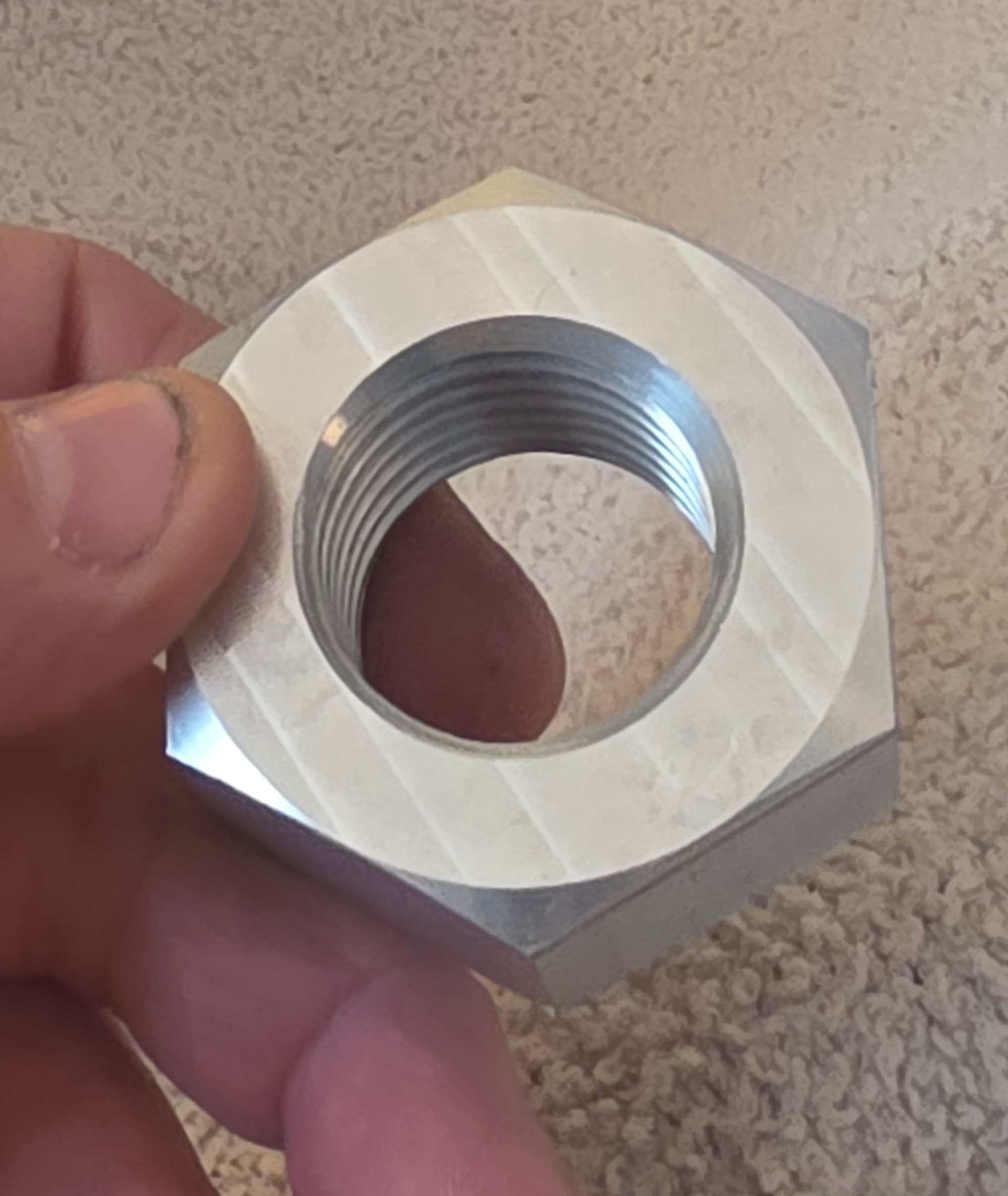

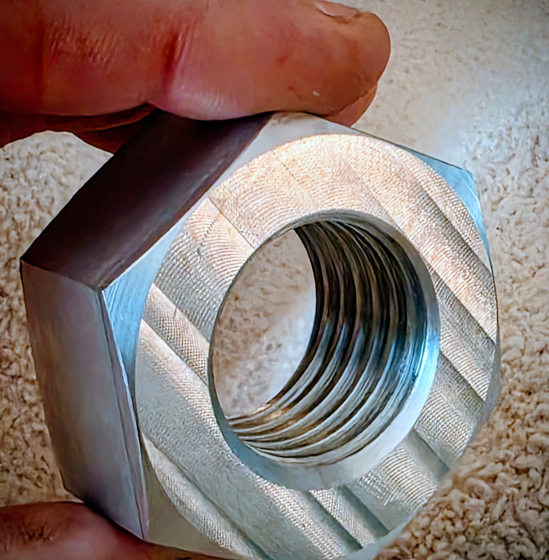

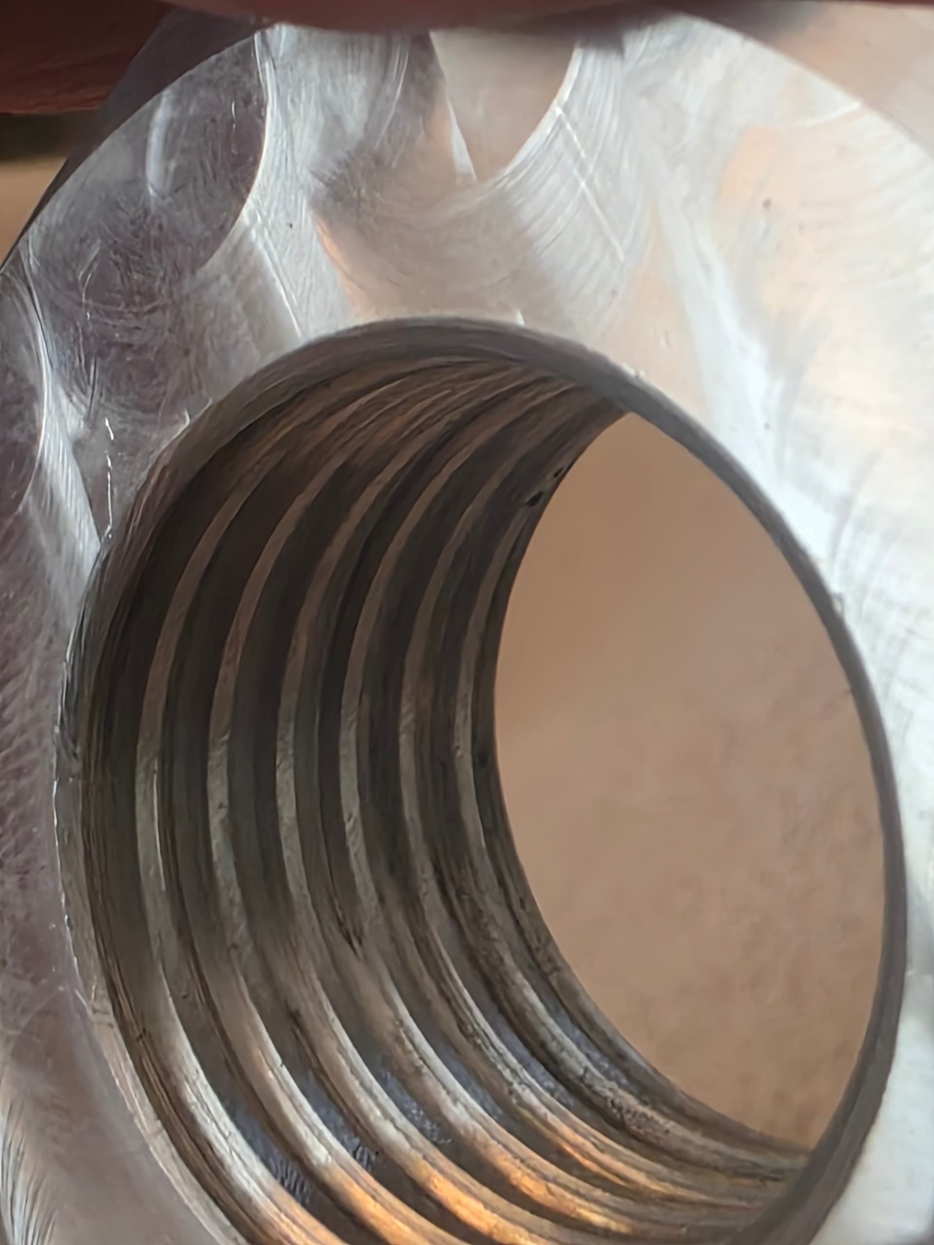

That sculpture is tough to beat. I made a prototype prop shaft nut this morning. I did it out of aluminum before I wasted the block of Silicon bronze. It came out way better than I anticipated. It is 1-1/8 -8 thread.

Nice looking piece of work!

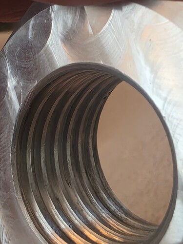

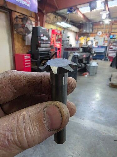

I made one several years ago and needed another one for tomorrow. The Fusion files were still on my computer. I just wanted to see if it still worked. My butt puckers up anytime I run the thead mill program.

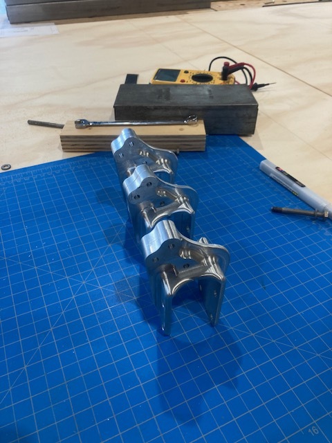

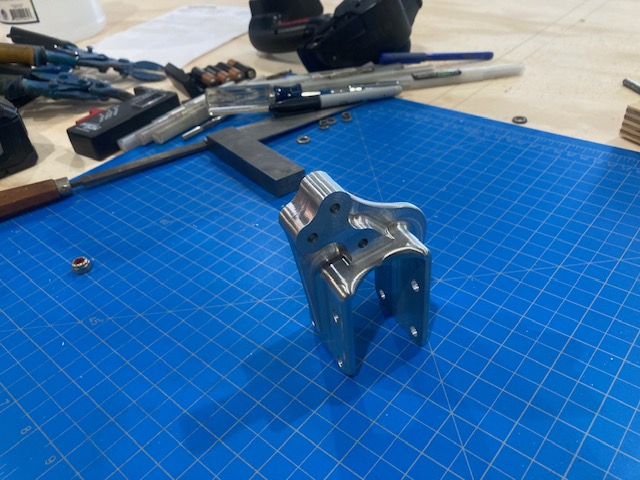

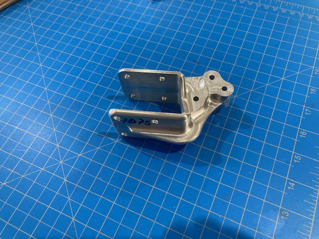

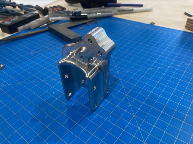

Here is some parts that I made on my MR-1 for an aircraft project that I am working on. Material is 7075-T7 aluminum. The tricky part is having to flip the part over to mill the backside. To finish these I will bead blast and then anodize.
well those dang thread mills are expensive. Nothing suck like snaping one off. :frowning:

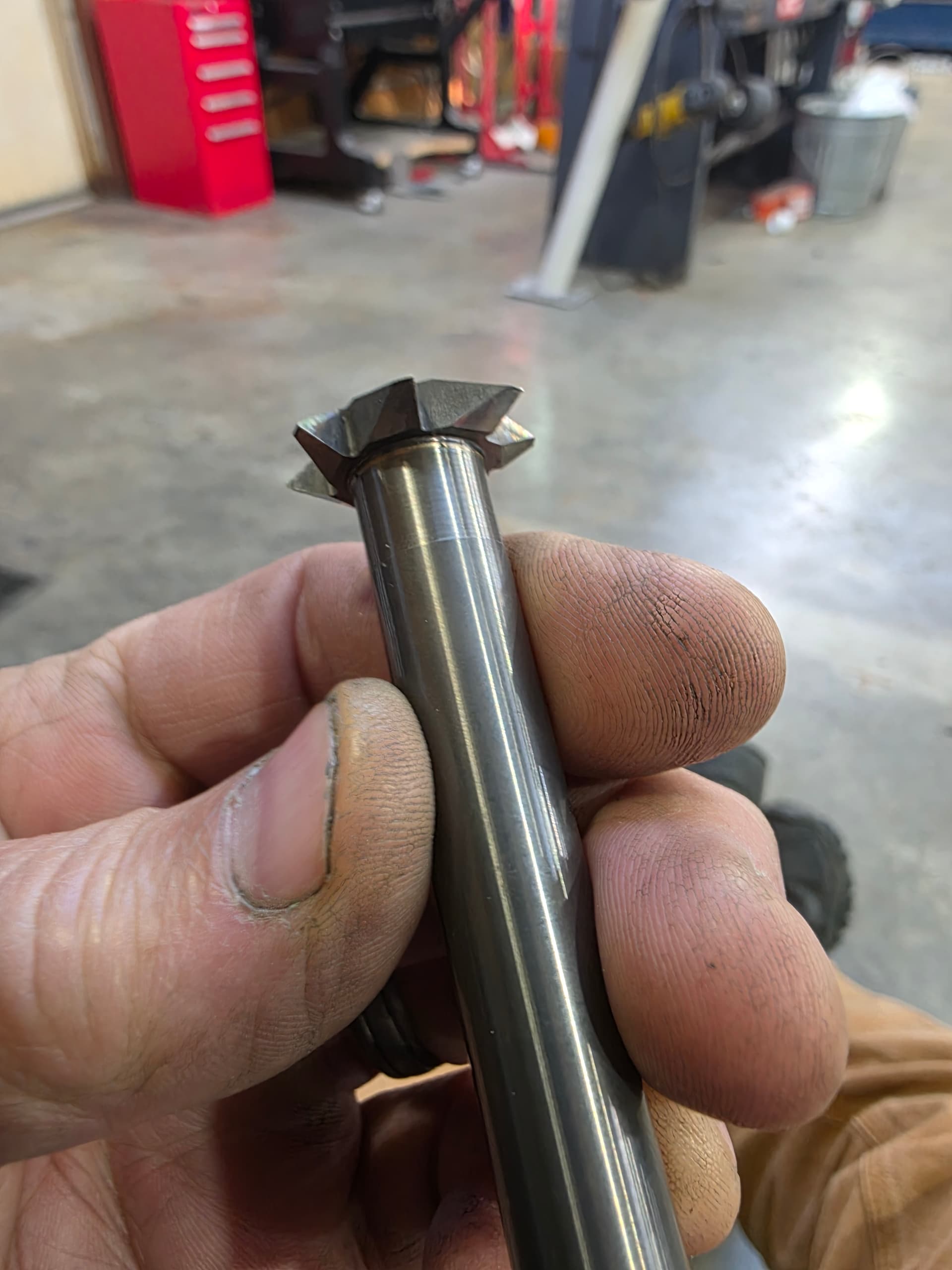

This one is for 8 threads per inch. If I break this one, the door will fly open, or worse. That’s why butt-squeezing making the cut.
O Dang! That’s a big thread mill. Yeah she’s gonna stall before she breaks that beefy sob. Or like you said the part will be coming out of the vise. Jobs like this make me happy that the MR-1 has doors. haha
I have yet to try thread milling, how tricky is it to set up in fusion and can you time the threads reliably?
Yes its easy. And better than a tap if you set it up correctly in my opinion. Watch a couple of YouTube videos from NYCNC or of your choosing. Get a hunk of aluminum and go at it.
