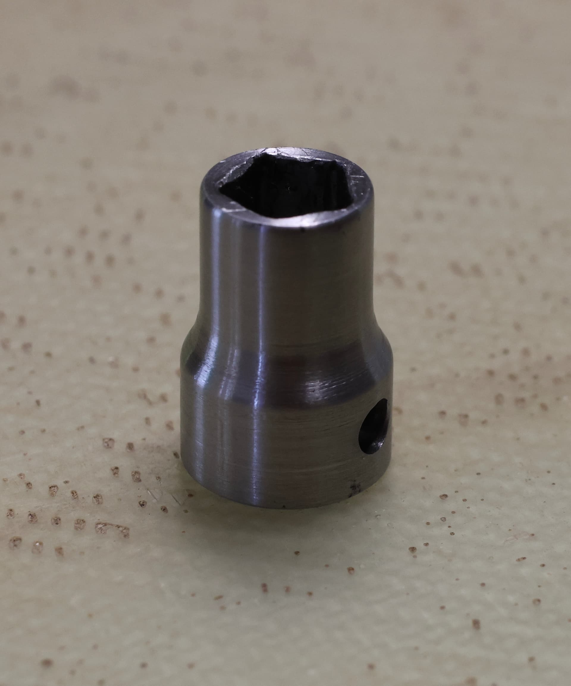

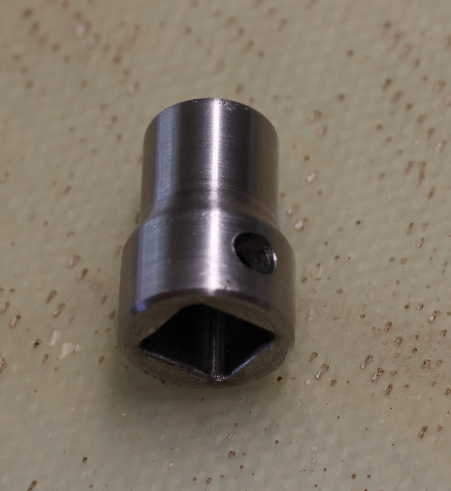

Here are a couple of things I have made recently. The socket is a penta socket for Cat injector pump.

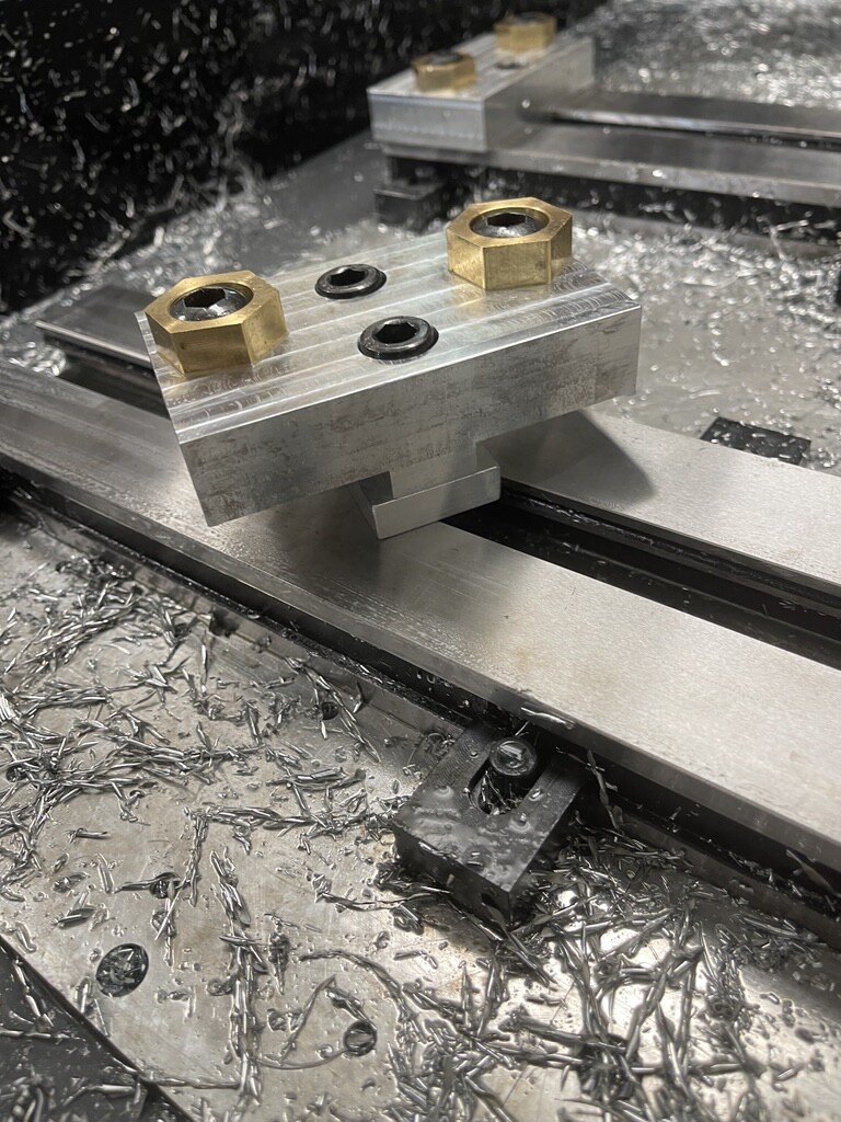

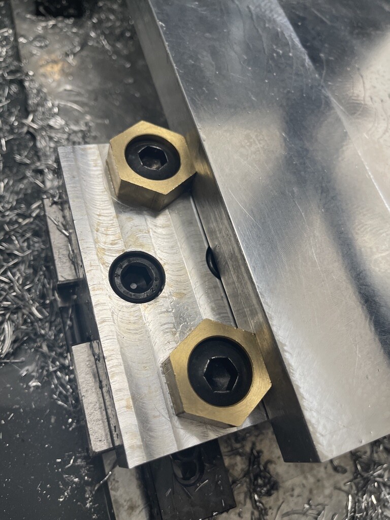

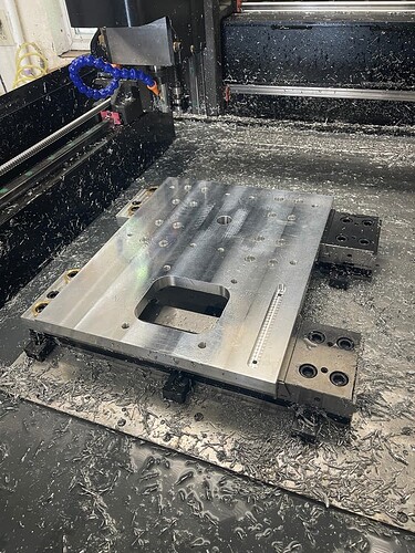

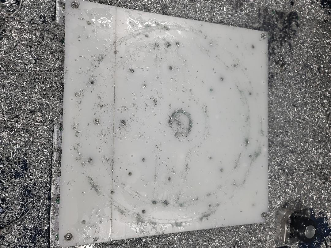

The large plate was 12" wide, so I made these clamps to work in the low profile vices. Works very well. The large plate is 3/4" 12" x 15" plate as part of a large (ver) 3d printer.

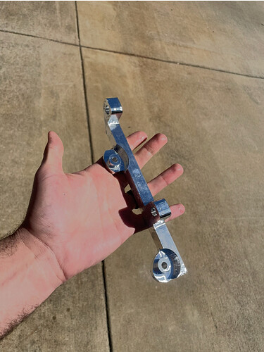

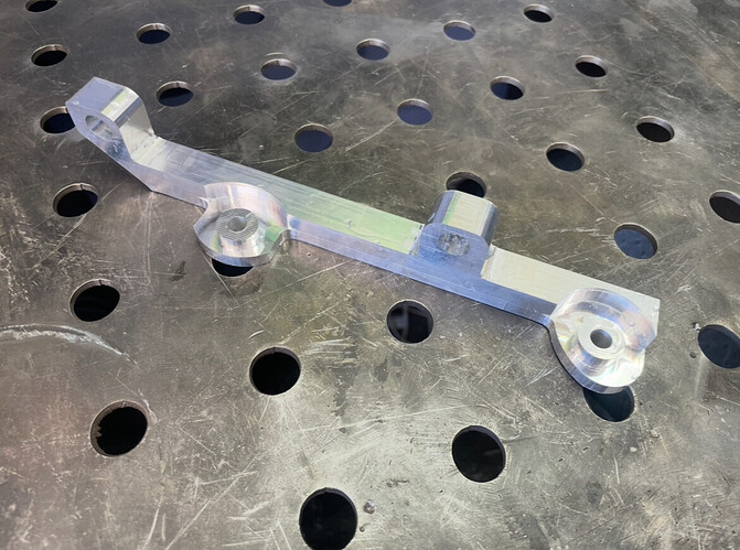

I made a few brackets to adapt a Volvo electric power steering pump to a LS engine

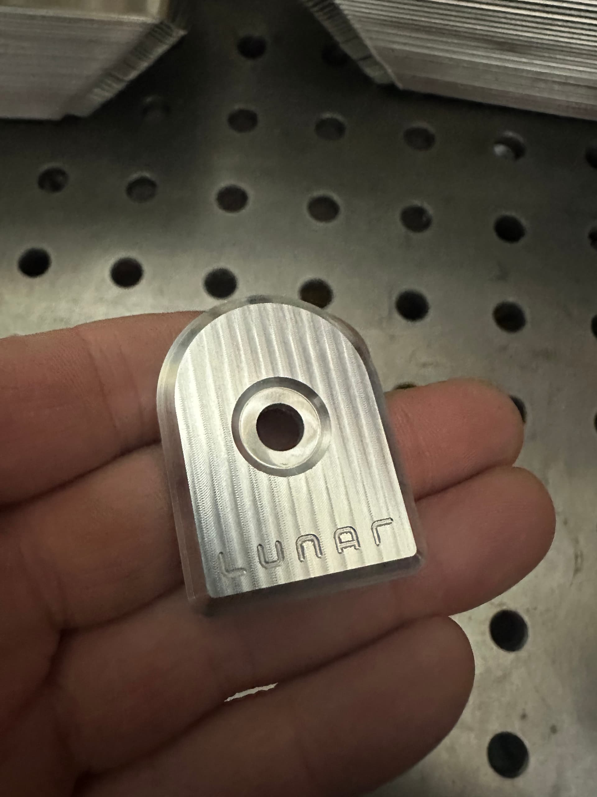

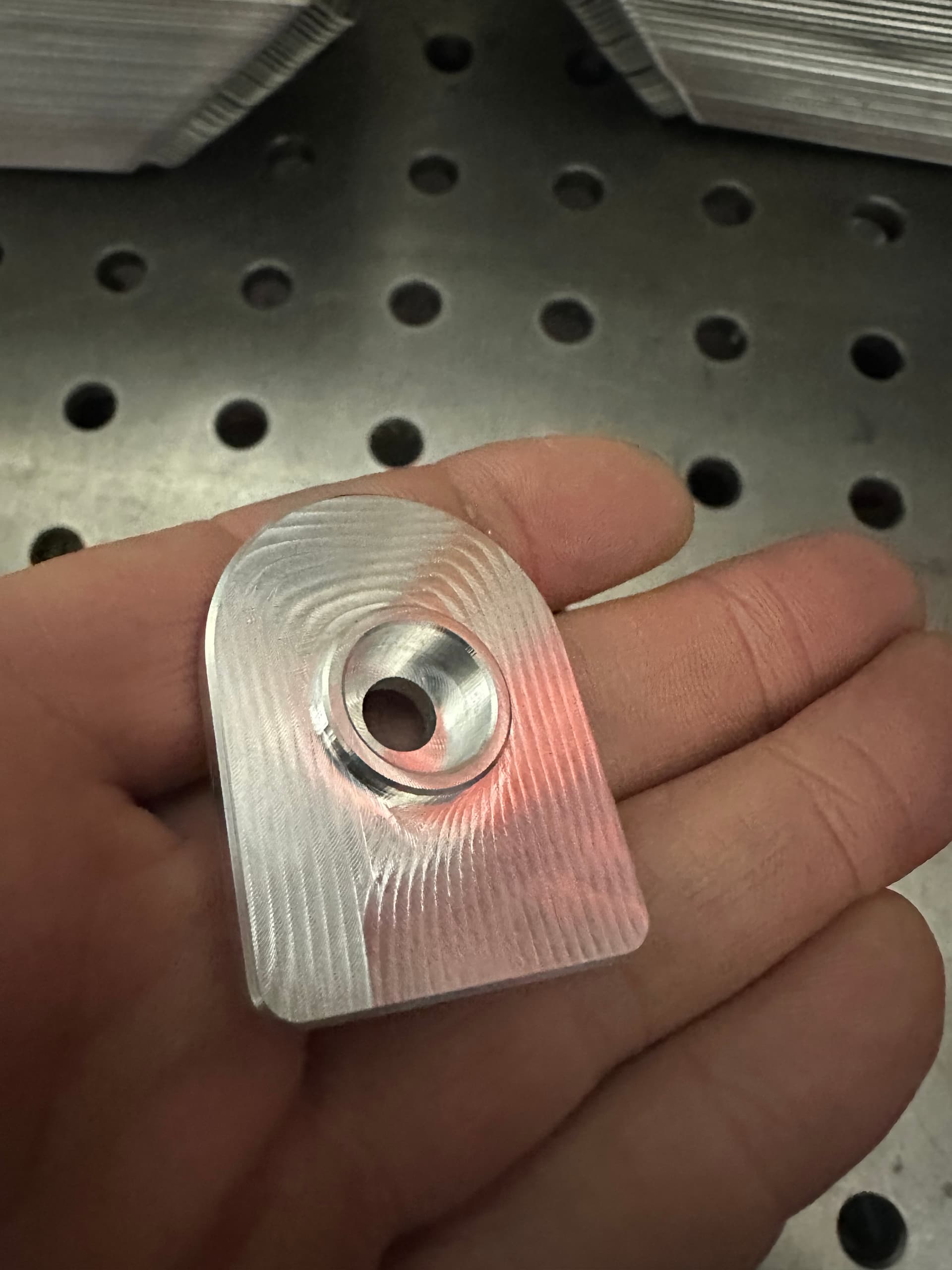

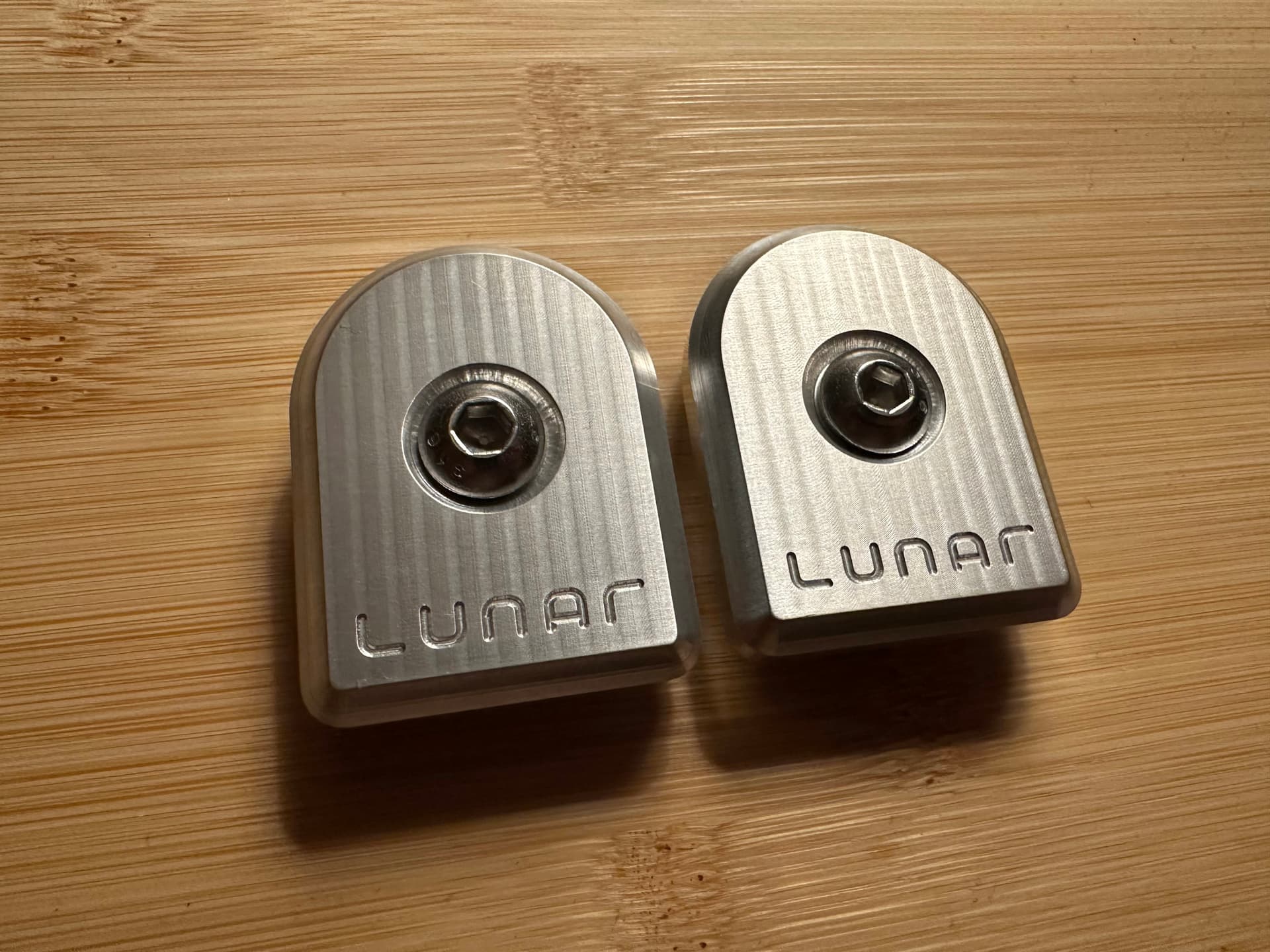

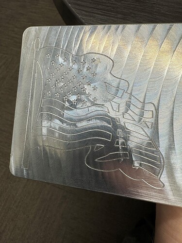

Fun little part for a company just starting up. These will hold down the ends of some straps. First time engraving too.

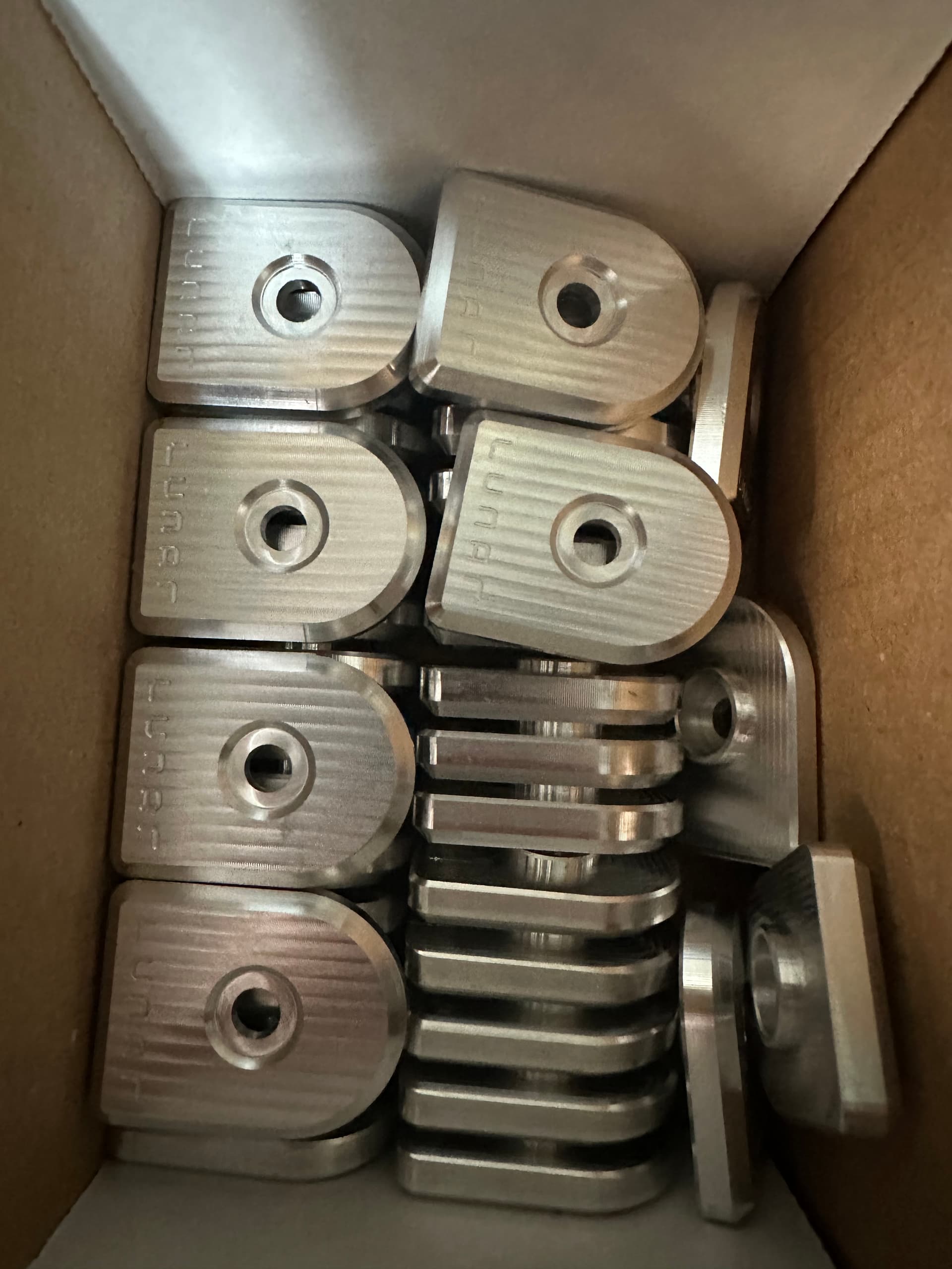

Few batches of parts finished up. First is feet for a roof rack system I sell.

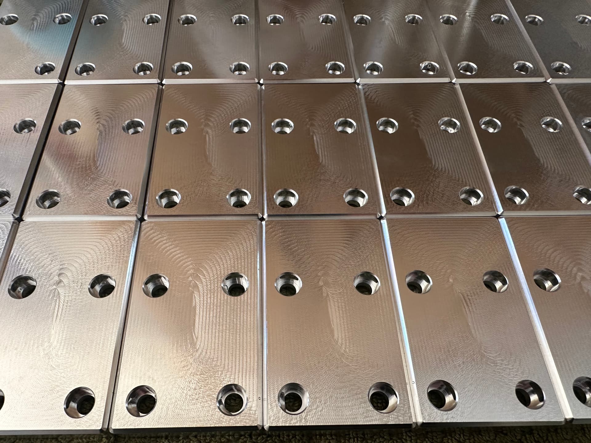

These are some 1" parts for a friends companies new product. Having two vices is a game changer for productivity! Going to order a 3rd asap!
That is some nice parts. What tool did you use for engraving ?
I did some a while back with a 0.02" ball tip engraver from Lakeshore but I like how yours turned out, the font looks good too.
I just used the my 90 degree chamfer tool
Looks super clean. Is it aluminum and what’s your feeds and speeds?
(asking about the engraving)
Thanks! it is 6061 8000rpm at 20in/min

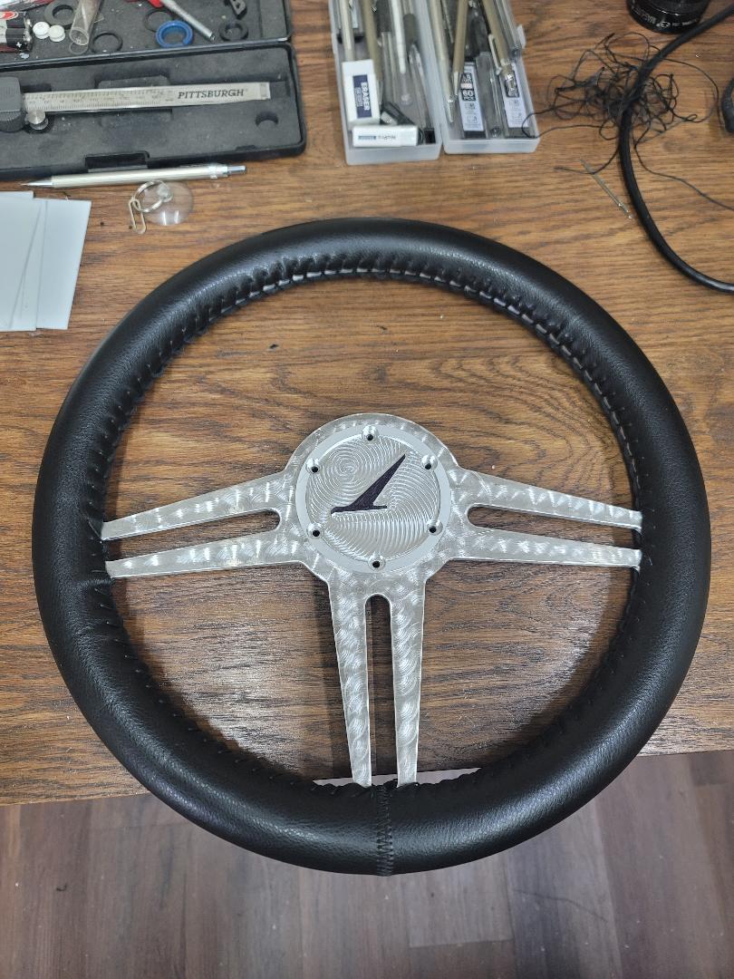

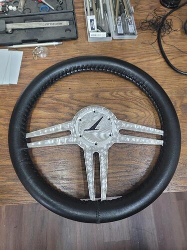

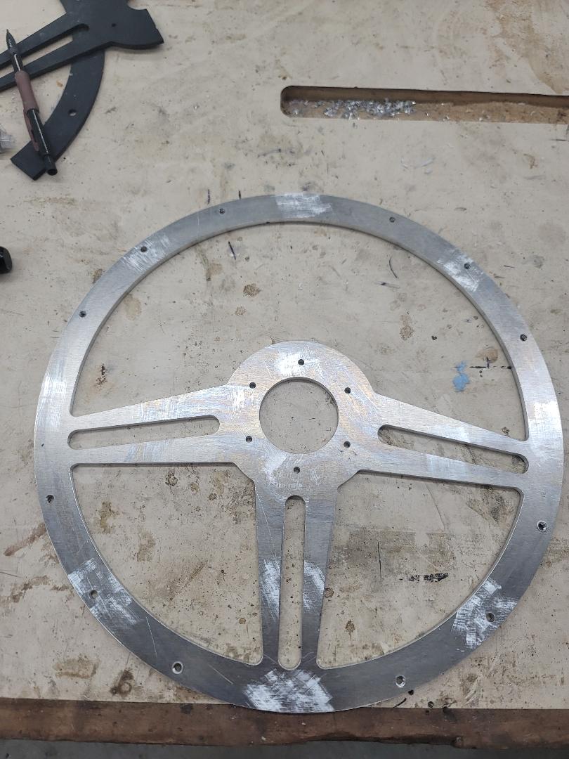

Custom Steering wheel for my race car. HDPE fixture plate.
That looks awesome. What did you use for the rim ?
I 3D printed the structure that goes around the wheel and then wrapped it in leather.

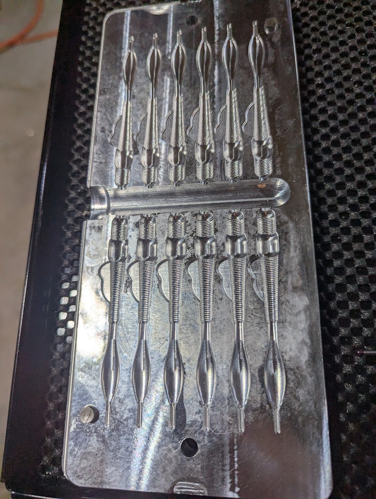

Hello all. I’m new to the forum and just wanted to share what I’m currently working on. This is an injection mold for soft plastic lures. This is side one and side 2 is currently in the machine hopefully finishing up soon.

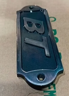

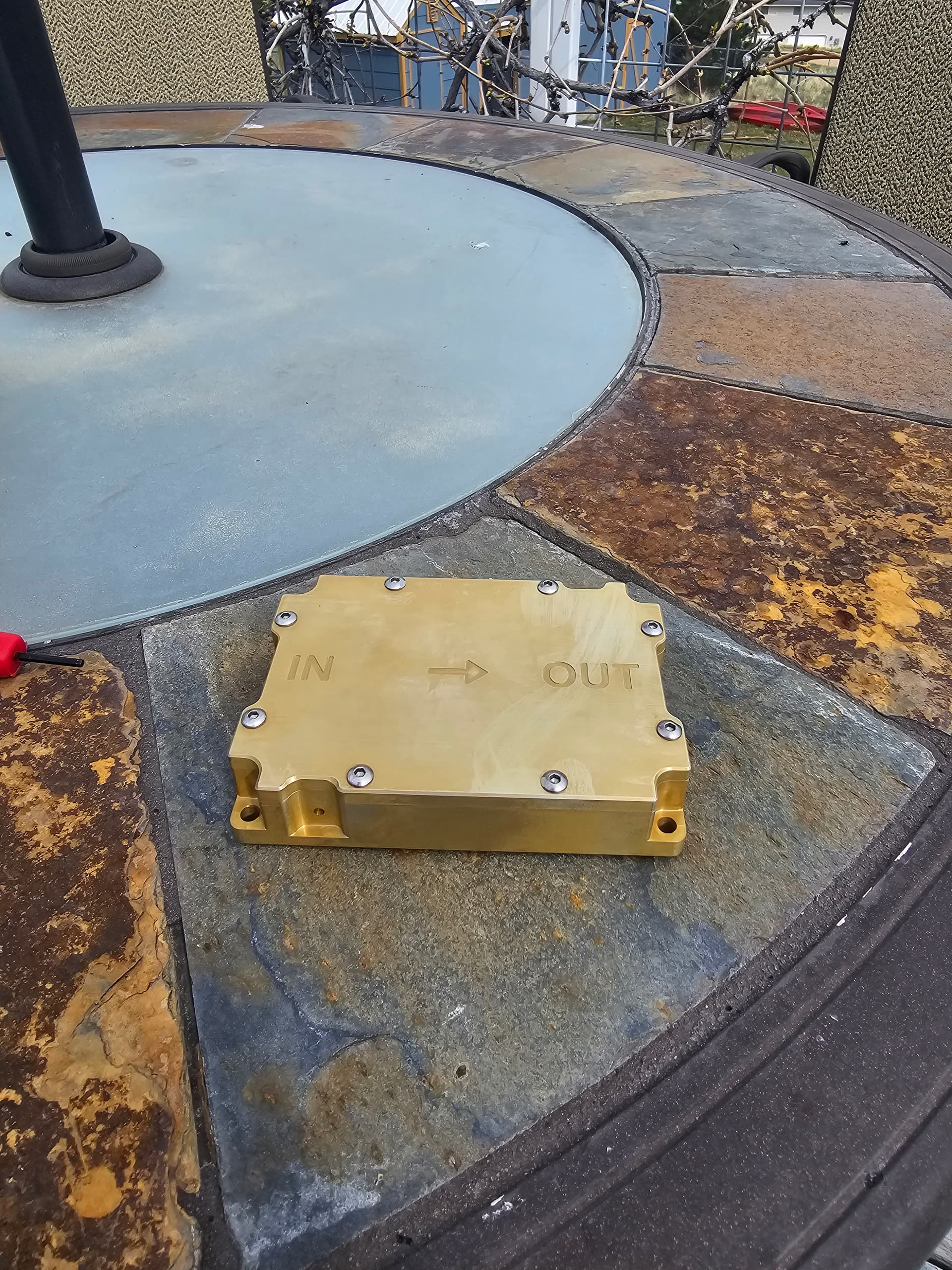

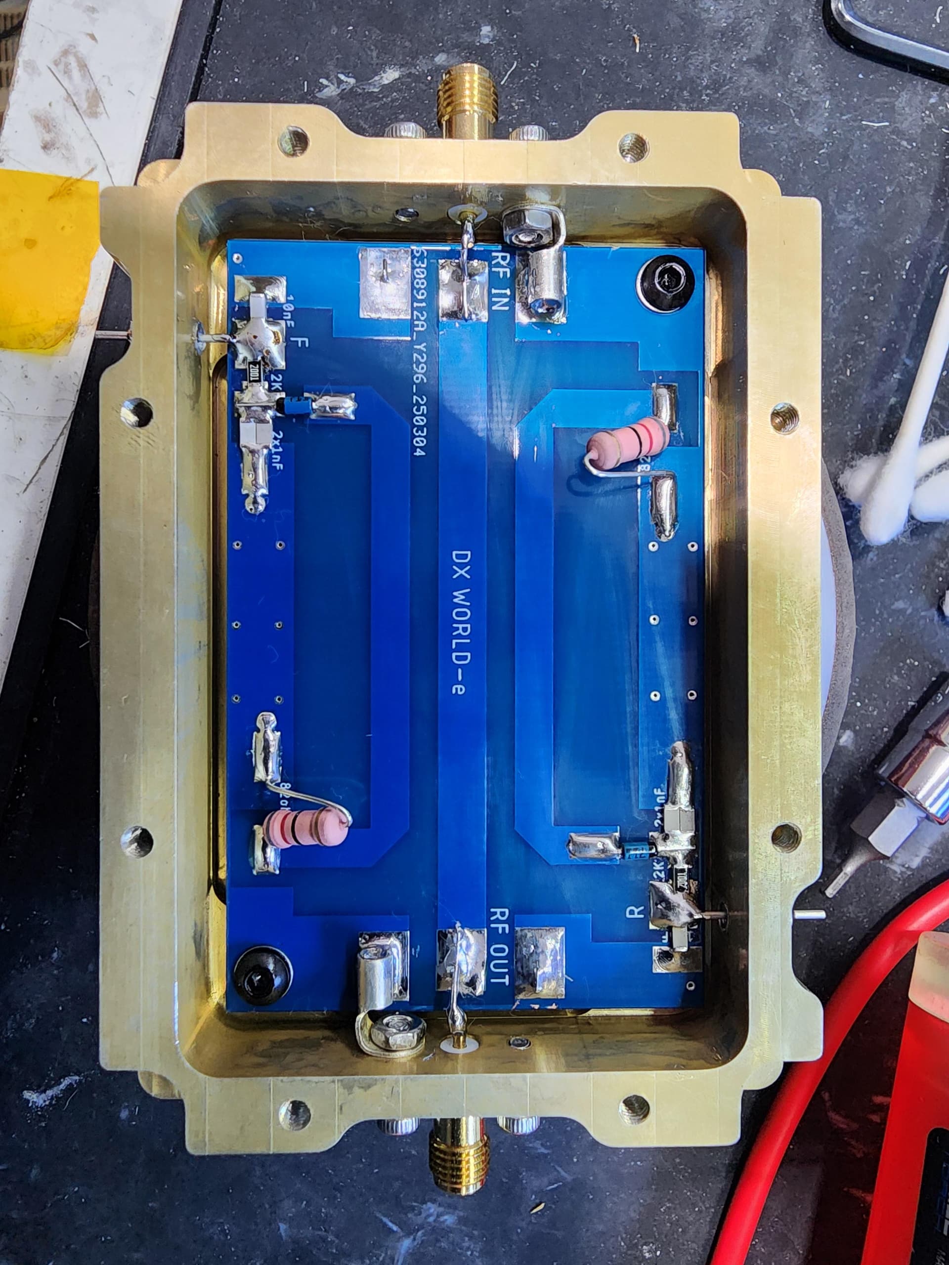

Been working on an circuit board enclosure.
Nice work, is it made from some kind of brass or is that a coating you applied ?
I tried my hand at Alodine coating.
