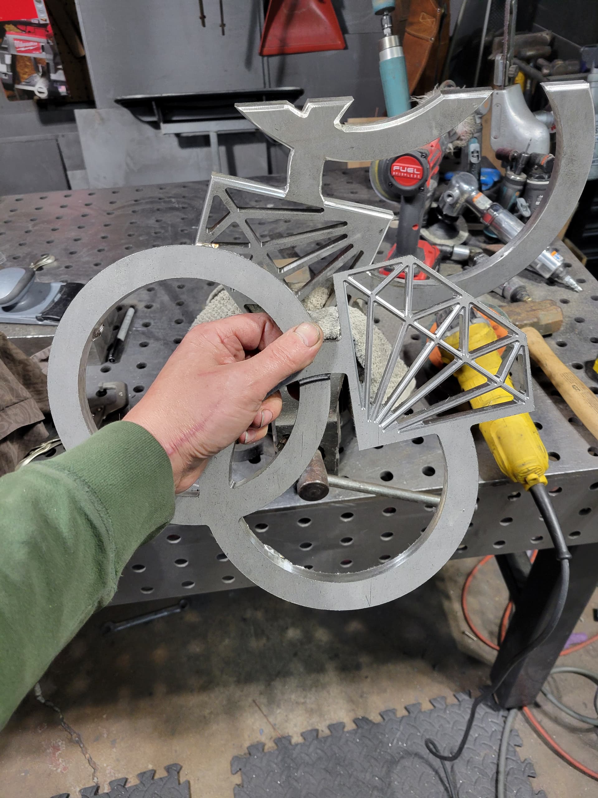

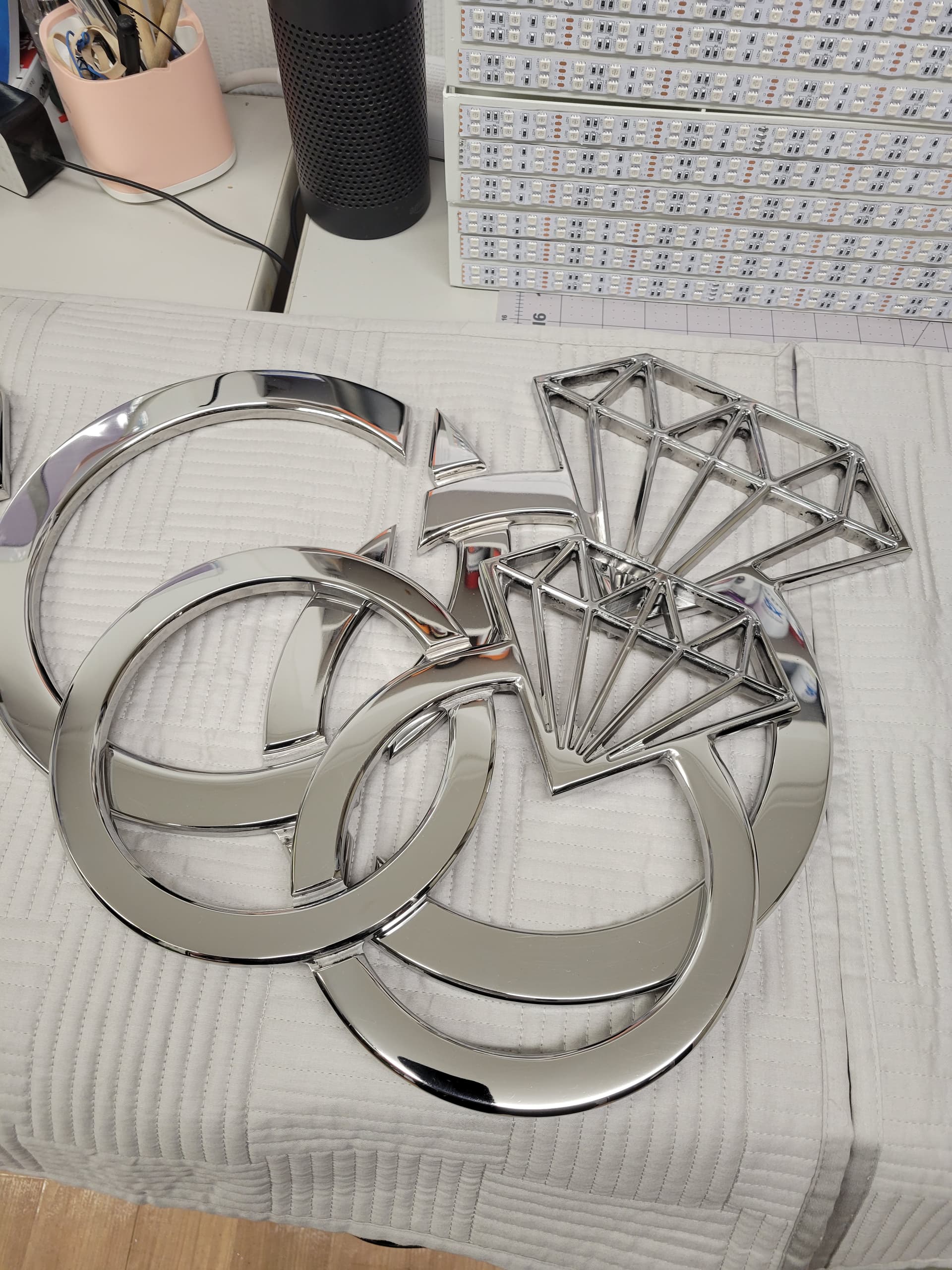

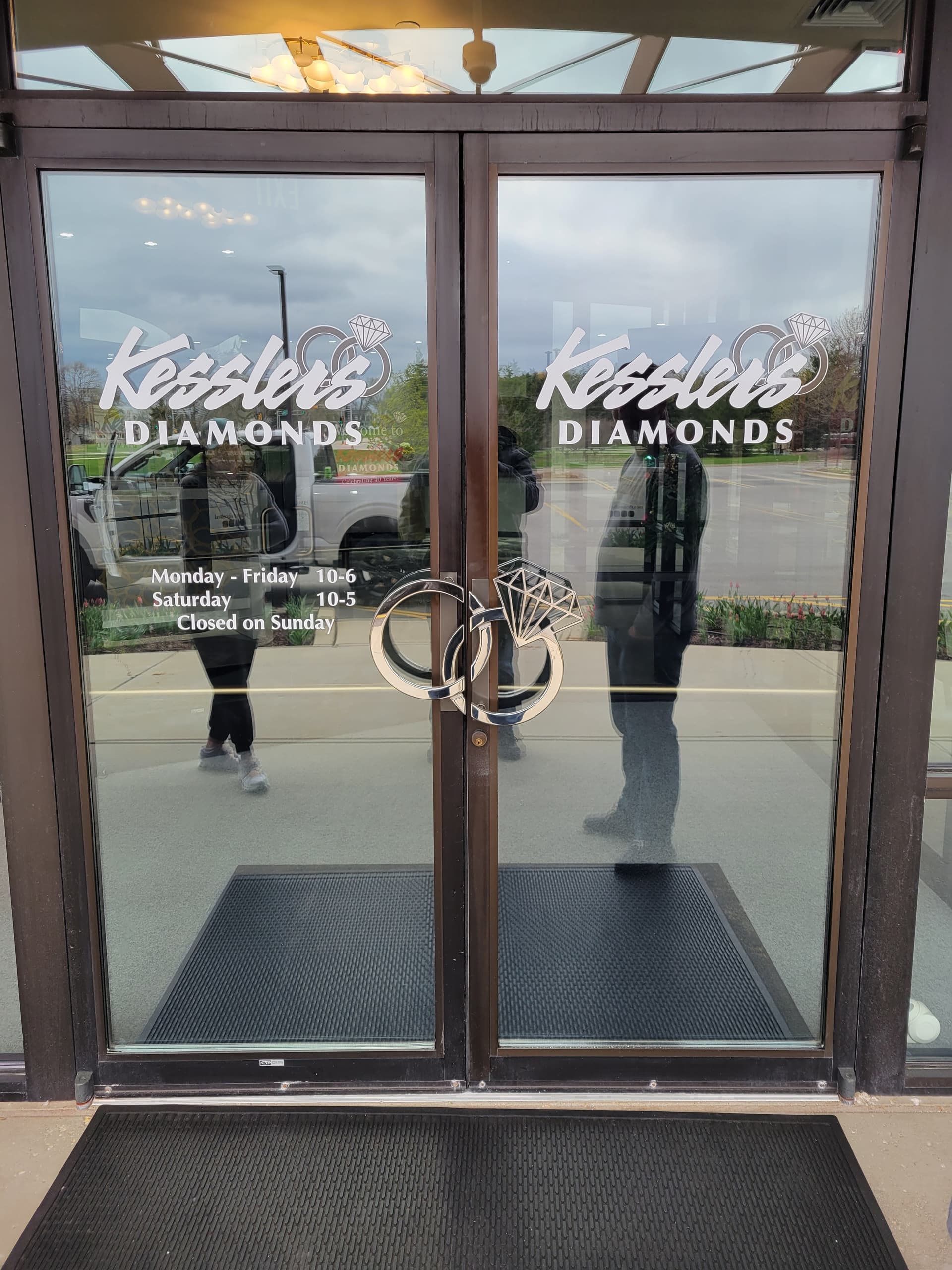

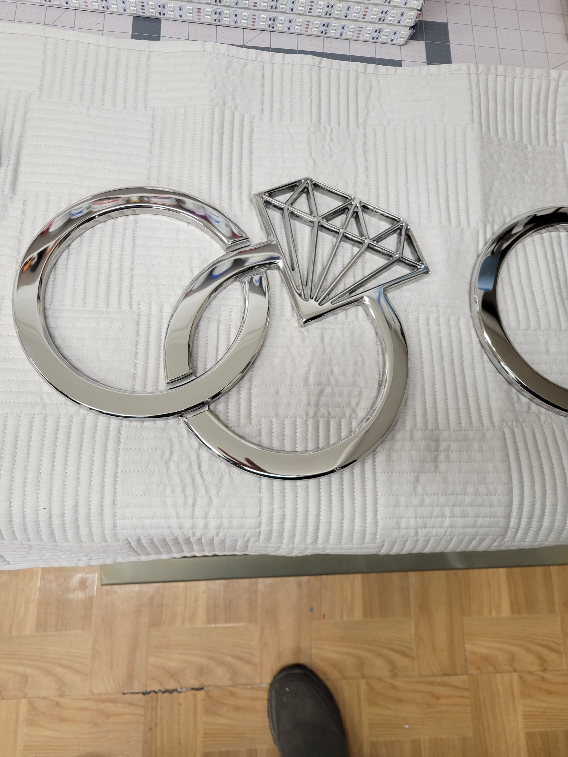

Wrapped up the milling and polishing of some custom door pulls. Last time I built a set I plasma cut them out of ¼" stainless and welded the layers together. This time I used solid ½" 304ss and it was way less work by hand. Still need to weld on the standoffs and the backers plates. But definitely happy to be over the polish stage. The installed picture was the welded version.
