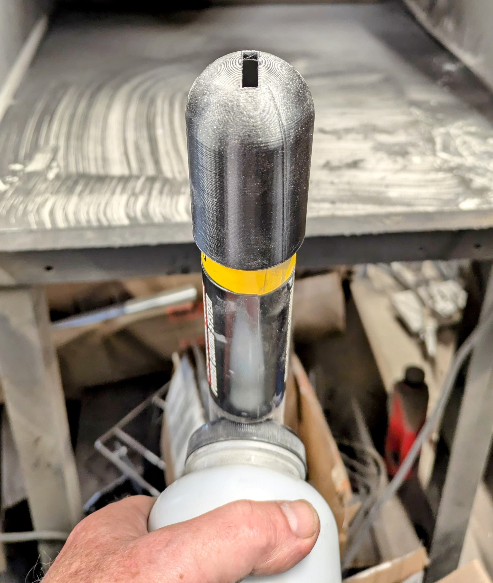

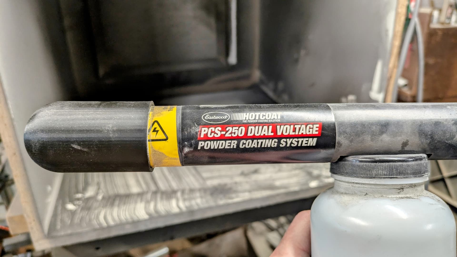

I printed this nozzle for my Eastwood powder coating gun and it works really well at reducing the amount of wasted powder.
I never liked the big cloud of powder that comes out of the stock gun and I printed a nozzle extension to reduce the cloud and direct it toward the part. It was an improvement, but there was still a lot of powder that went past the part.
I saw a few videos of more expensive systems that seem to just deposit powder on the part with very little waste. Those systems use a small slot for the powder to come out, so I wondered if that would work on the Eastwood.

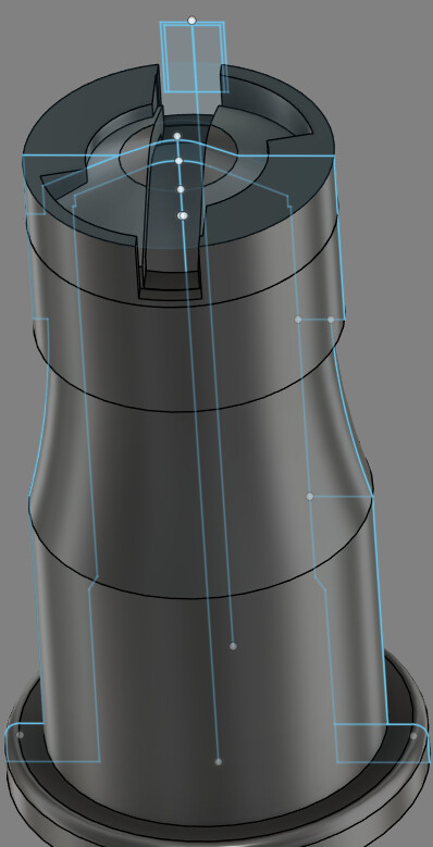

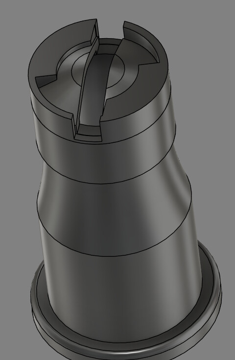

A few minutes in CAD and an hour of printing and I had a new nozzle with a small slot.
The initial test was a huge improvement in directing the powder onto the part without the cloud of wasted powder.
You are a genius…of course you don’t need me telling you that.
I noticed that one powder coat tip that I was just playing with to see if I could mimic the profile, had a slit like you created. It also had a lobsided depression that I imagine would cause some gentle swirling of the powder.
I know you would be easily able to do that if you wanted but at first I thought I would need to cut the depressions. It turned out being easier than I thought by using different profiles with the revolve feature.
