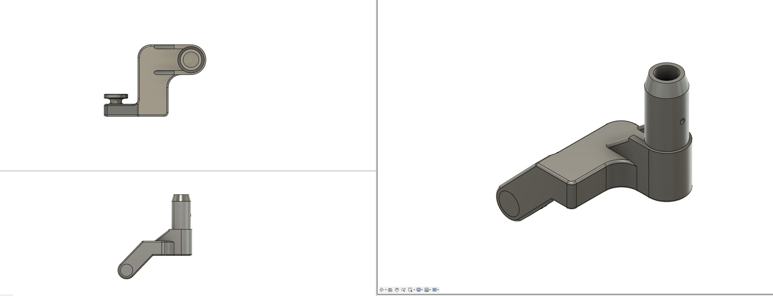

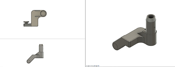

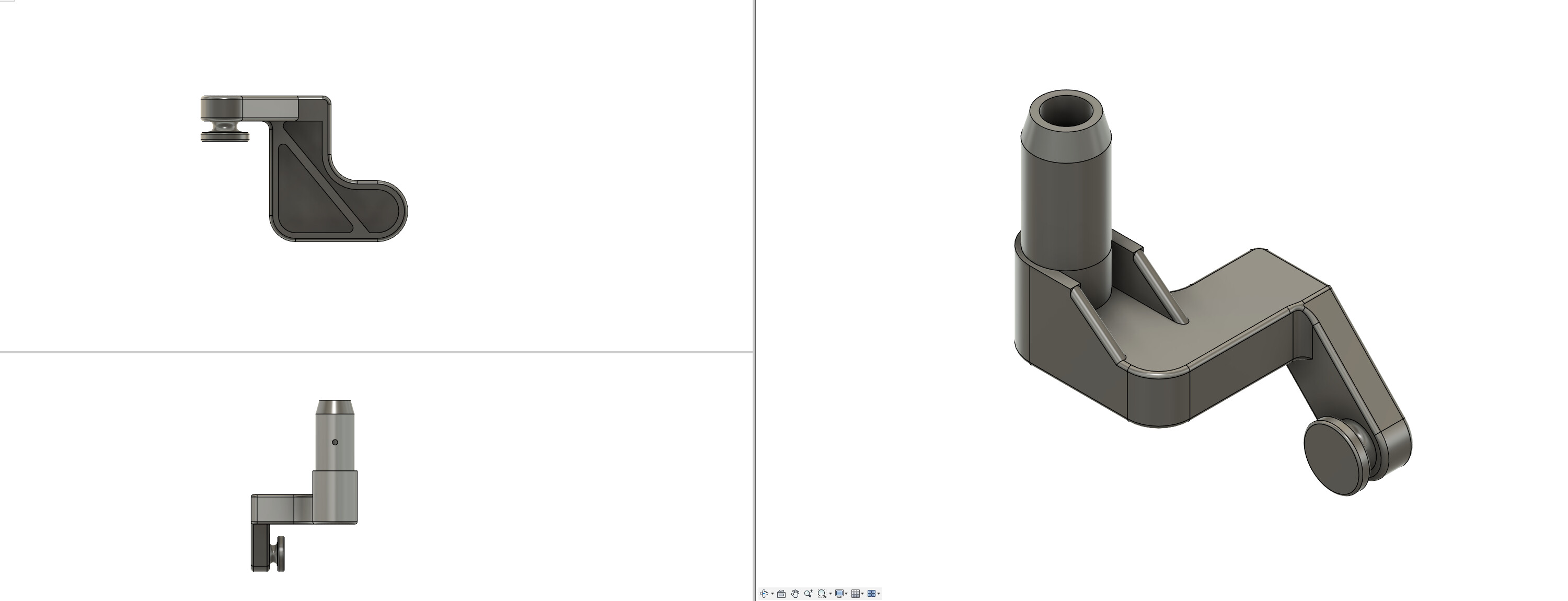

I’m planning on remaking a couple of these parts. I’m worried about it breaking along printing planes so I’m thinking about making it in multiple pieces and then assembling it at the end.
Does anyone have any thoughts on how to make this as strong as possible?
I currently have one printing in a solid piece to check sizing, its about 3 x 4 inches

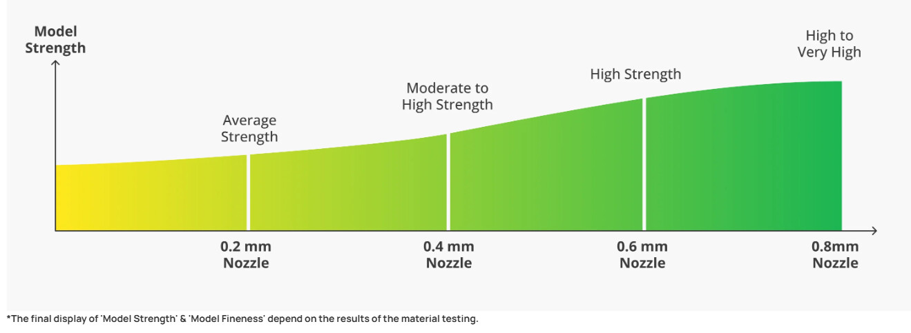

Bambulabs has several suggestions for strength. Increase the hot end size:
But a very new hot end is the High Flow. I have it on the H2D and it is not only stronger prints but faster.

This guy offers many ideas of adding rods, bolts and other things to the interior of the print. He suggests it is similar to adding rebar to concrete. It could be difficult with your project Tin.
@TinWhisperer has all the manuals on the planet, @ChelanJim is the master researcher.
Me, Print in three pieces, a capscrew through the barrel into the rectangular base, a capscrew through the 45* end into the rectangular base. Key everything to align before the screws.
ETA - print hollow, 1mm wall, fill with epoxy.
Sticks, I really like that idea of filling with epoxy. I will do that on some project in the future.
How is it going to be loaded/intended use?
The crazy glue thing is an interesting idea.
I have printed threaded parts before and added cap screws with great success.

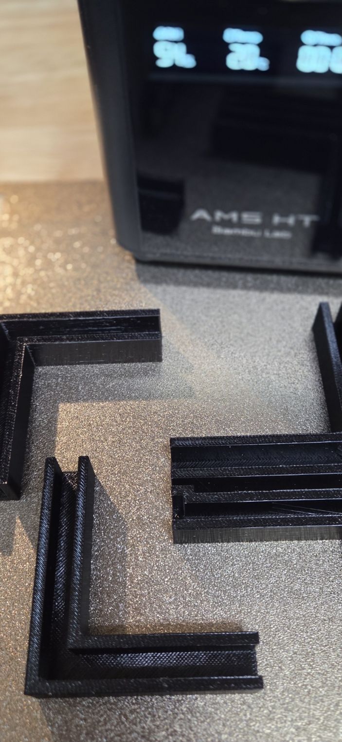

I did a recent print with TPU: I ignored the Relative Humidity of the Bambu Lab AMS HT - Automatic Material System. This filament has sat for more than 2 months without use and without drying. I just needed a utility print for “feet” for a riser I had made for a little fan. If it turned out poorly, it would not be a big deal.
Sorry that the photo does not show the indicator on the AMS but if you could read it, it is saying that there is 54% RH. The print turned out perfectly without any bubbling or stringing. This picture is taken with the plate having just been taken out of the printer.

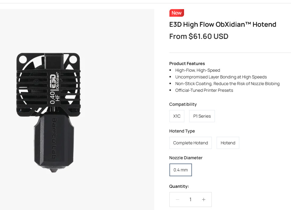

Correction of a previous post:
I am giving a cautionary note of the “E3D High Flow ObXidian HotEnd” for the X1C. They have preset configurations for PLA, PETG, PC and ABS filament. But you have to come up with profiles for other filaments. There are a few more in Wiki.bambu. I just am not that into experimenting with all the settings: That is why I bought Bambu.
I have the hotend but have not tried it yet. Perhaps my opinion will change after use.
