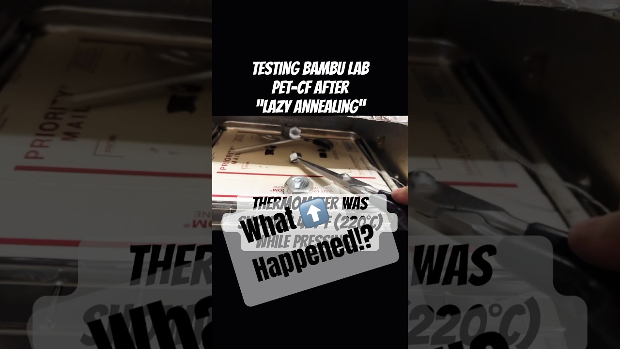

I’ll share this here as well…I’m VERY impressed with Bambu Lab PET-CF (*Note PET-CF is NOT the same as PETG-CF):
I’ve spent the last few days experimenting with printing and annealing Bambu Lab PET-CF filament, which is incredibly heat resistant, yet still quite easy to print.
After watching Dr. Igor Gaspar’s (My Tech Fun) video on this filament, it became evident that annealing was absolutely necessary to achieve Bambu’s advertised heat deflection temperatures, however, I found that I achieved similar results to Dr. Gaspar’s oven annealing (2 hours @ 110°C) by simply “Lazy Annealing” my parts directly on the heat bed (which has much lower likelihood of part warpage).
In previous experiments I found I was able to achieve a consistent 90°C annealing temperature with the build plate set to 120°C and the parts covered with a foil wrapped filament box. My annealing process on this heat deflection test bridge was 3 hours @ 90°C started immediately after the print, followed by a slow (1-1/2 hour) cool down.
What you are seeing in the video is the heat deflection bridge, after being warmed to 425°F (218°C). After witnessing zero deflection with 2x 10mm nuts, I opened my oven and pushed down on the bridge with great force. I would have gone to a higher temperature, but the cardboard I was using as an insulator was starting to burn.
I hope this information is helpful. Heat bed annealing is really only practical for smaller parts, but the ability to retain dimensional accuracy is quite beneficial. After very underwhelming results with annealing Matter Hackers NylonX, annealed Bambu Lab PET-CF will be my go-to filament for anything going into an automotive engine bay application moving forward.
-Casey
Very cool! Thanks.

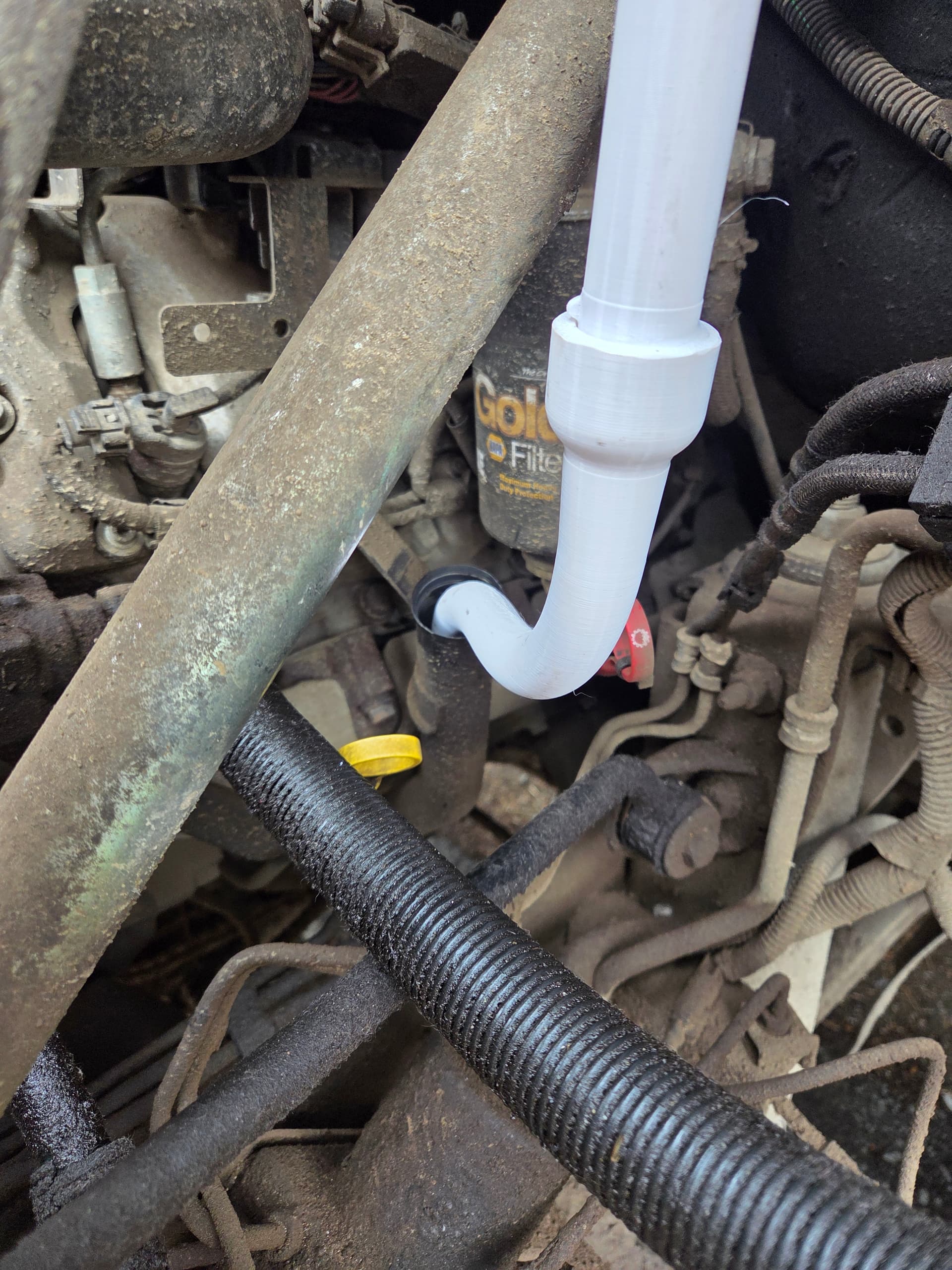

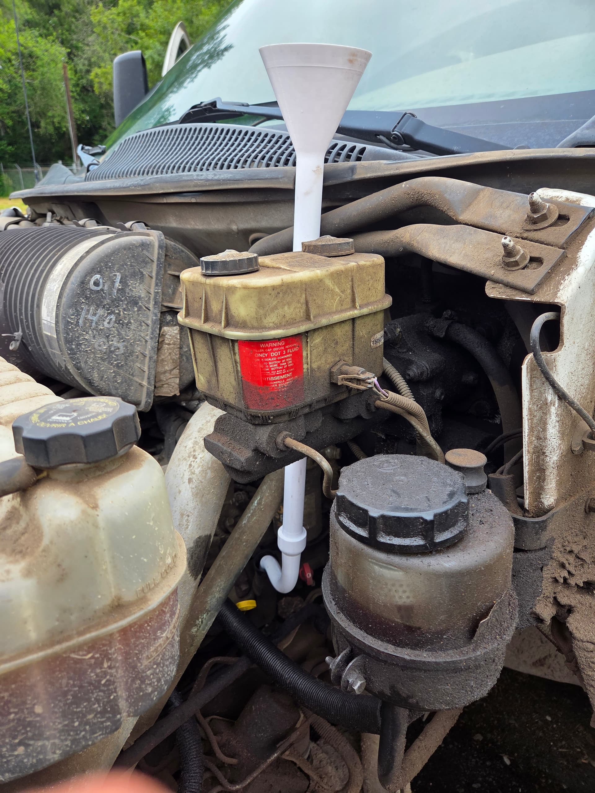

Finally got a chance to fit the funnel to the dump truck. It is going to work perfectly.

@ChelanJim, that funnel is amazing! I appreciate the ingenuity.

I will post the funnel model online. It really finally satisfied one of my requirements of having the printer.

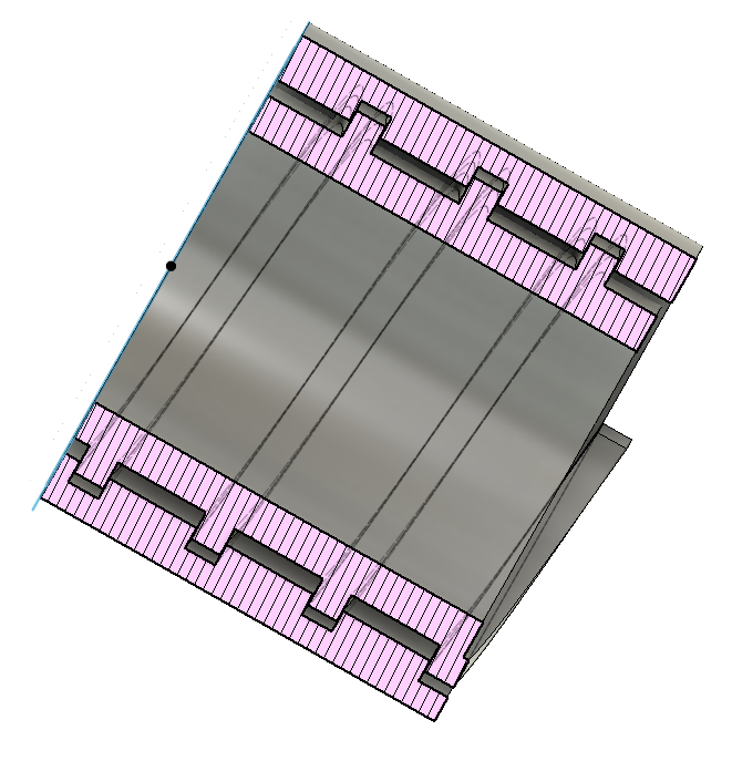

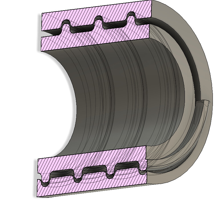

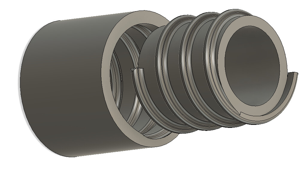

No, I just meant that I made at least 20 different versions of a funnel when I first got the X1C and was never fully satisfied with my designs. I had in mind, when I got that first printer that I was going to solve my itch of having a funnel “that worked.”
I think the thread design is what helped to expand my design thoughts. That allowed changing the actual pieces to work in different scenarios. Up until that, I struggled with a thread that was easy to attach and secure. I ended up using a coil design with a square profile, assured myself there was clearance with “inspection” and then filleted the corners of the coil.
I still have lots of refinement and learning to do but that is what keeps me engaged in this hobby.
(Note: This is not the actual model I used with that funnel. The clearances are much tighter than what this demonstration is showing.)

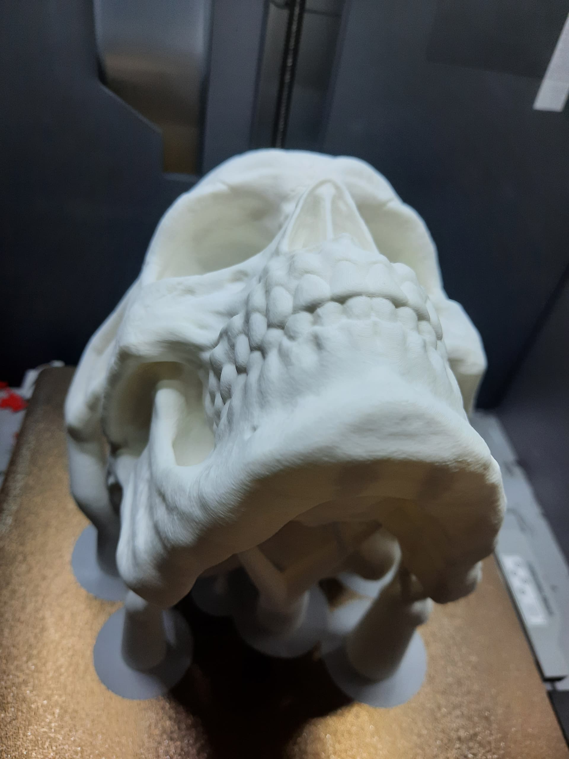

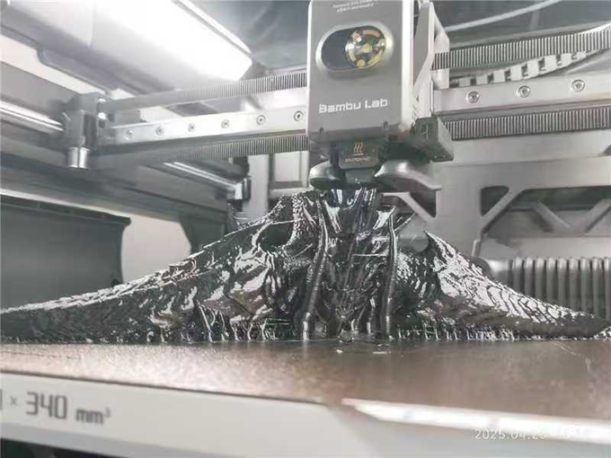

This is a great print
https://makerworld.com/models/110141

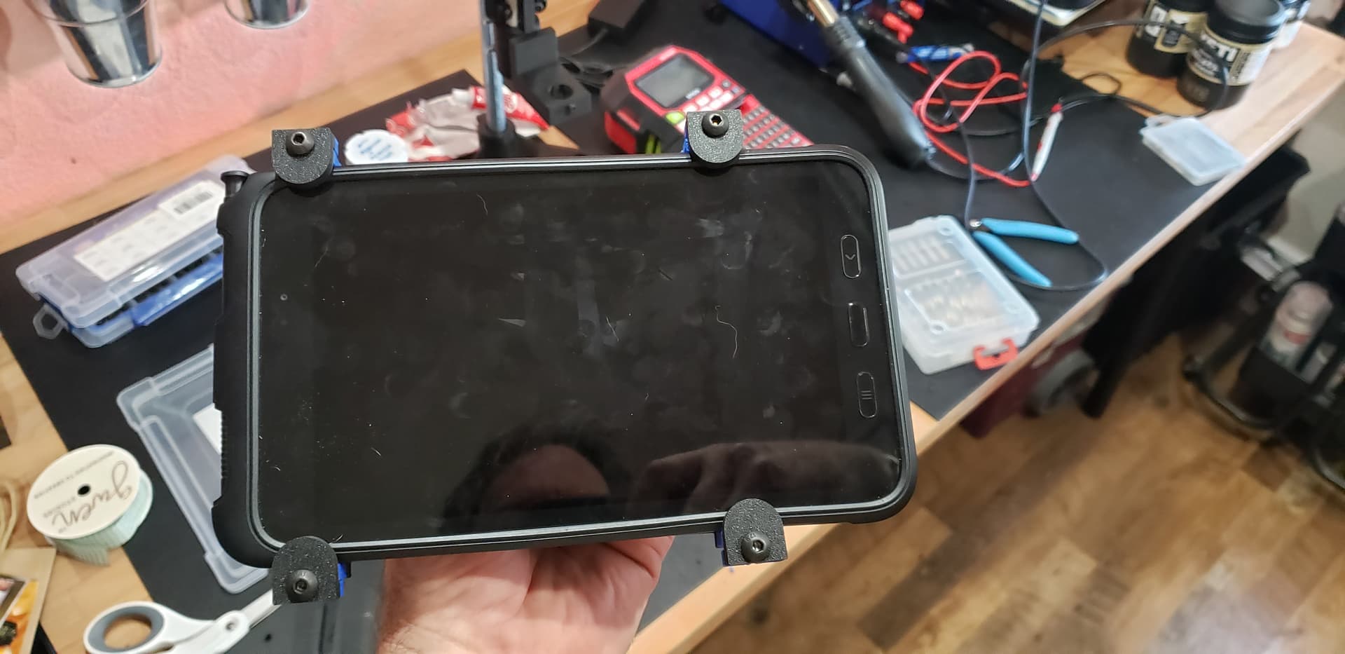

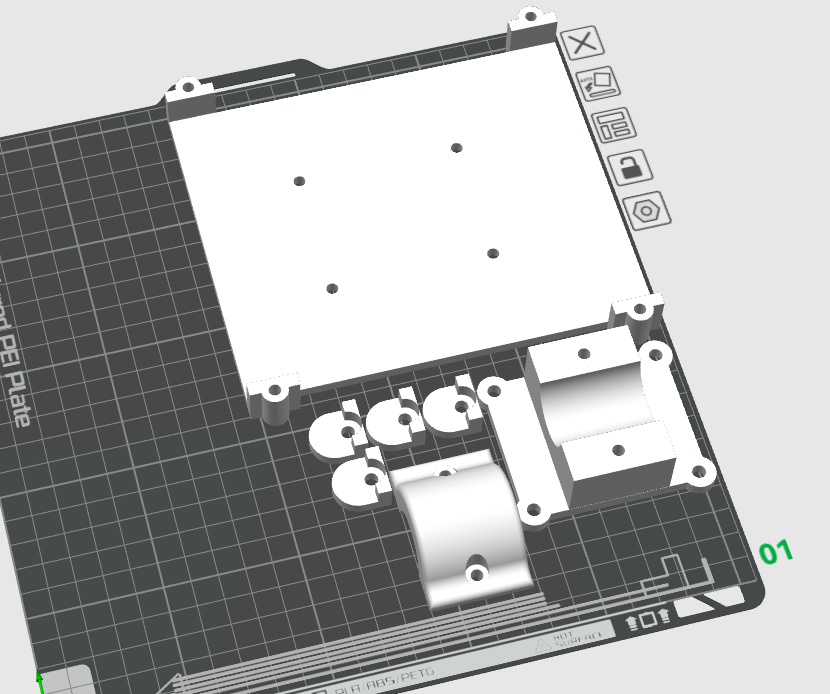

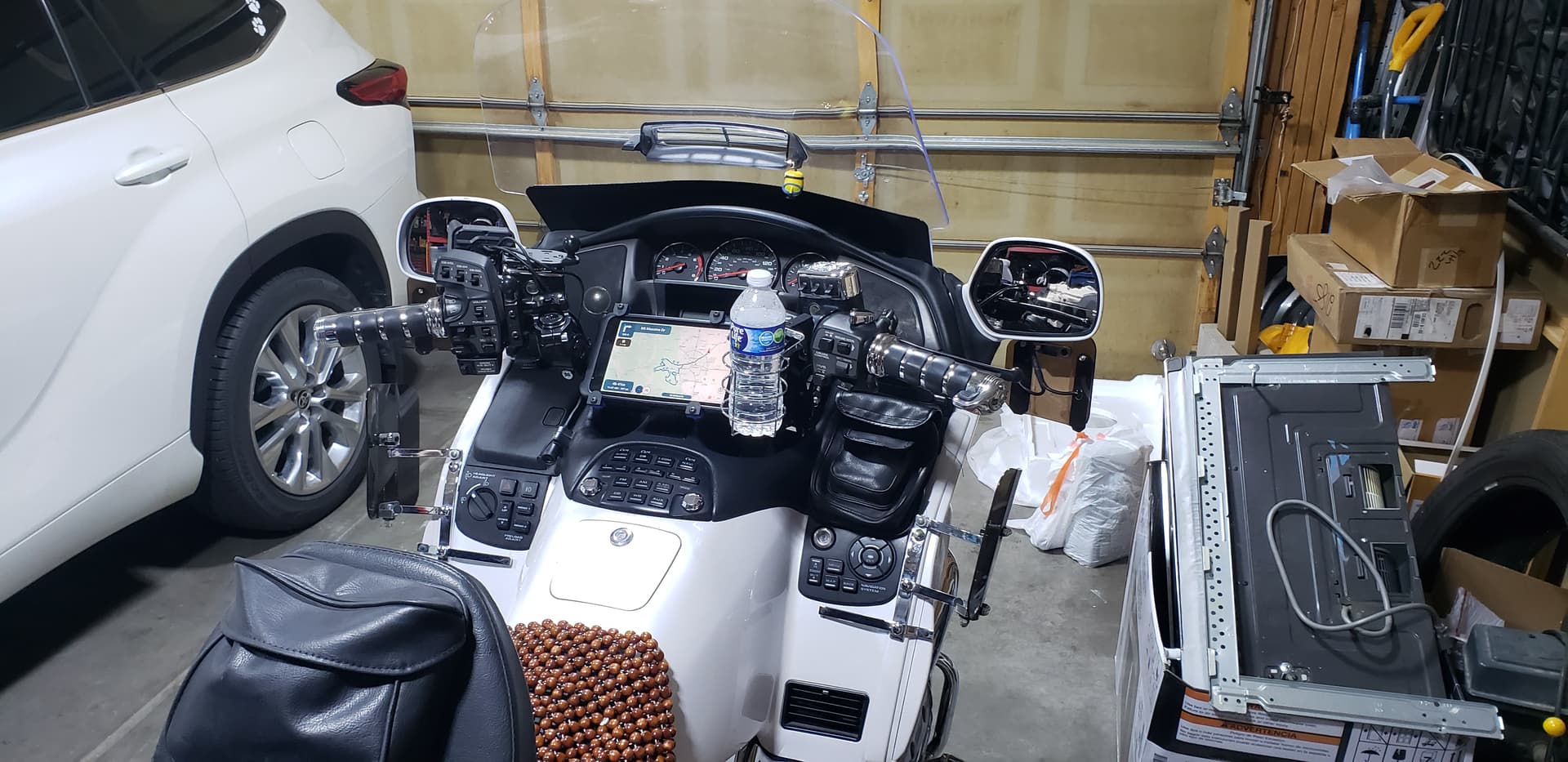

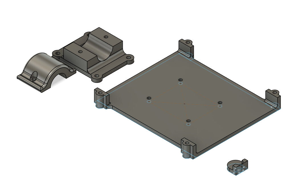

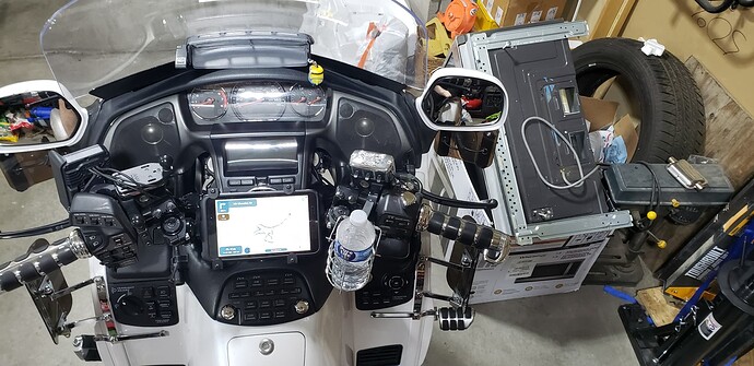

I do a whole lot of “I need a thing” stuff with my printer.
Last night, part of my ongoing navigation issues with my Goldwing, I am trying a 8" tablet to do my music and navigation in leiu of the Android Auto which works, but is tiny for my blind butt.
Got the tablet yesterday afternoon, slapped a drawing and model together to hold it last night, printed and ran out of Black and transitioned to Blue, and after an overnight failure to retract with the AMS (only ever happens when I am gone or sleeping) finally finished it…now (0519).
Prototype or V1.0.
V1.3 in the tweaking stage. Prototype in PLA+, final to be in ASA.
Sticks, Your tablet mount looks good. Do you use the nut inserts or screw directly into the plastic?
Yes. If it’s more of just an attachment, and not necessarily load bearing I’ll just thread the plastic hole. So for this particular application I’ve got both on the prototype. The final finished product out of Asa is going to have countersunk nuts or heat set threaded inserts.

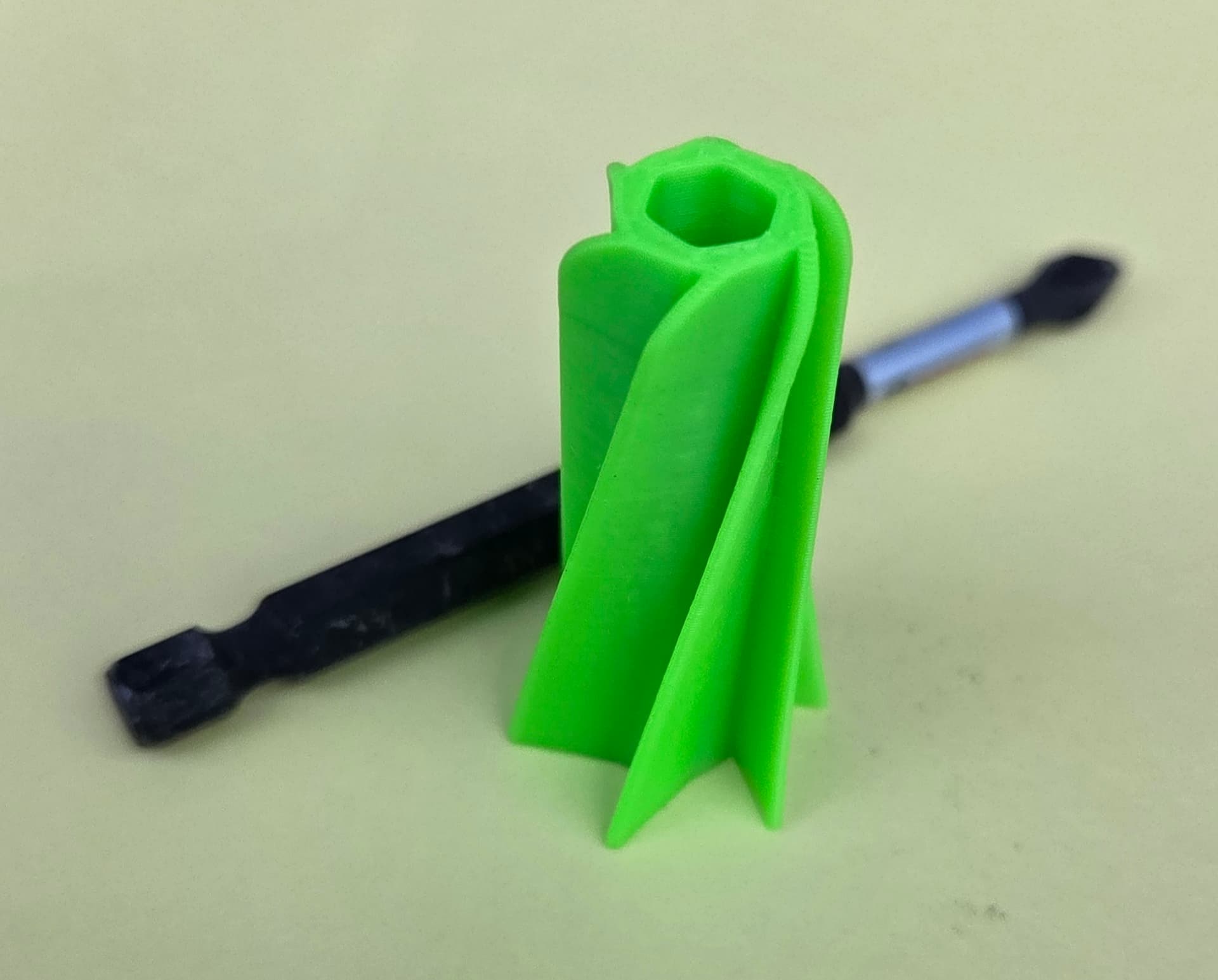

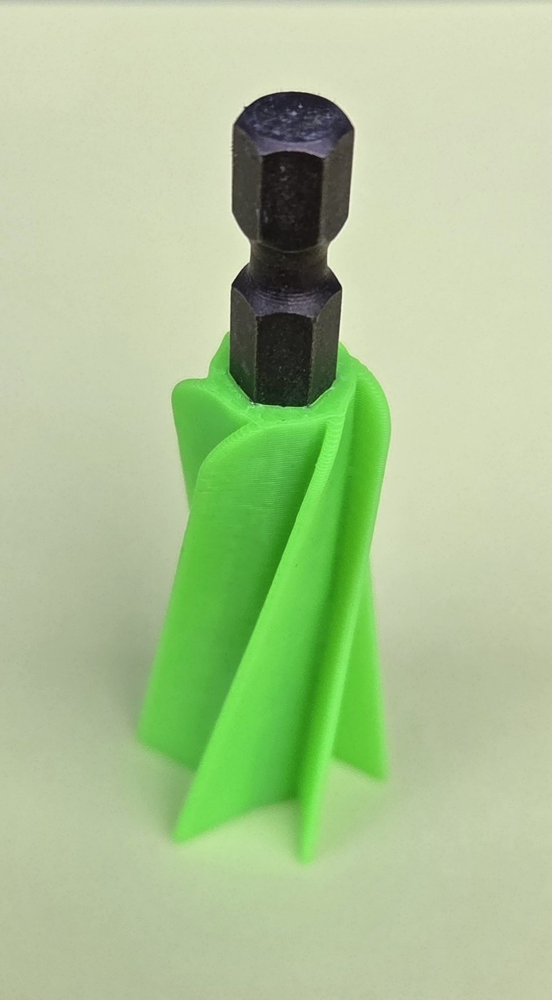

Maybe you guys have already figured this out:
I wanted to insert the shank of an old hex bit into a paddle stirrer I made but if I didn’t go straight it would create a larger hole.
So I chucked the bit into my drill press, and press fit it.
Alright… So I am late to the party!
I had thought of using a threaded insert, for another project, but couldn’t figure out how to get a more precise placement. Now I have an idea with the drill press.
