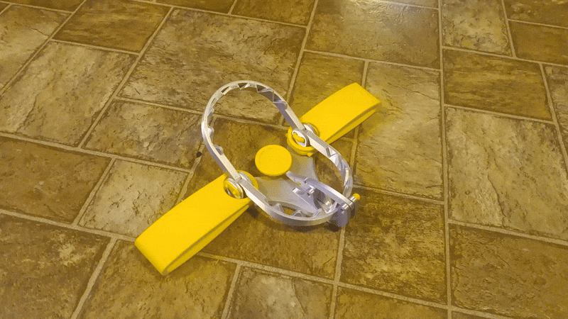

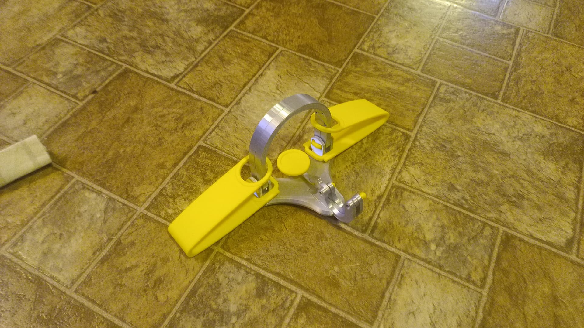

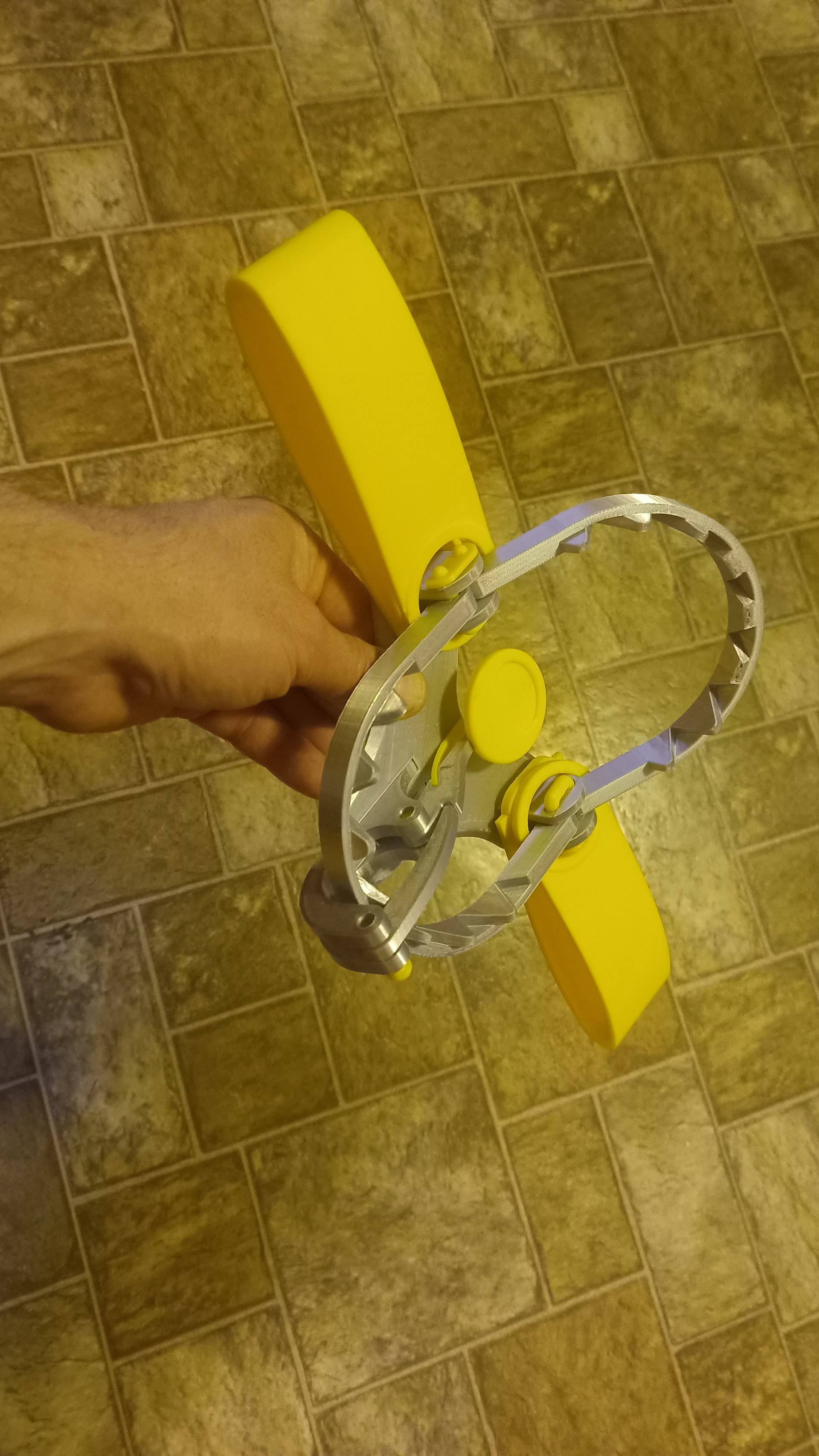

My kids were making leprechaun traps so I have 3D printed some bear traps for them. I started off with some small ones and then found a multi-pieceI liked.

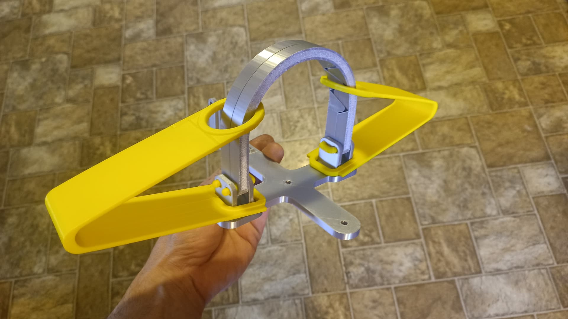

When I printed it at 150% scale it had a scary amount to snap to it. So much so that the original frame didn’t stand a chance. I redesigned the frame to take advantage of this strength of printing in different directions. I used keyway slots to fit all the pieces together without glue.
Here’s the redesigned frame parts
ezgif-15ca35c884728a
My kids almost didn’t want to use it cuz they were afraid it was going to kill or maim the leprechaun.
My brother has a trap line down the lake here. I bet you this would actually work for trapping. I could cut up some Jaws on the plasma cutter for it and roll them.Do you think should I work on this design a little bit more and see if this can actually be used for real? It would probably work for real even with the plastic jaws
By the way my kids were successful they caught the sack that they leprechaun carries around with all of its treasures

TinWhisperer, That’s a cool trap!

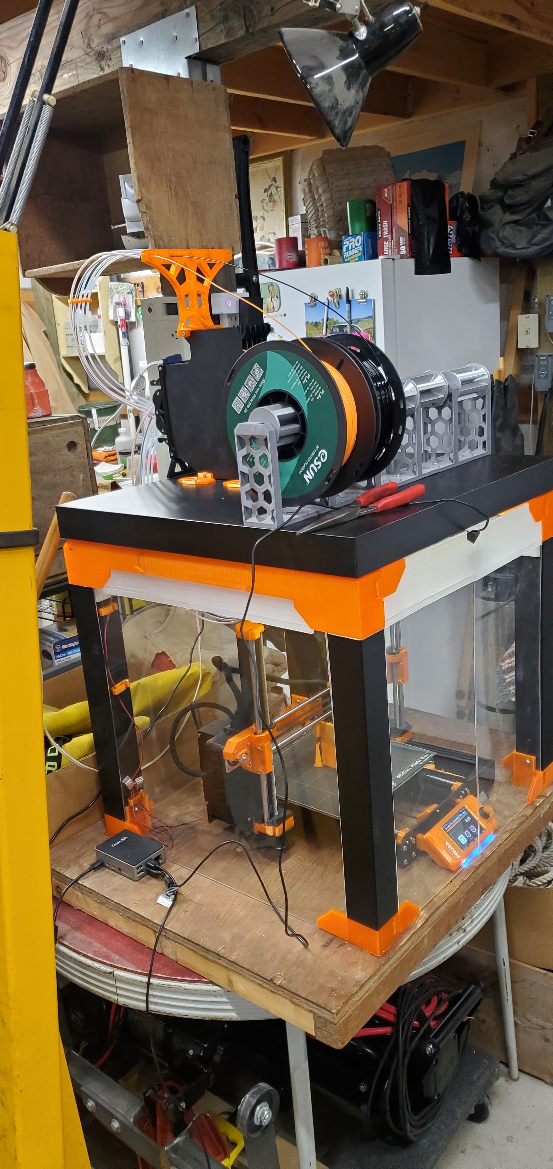

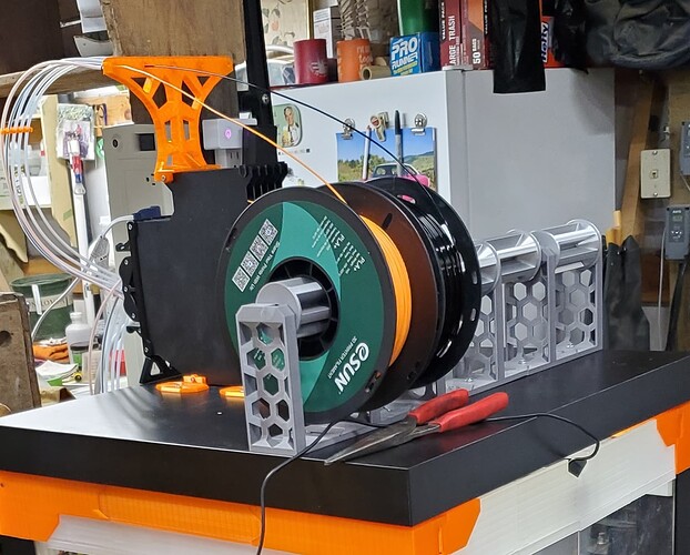

There has been talk about spool holders lately, this is what I did for my Prusa and enclosure. Since the lid hinges up I needed something that would hold the spools in place. This is the only photo I could find. Still putting things together in the photo.
Here is a cropped view of the holders.
@TinWhisperer - Make the springs out of PetG, and try different thickness for more or less spring.

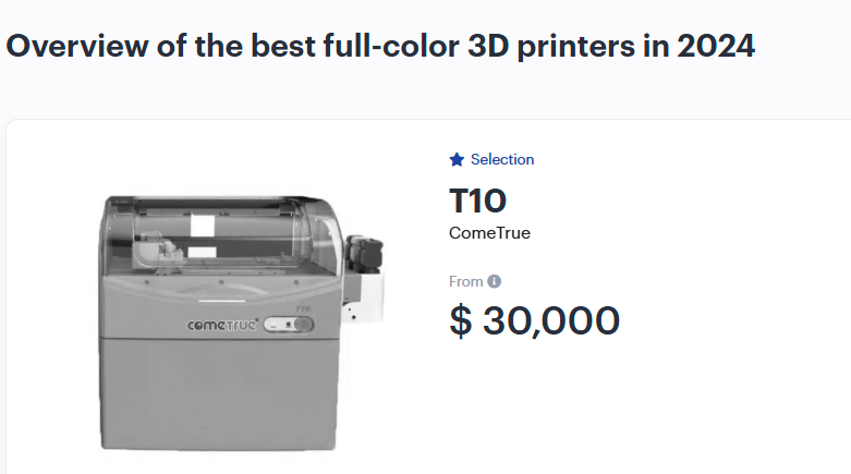

This video that Tin posted makes me think that a CMYK or RGB printer could really disappoint users. It would be really difficult to get a pure homogenous color with several filaments mixing together.
But I guess they are doing it…but not in a price range that I would like:
Two or three years ago at one of the maker conventions, there was somebody that had developed a CMYK printer. This just was your average at home hobbyist tinkerer that did it.
Now whether or not the technology was sold to one of the above companies. That’s possibility.

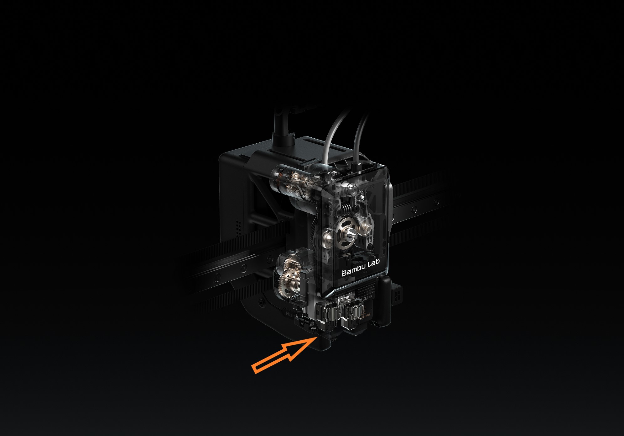

some of the details of this dual head extruder are pretty cool. One thing I noticed was these wipers slash nozzle plug arms. Pretty good idea to stop the one nozzle from weeping while you’re printing with the other and or it may be to wipe the nozzle clean before engaging.

Also utilizing the A1 hot swap nozzles which will be way more convenient than the current X1 carbon in P1P nozzles

Easier change of nozzles would be very nice.
Your bot eyes see that wiper better than I can!
