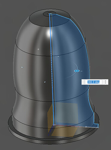

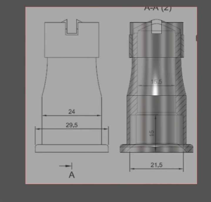

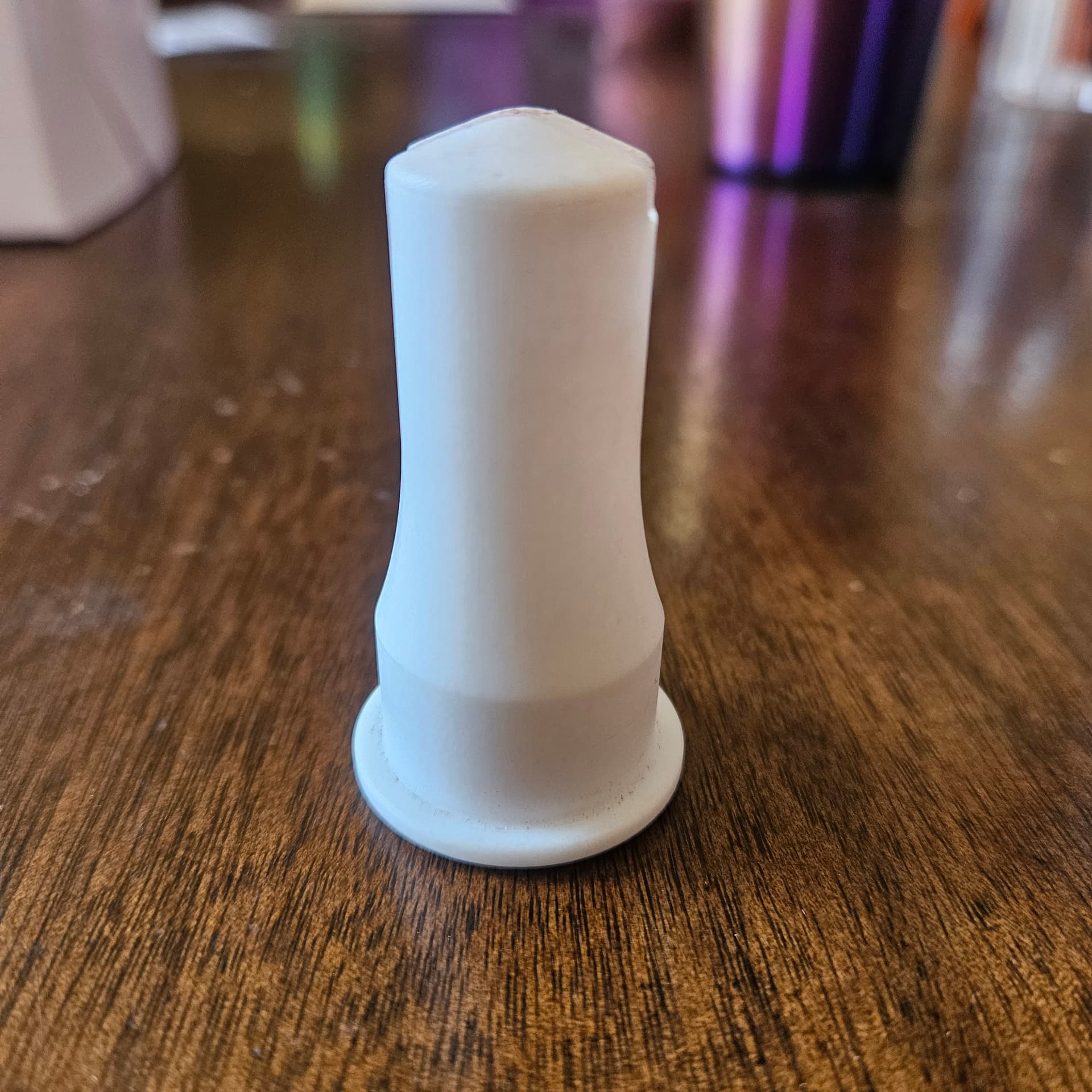

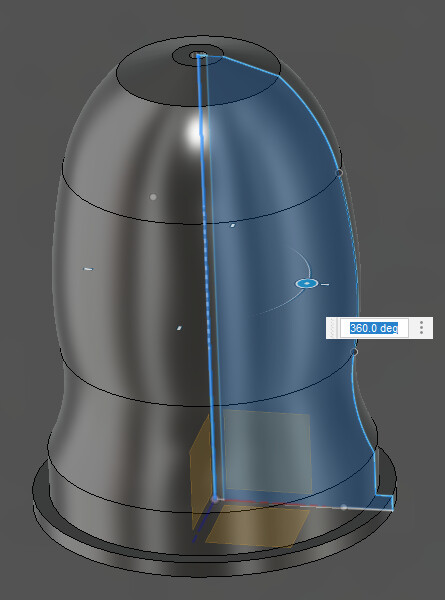

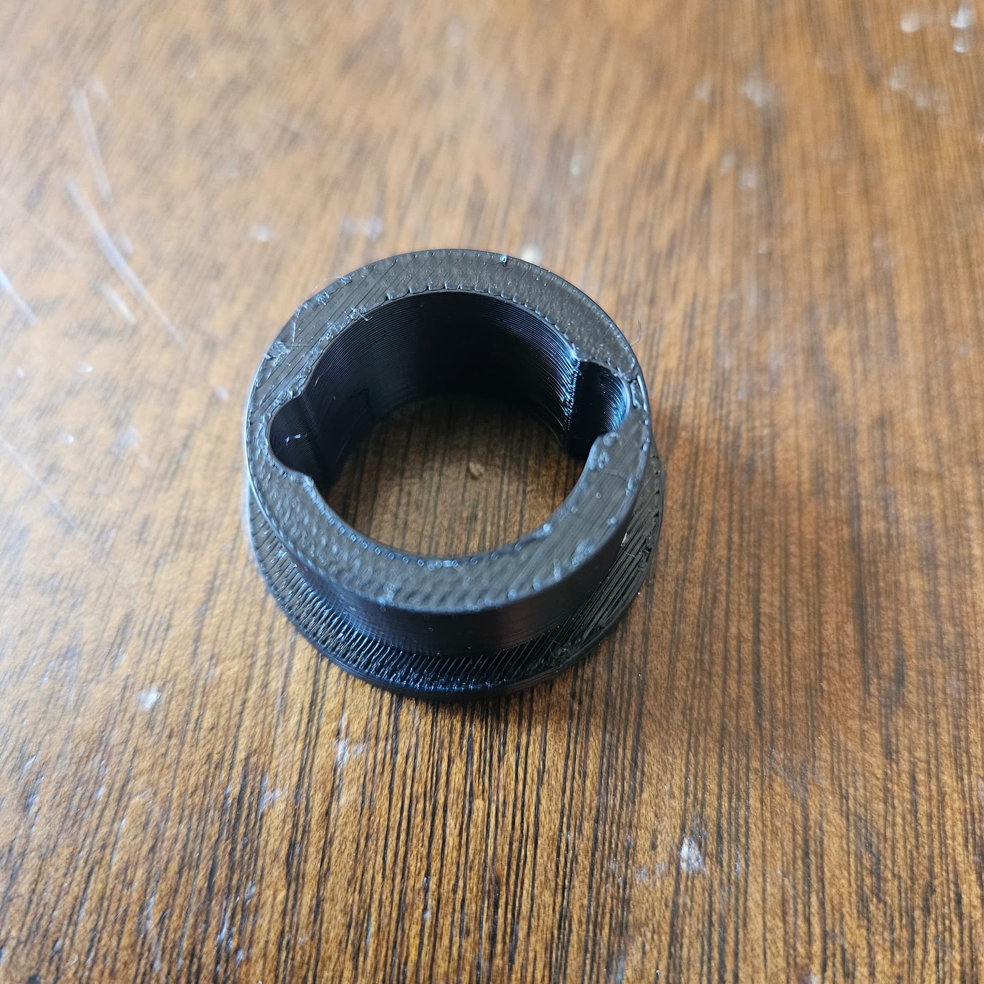

Im attempting to make 3d printed nozzles for my powder coating gun. New ones are about 30 bucks and they break pretty easily. Since I have a 3d printer, figured id try and save myself a few bucks. I’m running into issues though. I’m using Fusion360, the trial version. Ive been able to recreate the base of it, but when I try to make the top portion of the nozzle, it moves it to the base. Ive tried every option in the push/pull menu. I can’t figure it out. (Im still learning Fusion360). I’ve included pictures of the nozzle I need to design and the base I already printed. Any helpful hints?
This is a situation where you should utilize the “Revolve” function in the create menu rather than using the “Extrude” function or the "Push/Pull function.
If you included your f3d file and some photos of the actual tip someone could show you how they would approach it. @BoboBumster gave an excellent suggestion.
You make the profile. Pick the profile and the axis and there is your item.
I would caution you that it will be extremely difficult to get a machined smooth bore in that tip. At least from my experience trying to make this y splitter so that the filament did not have extra drag. (Six failures). Some people are successful. Maybe I don’t have my printer dialed in but if there is extra turbulence caused with the powder coating gun with the printed tip, it could introduce problems with your end results.
first pic is the nozzle
Awesome! Thank you! Already designing it now.

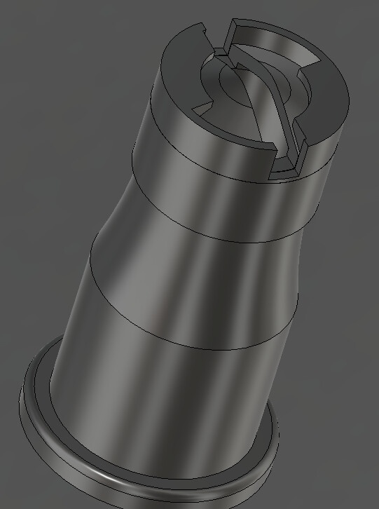

I did not realize that tip is mostly hollow space. Here is a listing where someone is selling the model for $5. Not sure if it will work for you but here is my mock up of it. You might whittle away at it.
https://cults3d.com/en/3d-model/tool/nasadka-na-raspylitel-poroshkovoy-kraski
Powder Coat Tip v4.f3d (482.0 KB)
Very nice, thank you!

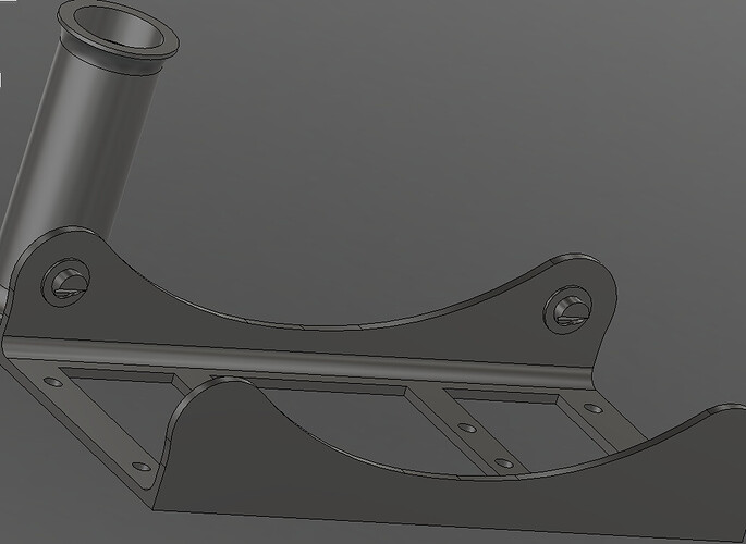

Sorry, not mine. Posting for ideas.

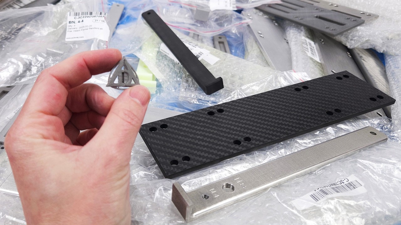

Speaking of which, if you’ve ever considered using PCBWayfor any kind of fabrication. This video shows a lot of different combinations of materials that they offer.

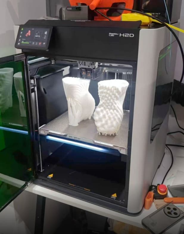

Are we getting closer to finding out about the new Bambu printer?
https://www.3printr.com/bambu-lab-h2d-leak-points-to-new-3d-printer-with-laser-cutter-function-5079428/
