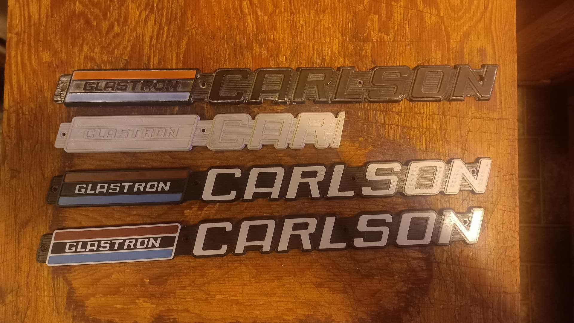

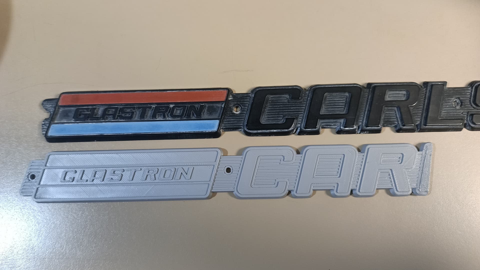

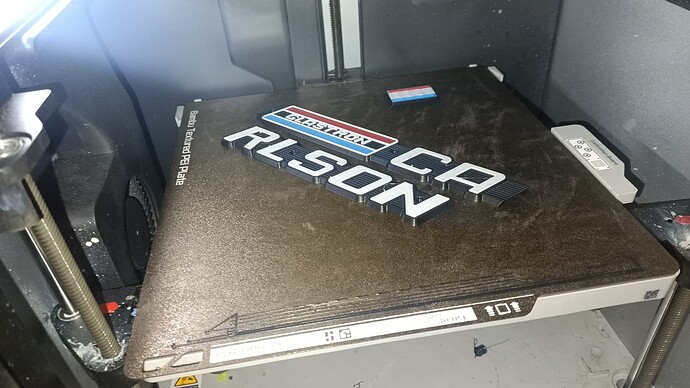

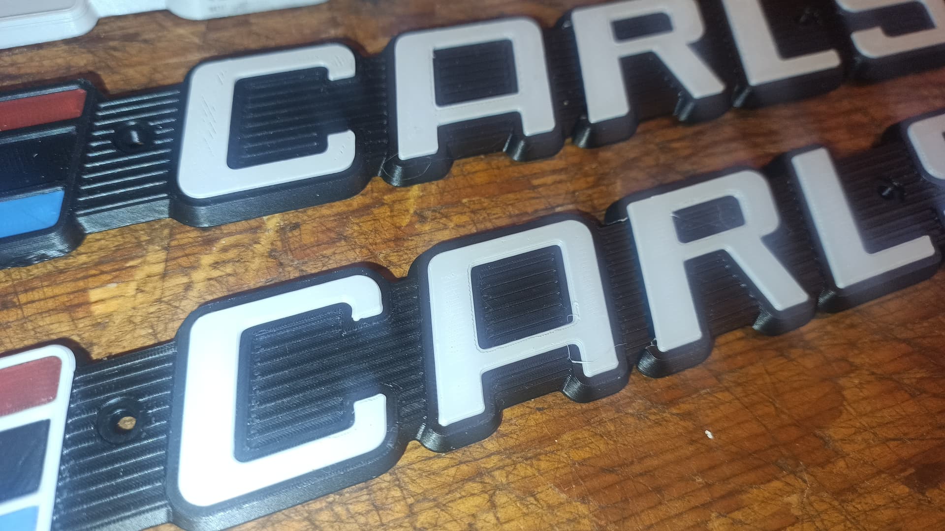

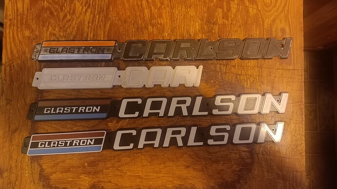

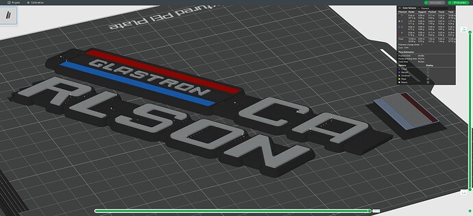

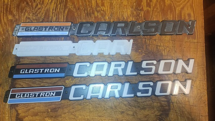

the test print went well now printing a colour version . 5 hrs 45 mins. i had to make it in 2 pieces
edit I had iron all surfaces enabled instead of iron top surfaces now I’m down to an hour and 45 minutes
Getting closer to a respectable representation.

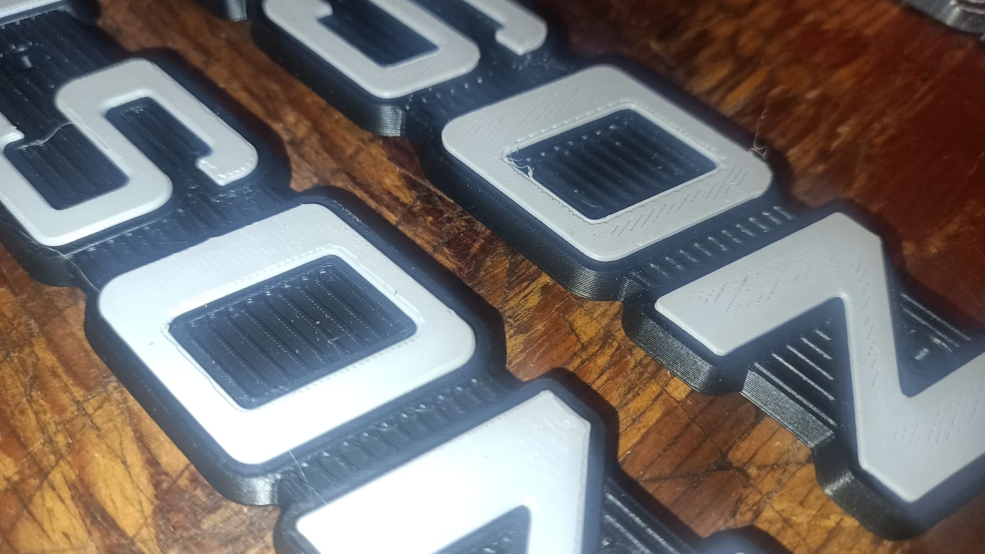

My gray filament must have had a little moisture in it it’s printing far better now that I put a fresh spool in.
It’s hard to tell but you can see there’s definitely some moisture related texture issues on that top surface. But with a fresh roll of filament it seems to be good.
Still considering printing the whole thing with a point 2 mm nozzle but it adds 4 hours to the print time and swapping the nozzles of big pain on the X1 carbon.
I’m happy with the way the joint worked out in and under the R
nice touch on the raised lines.

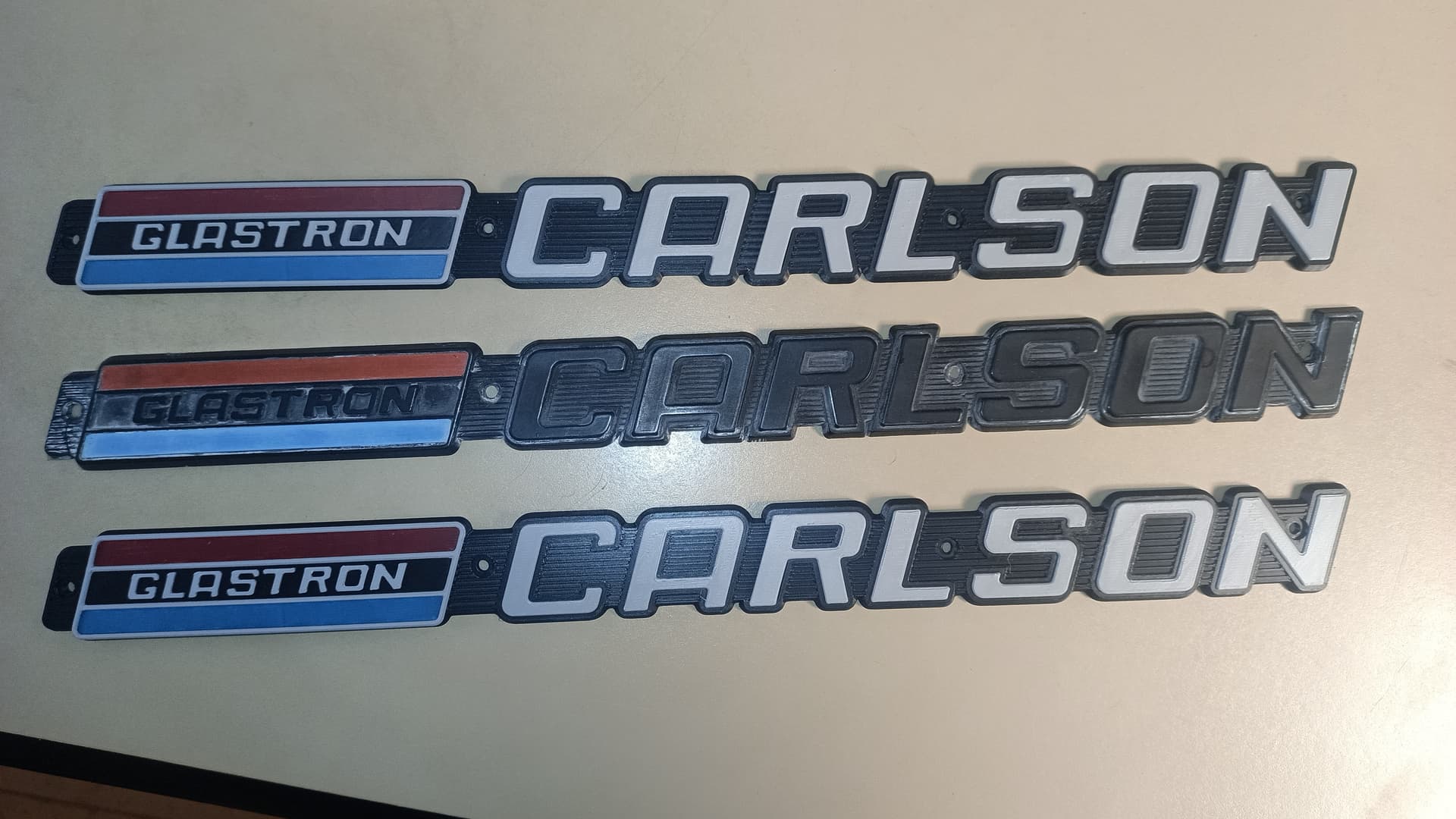

A matching pair done for the customer.
I think they’ll look good on his boat.
Thank you I tried hard to make this very close to the original with the chamfers, height differences and everything.

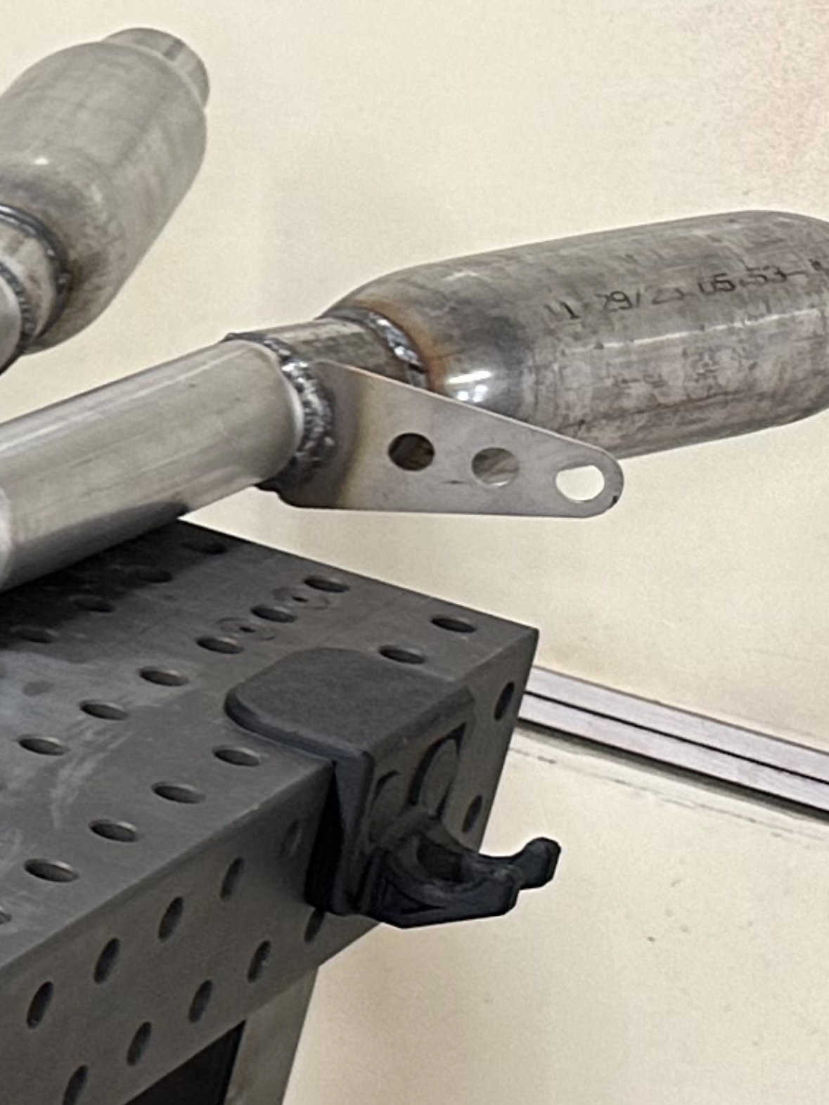

I ordered up a roll of that BL ASA-CF right before Christmas, and I’ve been printing with it like crazy.
Those of you who watch my videos may have caught a glimpse of this TIG torch holder I made from it. It holds up just fine to a TIG torch that’s hot from AC welding at 210 amps.

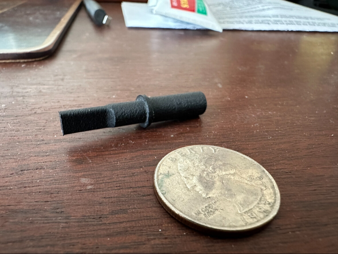

And believe it or not, I actually have it surviving inside the transmission of a 90’s Subaru as the speedometer drive coupling (which failed in the factory pot metal). I used the ASA-CF because I had no way to machine the required 0.100”x 0.400” blind square drive hole to correspond to the cable end. This is an example of the part, though I ultimately re-oriented it in the optimal direction.
That said, I am quite impressed with its Z-axis flexibility. These little tabs snapped instantly when printed from PLA+:
I’m VERY impressed with this material. It is extremely brittle (past a certain point), but I’ve printed 90% of the roll out of the AMS and haven’t had an issue yet…
What joint?
clap
Layer lines 90* to direction of load applied.
Tricky with cylindrical parts that need to be dimensionally accurate, Sticks. Though, the speedo drive adapter I 3D printed as a long hexagon laid on it’s side, which allowed it to print in the optimal orientation and without supports, and then I chucked the hex up in my lathe and turned it down to my diameter spec. And like I said, that part is surviving inside a transmission, cost 10 cents, and took less than 15 minutes to machine.

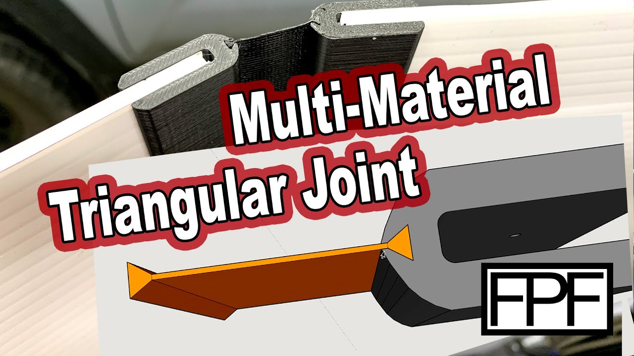

Very cool video on a live flexible TPU hinge for 3D prints.
Pretty clever!
Some take-aways:
  1. Good solution for printing the TPU flat on the bed
  2. Designing a brim piece vs. having an automatic brim that is difficult to clean out later
  3. He is quite the talker!

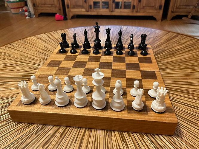

I made the board/box with my laser. I wrapped it with veneer so you can’t see the laser cut joints. I dipped the pieces in acetone to make them shiny. Another fun project.
That’s really nice. How many extruders does it have? Mine’s a dual but I can’t put out anything like that.
That Tandy shows his age lol. Looks like my 286.
Only one extruder nozzle. It has a AMS automated material system so I can feed 16 different spools in my printer. It takes some time and there’s some filament waste with the exchange between one filament and another but I have been happy with the results.
Those are some nice chess pieces and board. Some kind of laser cutter engraver is one of the next maker toys I’m after.
