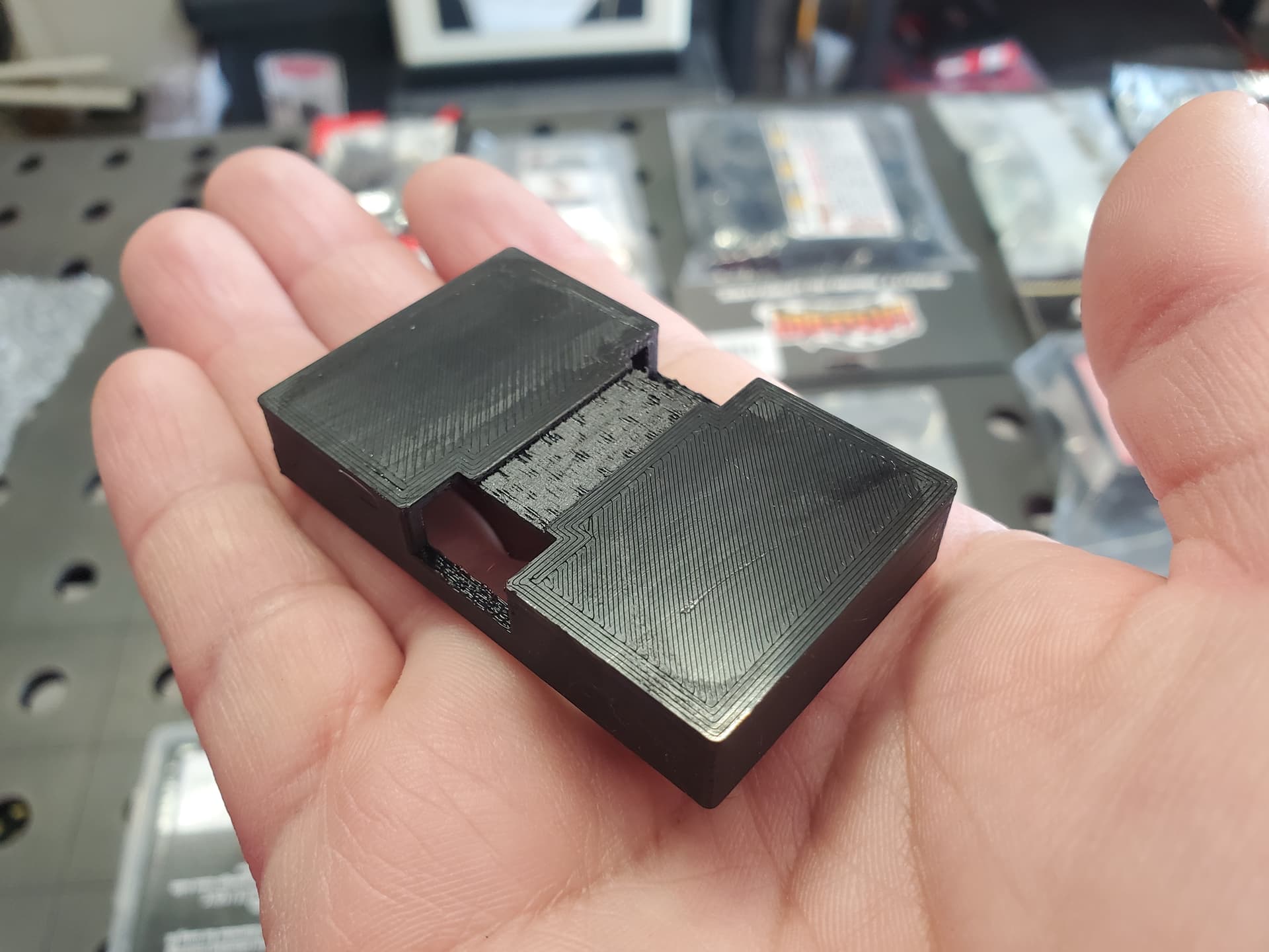

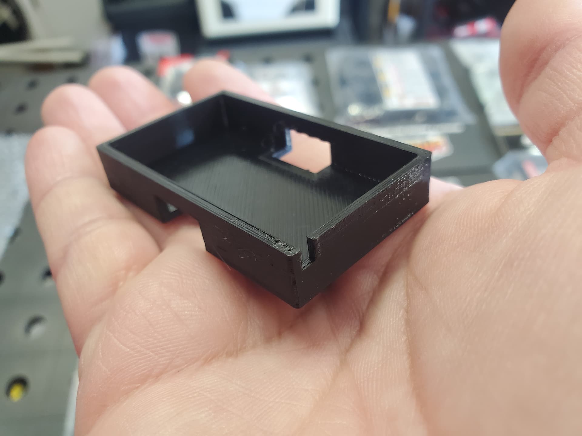

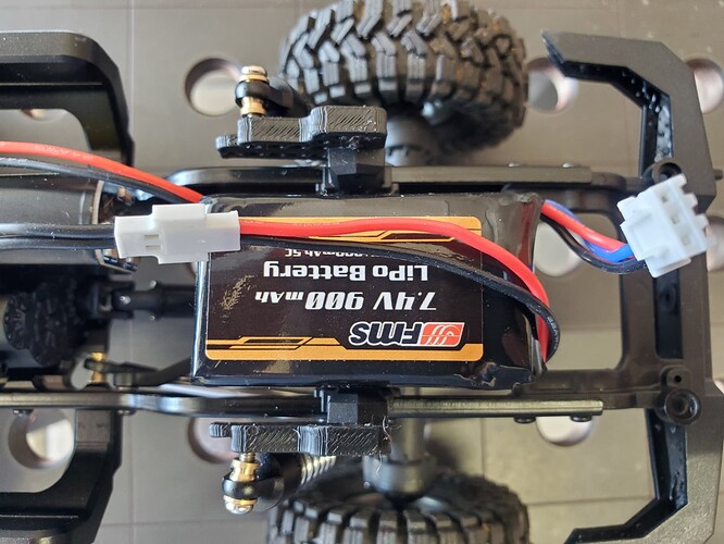

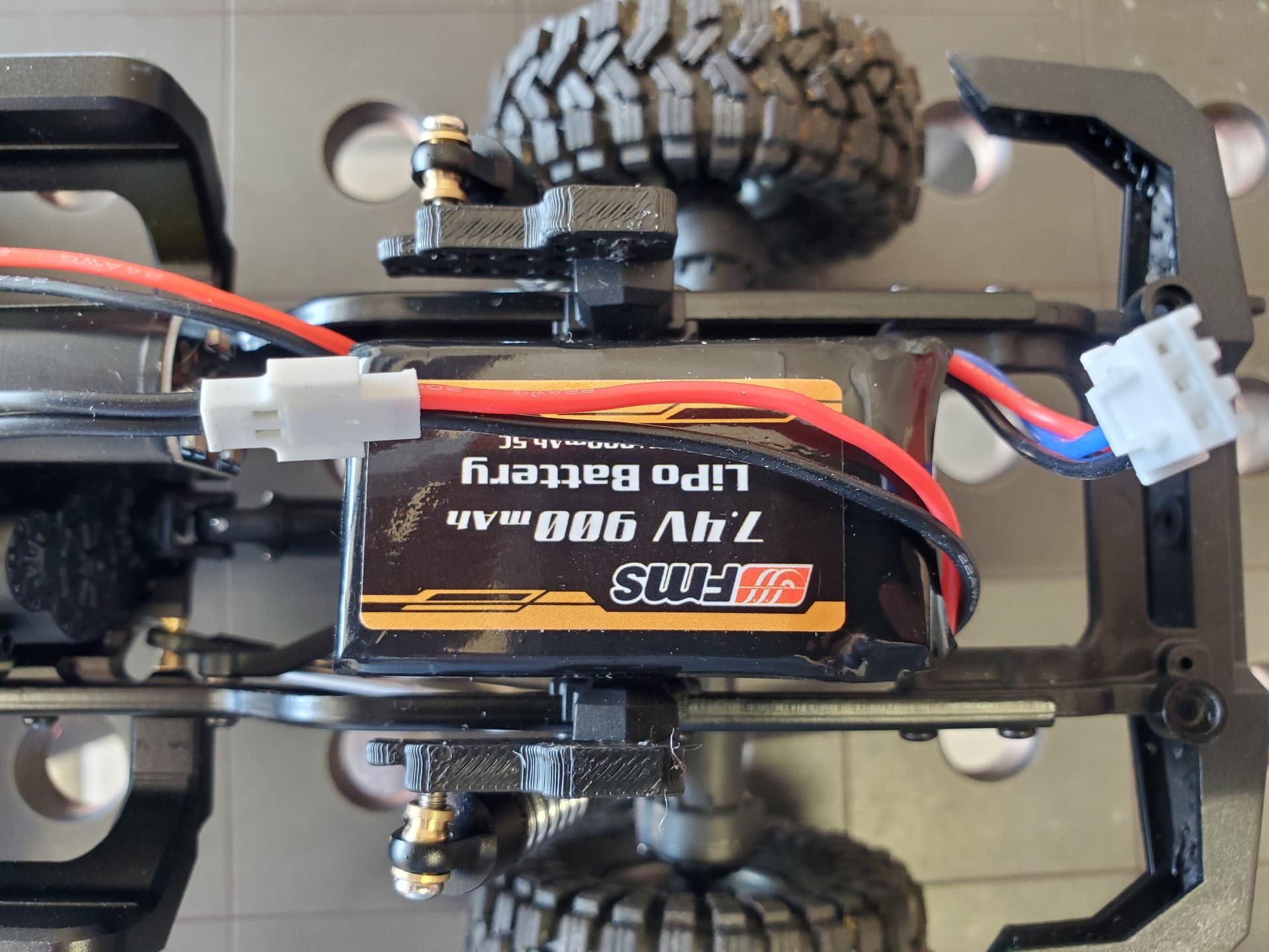

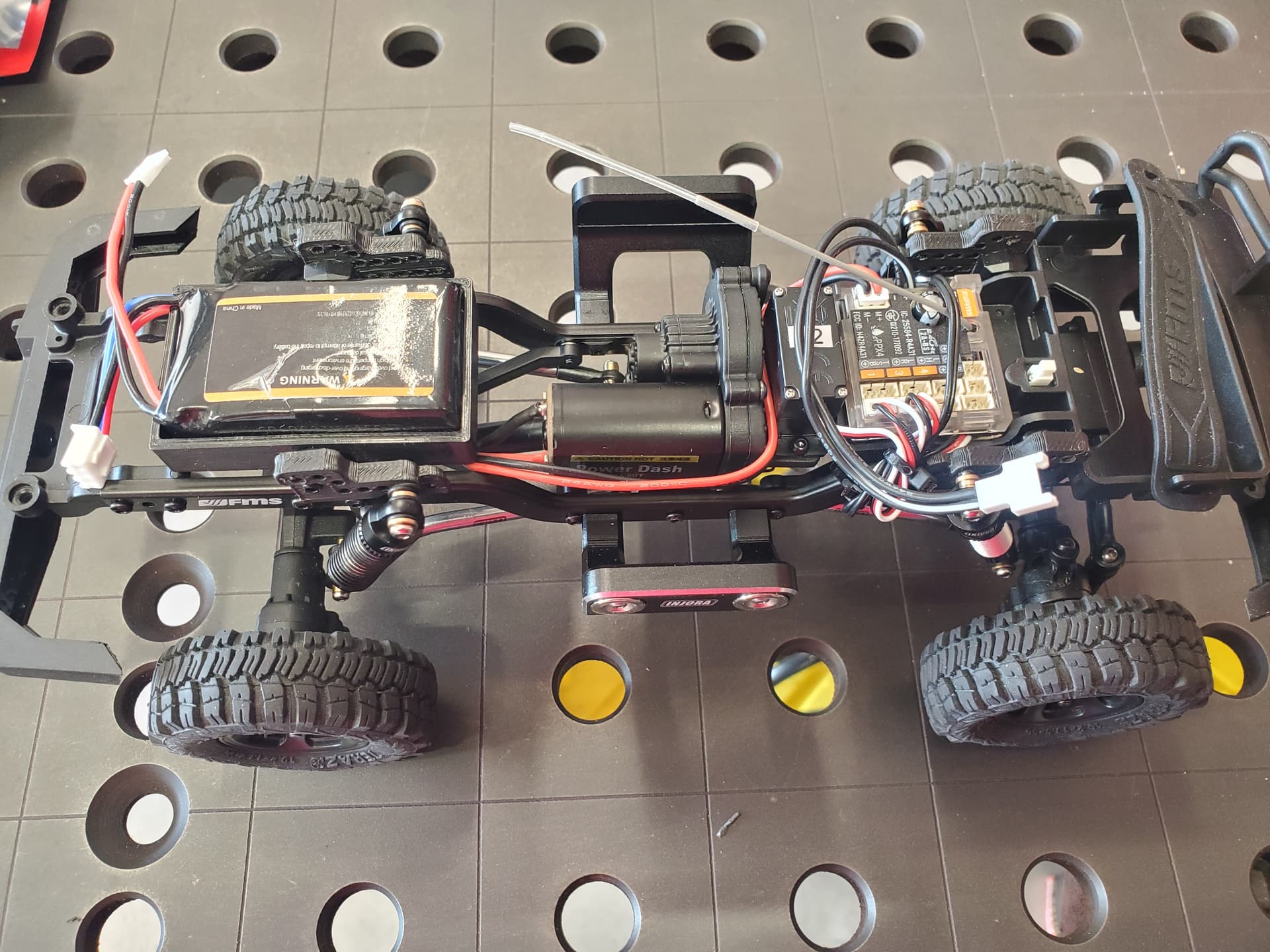

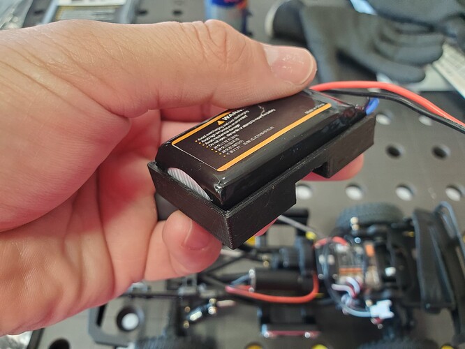

The item is an RC battery tray.
It is for relocating the battery to the rear of the vehicle between the shocks for better weight distribution.
Below the battery (held by double sided tape) is a crossmember between the frame rails, hence the need for the slot.
Got it all figured out though.
Thanks for the tip on adding strength with the fillets @ChelanJim
Glad to help…if I did. You had it already figured out before I got there!

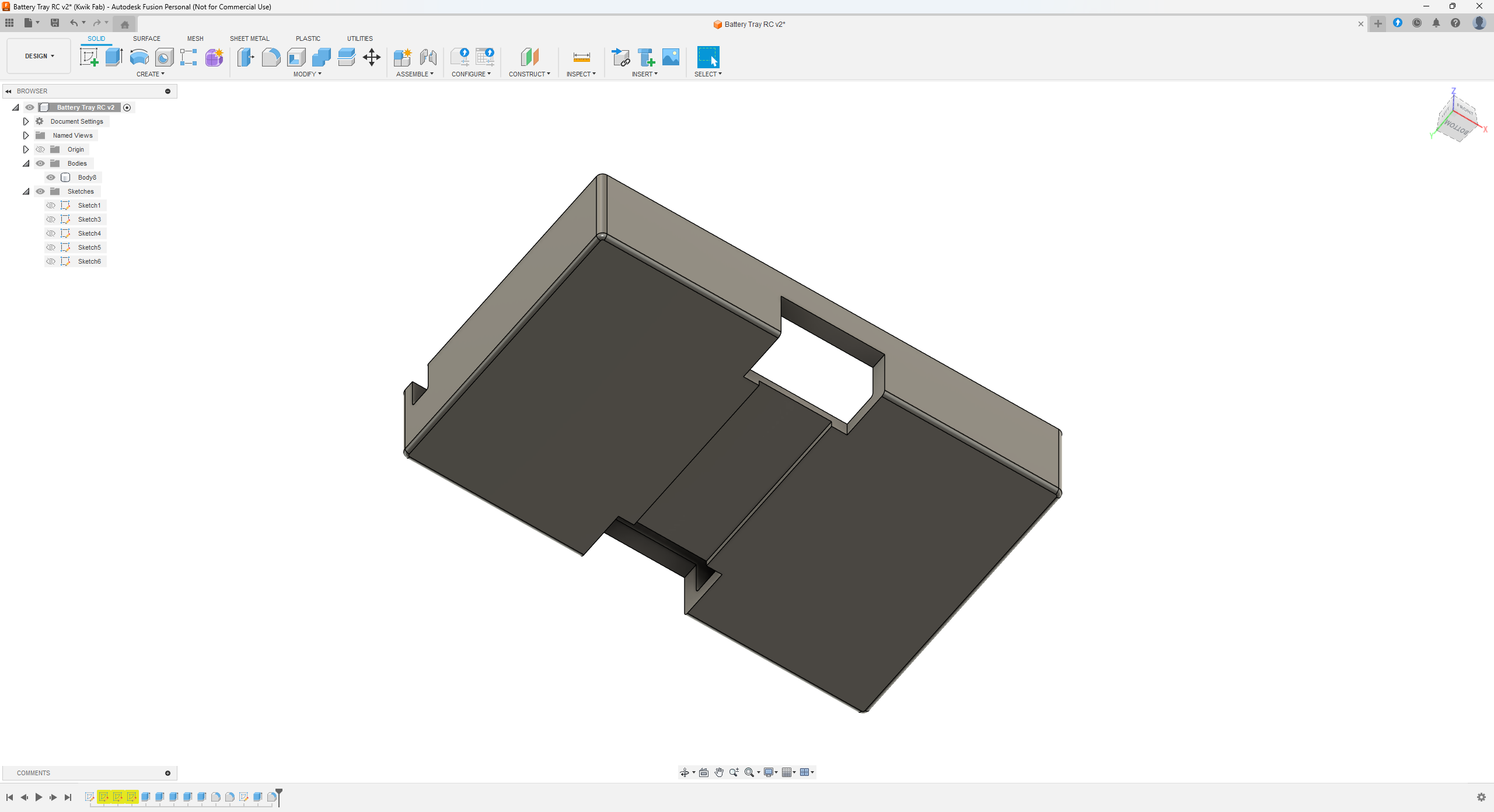

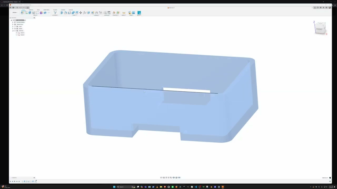

No problem. If you’re used to designing in 2d, it takes a while to think in 3d and use other planes.
here’s my kwik box
Jim showed me how the shell feature works, didn’t know what it meant!
The walls being a different thickness was on purpose but you are 100% correct that I did do a few sketches and extruded each one. And yes the fillet was done on the sketch. But the bottom and sides automatically joined to one body (I performed no extra action) so I guess I lucked out.
That mirror feature is going to be useful though so that’s new to me for 3D, but I use it often in 2D.
I don’t deal in 3D modeling so I thought the way I was doing it was a ā€œhackā€ job. I didn’t know I accidentally performed the process correctly as I’m not afraid to go into Fusion and spend time messing with multiple commands.
But the goal of my question was ā€œwhat are the proper stepsā€.

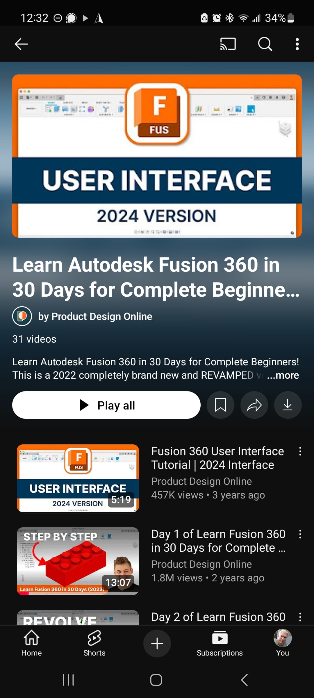

Super informative video though for sure so thank you for taking the time to even do that - the 3D advice is lost on me though as I’ll never 3D print. :rofl:
It was only after Jim gave me some specific advice about strength and wall-thickness (this piece is only 2.3" x 1.3" or so), that I gave up some interior volume to thicken the walls.
Ended up redoing it and it was like a 5 minute ordeal. I knew I came to the right section to ask about 3D solid objects.

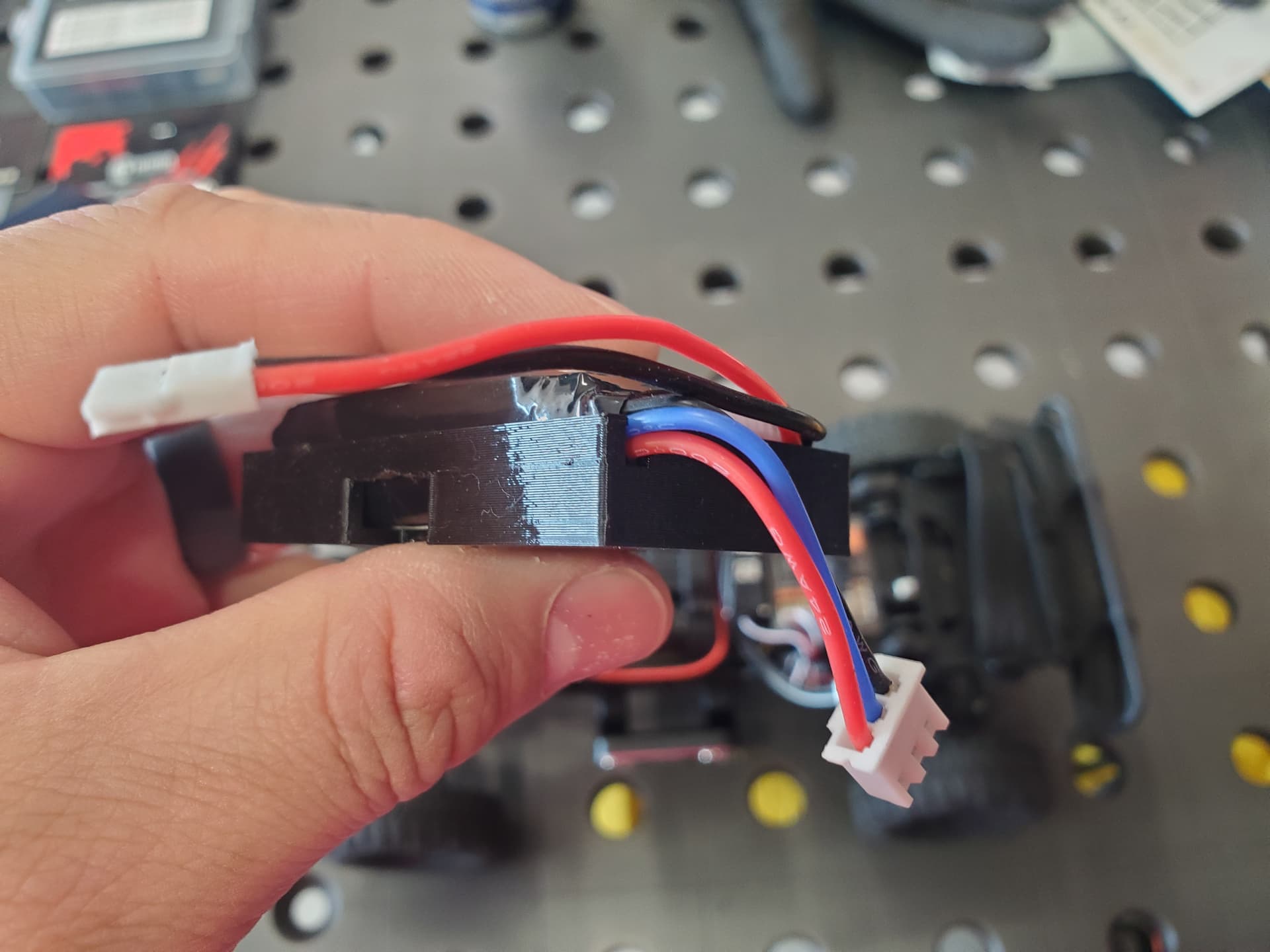

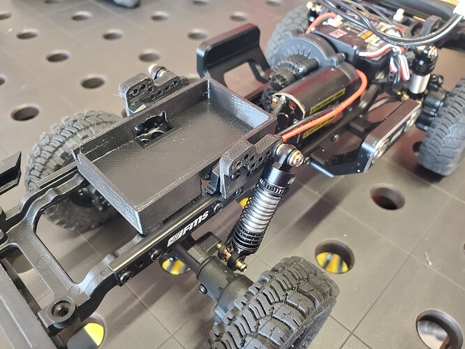

Part arrived!
I had given him absolutely no instruction other than ā€œmake it solidā€
Came out perfect, naturally since I use calipers for measuring shit :rofl:
Since I needed the clearance for the shocks, I opted out of drilling into it and instead used 3M double sided tape to hold it in place.
It’s a slow-moving crawler so it’ll last like this for years.
