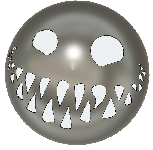

This is exciting:
I thought you were going to do something like this:
But I realize, that might be scary for you to have something like that looking at you. You are probably not as used to it as we are. :stuck_out_tongue_winking_eye:
this is lovely.
Who is to say whether my face is round or spherical. I don’t picture it as an evil pac-man, more nebulas.
Here is some avatar lore
"“‘Well, I’ve often seen a cat without a grin,’ thought Alice, ‘but a grin without a cat! It’s the most curious thing I ever saw in all my life!’”
I do appreciate the the used of a quadball form with the emboss tool.
I went old school revolve and the extrusion cut. (maybe that is ‘new school’, don’t know which came first :man_shrugging:
I was afraid that “emboss” would look distorted.
Emboss:
Extrusion cut:
