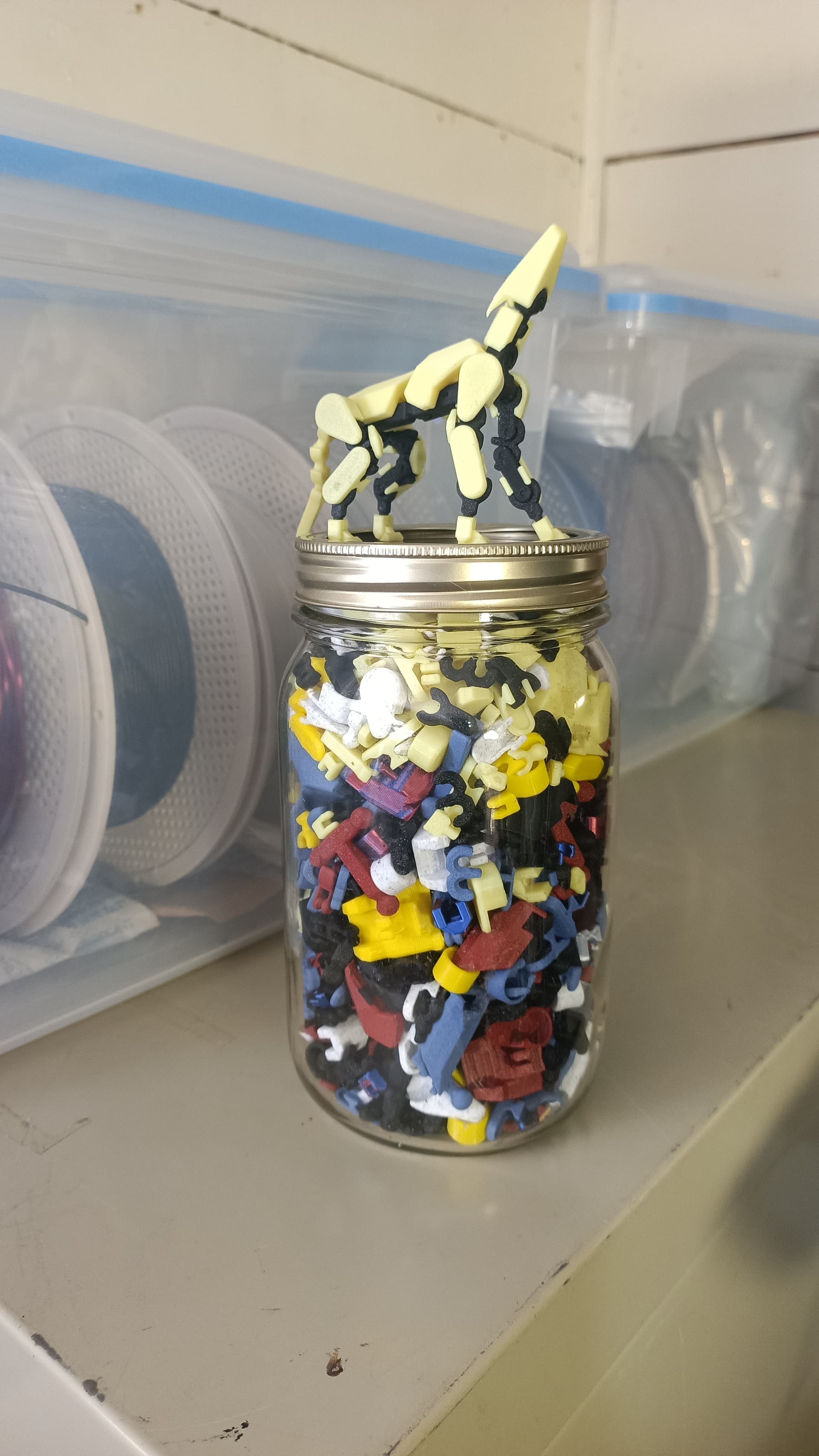

This dog print which matches the dummy 13 print is very good and I highly recommend it.
Printed a ton of them in different colors. One of these nights I’ll sit down with kids and build.
PLA-CF or PLA for the armor and PLA-CF for the skeleton.
https://makerworld.com/en/models/222834#profileId-240877

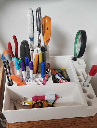

I am currently in the middle of a 23 hour print using .94 kg of filament. This is a storage/organizer for my wife. (scissors, seam ripper, glue sticks, etc)
The first attempt a corner started lifting up. Redesigned so there was room for a brim. So far, so good with 4 hours and 19 minutes to go.
That seems heavy - are you doing it with 100% fill? It seems like the walls would be sturdy enough with a 10% full and way faster.
25% infill with 4 walls inner/outer.
Perhaps I could have reduced things but my wife is rough on things sometimes. :grimacing:
Edit: Finished

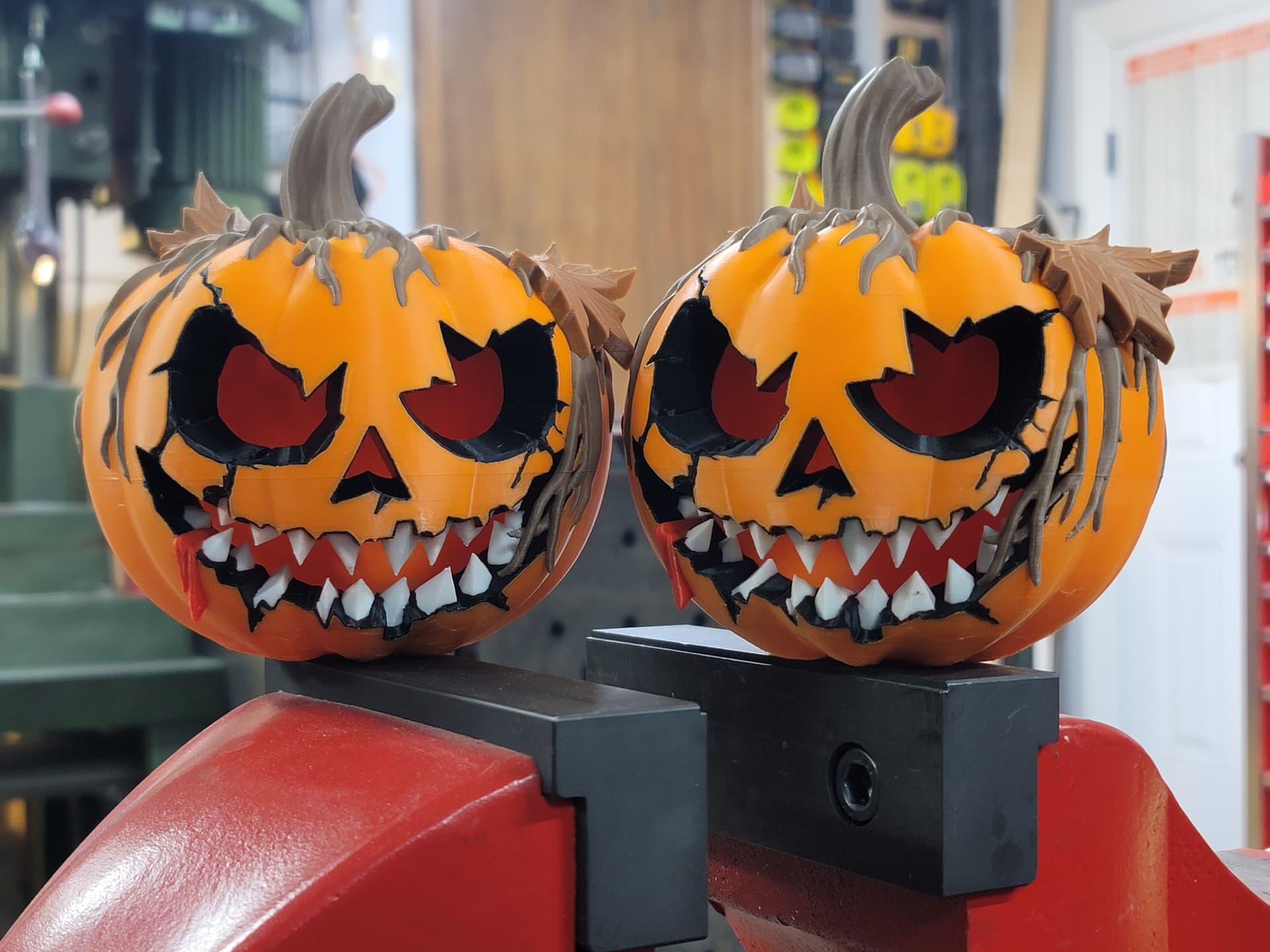

Printed these. Model is from Makerworld, and then I spent a fair bit of time getting the color painting in Bambu Studio done and clean enough. 3-1/2 days to print 2 about 6" in diameter on a single plate. Took a while to get them both to fit along with tree supports that could reach in through the mouths and eyes to support the inside roof.
For the keen eyed, I bet you can see where the machine switched rolls of orange filament.
Thanks alot Henry…Now my wife wants me to print that :roll_eyes:
EDIT: I don’t have any orange filament!!! :rofl:
And, I don’t know where I could possibly get any before Halloween!? :man_shrugging: :smile:
Bambu usually gets me filament within about a week when I order from them. I’ve been mostly printing with their filament to keep colors in the AMS units organized. I got a second X1C last week with the AMS (and an A1-mini for me/my son), and I had one already with 2 AMS units. With up to 16 spools to track its nice not to have to remember to set the filament colors 90% of the time.
I actually printed them for my wife. :joy:
Her office does a pumpkin carving contest every year and she asked me to do it for her this year. I figured no one else would be entering a printed pumpkin, and it sounded cooler than carving up a small pumpkin.
Everyone that’s seen them thinks they’re awesome. I’ve already rated and boosted the design on Makerworld.
I was teasing about finding the filament.
AMS: Yes. That is the way to go. I have two of them. I rarely need all 8 slots but it is great to have the replacement spools all lined up.
Yep. You picked a good one.
Never would have looked for it, nor seen it, had you not brought our attention to it.
I could not tell, but they look cool as hell, nice job

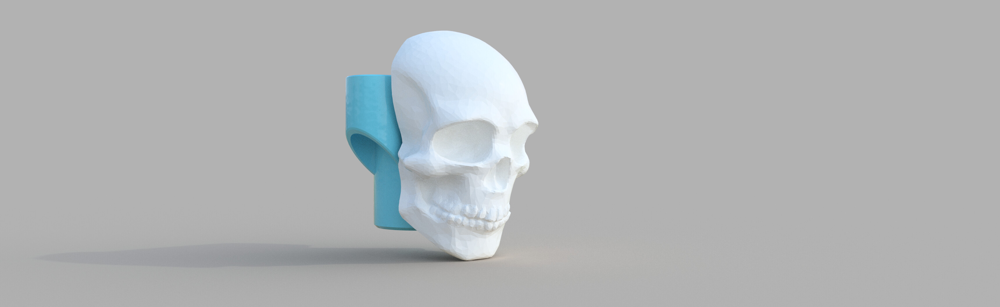

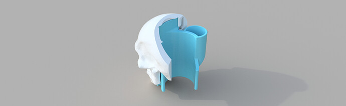

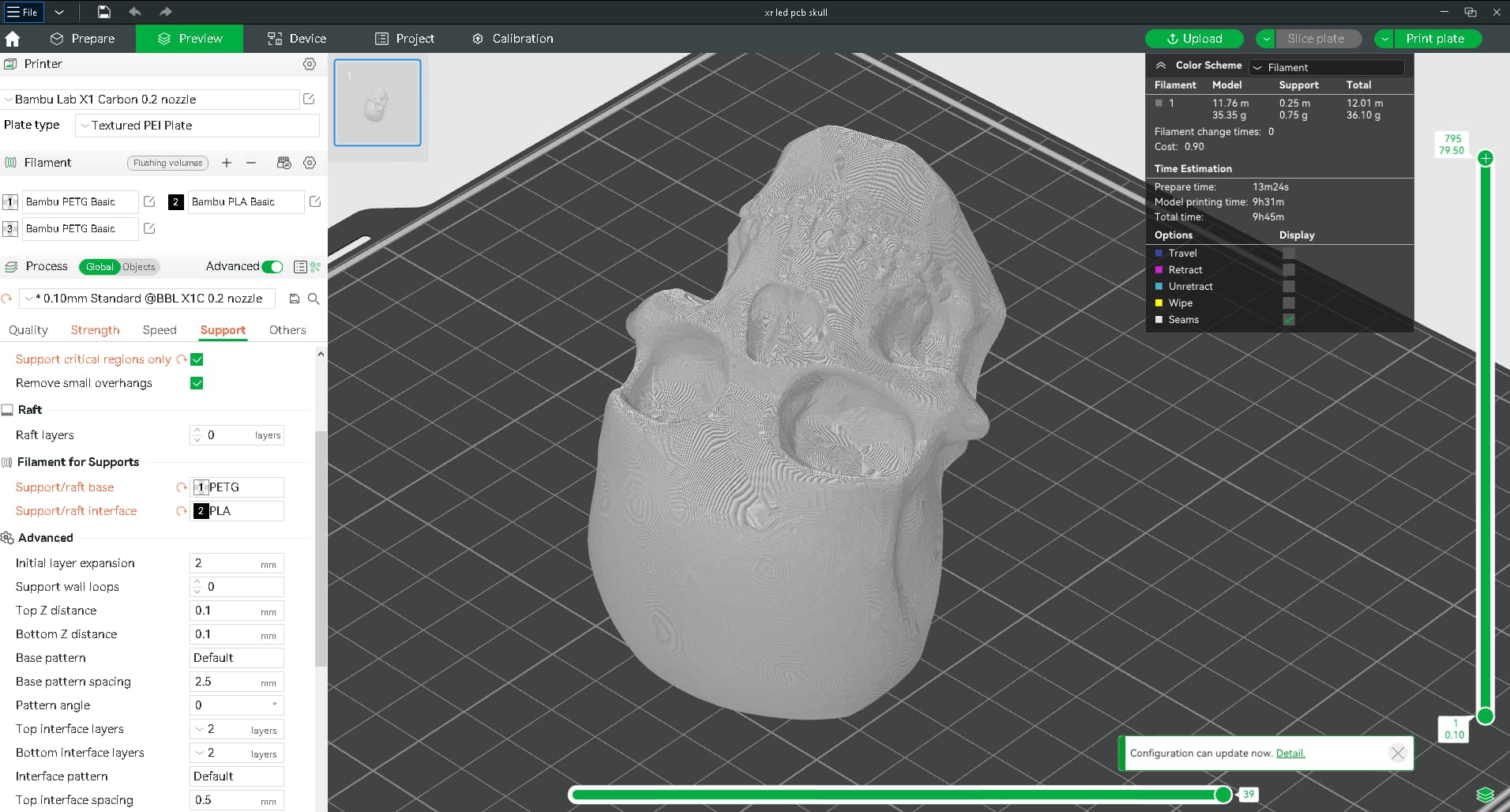

Working on a new revision of this .
Printing a prototype right now.
I’ll post results later
Now that would make quite the novelty knife with the skull at the butt end of the knife and the bolster have the skeleton arms crossed. Not practical at all but quite the spectacle.
Or the bolster could be the pelvis of the skeleton.
