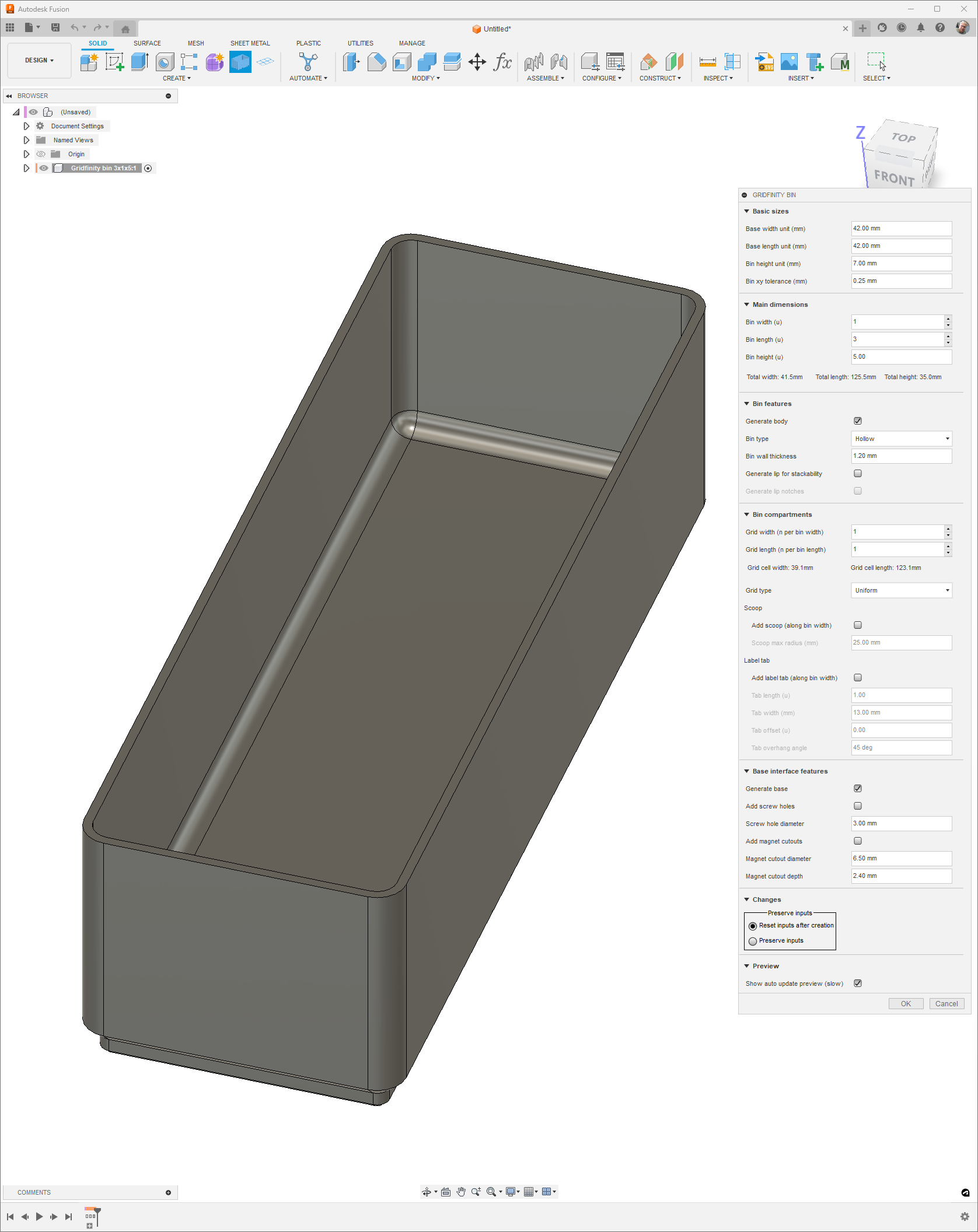

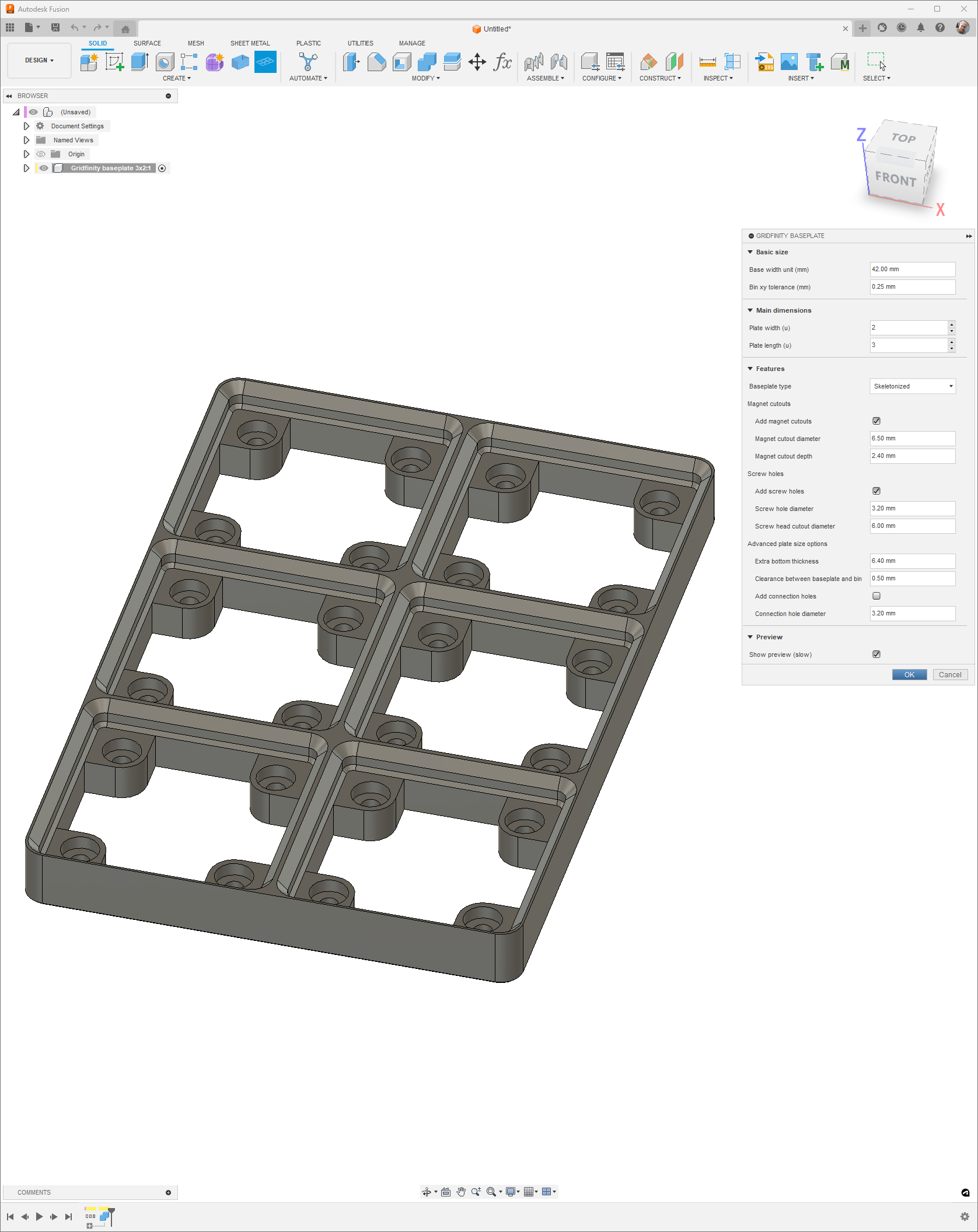

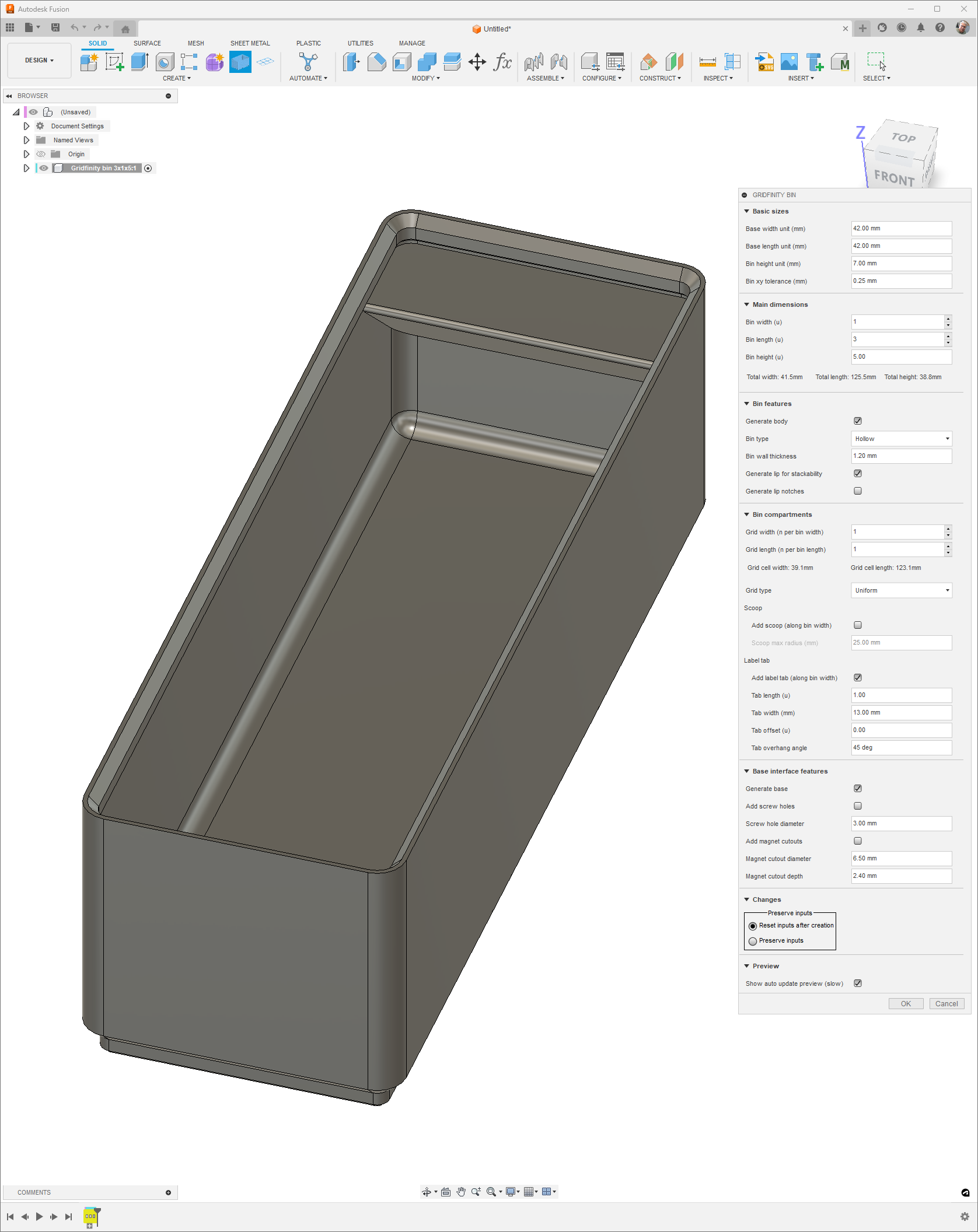

Learning 3D printing
removing lip
adding label feature
adding compartments
adding labels to compartments
skeletonized
skeletonized with magnet cutouts
skeletonized with magnet cutouts with connection holes

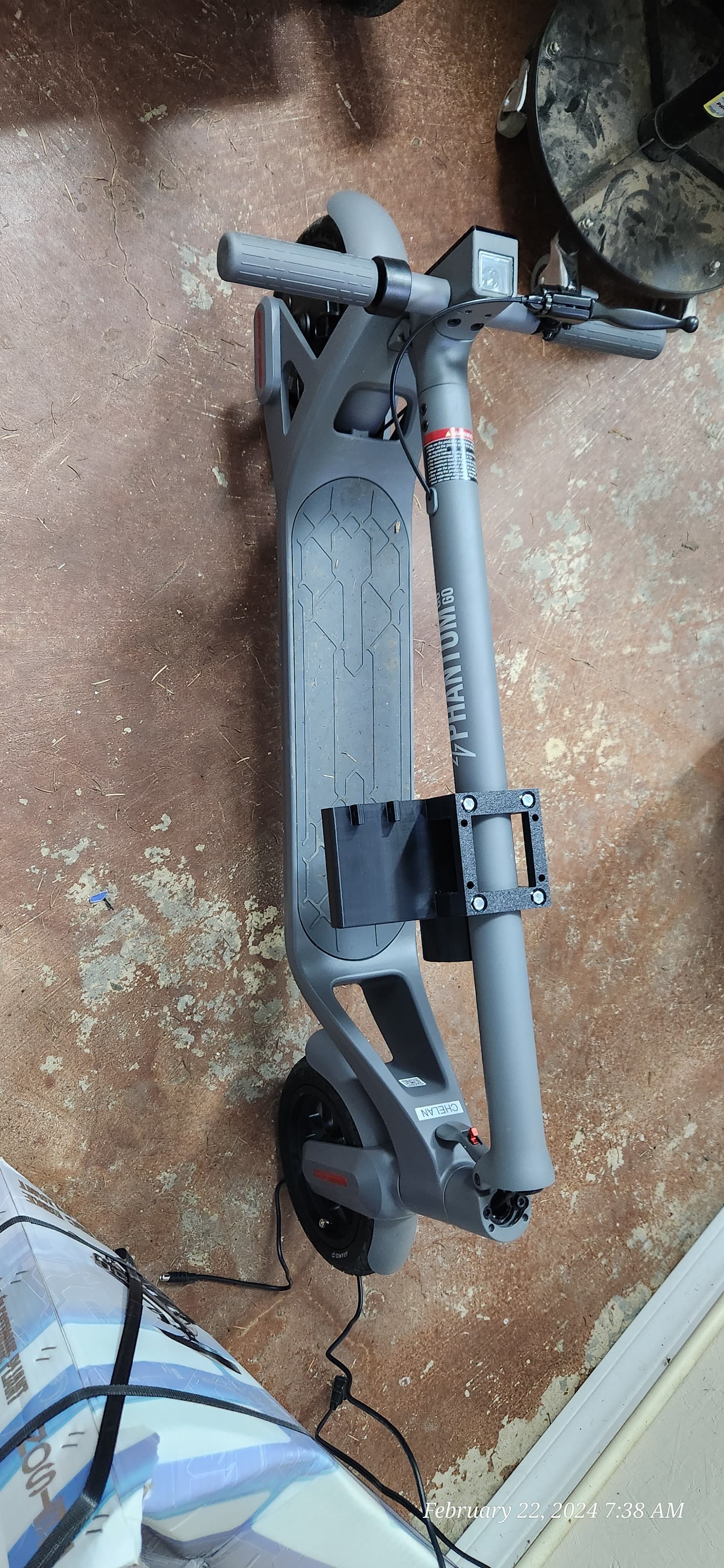

I just tapped some more last night with a printing of a water bottle/cell phone pouch for our scooters. Yes…they are for the road trip. And “Yes” that is the payback to wifey for agreeing to me getting the printer. You guys are so full of questions!!! :rofl:
Winner Dude!
I really like the nut insert in that project. Very smart!
It works extremely well but an interesting thing in my 1/4" nut assortment revealed a puzzlement. I had some normal size nuts that measure 7/16" flat to flat and I had some large ones that measured 1/2" flat to flat. I patterned the opening for the 1/2" which is too large for the 7/16" as corner to corner is about 0.55 inches. I am afraid that 0.05 difference is not enough strength with plastic to apply significant counter pressure. I can insert shims while tightening but that is old school.
As it turns out, I have a total of seven of the large nuts and needed eight. I will shim the eighth but probably use a square nut for that one.
I am not posting the plans online until I get a definitive nut size and I think it will be the square one because it measures that same 7/16 of an inch flat to flat and will be more reliable. I will modify the cut-out as well.

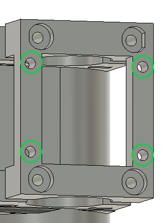

The front of that bracket has four holes. They are meant for adding a decorative plate later.
Scooter Pouch3

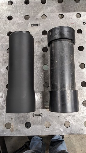

I wish I had thought of 3d printing the caps for my TIG filler rod storage rack, before I spent way too much on 2" ABS caps and unions.
I didn’t like the look of the ABS caps, so I decided to design one and 3d print it. I’m much happier with the look of the new caps. I’m hoping I can find another use for the ABS parts.
I posted the cap on Thingiverse here Thingiverse - Digital Designs for Physical Objects
