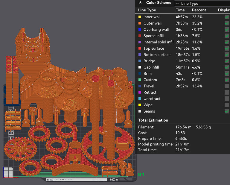

Here is the one I did:
https://www.printables.com/model/407688-bambu-lab-p1-x1-x1c-x1cc-filament-spool-switcher-w
OMG @lumberjack, I never thought all of this could be printed at one time. Perhaps too advanced for me!

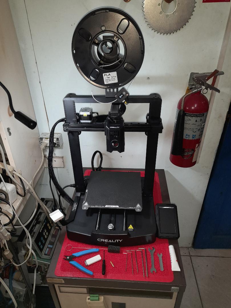

My Ender 3 V3 KE is on the truck and should be here in the shop within the next hour, I’m pretty stoked! I should have ordered the Nebula Camera at the same time, but ordered it a day later.USPS sucks, that cam won’t be here for another week or so.
how does this machine handle PETG?
I downloaded and installed Creality’s slicer last week but it keeps crashing going to black screen and locking-up. So I downloaded and installed Orca which looks pretty decent.

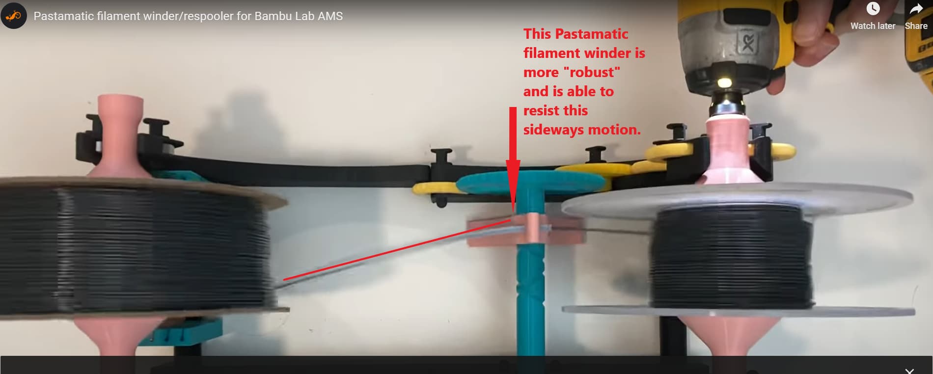

I have had to abandon my classy looking filament rewinder spool. If you look at the filament tracker (or whatever it is called) it is only sitting in a tray with very little stopping it from popping up and out of the tray. If the filament is lined up well with the donor spool, then no problem. If it gets sideways, and it will, then chaos occurs!
I am now printing this model as recommended by @lumberjack.
