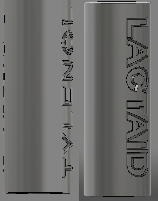

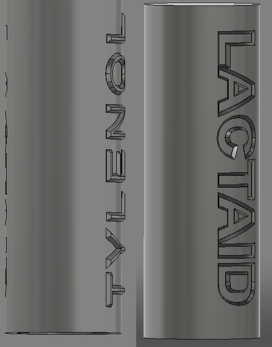

I saw that. I have a couple other ideas I might try first. I would be interested in yours or others opinion of whether you think these letters stand a better chance. “LACTAID” in recessed and “TYLENOL” is raised. All of the edges are chamfered all the way around.

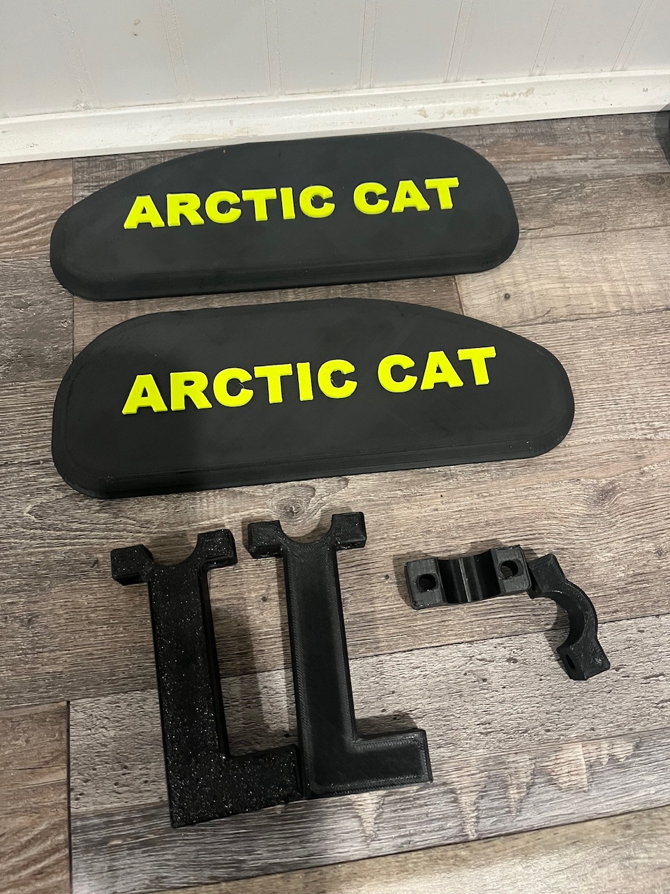

You’d be surprised at what kind of overhang will print without support. Every one of these printed without support. Like Don said, failures are still learning. Print it and see what happens.

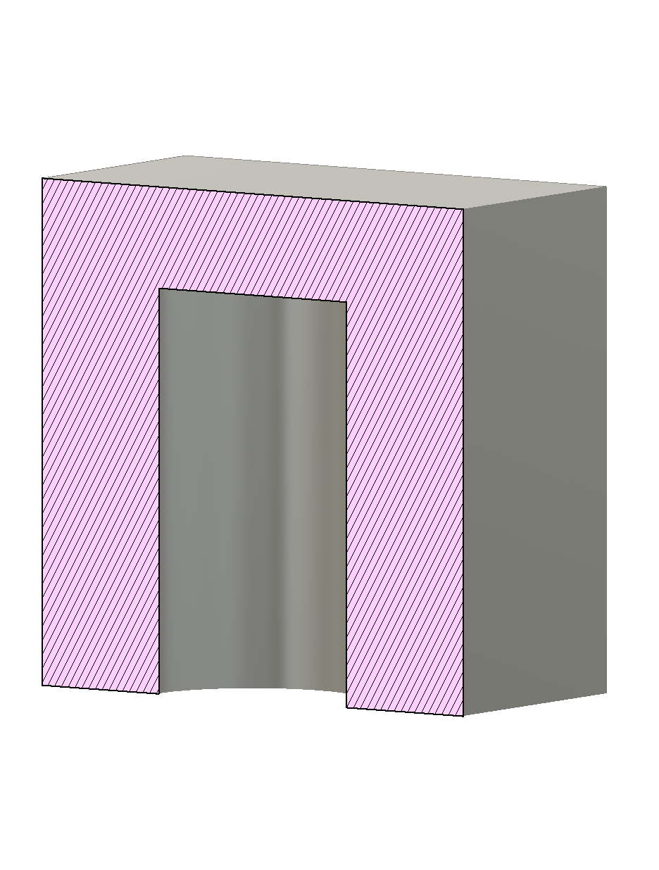

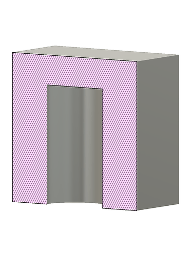

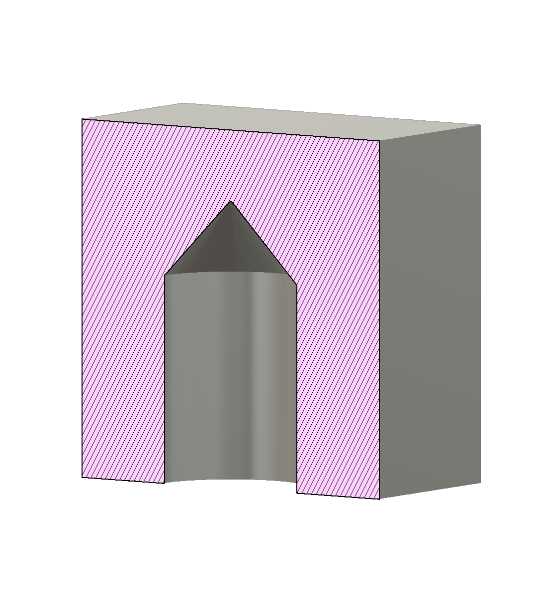

here’s a tip to avoid support inside a hole with a top. Add a chamfer to the inside creating an internal cone which can easily be printed because overhang at 45deg.

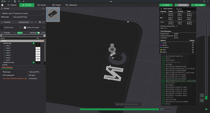

Here’s how to change the filament print order in Bambu Studio, useful for multi-color prints.
This is slice #1 for an enclosure with white labeling. You want to print the base color first then the lettering.
To change the order, click on the gear icon next to the build plate.
I’ve printed a lot of stuff with lettering raised on the sides of cylinders. You just can’t raise it too much. I believe I’ve done .040 or so without problems. Just do it, and see what it does rather than overthinking it. You’ll learn what you can and can’t do. And I’m just using a 5 year old cheapest I could find Chinese 3D printer that I got as a thing for my and my son.
@DRotblatt @ChelanJim - That is the key, either the chamfer that you did, or as DR said, .2 to .4mm. My brain saw a large cylinder and proportioned the letters accordingly, even though you put the size down as a little bigger than a AA Battery, by brain said pop can.
