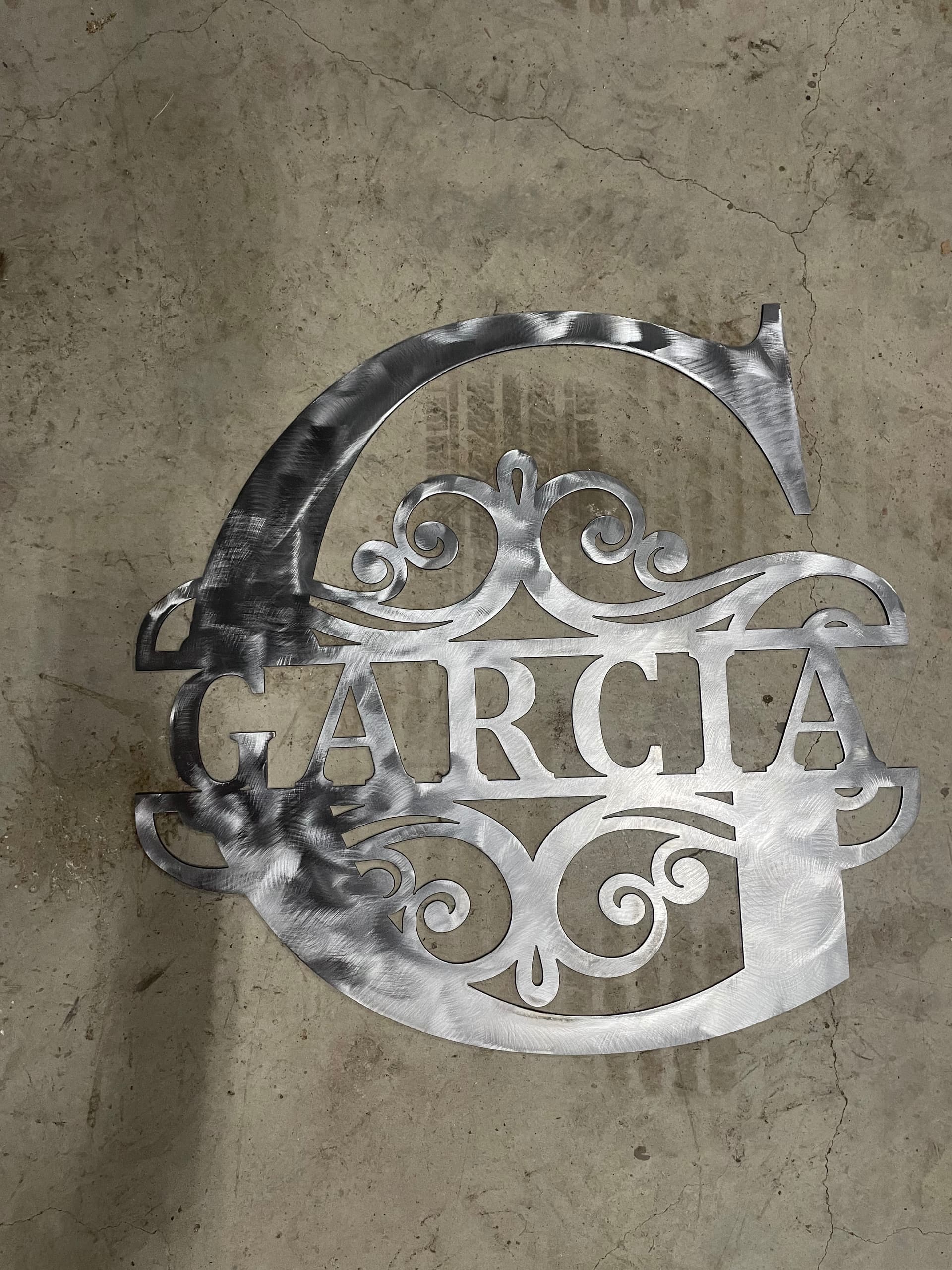

Jagged cuts on some arcs but not all - Solved

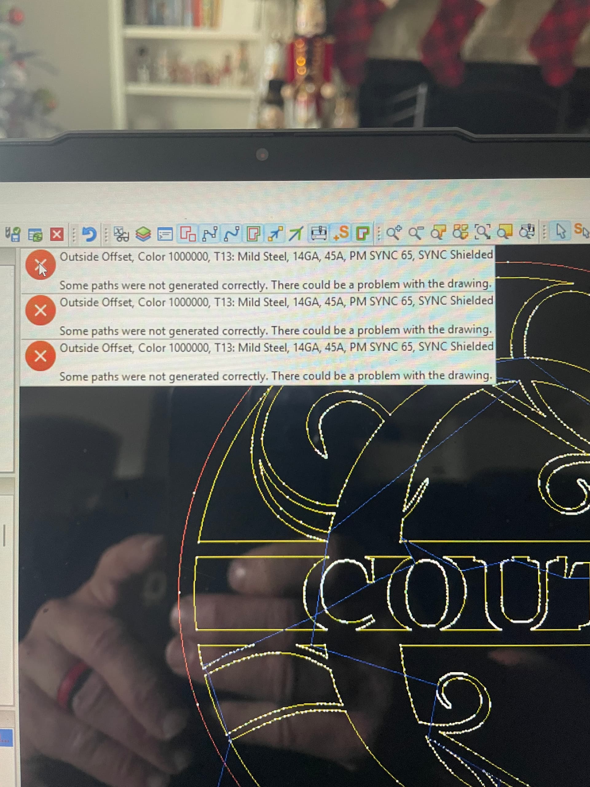

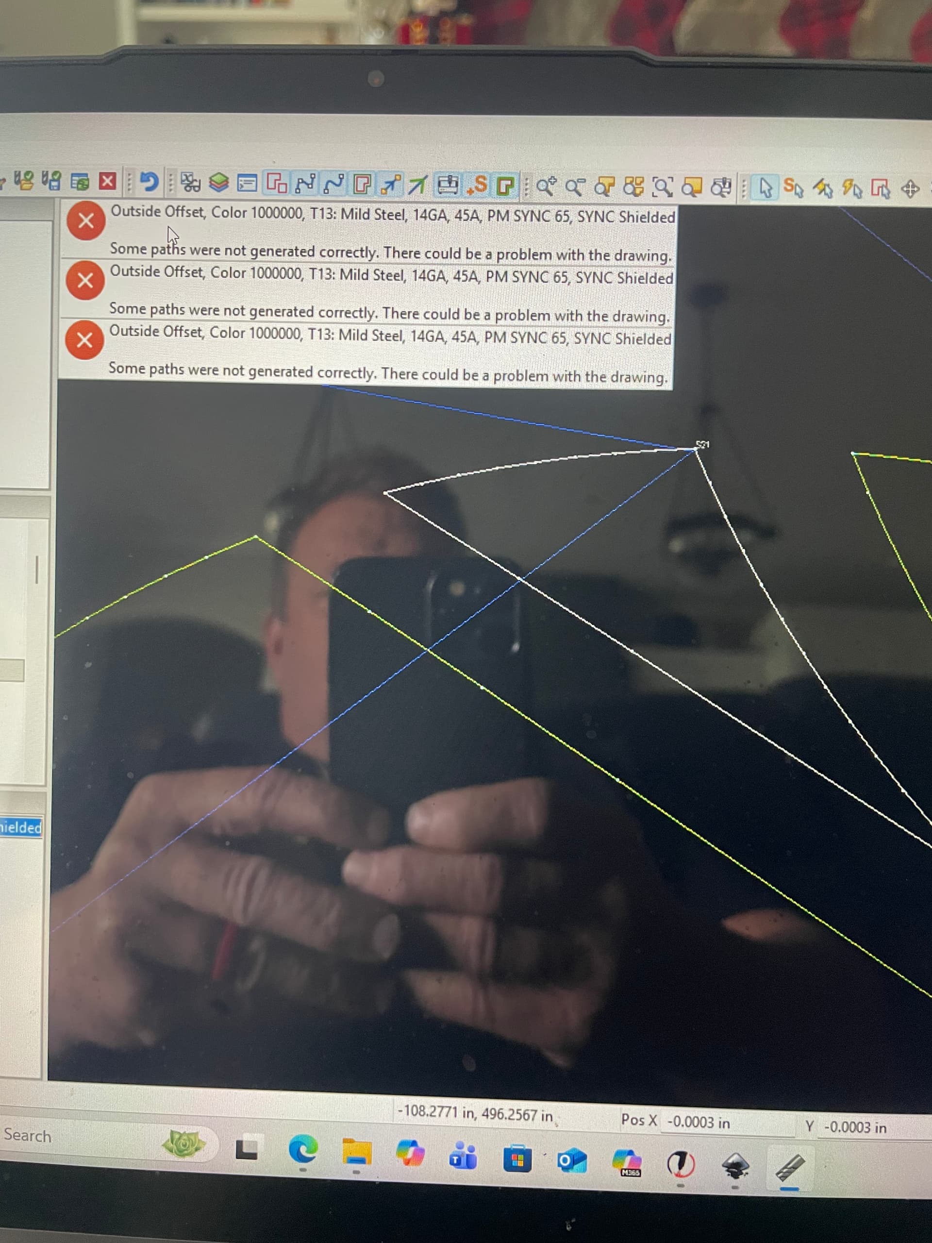

yours looks great. I obviously have a lot to learn, as expected. I went back to my files and re saved them as both plain and optimized svg files. Now I am getting this error message. weird to me, other than re saving, I didtnt alter the drawing.

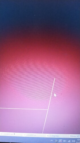

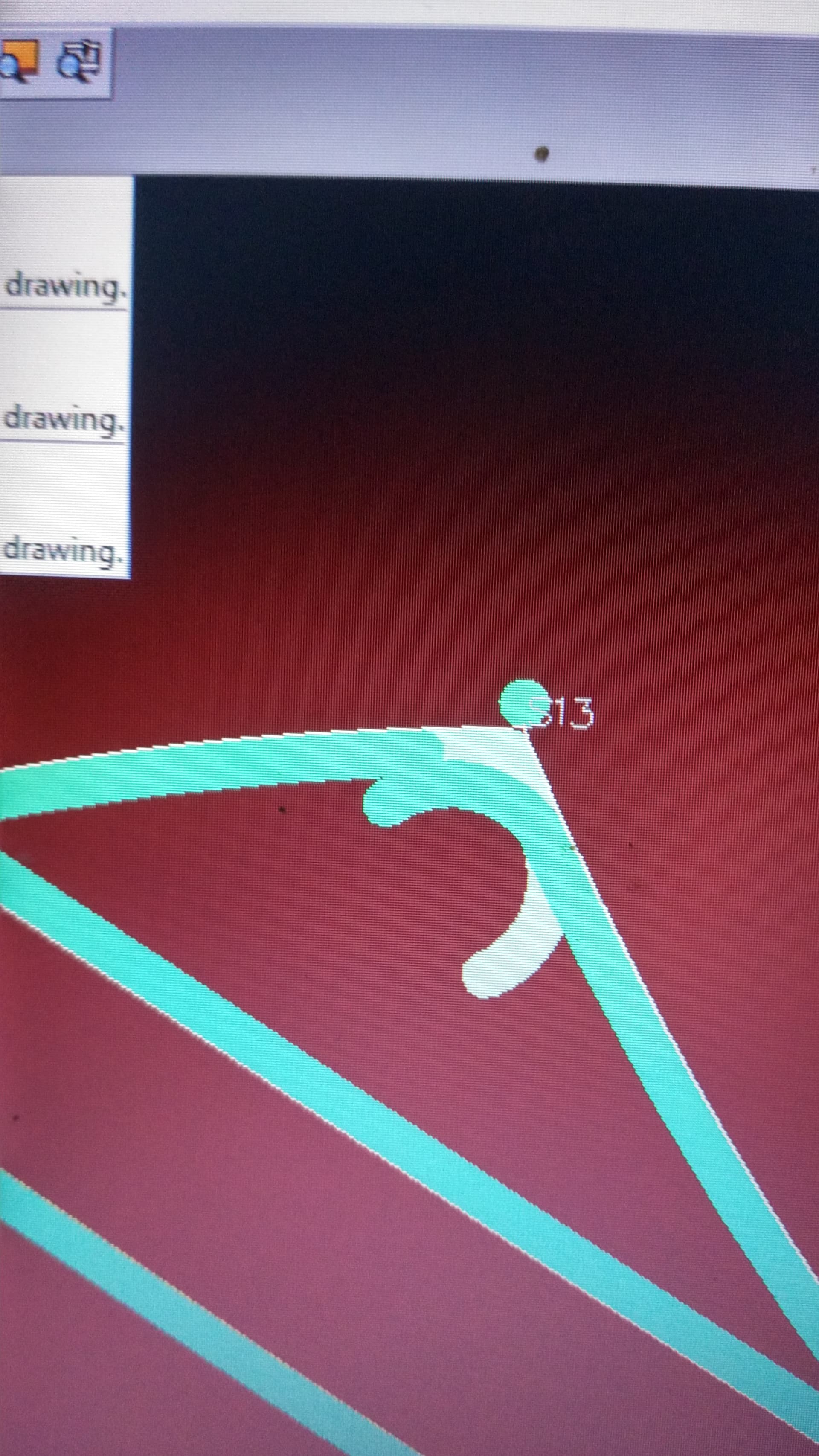

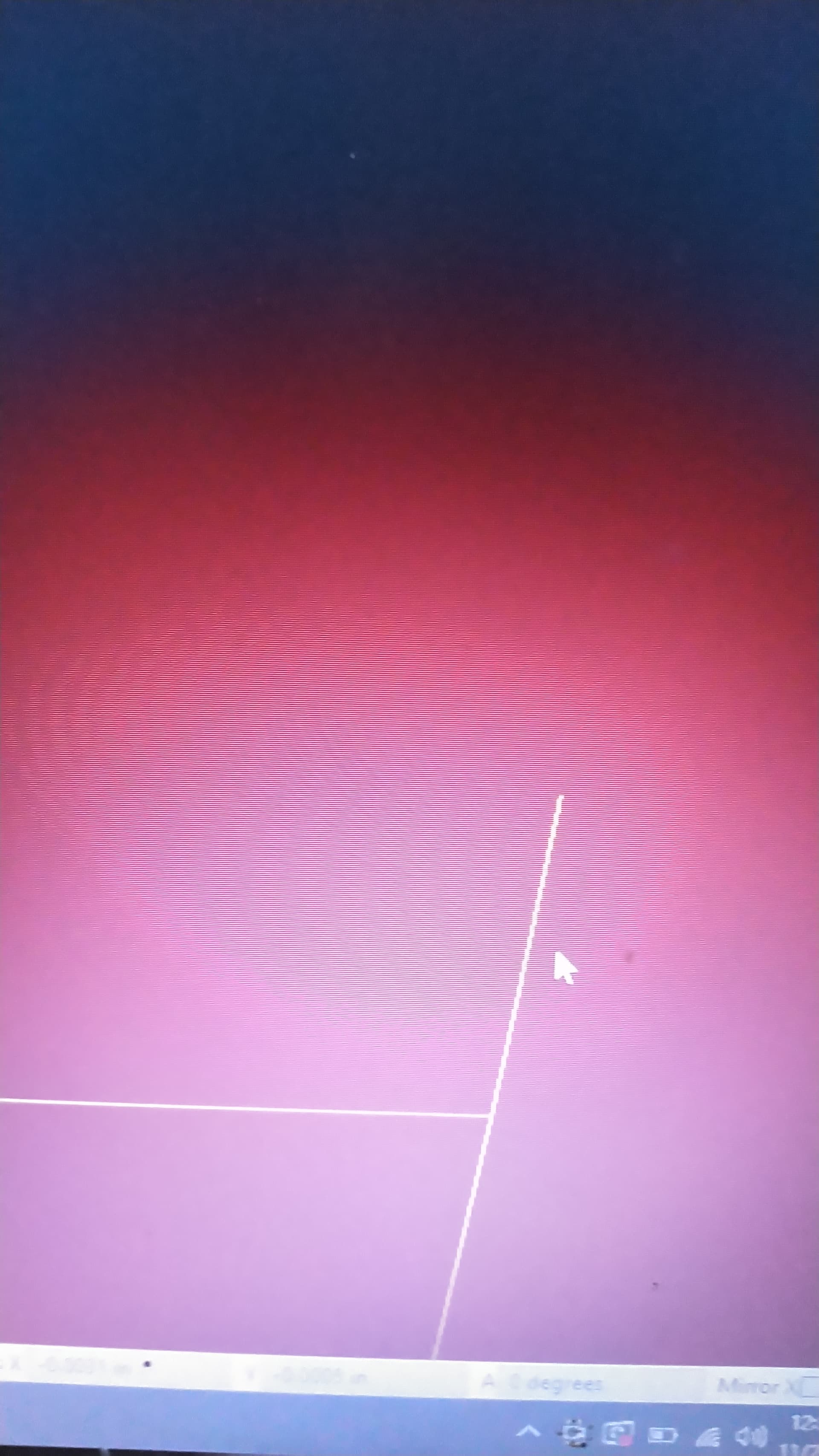

If you zoom in you will see a “overdrawn” place I have seen this several times before. Not sure if this is caused my a bad design or a conversion of format. When I “ simplified the drawing it took all out but one that I had to manually remove. Here are pictures of the same location.
ok, thank you. I tried the simplify feature and it completely distorted (changed) the image. I will start fresh and see if can put all the advice to play from the beginning. I think I may be creating issues using files that have been altered and re formatted many times. Not sure where you are located, but if ever in DFW area, I’d love to buy you a beer to say thanks
