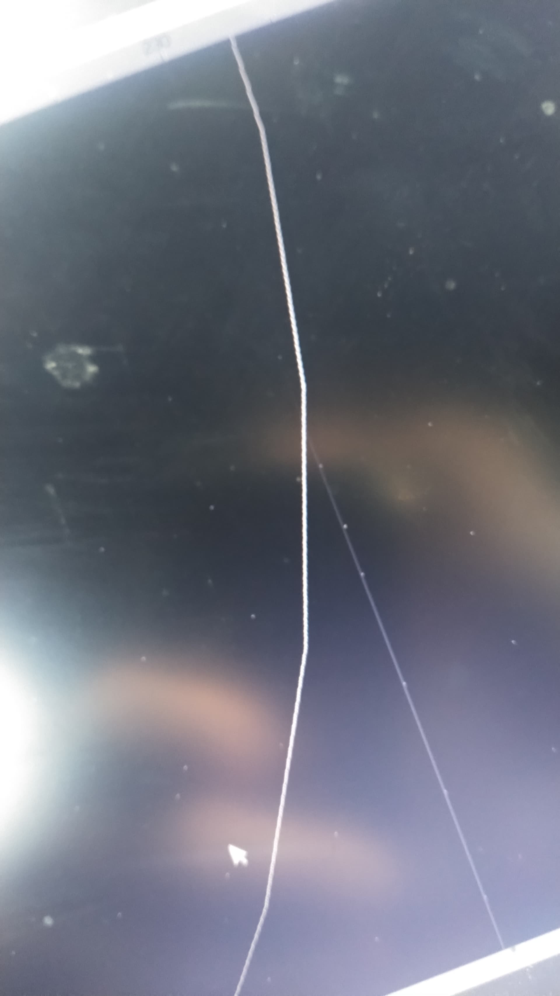

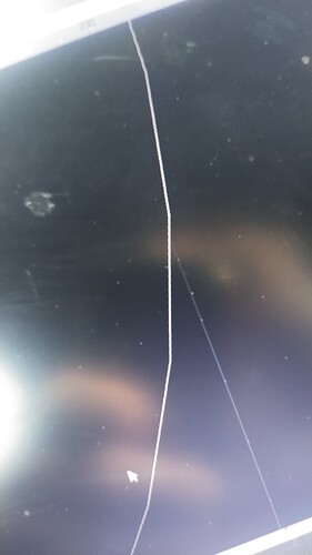

Jagged cuts on some arcs but not all - Solved
in Inkscape, these are not showing as nodes, so I am at loss again. Hopefully just a setting I am overlooking. Can’t thank you folks enough for the help.
The issue is importing a DXF vs an SVG into sheet cam. DXF files process curves differently than an SVG file. If you saved the Couto file as a .svg it will fix it. Save as a plain SVG in Inkscape.

The Brawley file looks fine to me but the Couto file is definitely the problem. This happens with converting and scaling from DXF to SVG and back and forth. It takes some getting used to. This is why I don’t like buying files. Always some massaging to do at scale. Sometimes you can rely on a smoothing option within your design program but not always. In Inkscape you’d highlight the nodes and, then go to path and simplify. That kicked it down to 4 or 5 nodes on mine. But I only use Inkscape to bitmap trace things. I use another vector program called affinity.

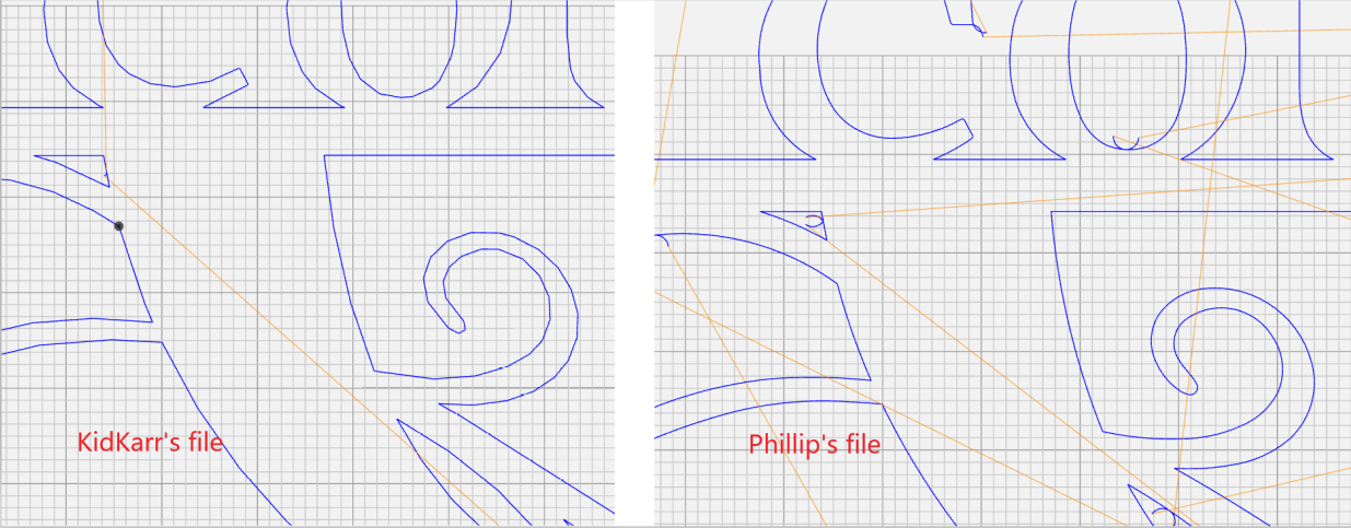

@Kidkarr @TinWhisperer i took a quick stab sure it isnt perfect but. here is a svg and a .tap. see if this looks better seems to on my end.
couto.tap (30.3 KB)
couto

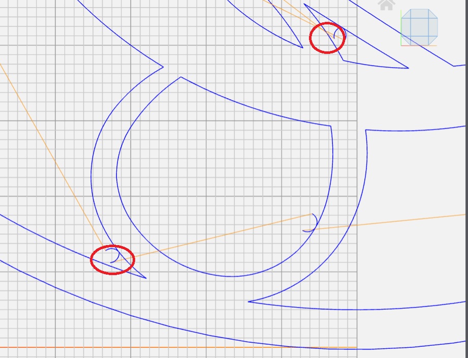

Looks good in NCViewer other than a few areas where the lead-in/out is pretty close to an edge. Here is a shot from the 7 o’clock position:
Yep I was more concerned about the jagged cut. I would certainly move a few of the starts if I was going to cut it. I did run it through my” artsy “ program it has a simplify feature that reduces nodes.
I also noticed in the original file that it had a lot of loops in the corners that wanted just to pierce a hole. I should have screenshot it.

Give the svg I posted a gander. It may not be perfect.
I recommend playing with the original its good practice.
That looks great Phillip:
