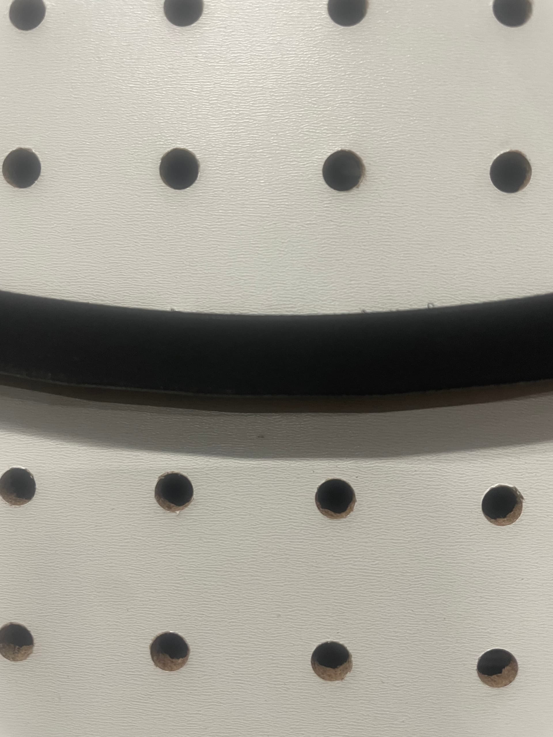

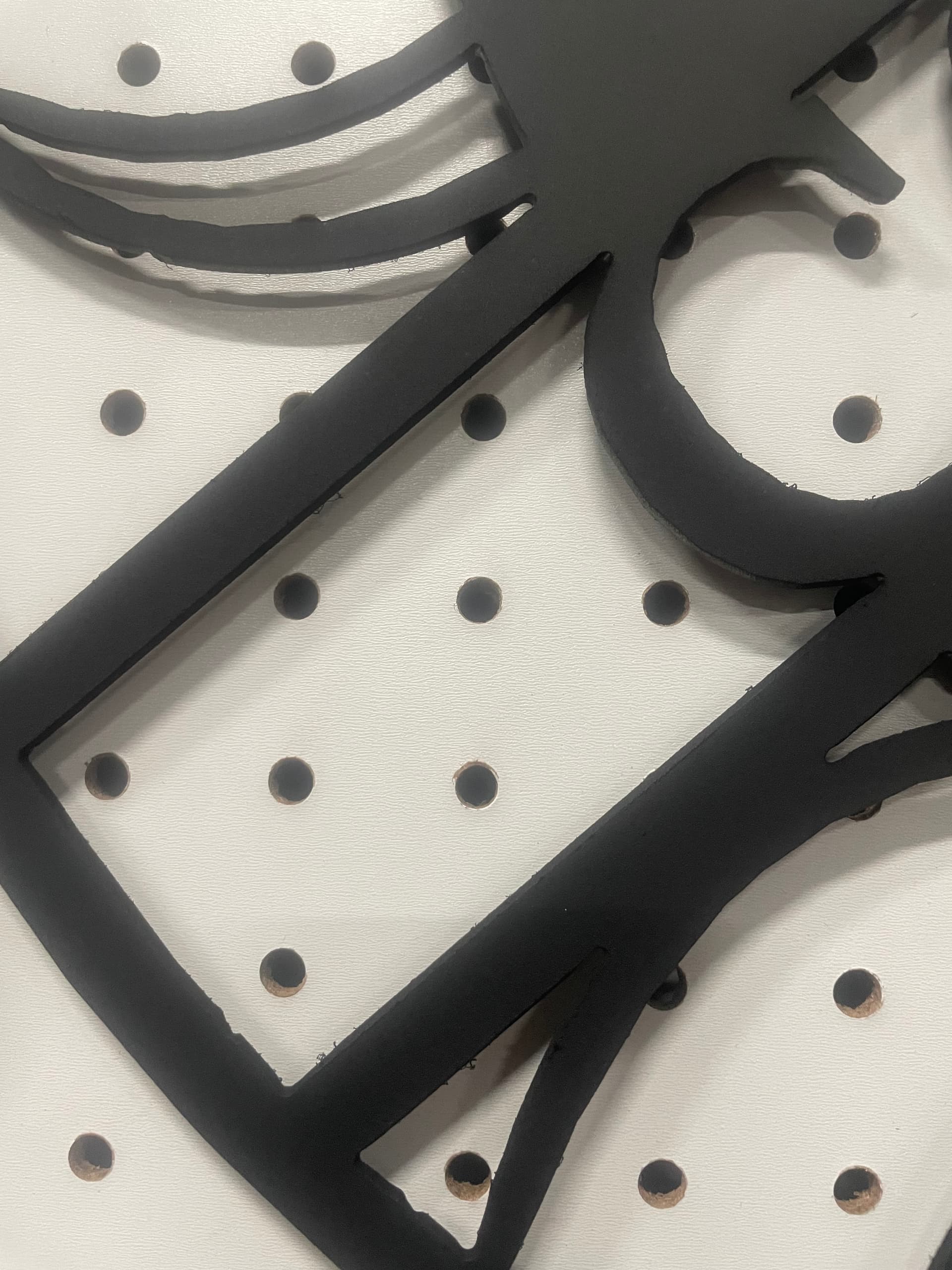

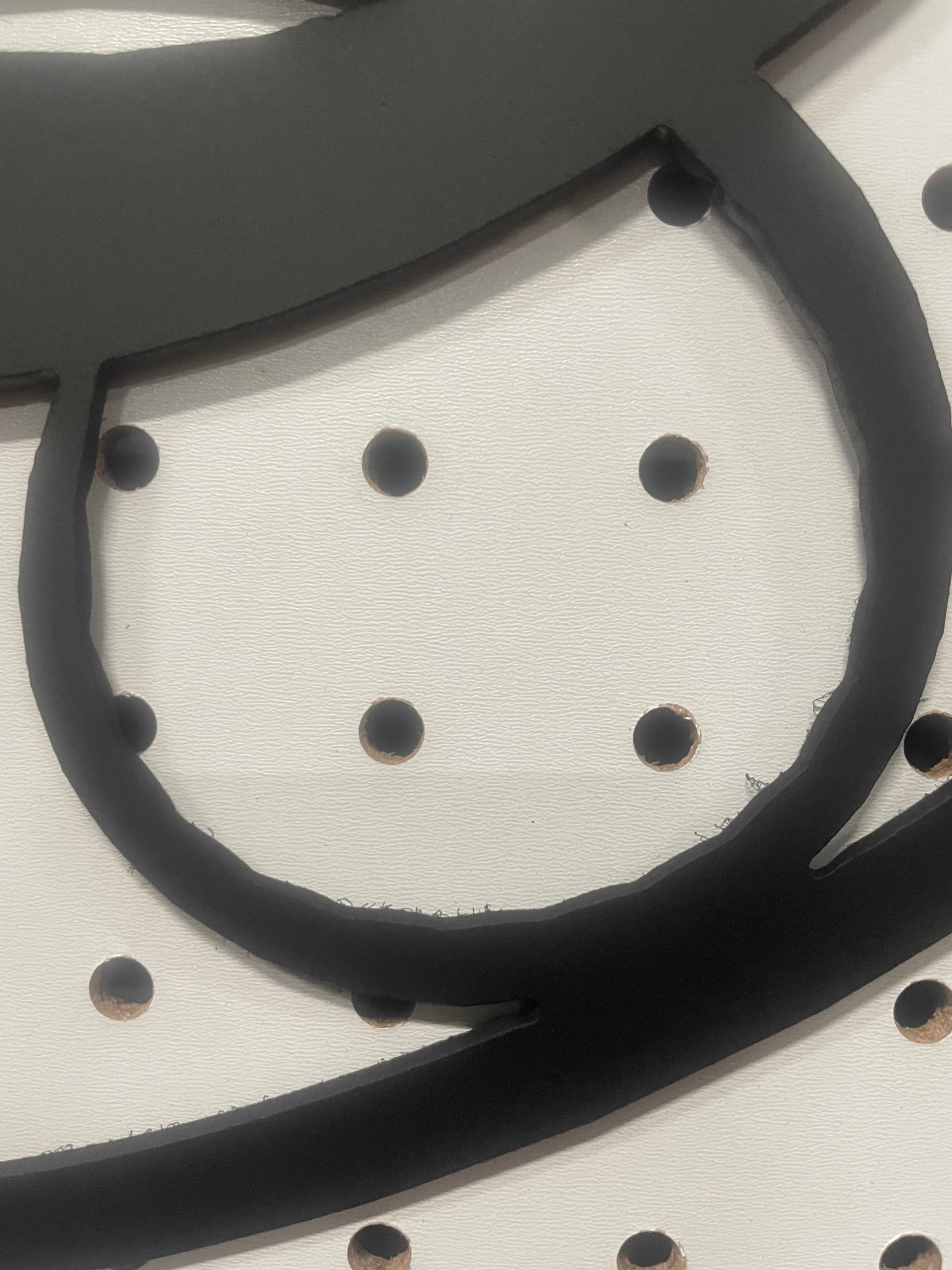

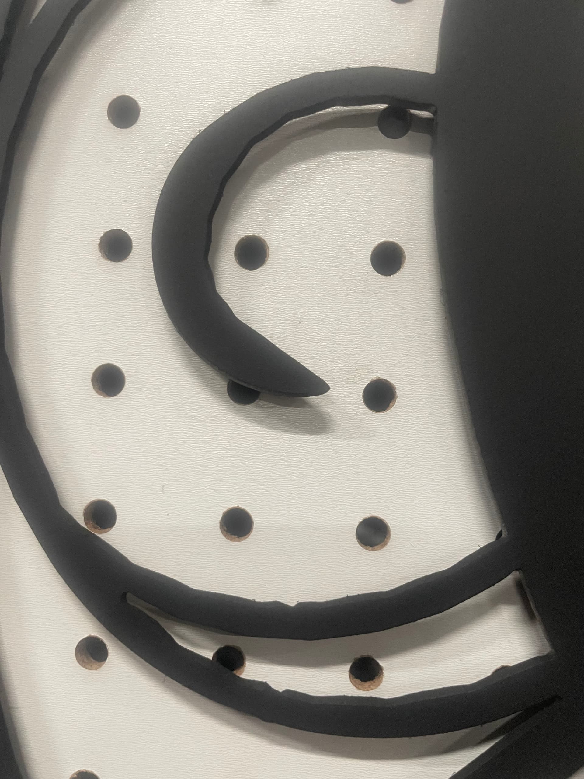

I am getting rough or “jagged” cuts on some arcs/curves but not all of them.
I have a crossfire pro table with THC
Hypertherm powermax 65 sync using 45 amp “smart” consumables
Air is pretty dry filter, dissicant filter, then motor guard. Air is set at 90 at regulator (hypertherm manual says the machine fine tunes it internally)
Torch height was recently re adjusted with feeler gauge and accurate
14g mild steel.
Using cut setting from manual and path rules I found for my machine (those could be wrong for the crossfire).
I use sheet cam.
any help would be appreciated.

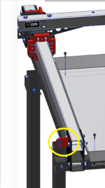

As Richard said, check the couplers. I had inconsistent holes and could not figure it out.
As it turned out, there was some wobbling happening at the end bearing blocks but I did not figure it out until the entire bearing block dropped off the rail with the lead screw. Tightening those screws thru the rails is somewhat difficult but I didn’t want to do it a third time so I used the blue loctite on them. No problems for 3 years now and the holes and curves are great.

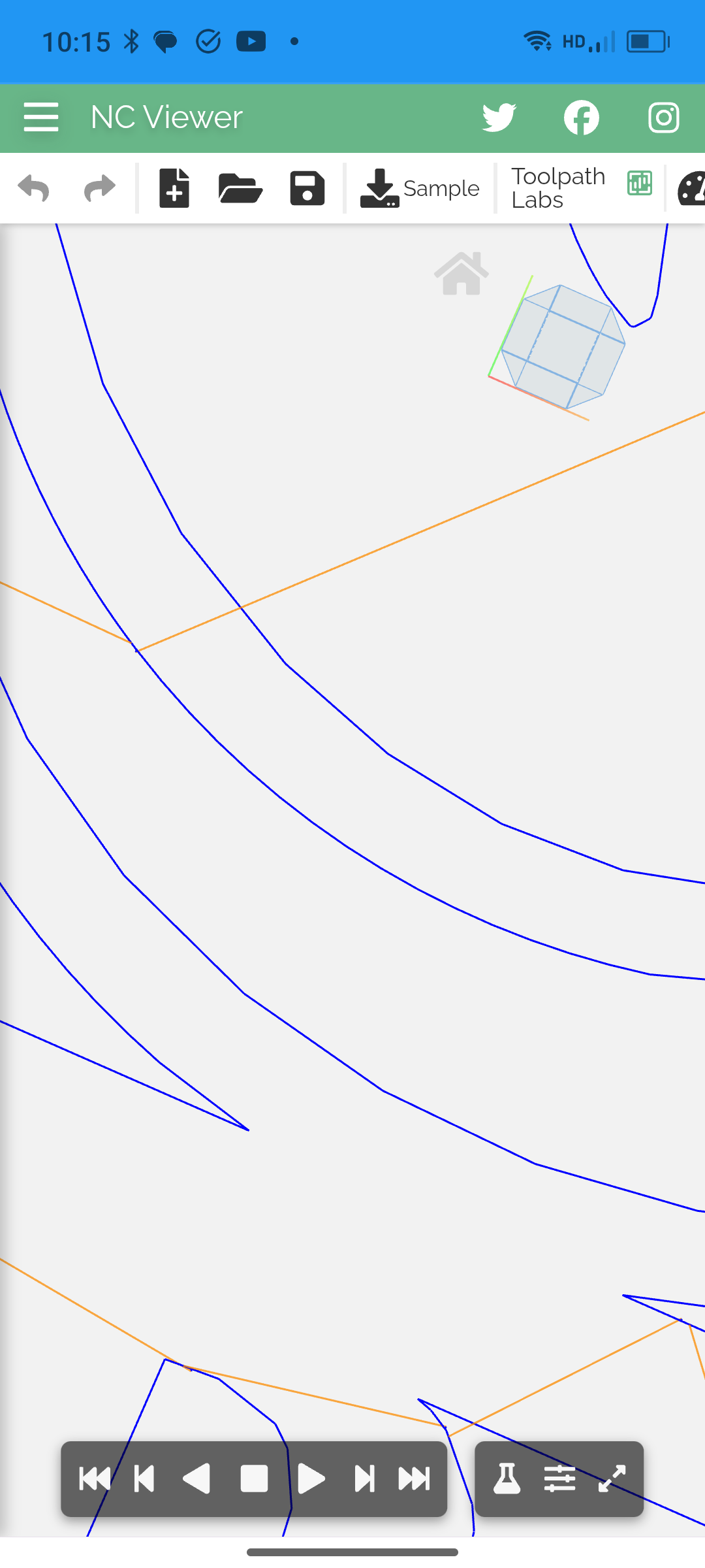

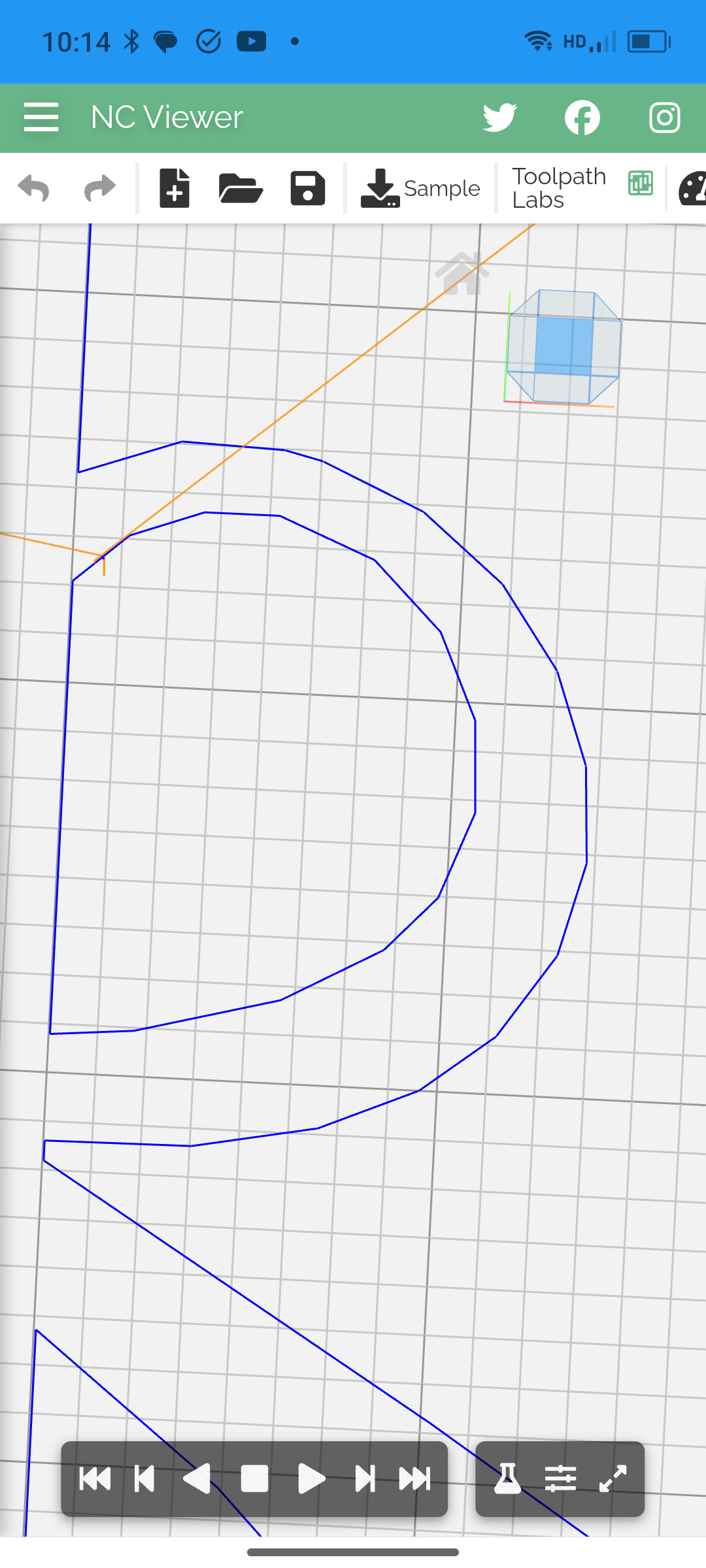

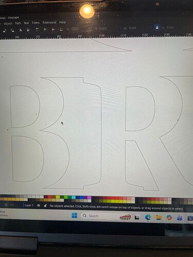

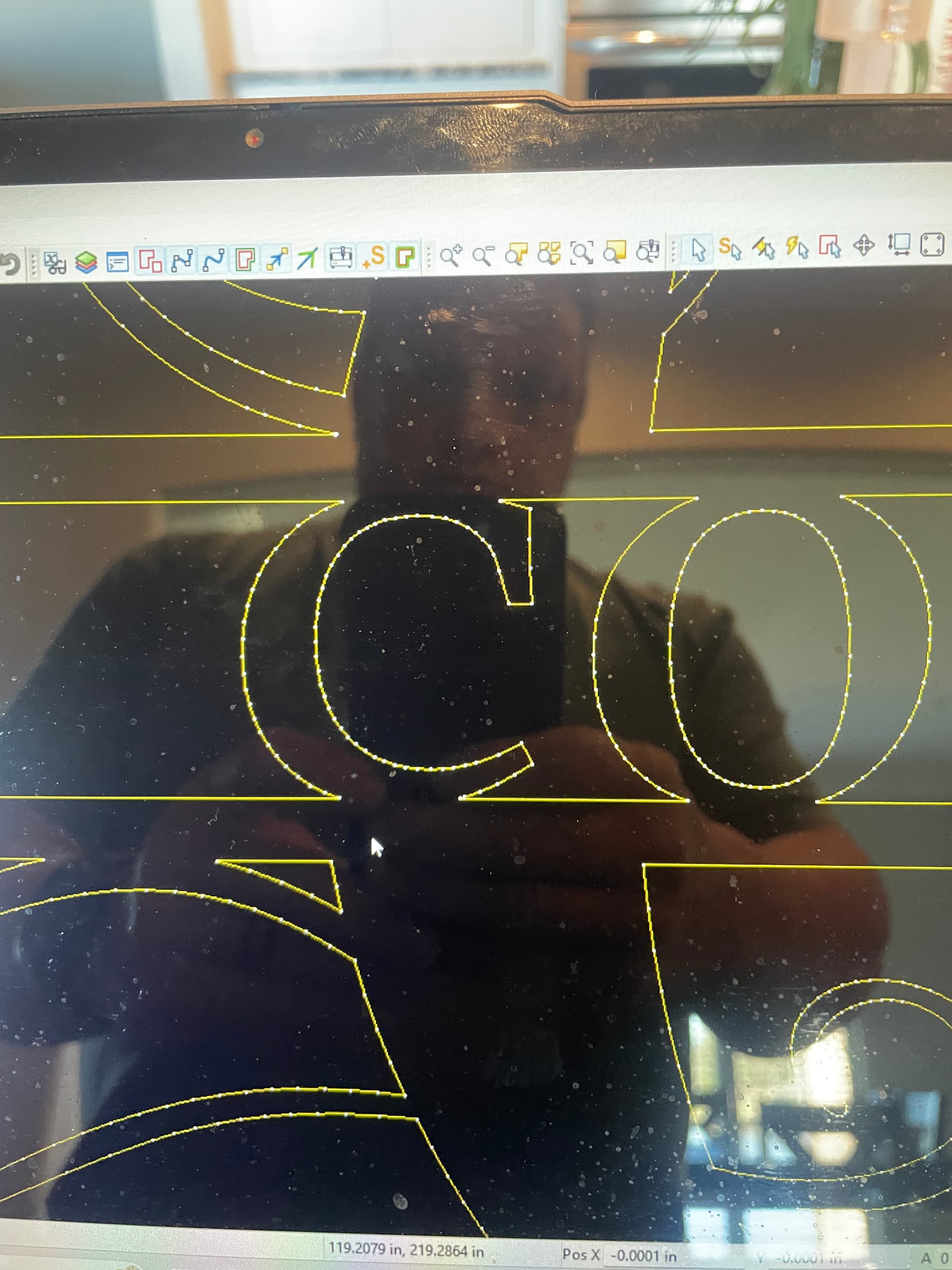

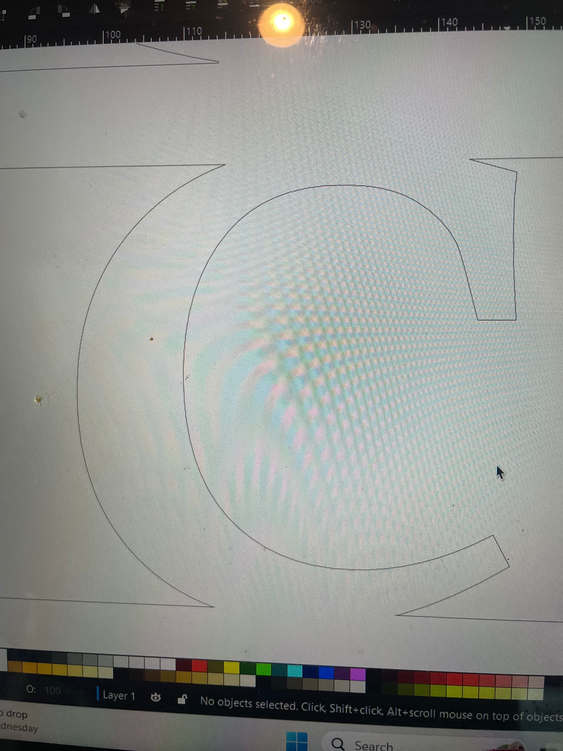

The photos you posted with the cut issues have a C visible. The file you posted doesn’t have a C so it makes me think it’s a different file. The file you posted shows smooth curves as an SVG should be. The photos you posted of the cuts have uniform segments like you’d see in a file that doesn’t have smooth curves. Which you encounter on certain fonts and one some conversions. If you want to post the exact file you used for the cut in the photos that will help.
The suggestions about couplers being loose could be valid; but to me if it’s only happening on some curves, with that level of uniformity; it looks exactly like arc segments. Without seeing that actual design or the cut file, the design can’t be ruled out as the issue.

Good catch. I don’t see those on mine.
It’s likely happened in post processing. That’s why you don’t see it on your SVG or dxf.
Maybe some kind of setting in sheet cam that’s adding those facets?

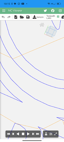

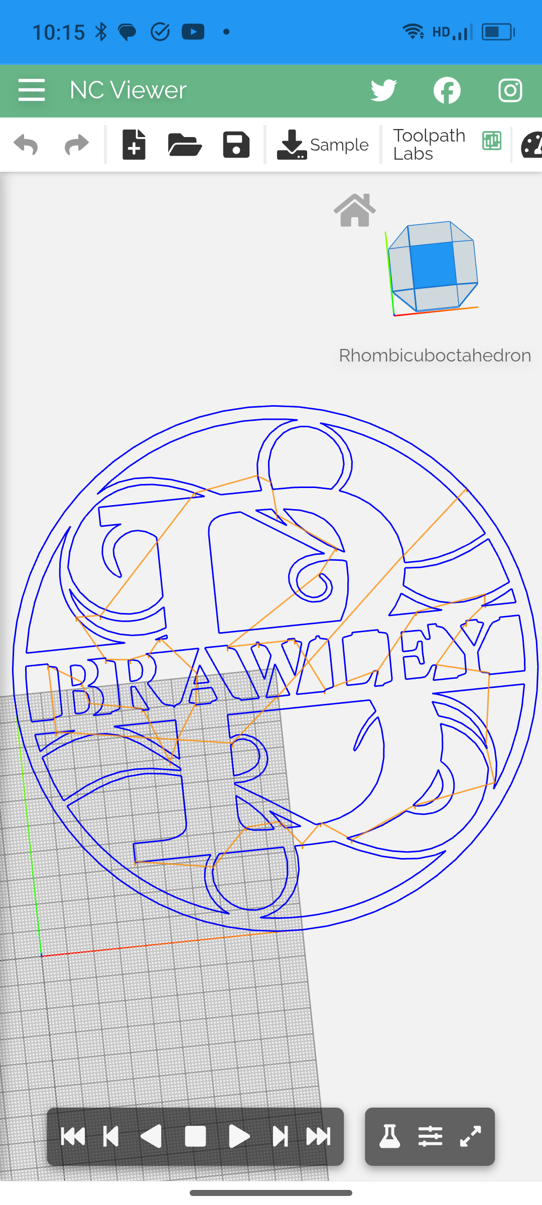

You can also use “NC viewer” to look at the tap files from SheetCAM. It’s a good app for your phone and you can use it browser based on the computer.
I see all of the issues after zooming in on sheet cam.
