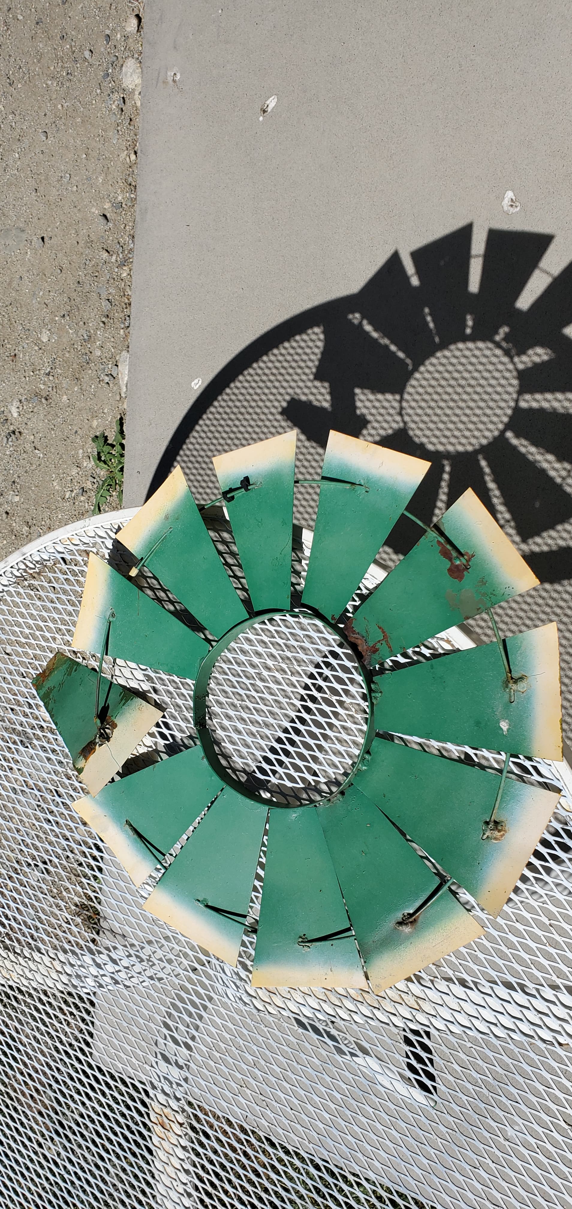

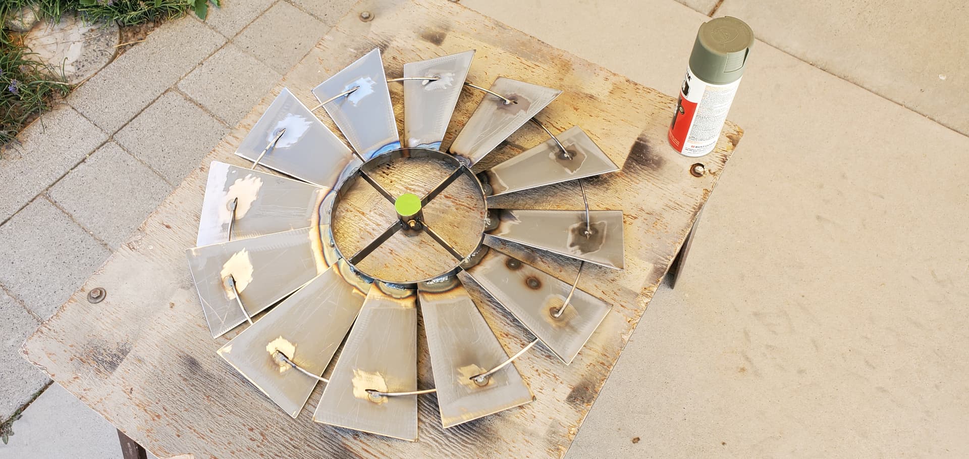

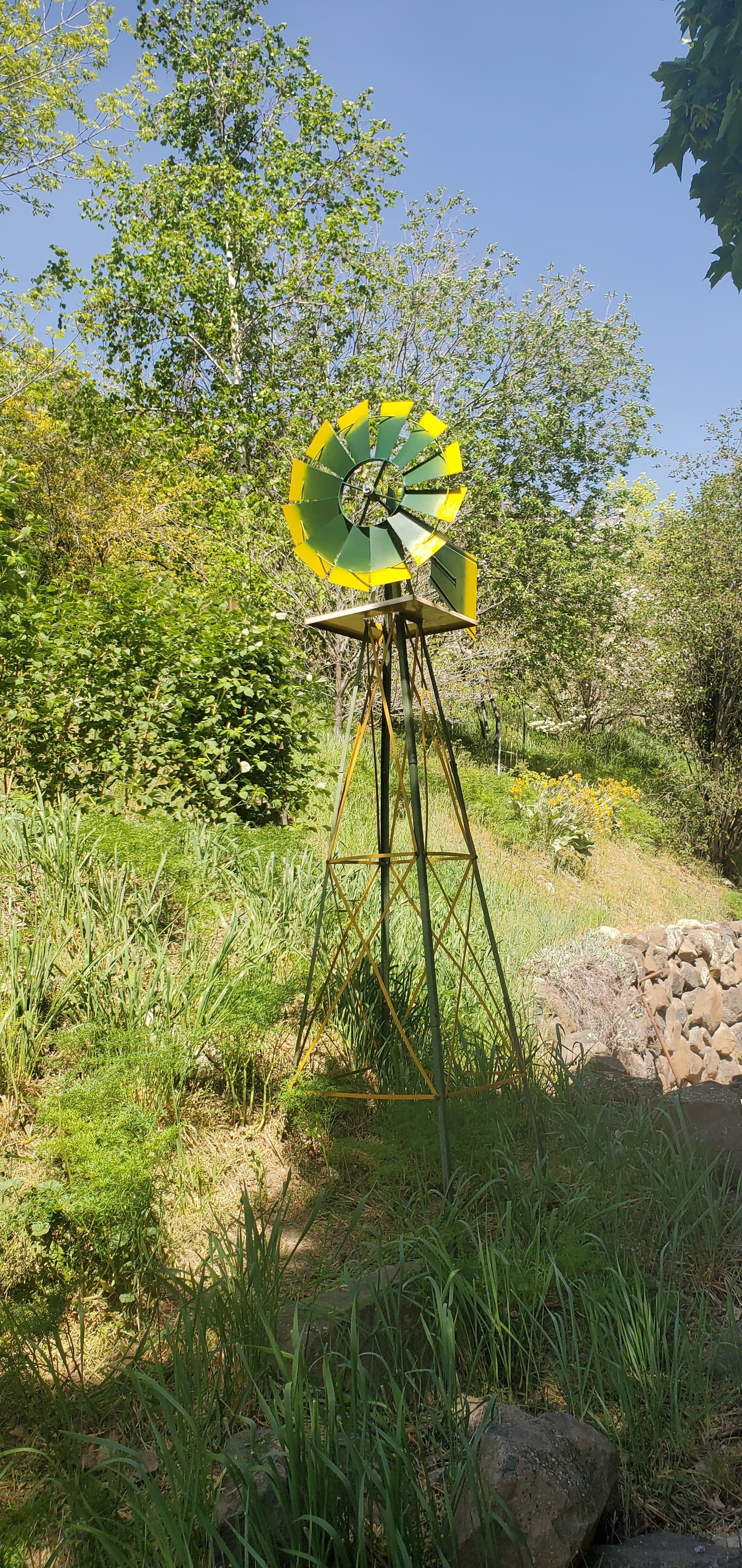

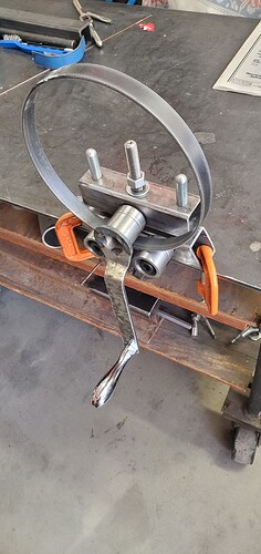

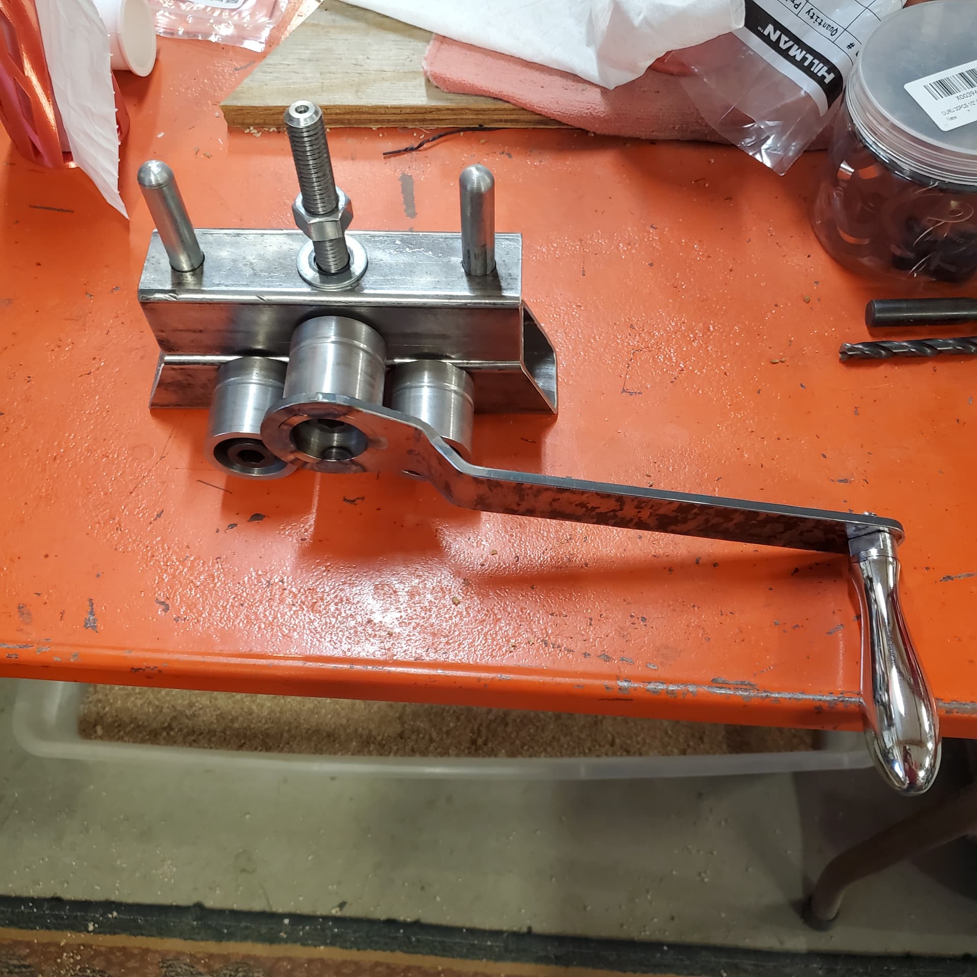

I made a ring roller a while back ( I may have already posted the ring roller) and then proceeded to build a new artsy windmill, since the old one self destructed a while back.

I really need to make one of those for rolling round tube.

Did you watch this to make your ring roller?

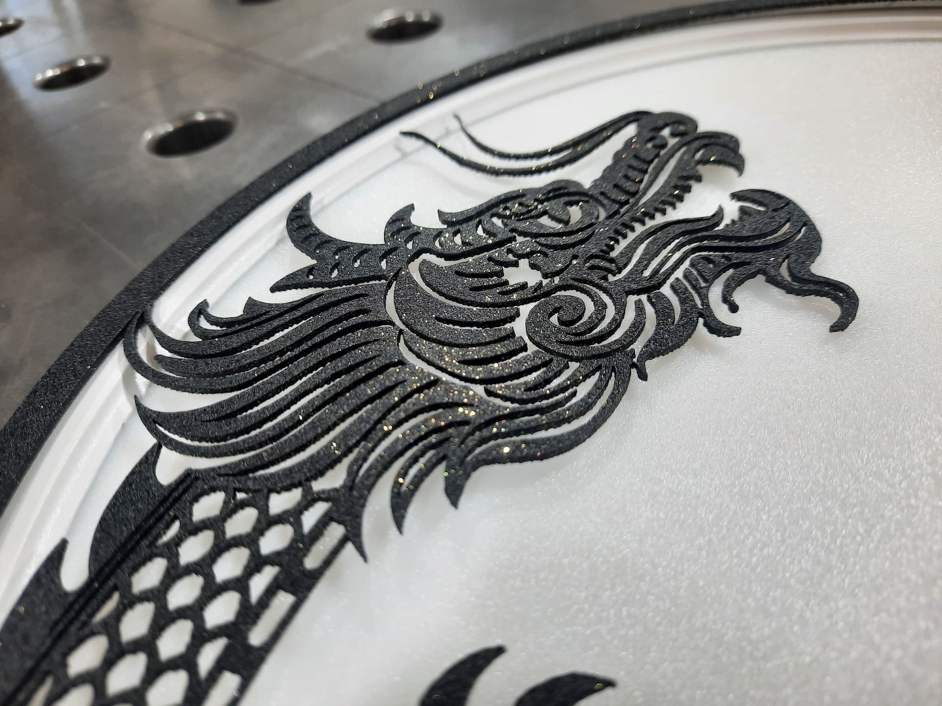

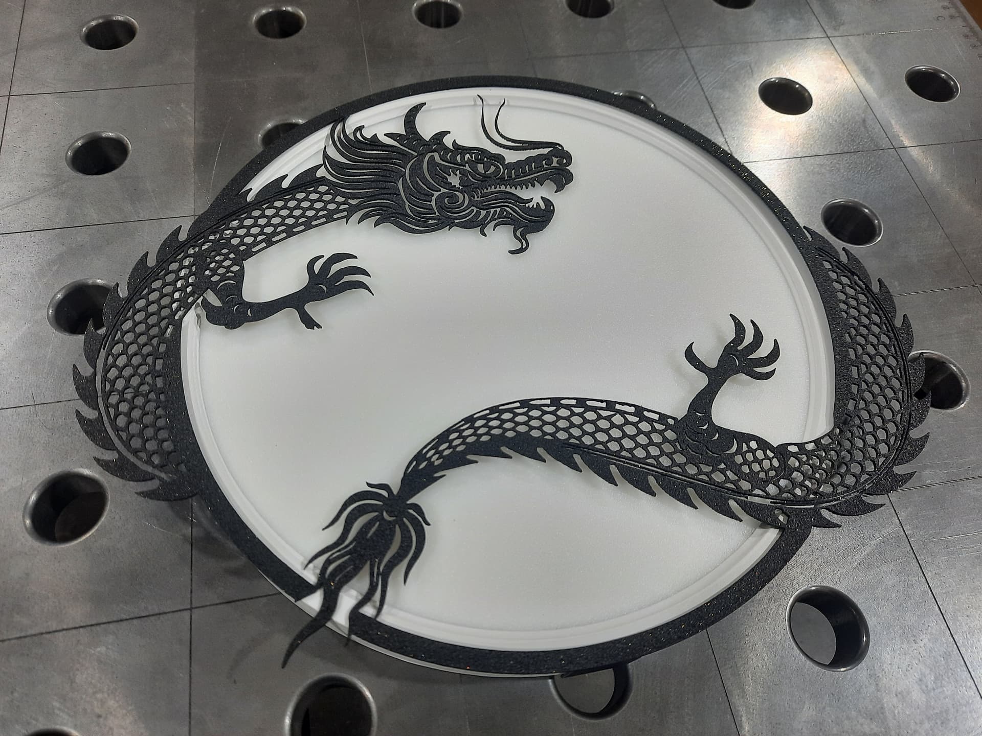

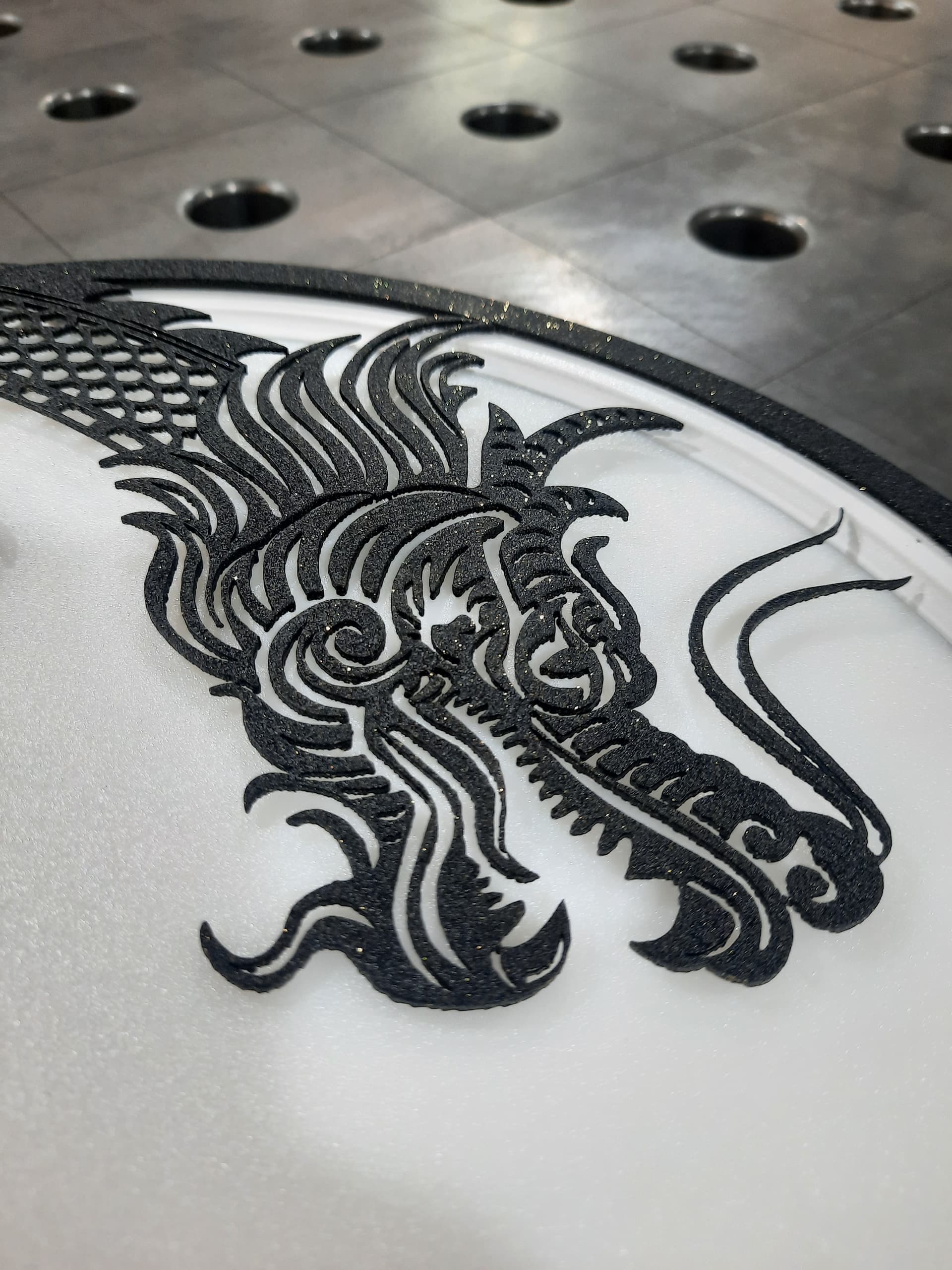

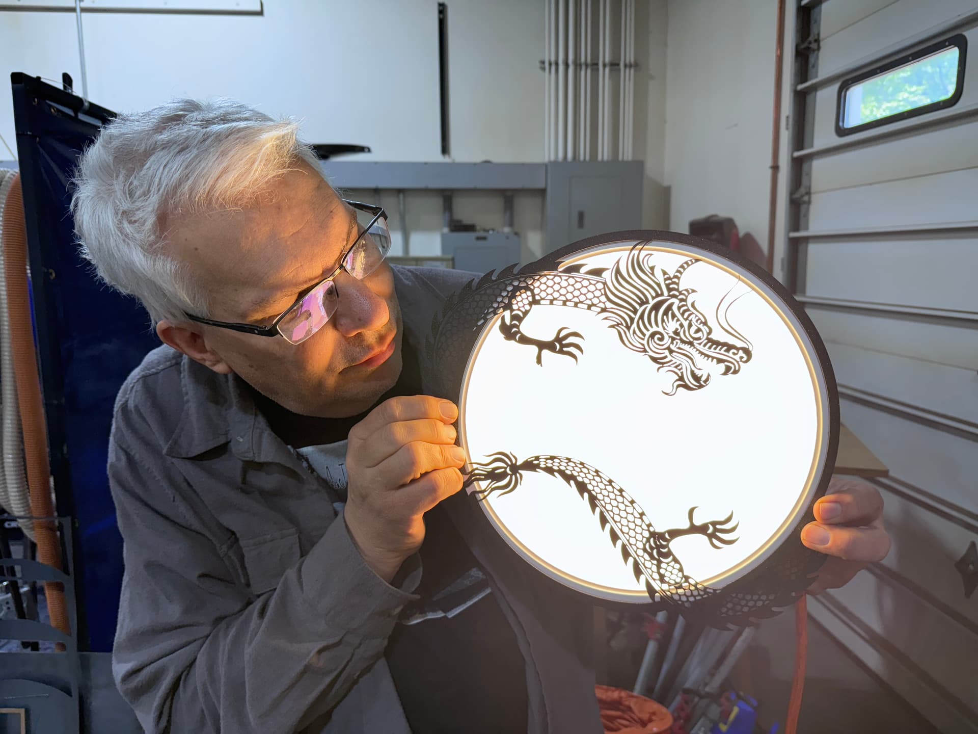

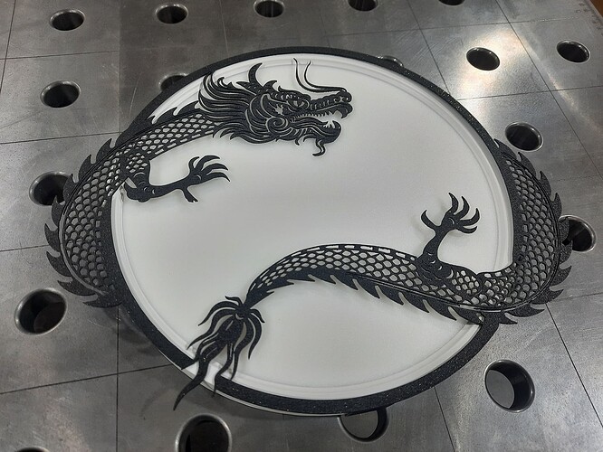

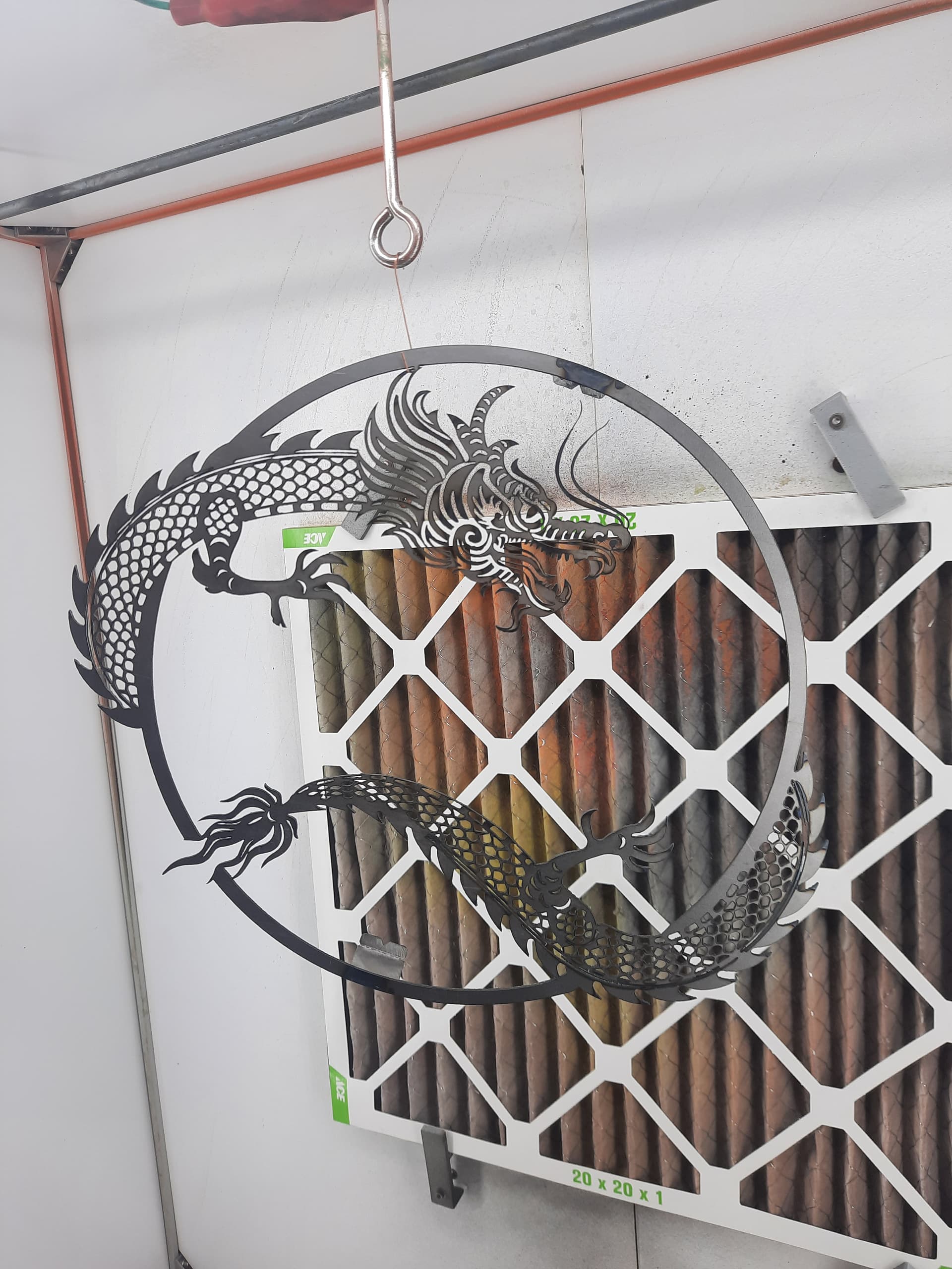

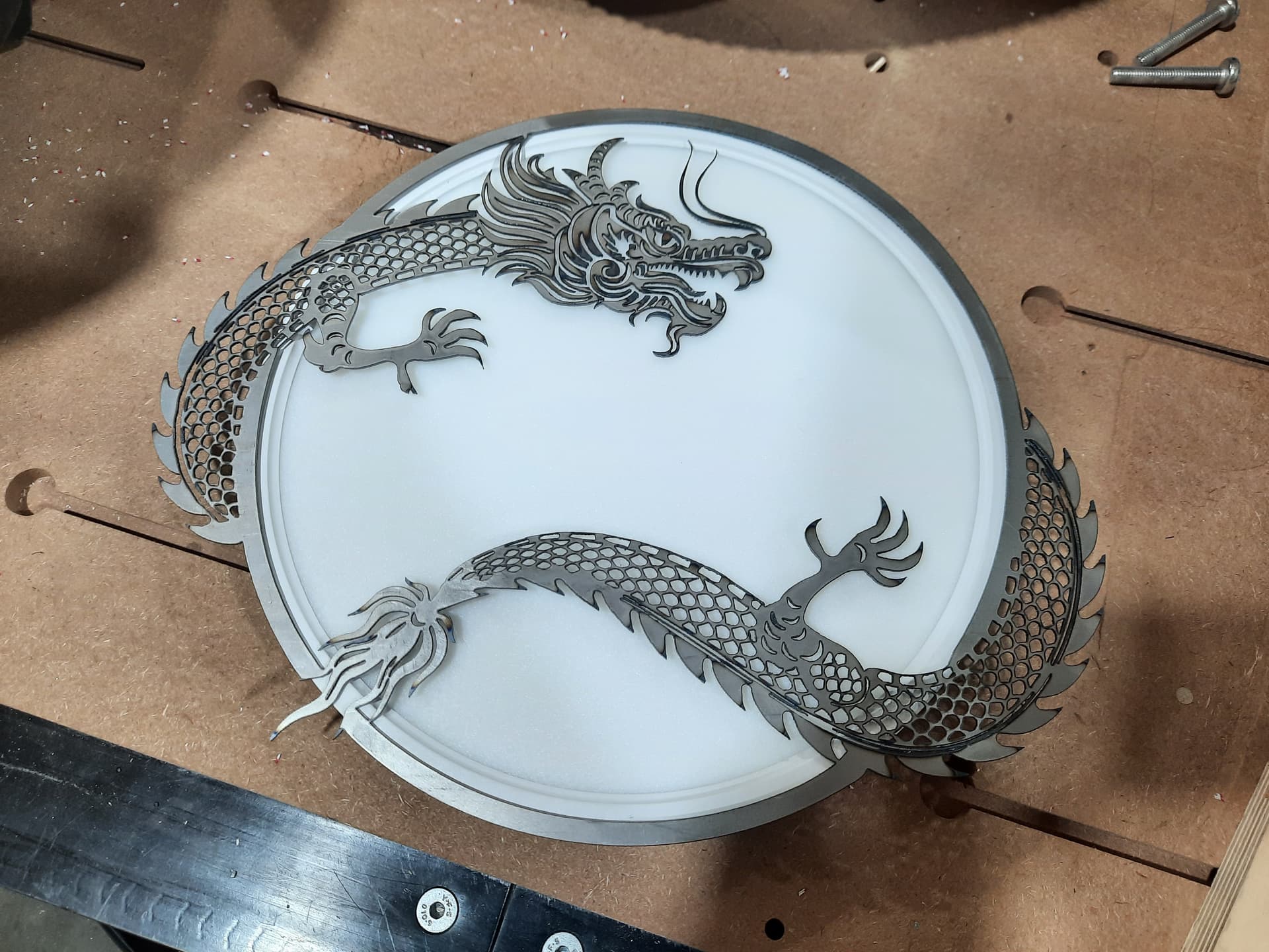

⁨Worked on a birthday present for my granddaughter this afternoon. Its an attachment for the bedroom ceiling light. Powder coating it tomorrow. It came out great.
12" diameter LED ceiling light.
https://www.amazon.com/dp/B08F9CM8KK?ref_=ppx_hzsearch_conn_dt_b_fed_asin_title_1
Art
https://www.etsy.com/listing/1572885532/dragon-laser-cut-wall-art-dxf-svg-eps-ai

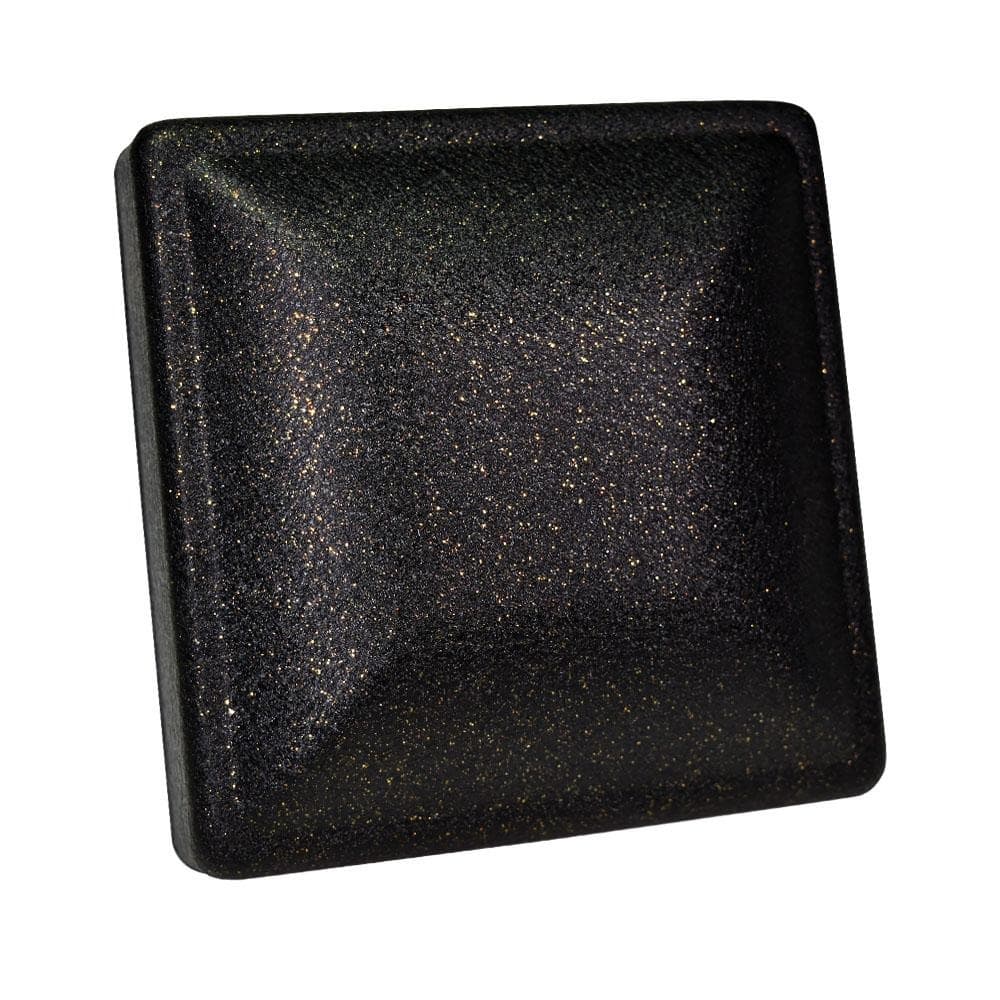

Going with this black gold ore powder.
Yep, I watched the second one you posted. I had to modify it a bit though as the bearings I had were smaller so I machined the rollers and pressed the bearings in. I cut the handle out on my crossfire table and used a handle that I wasn’t using from my mill.
I finished the little windmill up today.

Starting to be really jealous of you and that laser with the detail that you get.
Ya I am too, for some reason he seems to be better friends with the tool and equipment gods than I am. Wish I was his neighbor :grinning:

On one hand, I’ve become resistant to posting these killer cuts because the detail here is beyond what a plasma cutter can do.
On the other hand, I want to show what’s possible with a combo laser/welder mounted your existing LS machine. The more I use my setup the more I love it. It’s now at a level I can do the meticulous metal work I’ve only imagined.

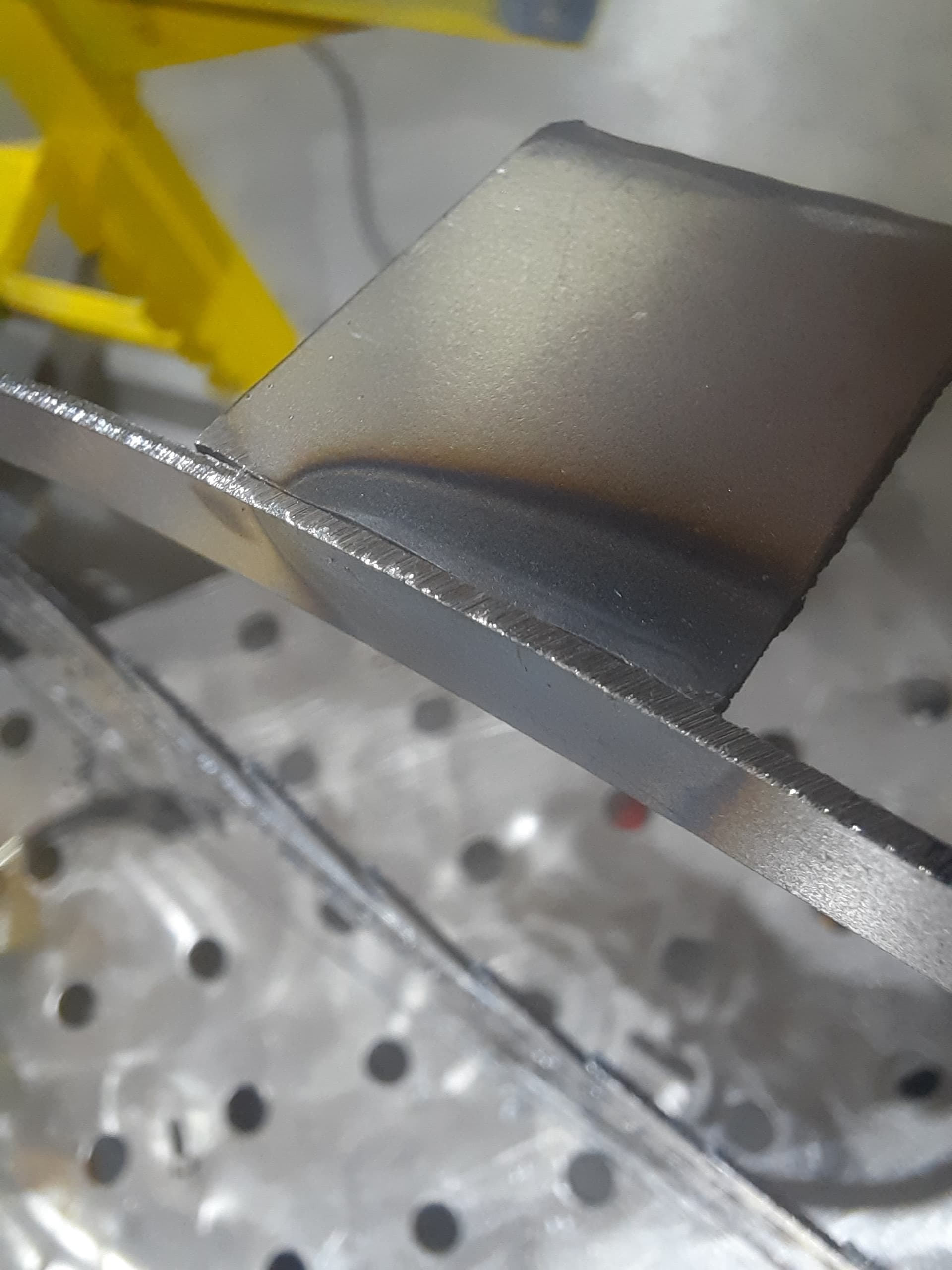

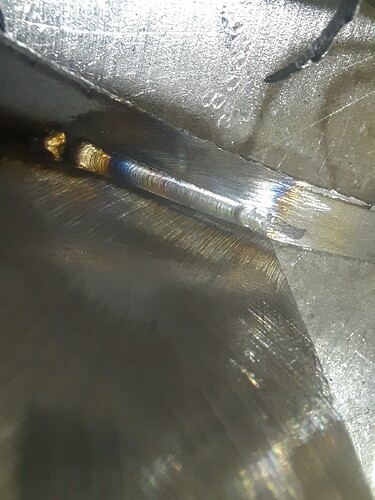

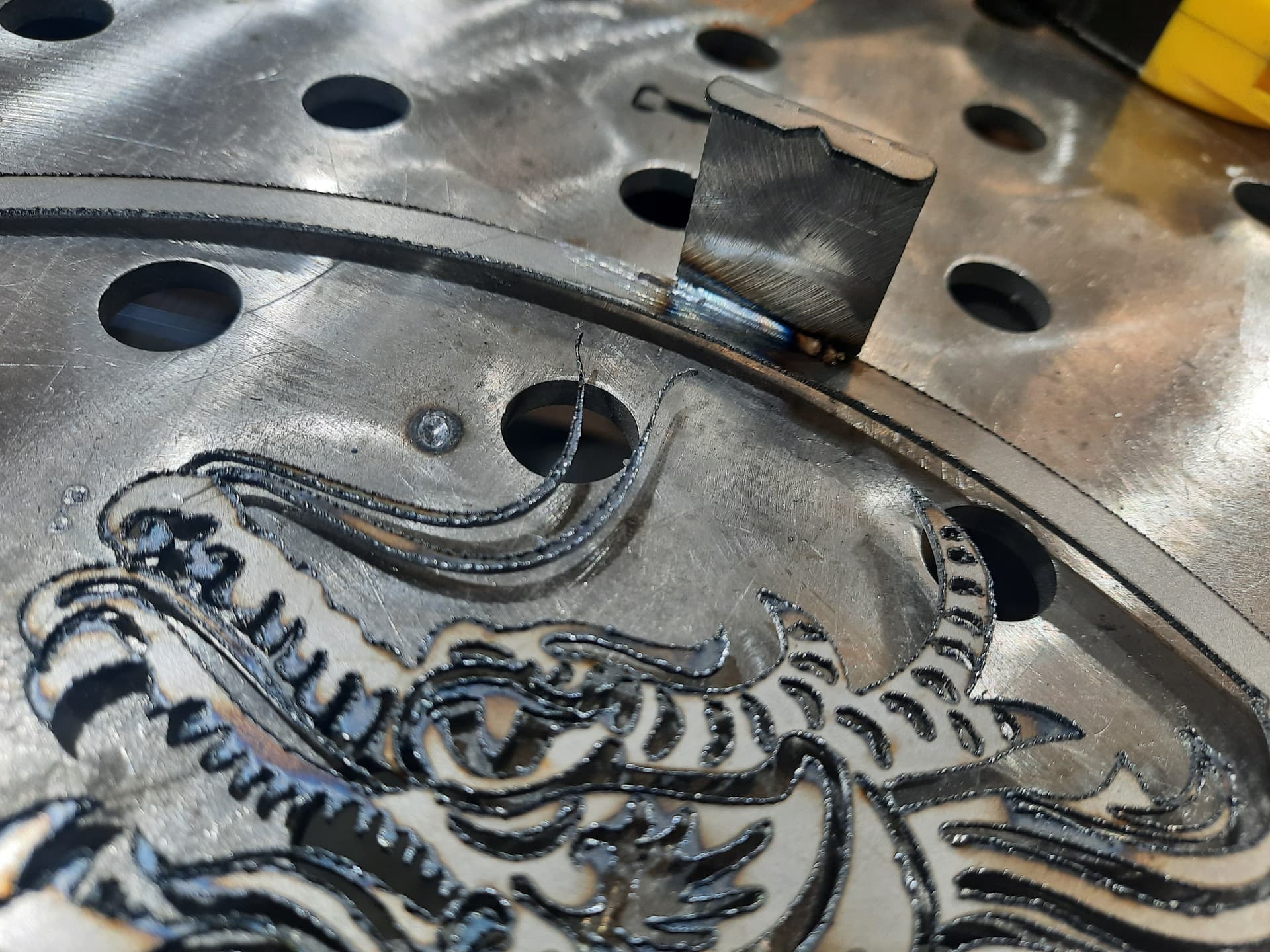

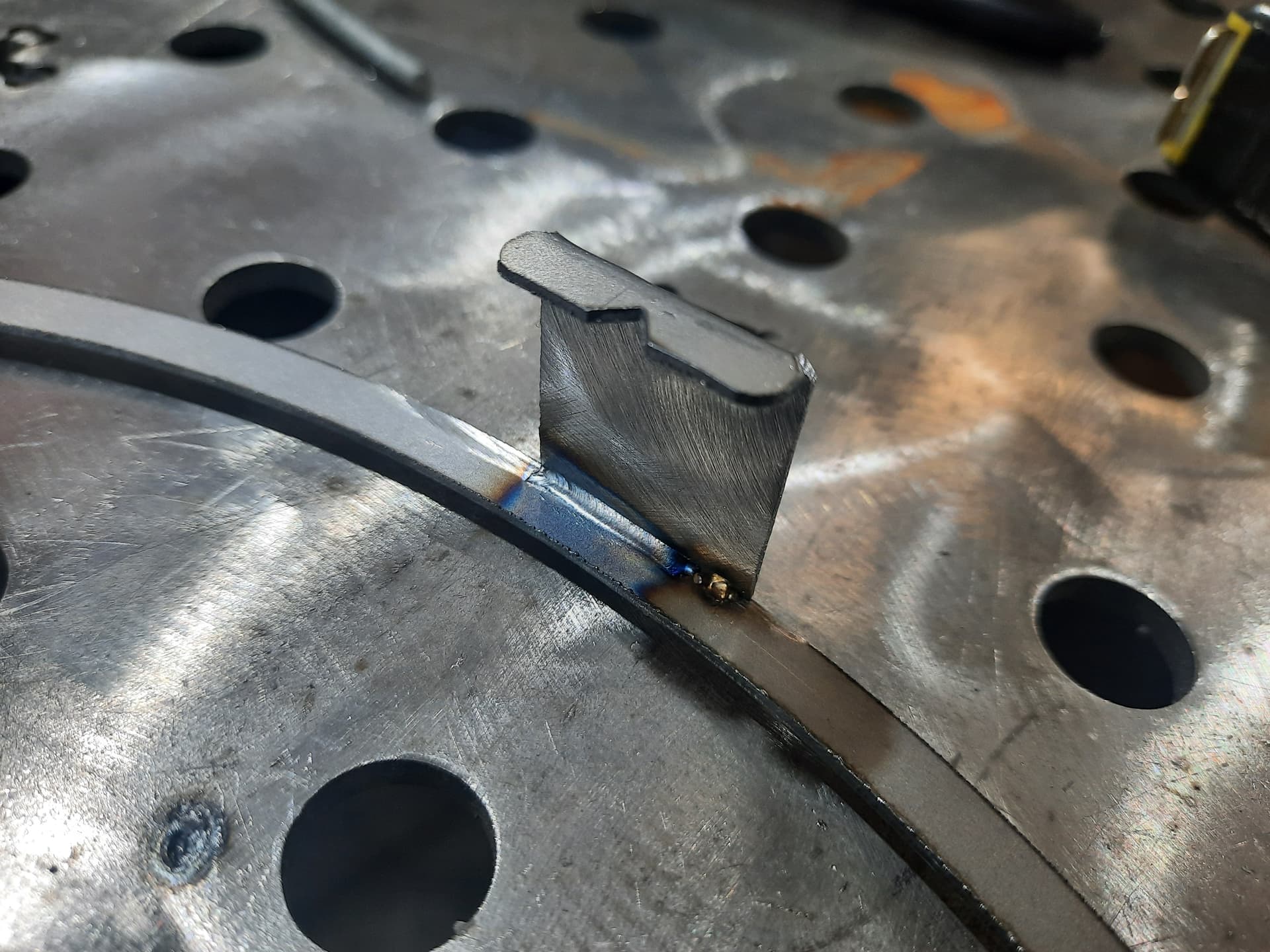

My tiny welds for the mounting tabs came out great, 400watts had plenty penetration on this 18ga HRS.
Got my present done for my granddaughter. She also wanted a dashcam for her car, 17 yrs old. Where does the time go guys, where?
It’s killer!
