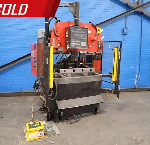

Snagged an amada rg35 last week. Pretty good deal on it. Should get delivered this week hopefully. I gotta find some new tooling or some adapters since its euro tooling.

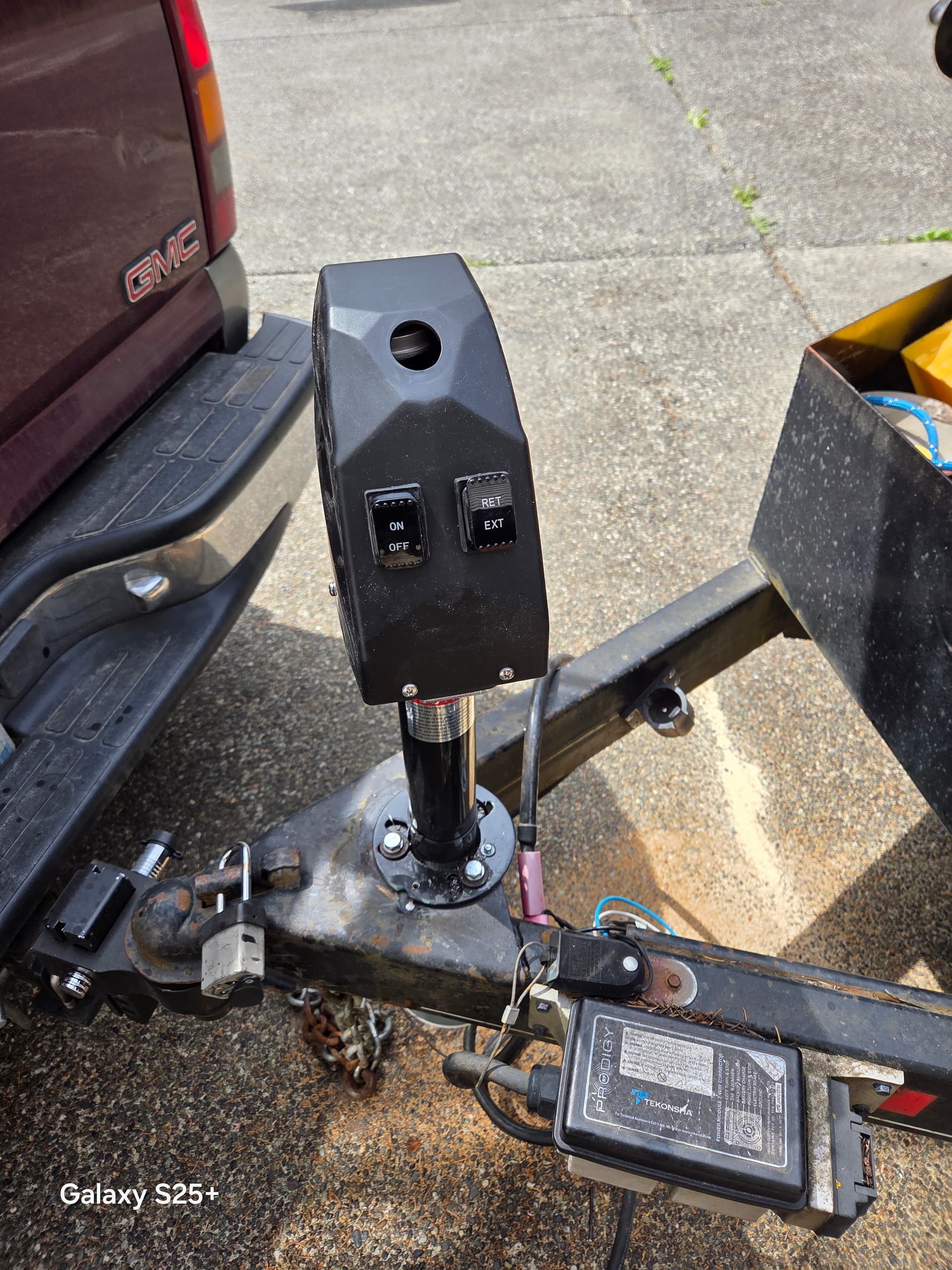

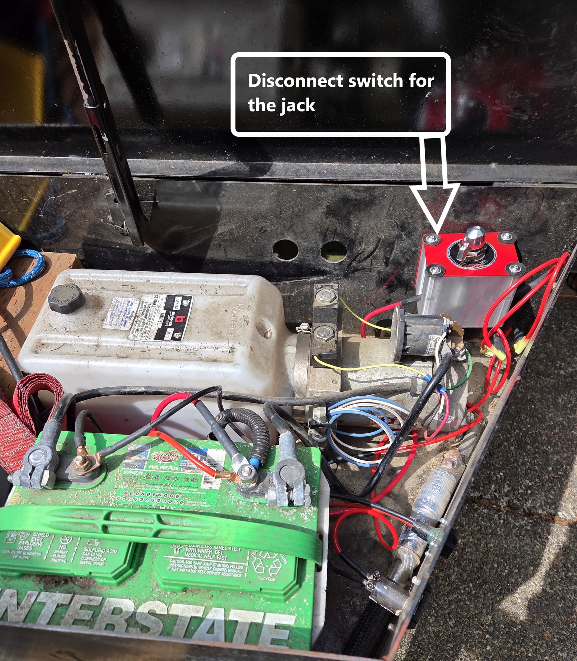

I finished the install of my electric trailer jack with the CNC cut-off switch box.

Got the pump running with a vfd. Dont have 3ph in this shop. I’ve got it at the bin site, someday I’ll have a new shop over there.
It had pneumatic lifters and light curtain. Ripping all that out. Its definitely cool seeing some of the innovations on this era of a press. Was definitely a sweet ride back in the day. The mechanism for the pedal is cool. Its got 3 limit switches for the pedal. One for slow speed bend, one for high speed bend and one for return. So if you barely push the pedal it would have ran slow speed the whole way. Big push is high speed until the ram hits the slow trigger.
Tearing all of that out. Got a raspberry pi on a touch screen that is going to flip relays to run all the valves. Got a rotary encoder that will tell it ram position. Slow speed will be triggered by the ram position. Probably going to switch to a two stage pedal as some point to recreate the variable pedal feel.
Back gauge is going to be 2x nema 34s with homing switches. Stage 1 of my controller build is just basic controls. Goto BG settings, ram height and speed controls with limits. Next stage I’ll add in programs. Programmable from the machine or from laptop and sent over. Stage 3 has a bunch of goodies Im going to add in.
Get yourself a Phase Converter. I use an American Rotary 5 hp version. Works great, but very loud. They sell them by HP rating. $400 about.
Most of the ones I’ve seen are in the 1-3k range. This 5hp VFD works great so far. Soft start and stop. Adjustable speed. I’ve used a similar one on my drill press for years. Got a nice walker Turner from the 40s. Motor went out so I went vfd and 3 ph for variable speed. Its awesome.
I dont need anything else on the press to be powered from it. Push a button for the pump and push a button for the controller.
This is the one I have. It was 400 its now 650.
No speed control but full motor hp.
Thats cheaper than most the ones I was seeing. I did most of my phase converter research when i was looking at a used guifil press that used a large pump. I think if i went the rotary route I would shoot for a 15-20 hp one. Then maybe i could run an ironworker too someday if i find a deal on one.
Wisdom. Always get some overhead for when you wish you had at a later date. Buy once, cry once.
