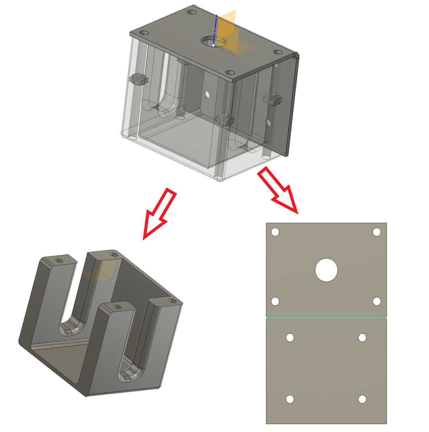

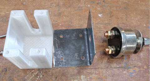

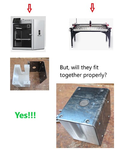

This project isn’t anything spectacular but this is exactly why I wanted my plasma table and exactly why Fusion 360 makes my designs possible.
So I have a dump trailer and grand kids (young). I am tired of the manual wind jack for hooking/unhooking the hitch so I bought an electric one. I know my grandson will not hesitate to play with the power on the jack once he finds it so I want to put a disconnect inside the lock box that holds the controls and hydraulic pump and battery for the dump bed.
Thanks to Fusion, the design was easy to make both the plastic model as well as the metal plate that will be riveted to the metal lock box (inside).
Now these patterns move to the respective equipment and Voila!
I couldn’t be happier with the outcome. You can’t really appreciate but that plastic part has square metal nuts that will allow bolts from the top to pull the plastic bottom securely onto the plate. The plastic turned out to be strong enough for me to turn it on its side and step on the smallest portion with my heel and there is no risk of breaking.
I used 16 gauge steel and Clear PETG GratKit Filament (5 walls, 25% infill, with addition support added in the shaft for the bolts with 50% infill).
