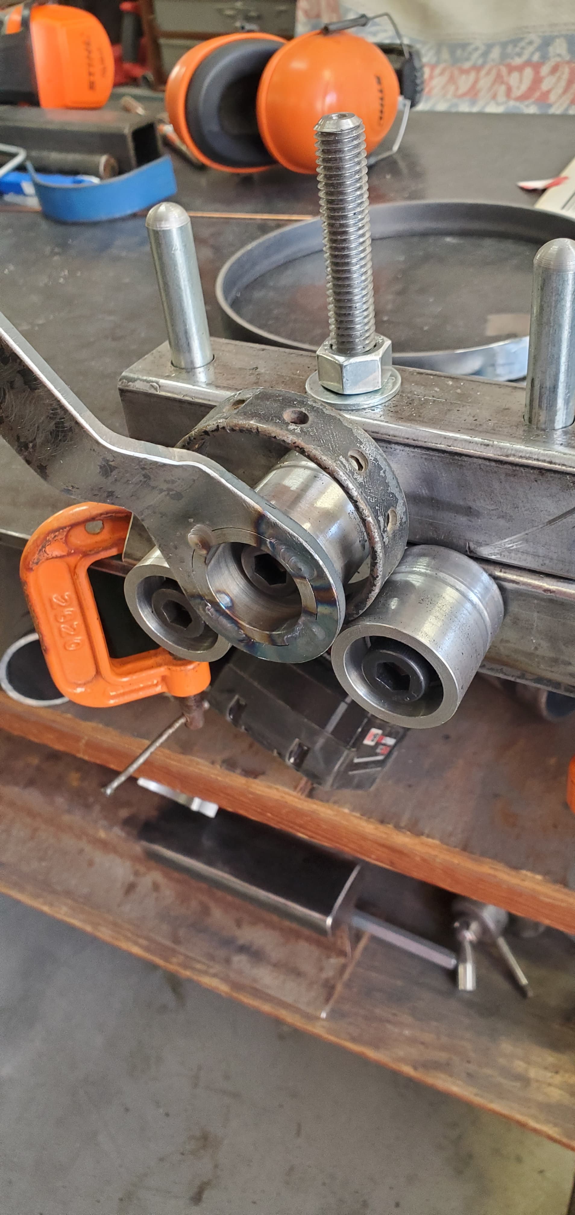

Made a little roller binder, cut the handle out on my CNC table, other then a little paint it’s done.

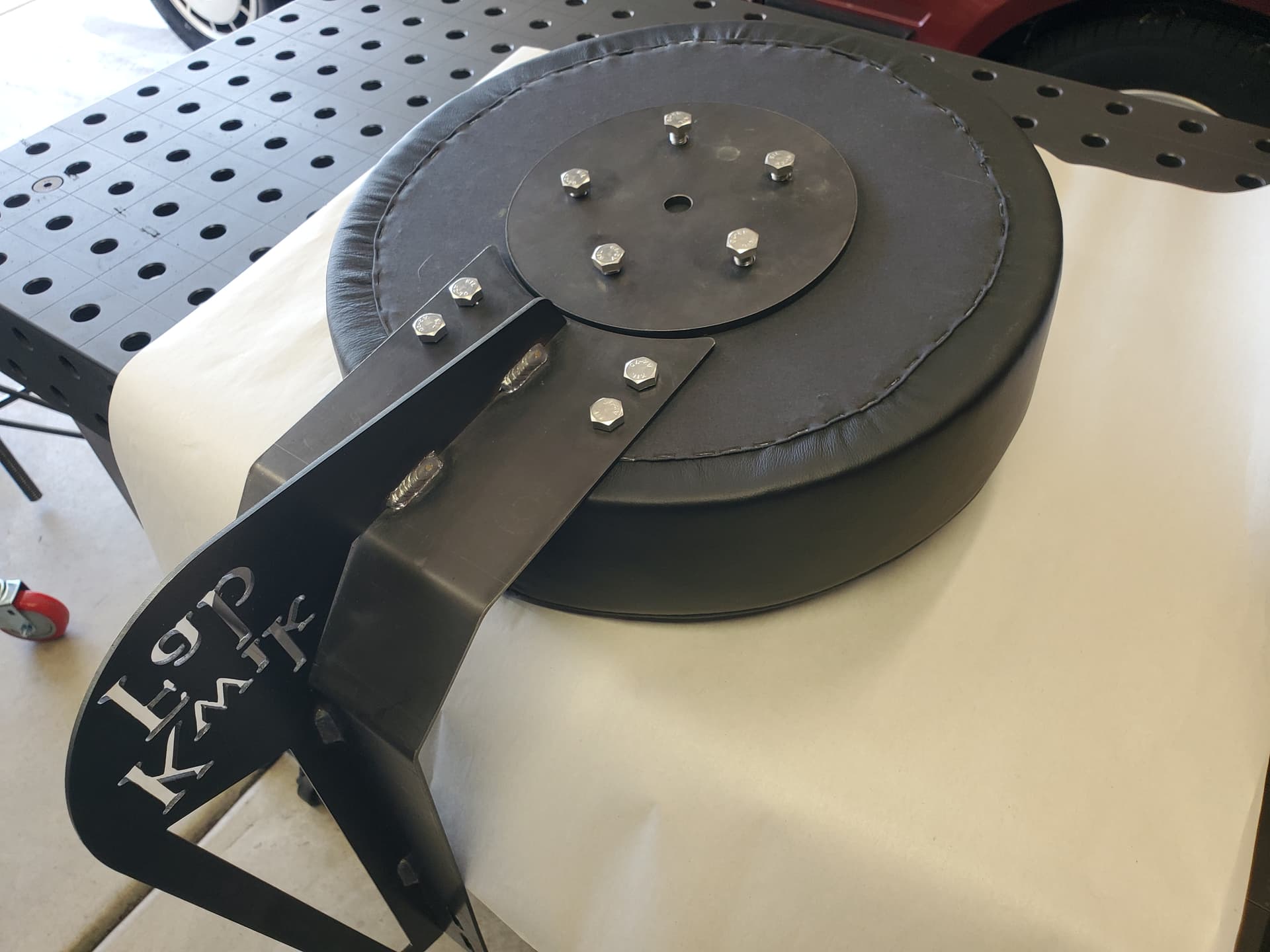

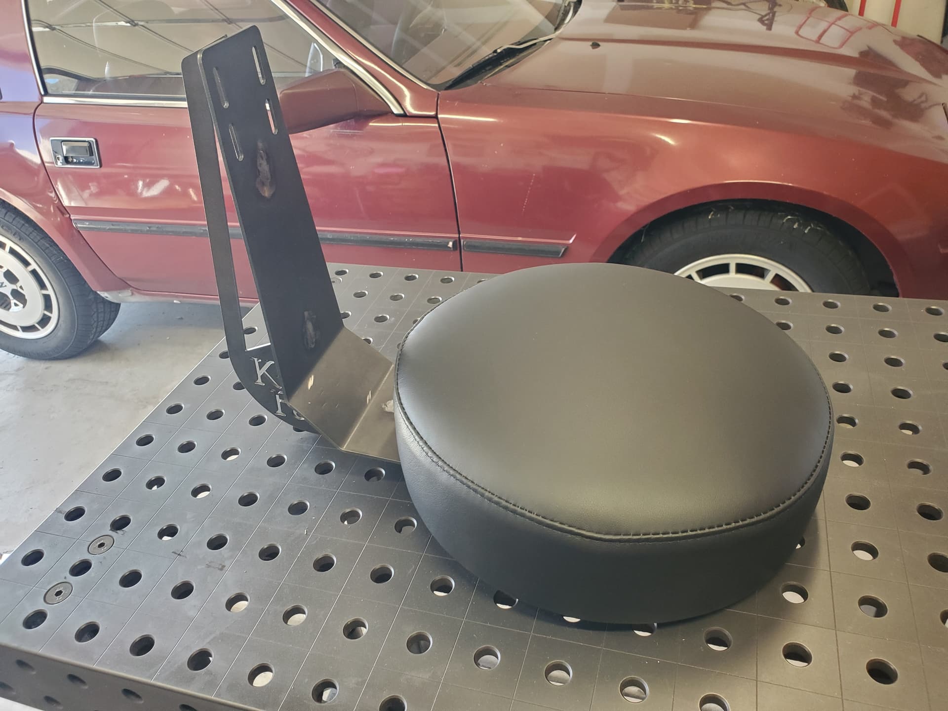

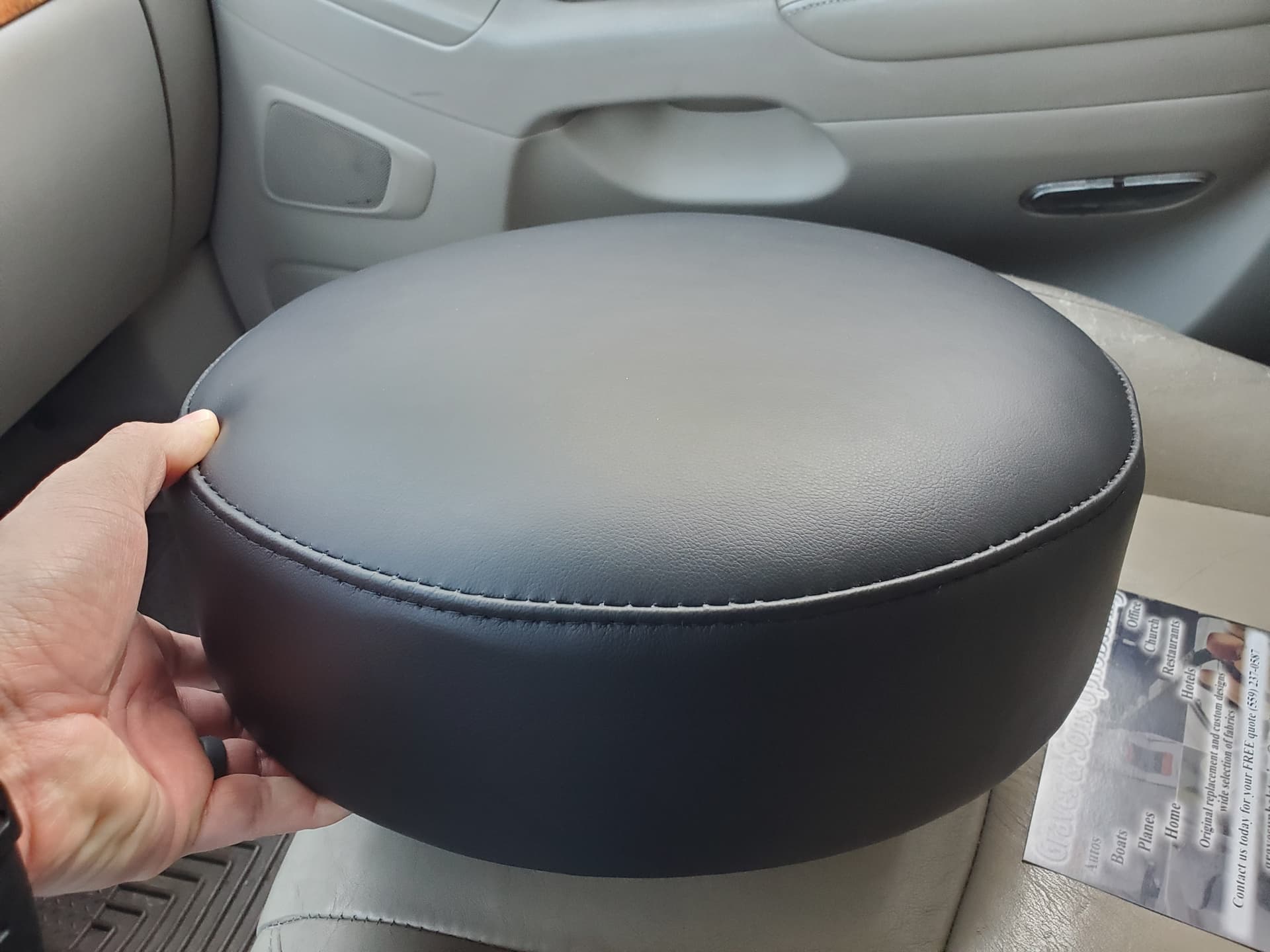

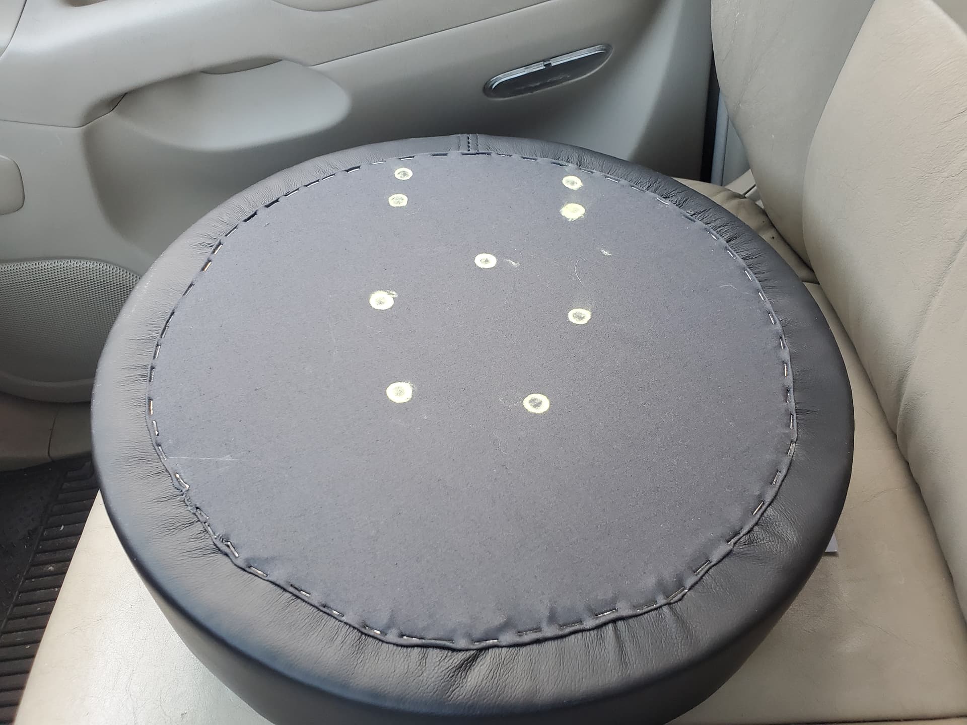

Upholstery shop did way better than I ever could, this fucker is nice!

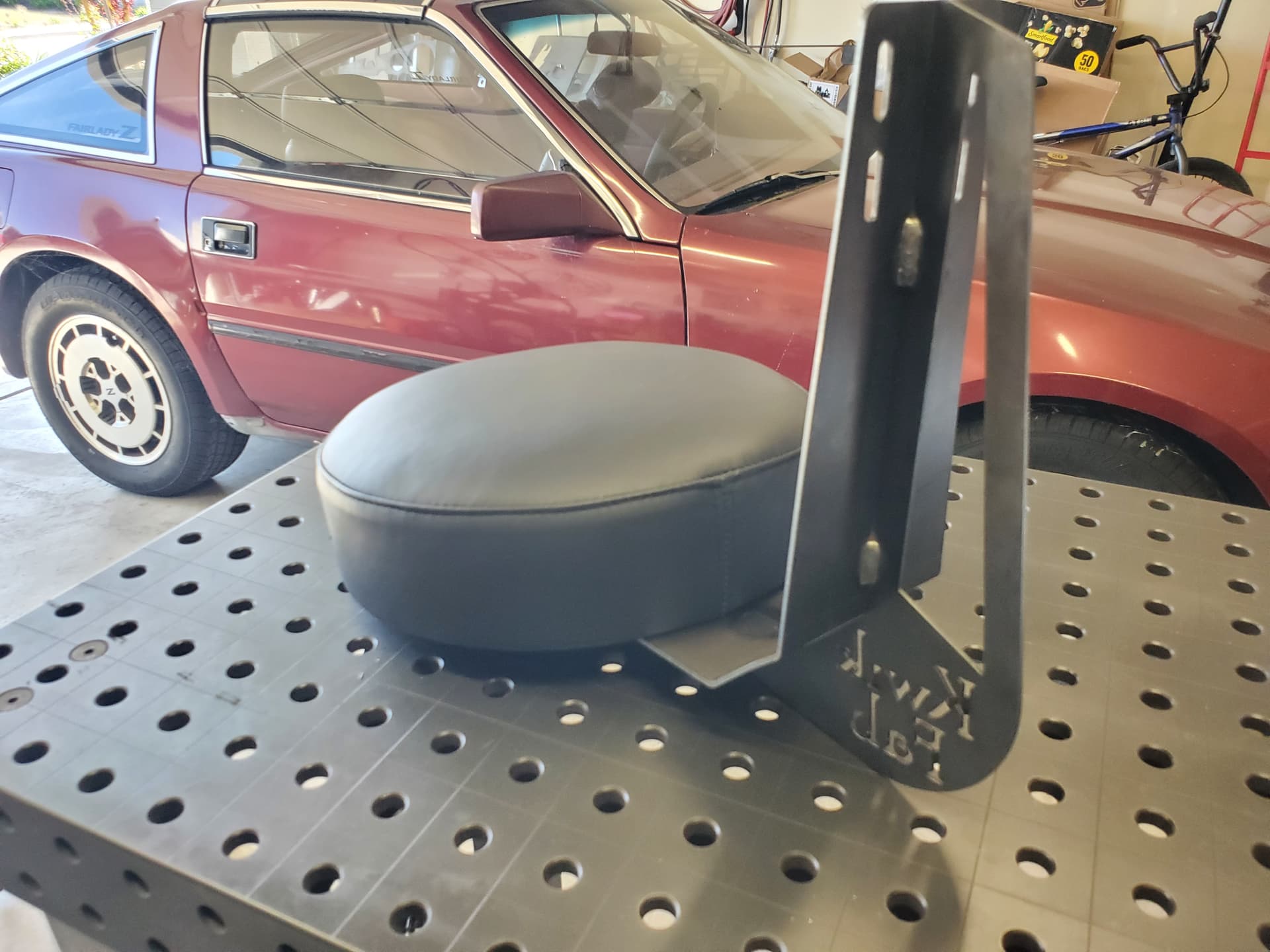

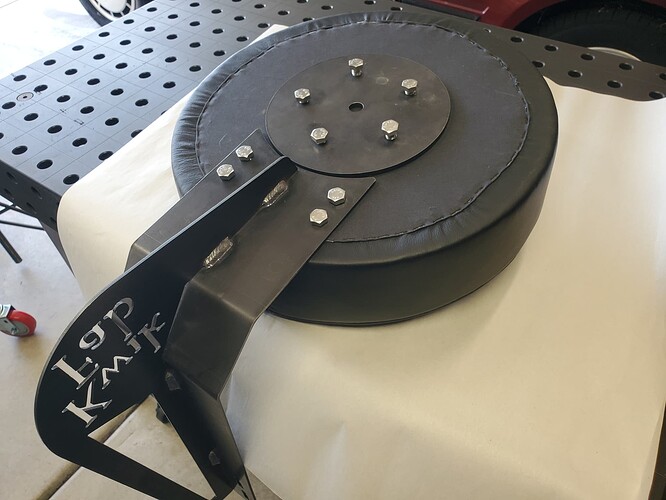

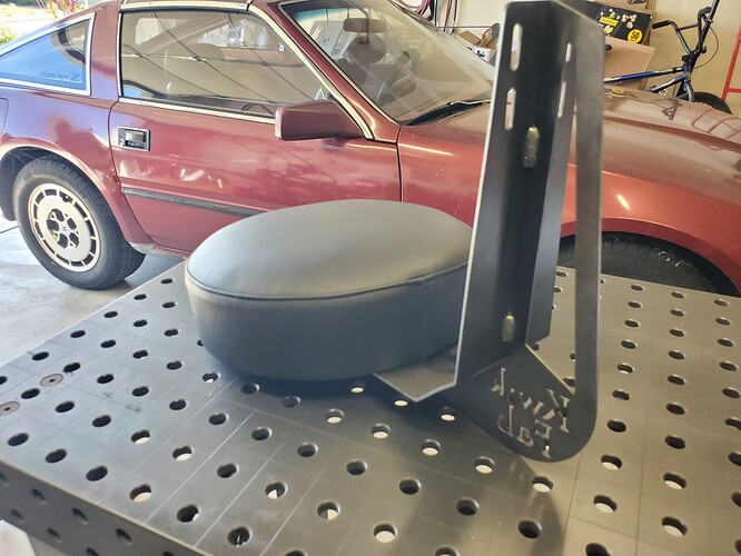

Quick mock-up
Oooh yeah

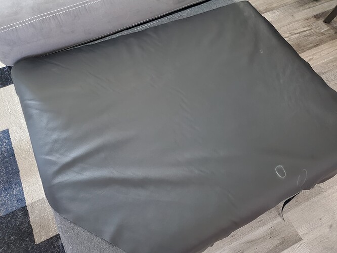

I’ve got a ton of leather left so I may just use some of it for a new backrest and return the one I bought from Vyper to use.

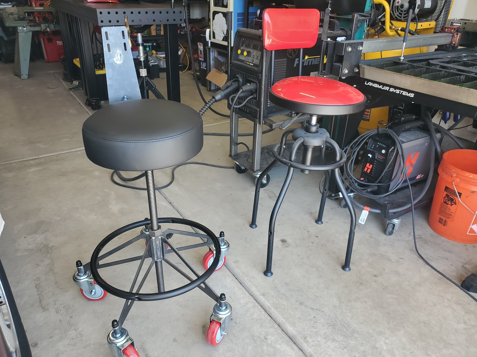

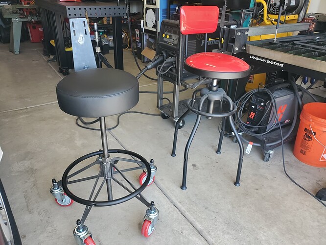

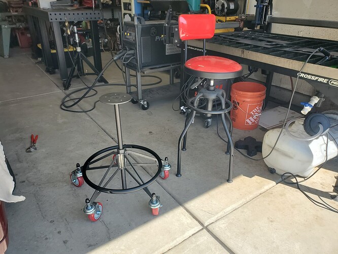

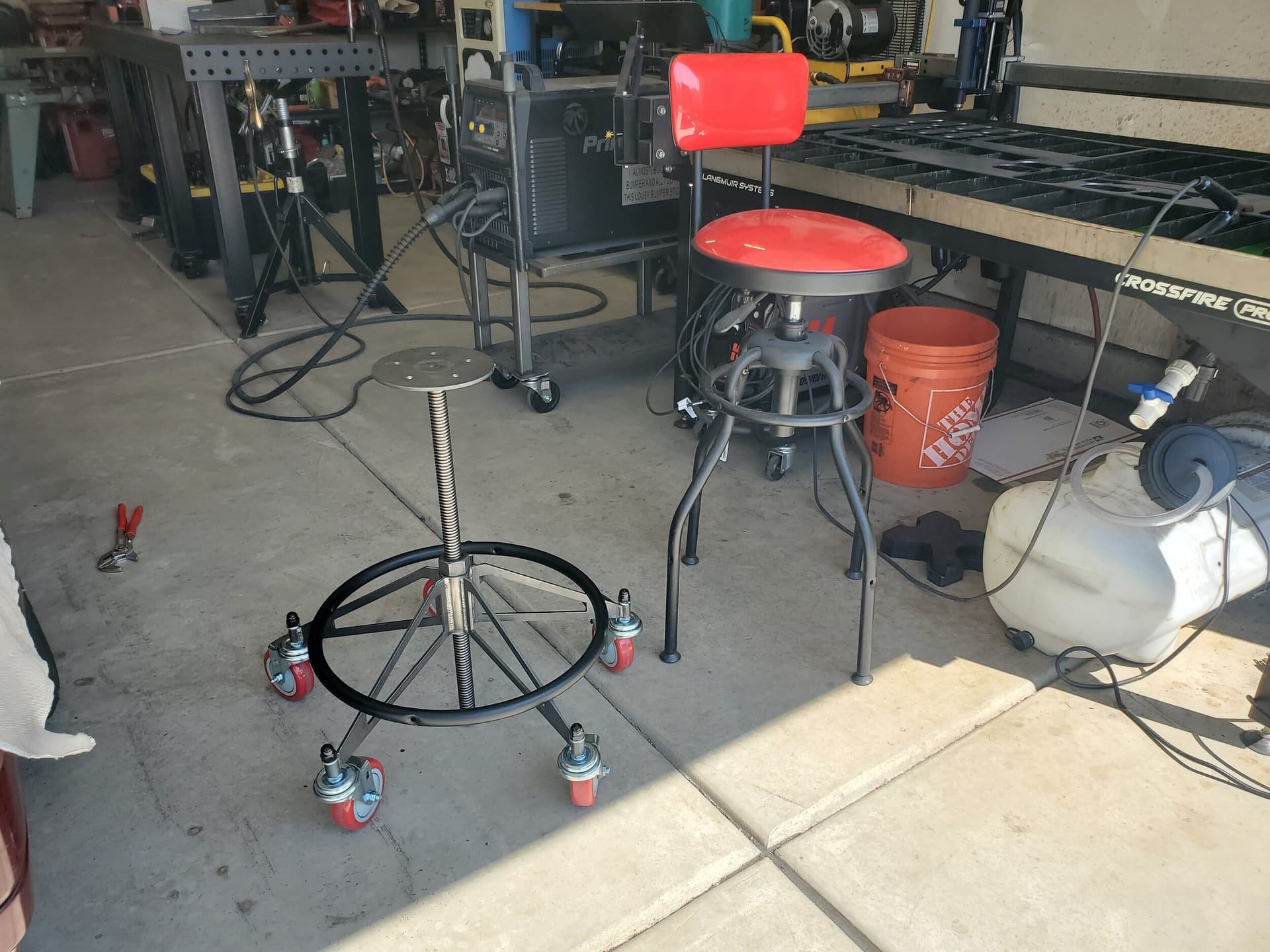

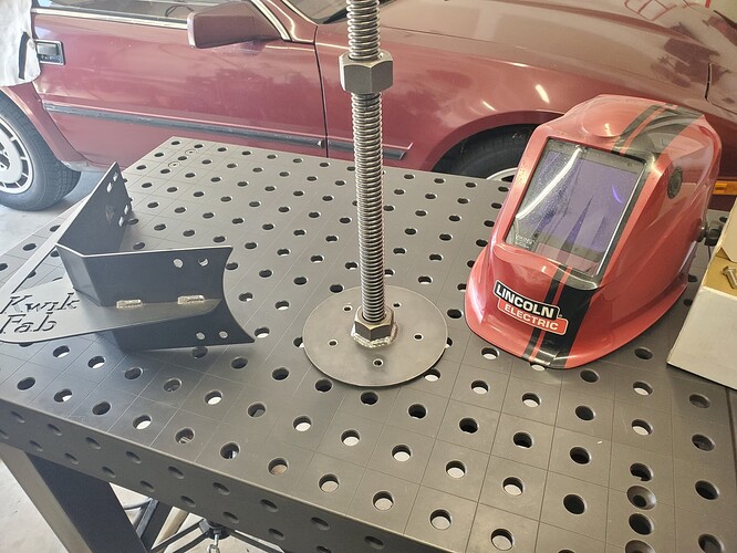

Just gotta let her cool down but metal top, nut, and leadscrew are welded up
Later I’ll have to mount up the seat and run it down to mark where I’ll cut my leadscrew.

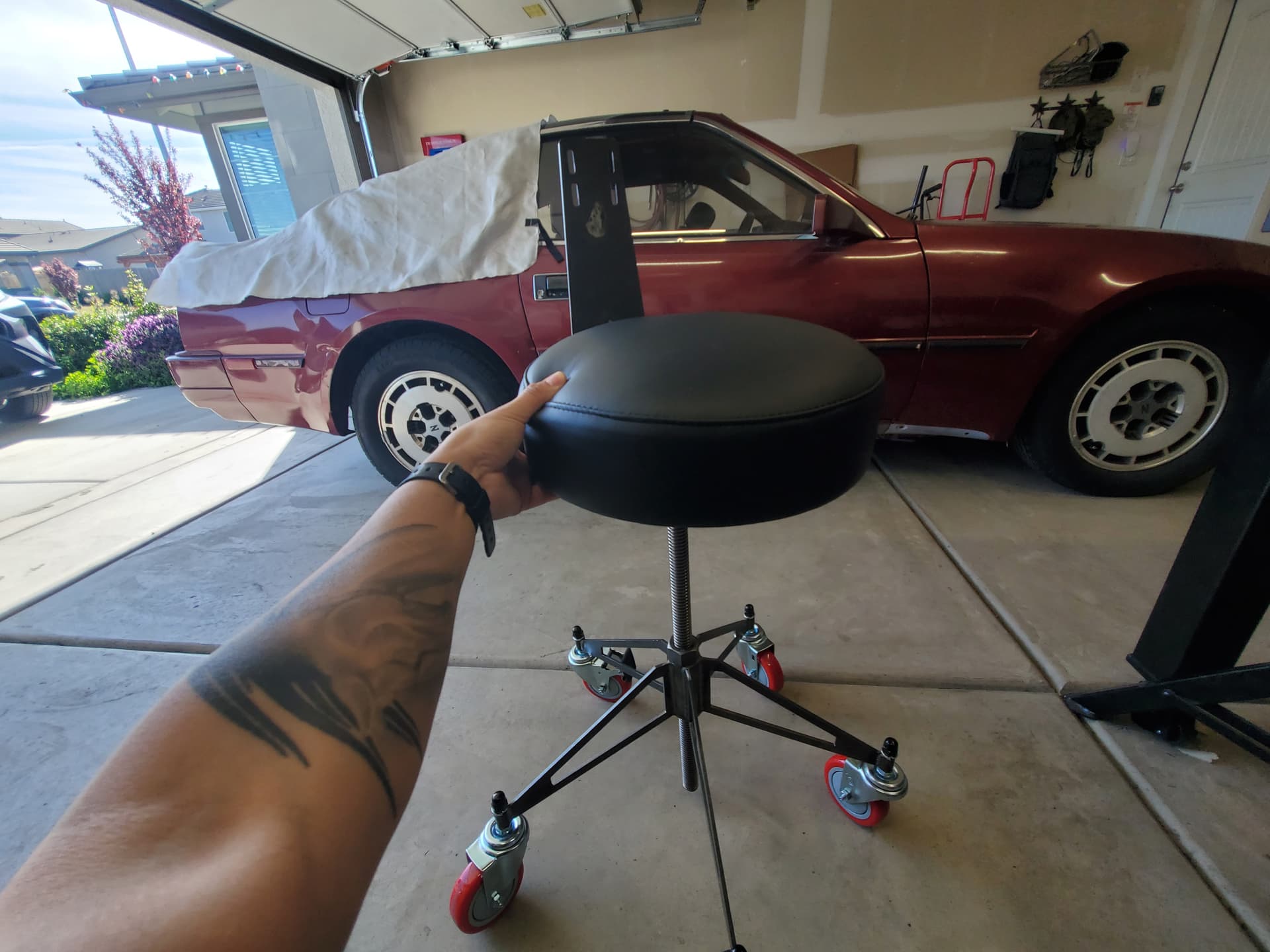

In the bottomed out position here, I will have a sit height of approximately 29.5" This is a no-go which puts me right at the same height as my current stool.
I’ll be cutting off about 7" from the leadscrew to give me a sit height range of 22" to 29", since 29" only works well at my laptop, and somewhere between 24" to 25" would be perfect for my welding table.
Ignore the footrest. I stole it temporarily off my other stool just to see how it’d look. I don’t have a tube roller and I haven’t found anyone nearby (not even my own customers) to roll tube for me with the exception of a shop.
