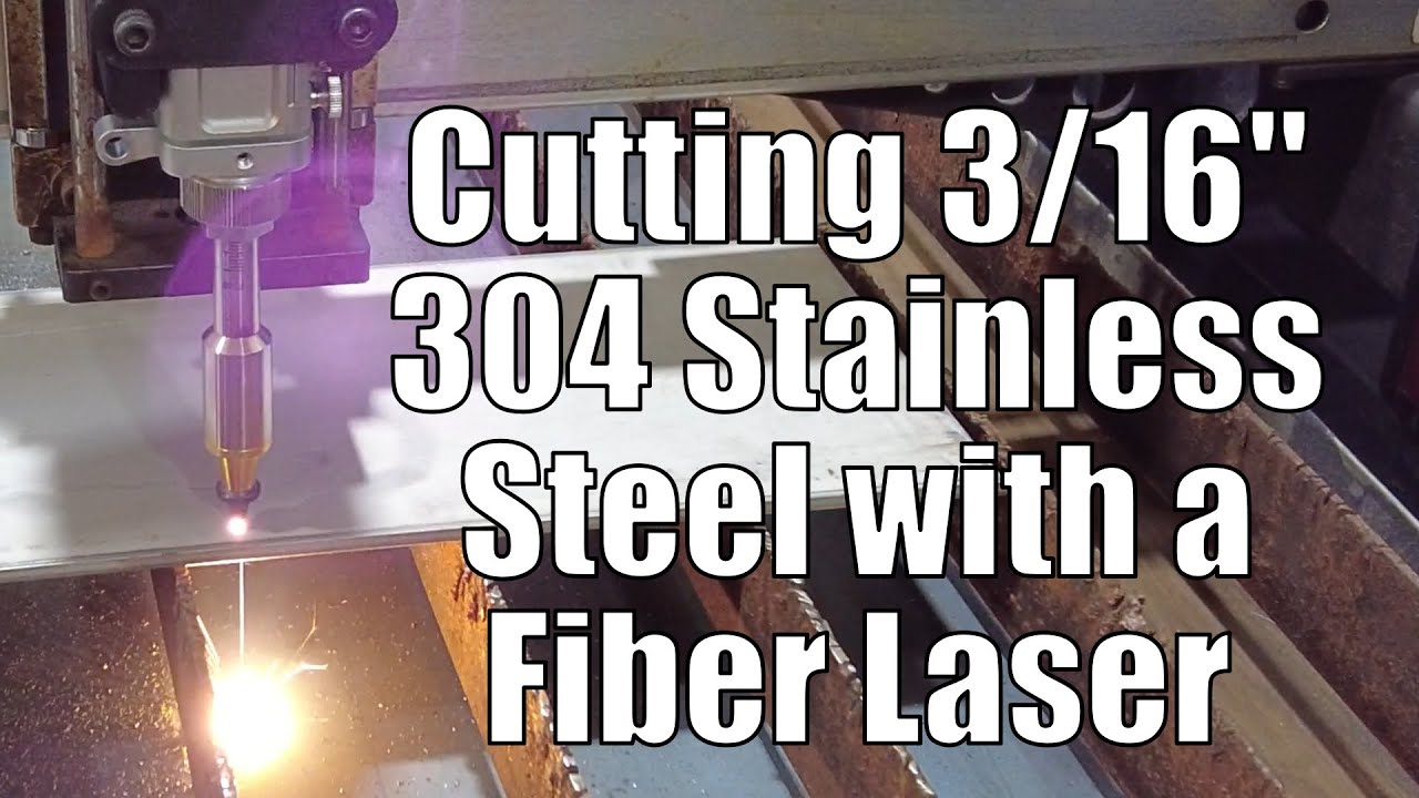

Got an order to cut a kitchen sink backsplash 304 3/16" Stainless Steel.
Got this laser dialed in!
@holla2040 , have you patched you table and tried water with additive yet? Wouldn’t an opaque liquid protect the pan?
What opaque liquid would you suggest?
@holla2040 those cuts look excellent
Cutting fluid obviously. Anything that would absorb/diffuse the light energy.
the 1/4 " piece of steel at the bottom of the pan works well too
Thanks Tim. As for the opaque liquid, we plan on building a different base for the XPro and ditching the water trays. However, we have a different potential issue, the laser energy damaging the shop floor. We address that if we see it happening.
Although I know very little about laser tables, the 12000w laser table the local shop used to cut stainless steel featured a honeycomb mirror material. Next time I visit that shop, I will ask about it.
$900,000 Table made in Germany. 480v three phase. It literally had light beams all around it to keep people from getting to close to the sheet loading area.
https://youtube.com/shorts/taLfcuEZeXA?si=tc-TUzwCvtk7Ncwe
