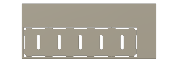

Some large panels out of quarter inch aluminum.
I added tabs so all the cuts would end up as closed contours. Find this helps with thermal distortion.
