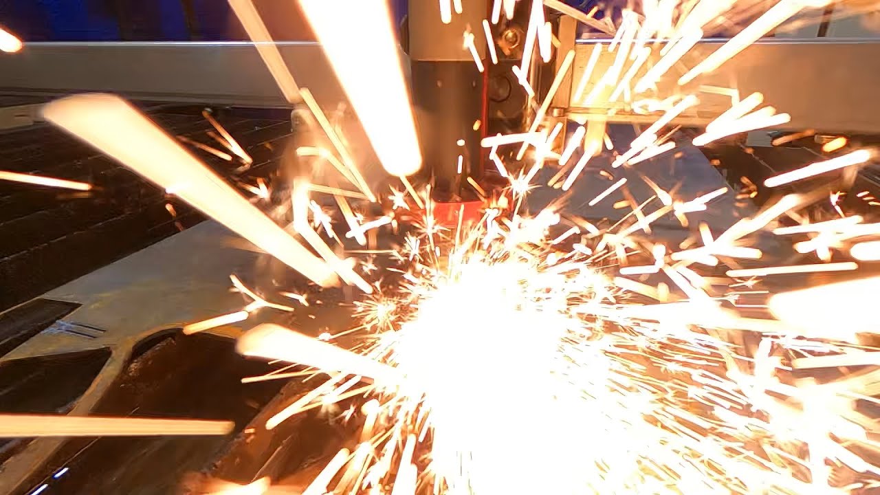

Friday off built an air dryer. I cant believe how much moisture is produced. Consumables should be lasting longer.
Why did it slow down so much?
I shot the video at 240fps for super slow motion. I slowed it down to show plasma sparks detail.
