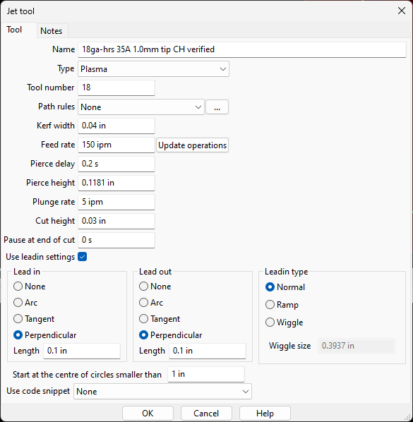

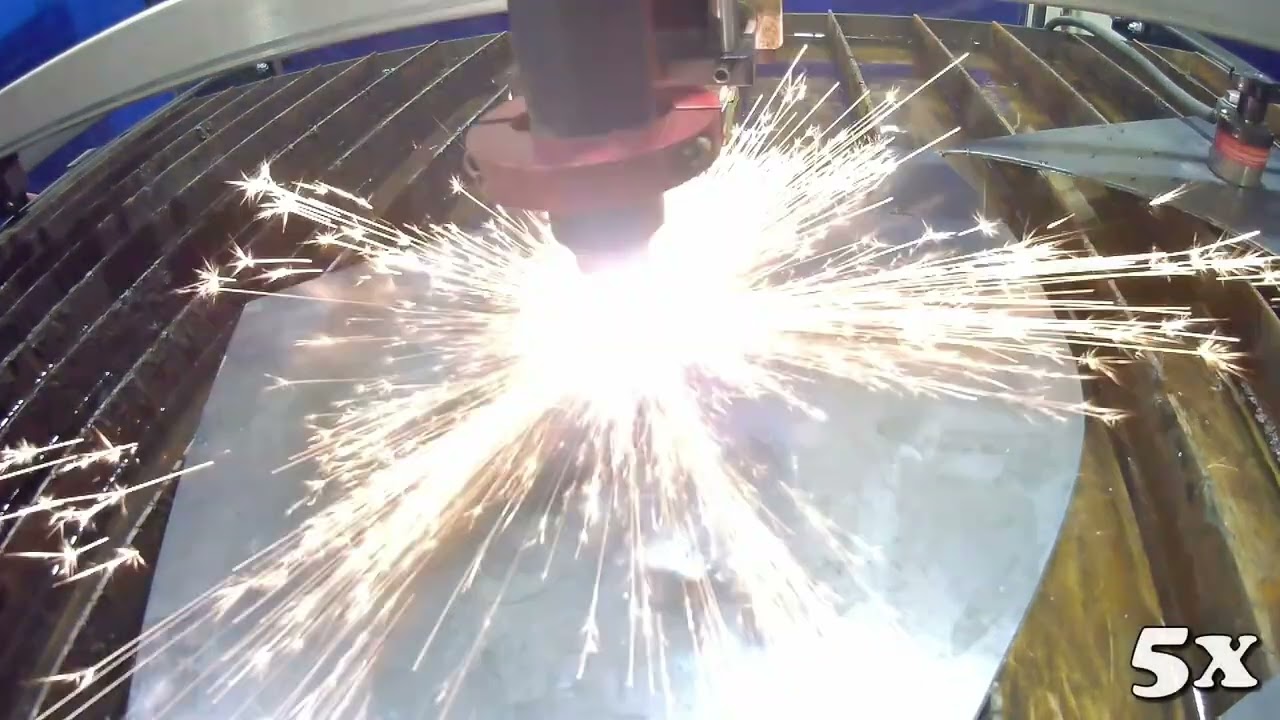

cool…but looks like you could increase your plunge rate and shorten the pierce delay to limit the “divot” hole at the start…just my thoughts…
Agree, shortening the pierce is definitely in order. I was ok with these hands because I plan on welding the finger joint slots. What does increasing the plunge rate do?
Shorten = zero lead-in, zero lead-out, zero pierce clearance and center compensation for open line cutting if using Fusion. No plunge rate in fusion if you zero the lead-in/out. Your plunge rate would be your cut speed based on material. You still need normal pierce time based on material thickness. If you did all the things above and got the big hole at the start you would want to adjust your pierce time down. Keep on cutting and sharing i really enjoy the videos and pics. Awesome project!

I get it. Plunge isn’t z-axis speed. I’m using sheetcam for this, so center cutting without lead in/out is always set to 0. I love tinkering with this stuff and reading comments here for tips and tricks. Thanks for the encouragement.

Plunge rate is the rate of speed in inches per minute that the Z axis moves from Pierce Height to Cut Height.
In fusion 360 the default is 100 ipm
In SheetCAM the default is 3.947 ipm which most users change to 60 + ipm.
Ah, now that makes a lot of sense. Does a slow plunge rate cause this problem? On no offset cuts, the pierce seems to travel a bit before starting the cut movement. Or is this a z-axis alignment issue?

Yup, mine’s set at 5ipm, look forward to kicking that up and see what happens.

The torch should not move X or Y until the pierce is completed and the torch is at cut height.
I also reduce my pierce delay to .5 then reduce it to 74% in firecontrol. 1st pierce will always be longer then you set it .

The slow plunge rate effectively extends the pierce delay by increasing the time it takes to get down to cut height. The motion doesn’t start until cut height is reached, so the time that it takes to go from pierce height to cut height is increasing the time that the torch is burning in the same spot and making a bigger pierce hole.
