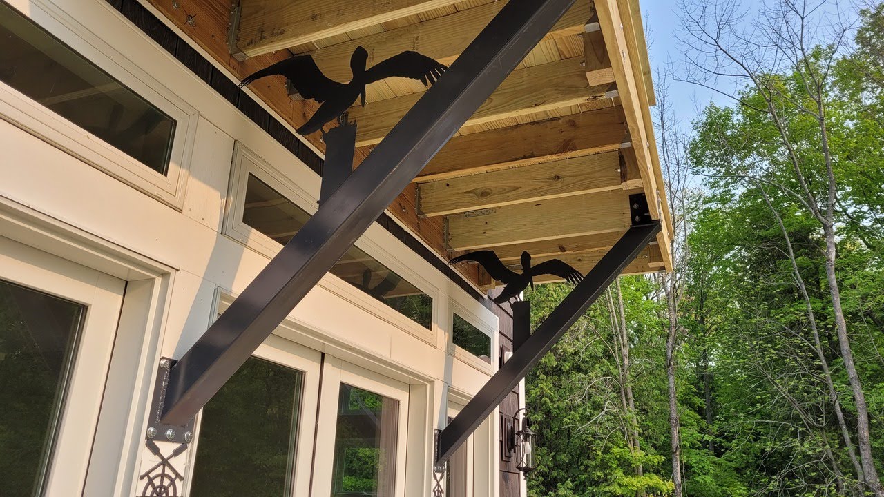

It’s 25 minutes long if you have time to kill otherwise you can skip to the last minute. Made these for family who just finished building a house on Green Bay. Still working on the deck…
Looks great. Not sure they needed the supports - standard looking cantilever that wouldn’t require additional support.
But great excuse for the decorative steel work. :slightly_smiling_face:
That’s not standard, those are just hung with joist hangers. You would need to run those joist back into the house framing for any strength.
I take it that little deck/patio was after thought
Ah. I thought they had just put that leger board on the end of the deck framing and added the cantilever instead of running the joists out from the house or even adding the new ones as sleepers to the existing structure. It didn’t look like it was big enough for an add-on deck.
I still like the pelicans - they looked really good with the water splashing creating depth and definition to the design :slight_smile:
Unfortunately it’s not cantilevered, it should have been though. When the house was framed that balcony appears to have been a complete afterthought despite the fact that they framed in a double door opening on an exterior 2nd floor wall…We used 10 tension anchors to hold the joists tight to the house because the struts will cause some of the downward weight of the balcony to become lateral force pulling the balcony away from the house. We’ll see how this holds up, it’s definitely probably most likely not code. The base of the struts at the house are lag bolted into 4 2x6’s sistered together as a column so there is plenty of strength at that joint.
