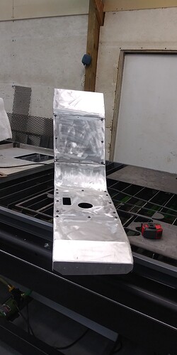

.080 aluminum cut on XR w/Hypertherm powermax 45 XP. Settings- 225 imp, 45 amps, .060 cut height, THC 129 nominal volts. 80 air psi torch setting, and 120 air psi to plasma cutter.

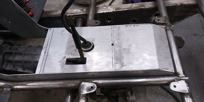

center console pieces for offroad buggy build.
That looks like a fun project!
Nice work
what is going on here ?! are you using those as air bumps?

Center console welded up and waiting for gauges
