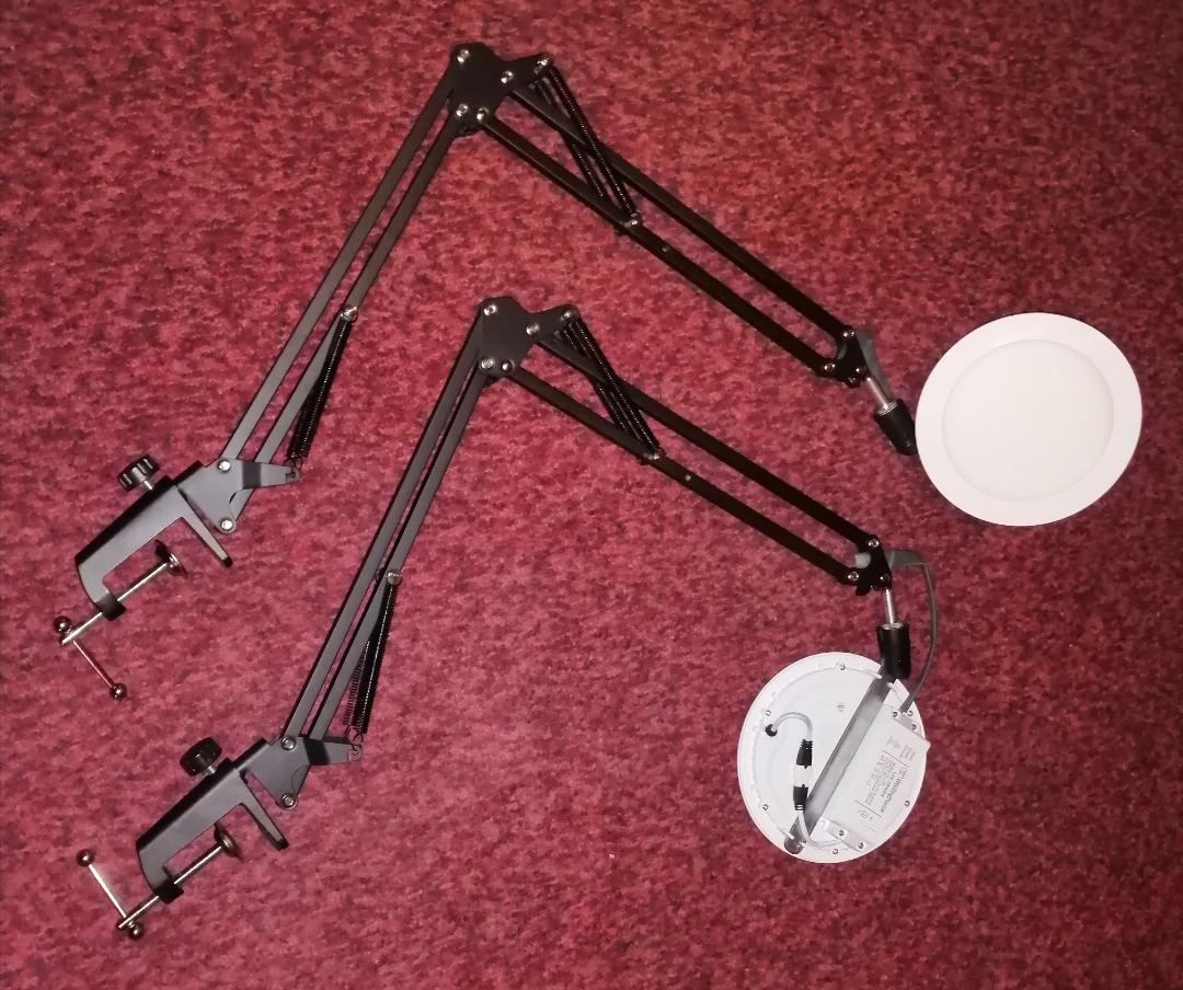

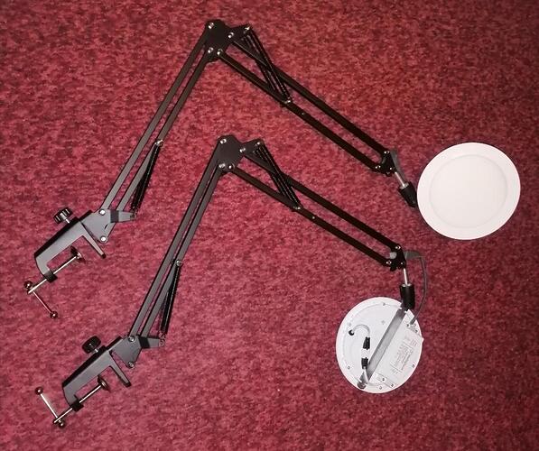

Completed two really nice work-lights today for the mill. Two cheap microphone booms and two Westinghouse 69032 LED downlighters. Each 12W, 6500K, they’re really bright and no shadows.

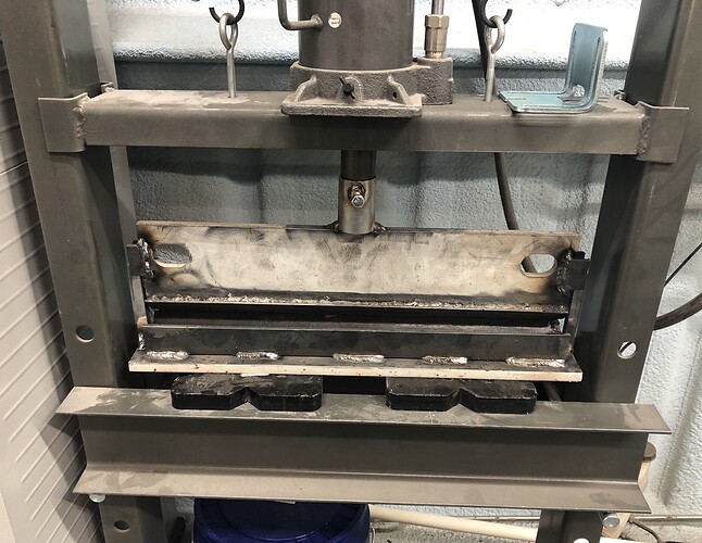

Got bored waiting for the table, so I through together a little press brake from some scrap I had laying around.
Nice! … Waiting for the new, expensive toys to arrive can be excruciating! :joy:

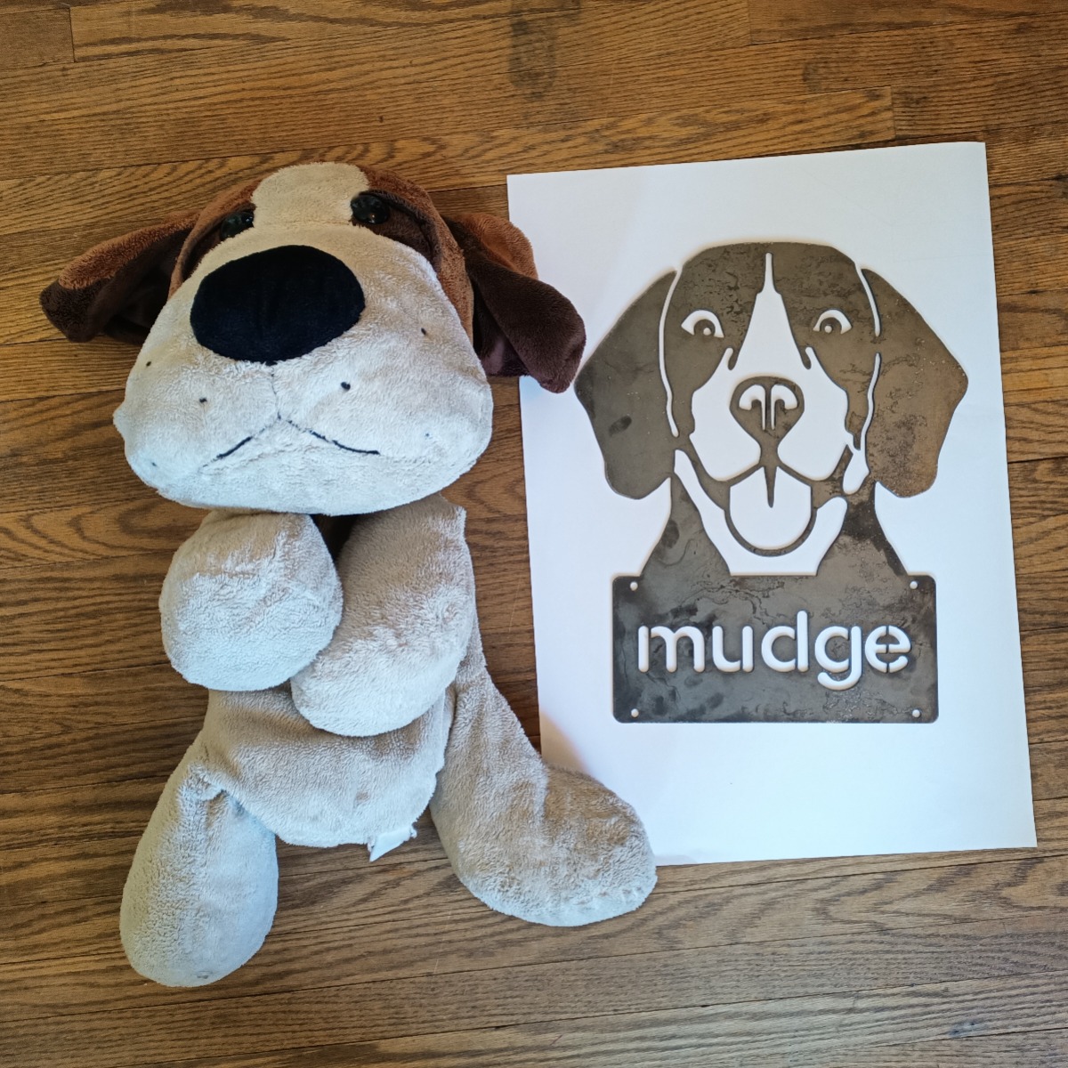

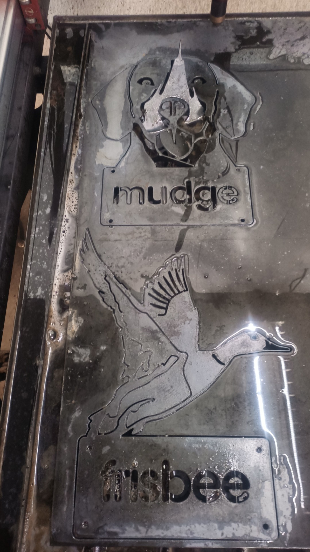

My brother was in town so I walked through the whole process with him. we designed up two signs for his kids stuffed toys not sure why but here is the results.
14ga mild steel running a hypertherm 85 with 45 amp shielded consumables at book settings.
Cad and cam was done in fusion 360.
These are about 11x16

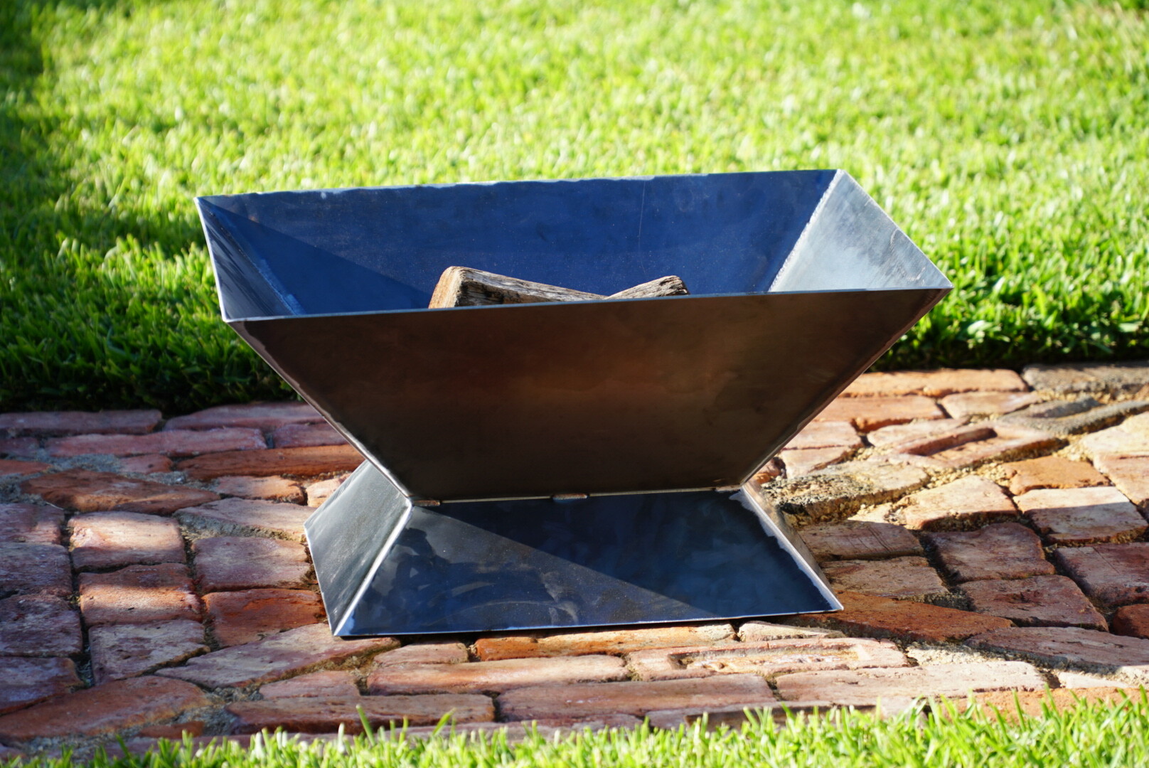

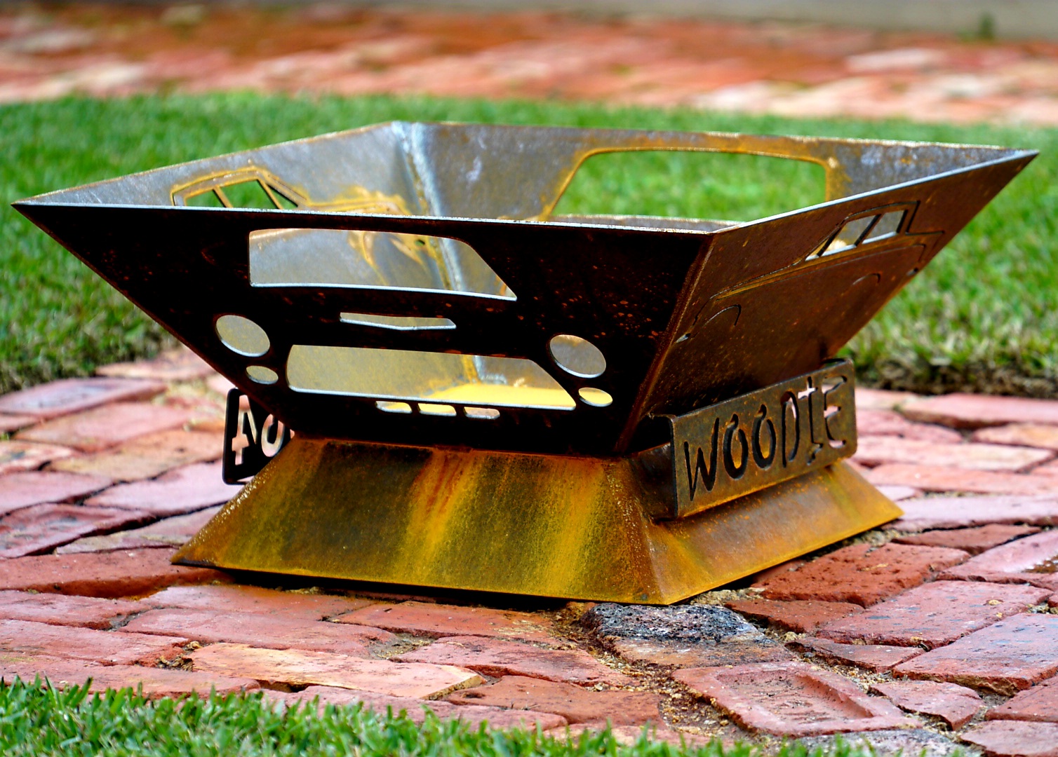

Couple little fire pits…

Looks like langmuir reposted you.
Friggin’ narc crying on there. Lol.
What a boner.

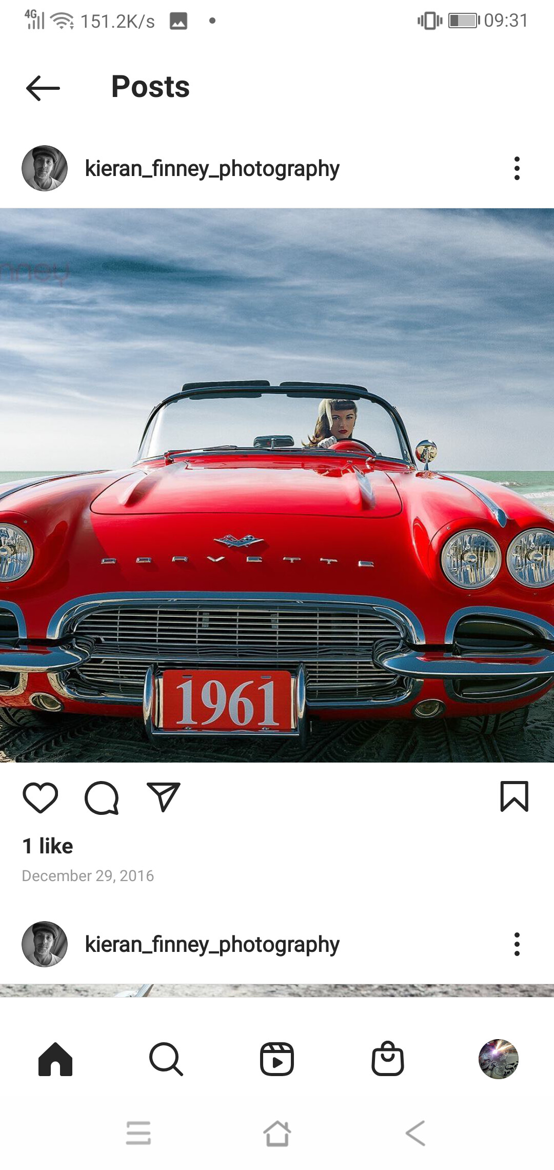

And like most boners this dude looks like a huge hypocrite.
Using automotive and beverage product placement in your photography.
What’s the difference really?
very interesting !
From my side of things, the fire pit its not a commercially available item and not sold for profit ! it is a birthday present for a close mate. The purpose of use regarding the logo and text is different from the registered trademarks purpose. From Langmuirs point of view I am not sure how it works !
Yes you are right tho !! Boner … you will find commercial photographers are all about ownership and copyright etc. I get it as I was a commercial photographer many years ago !
Coming from a business point of view, its not about the logo or the text. Its all about the cut quality and the precision of the Cross fire pro.
