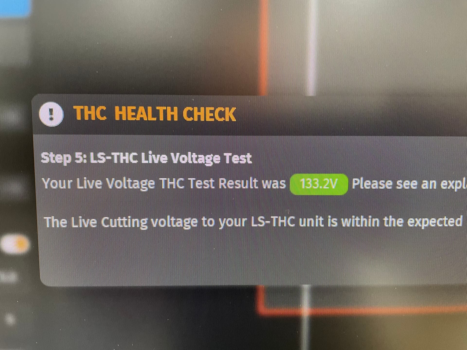

As some of you probably saw, I also installed the new Langmuir Limit Switch Kit and had a small issue with one of the Y-Axis motors, but the tech guys were awesome and got me the new part in a hurry. After that, the hard and soft limits were set and the machine seemed to be moving fine. All that was left was checking the functionality of the THC on the Z-axis and to test fire the plasma cutter to see if it actually worked… The calibration seemed to go fine and I got around 133V on the torch.
So the next step was to throw a thin sheet of steel on the table and do a few manual 1" cut tests to confirm that all of my efforts were going to pay off…
It worked great!!! I had the plasma cutter running around 90psi and 45A initially… turned it down to around 30A just to see if that made any difference…

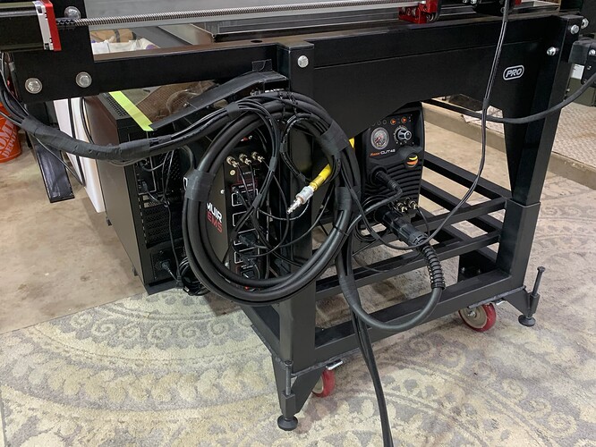

looks great…but you will need to remove the carpet or expect a fire soon…
I would put a cover over your control box…it will get splashed back there…
and if that is your plasma beside your control box…not advised…you could get electromagnetic interference issues
other than that looks great and you are doing a great job walking…

A few more photos for clarity…
Acrylic splash guard was installed to protect the control box and the PC…
Here’s a shot of the control box (left rear corner of the table) and it’s proximity to the RazorWeld45… did not give EMI much thought when I was looking for a spot for the plasma cutter (if I’m being completely honest)… and now that I’m looking at that big loop of torch lead right in front of the controller wires, that may not be all that awesome either…
Nothing is permanent… and can be changed if necessary. It’s a learning process so I’m glad I asked… (and glad you answered).

You need to get some of that stuff out from under the table. Also the picture of the plasma cutter, its set in 4t and need to be in 2T for use on the table.

Water and electrical don’t go hand in hand, never have plasma machine under a water table.

Yeah, the whole concept of a water-table based 220V plasma cutter is terrifying if you really think about what is going on for any length of time… The control box and PC have a good shield above them now, and the plasma cutter is under a fully-welded water table. I could probably do a splash shield above it just in case I ever had a leaking drain pipe to add an additional margin of safety, but ultimately I need the machine to be self-contained and portable. I tried to make the best possible safety and packaging choices based on that requirement.
