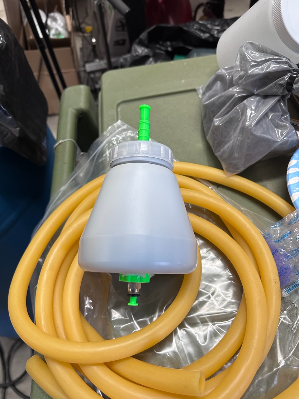

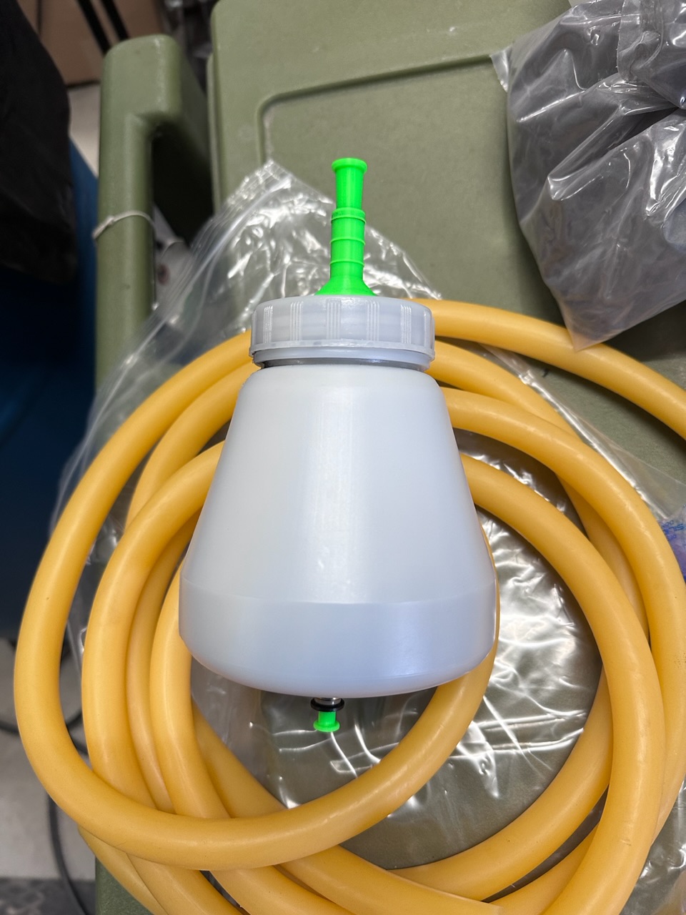

I have the Hyper Smooth 3.0 with the Omega gun. Do you have the complete hopper with the plugs ready to use? The parts I ordered from you before worked great!
What size containers would be ideal? Can I use a 32oz container?
I have not used a container that large so I am not sure how well it would work. I use a 20oz container for most of my personal hoppers. 32oz might be too large to fluff the powder properly and get too heavy when filled with powder.
Do you have a link to the jars you use? I’m seeing 16oz and 24oz all over the place on Amazon but no 20oz. Would 24oz work? I did get the order cancelled last night so I’m ready to order some of your hardware.
I use usplastic.com 625cc PET packer jars, only because I had a bunch of them from my Eastwood Dual Voltage System. I have a few customers using Uline S-18071 wide mouth jars and they are really happy with them.

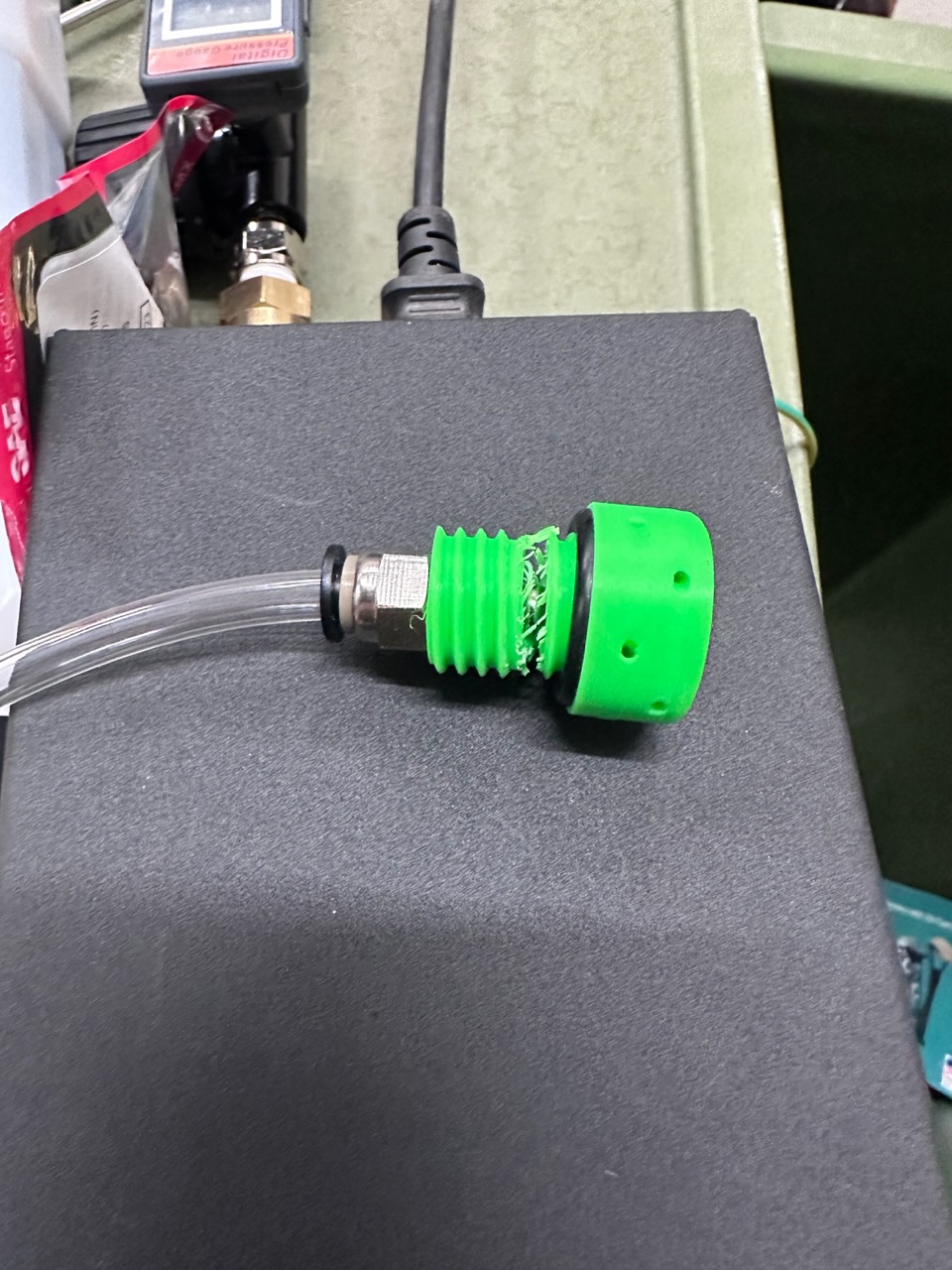

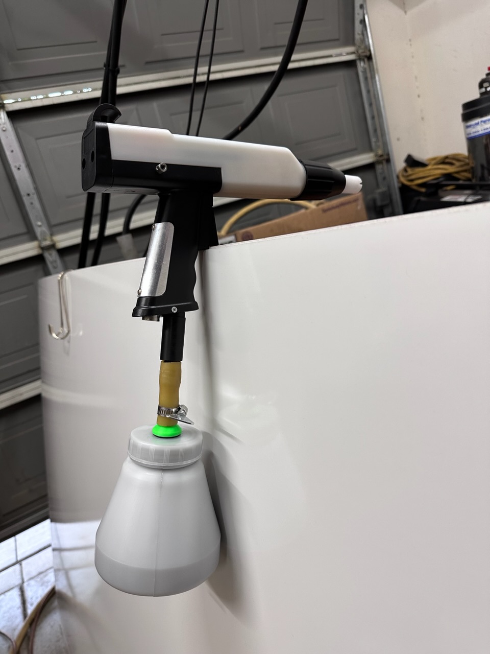

I also just bought some of those fittings (the universal type) to convert my HF PC jars to fit the royal coats PC gun I just bought. I was able to get 3 standard and 3 shorty’s on the 5+1 sale.
The first one was a fail. I hand tightened it and checked for leaks and was leaking from the bottom so I tightened a lil more at a time until no leaks but I must’ve stressed it out and it eventually gave out…
The 2nd one I just applied as small amount of hot glue on the bottom and tightened it until snug, let it dry and works great.
The gun has a screw on connector on the bottom not a quick disconnect like others but royal coats makes a screw on barb connector to use with 1/2 hose. I just cut a piece of the hose to connect the gun and jar together. The bards on the printrovert fitting are a lil too small for 1/2 hose and didn’t grab it tight so I had to use a hose clamp to keep it secure.
All in all thought, they are great fittings. I’ll get more as I get more variety of powder.
Thank you for the order, shoot me a DM with your address and I will get a replacement sent out ASAP. The o-ring should be enough to seal, but I have had a few odd ball jars that I had to smooth out flashing lines on the bottoms to get them to seal properly.
