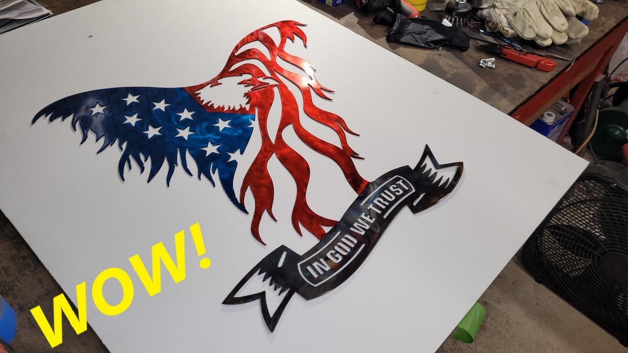

Did my first candy paint job, and thanks to Unknown Coatings I finally got masking figured out! This sign turned out even better than I hoped, primary design by Aidan from FireShare! I made a couple little tweaks, nothing too major.
Awesome video. I watched a video where a guy was coating Porsche calipers in red with the Porsche name in white and he cooked them to 160 until the powder flowed and then pulled off the decal. I wonder if the lower temp for the red is to prevent it from turning darker than it’s supposed to? Is there a difference in using the yellow gas bottle vs the blue?
Yellow is MAPP gas, it’s hotter than the blue and green bottles that are straight propane. I will be doing some stuff with lettering and logos with the vinyl plotter this spring I think, those will be cool videos.
Nice video. Awesome sign! I was having trouble using foil too, put over powder it “glues” on. I tried parchment paper, solved that for me. Ive had good luck for clean lines, no adhesive using frog tape and I remove the tape before the part goes in the oven
I’ve always heard that you want to flow your powder before you pull the tape so you don’t get powder puffing on an area that is supposed to be clean. Frog tape is good stuff though, I use it for traditional painting. Parchment paper is a great idea, I’ll have to pick some up!
I have had powder spill over on the surface I was attempting to keep clean. I just used a fresh piece of tape and dabbed the spilled powder with the sticky side of the tape. Just seemed like using the high temp tape and letting the powder flow out I would either remove some of the old paint or leave adhesive behind. Seemed to me, using frog tape worked the best
I was having a big problem leaving adhesive behind, I reached out to Unknown Coatings on YouTube and he said heat it up to 180-200 for a couple of minutes, I did that and the adhesive problem stopped. Using the sticky side of tape to remove spilled powder is a really good idea. 200 is the absolute limit though, I let it get to 225 for the blue and it was leaving adhesive behind again. I don’t like the high temp tape, it’s very rigid like thick cellophane.
