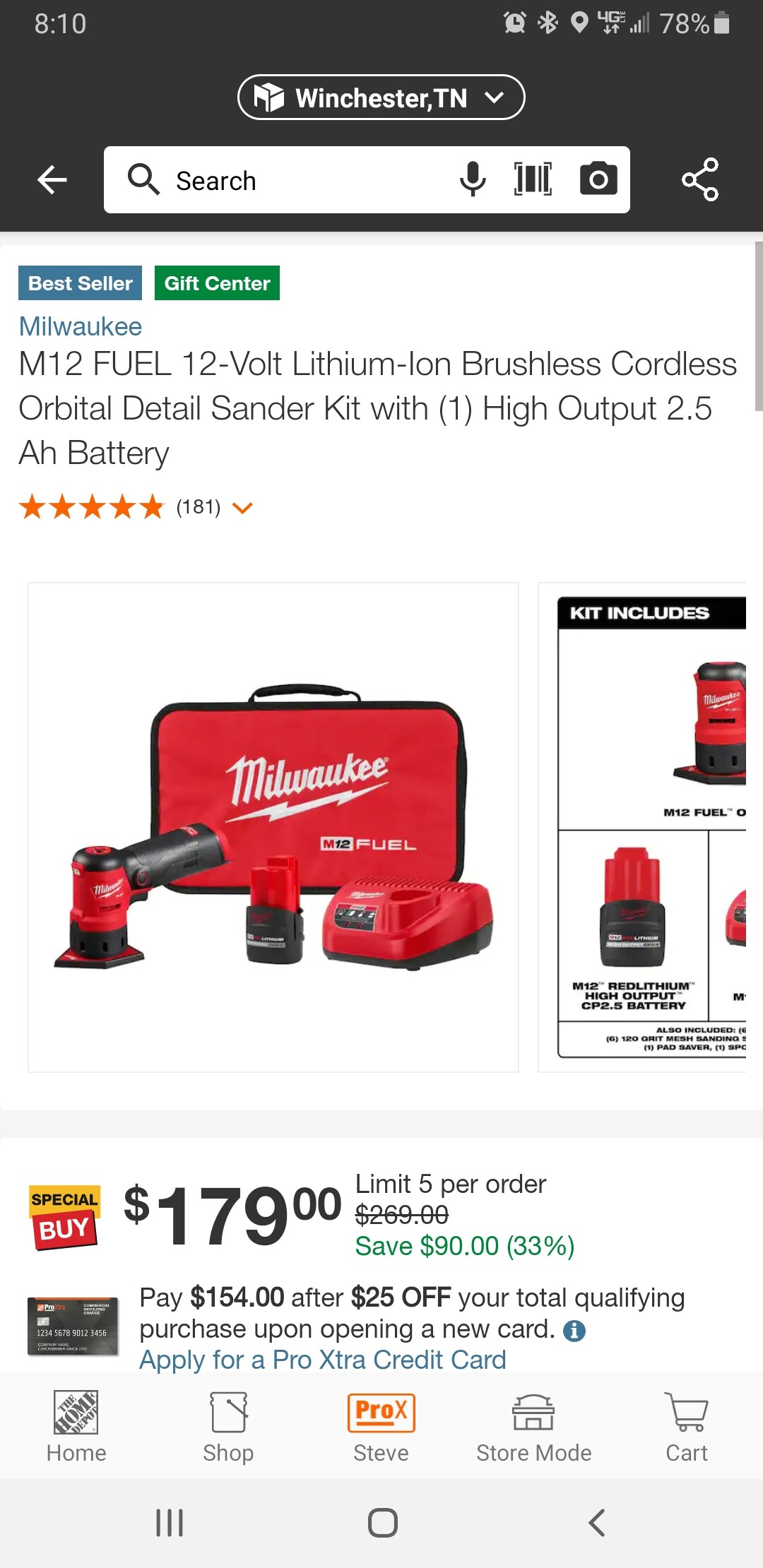

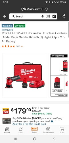

They have these “special buy” units on clearance at Home Depot for $99. The mesh pads works great for sanding powder coat when you have a f up.

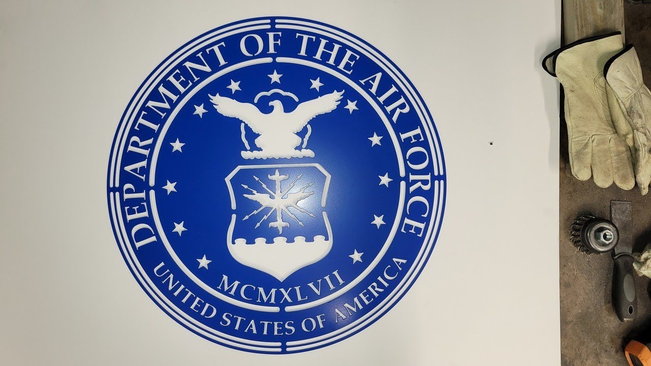

I preheat for a couple of reasons, big one is what Teknic said. When I sandblast the compressor is running almost the entire time which puts a lot of condensation through the line and while my water filter catches most of it I can still see it putting moisture on the part when there are big temp changes which happens really whenever the compressor is running because the temp shifts when the air is compressed going into the tank and when it decompresses leaving the nozzle in your cabinet. The second reason is that sandblasting generates a bunch of static and preheating dissipates the static and that helps prevent edge pull on the sharp edges and thin lines on the sign.
It’s not so much for outgassing as cooking off the moisture and static I added while sandblasting.

I forgot who mentioned that cooking helps dissipate static but they were right. I had a sign that was edge pulling hard, nothing I did was solving it and I cooked it, resprayed it and just like that the problem was gone so whoever that was thank you!

The last in the line of unofficial official service branch seals is up. I made a few changes from my original version of this seal and then covered it in super matte blue. This one can be tricky because those really thin outside borders can edge pull really hard, this design needs to be preheated because of it.

Have you noticed problems on edges more with some color than others?
I just did some with a very glossy bright Red and it pulled from the edge a little, I have never had a problem until these red parts.
I read that powder quality, and color play a big role and preheating also helped. I really hate adding another step to the process by preheating.
I would like to try some Tiger Drylac and see if there is a improvement with better quality.
