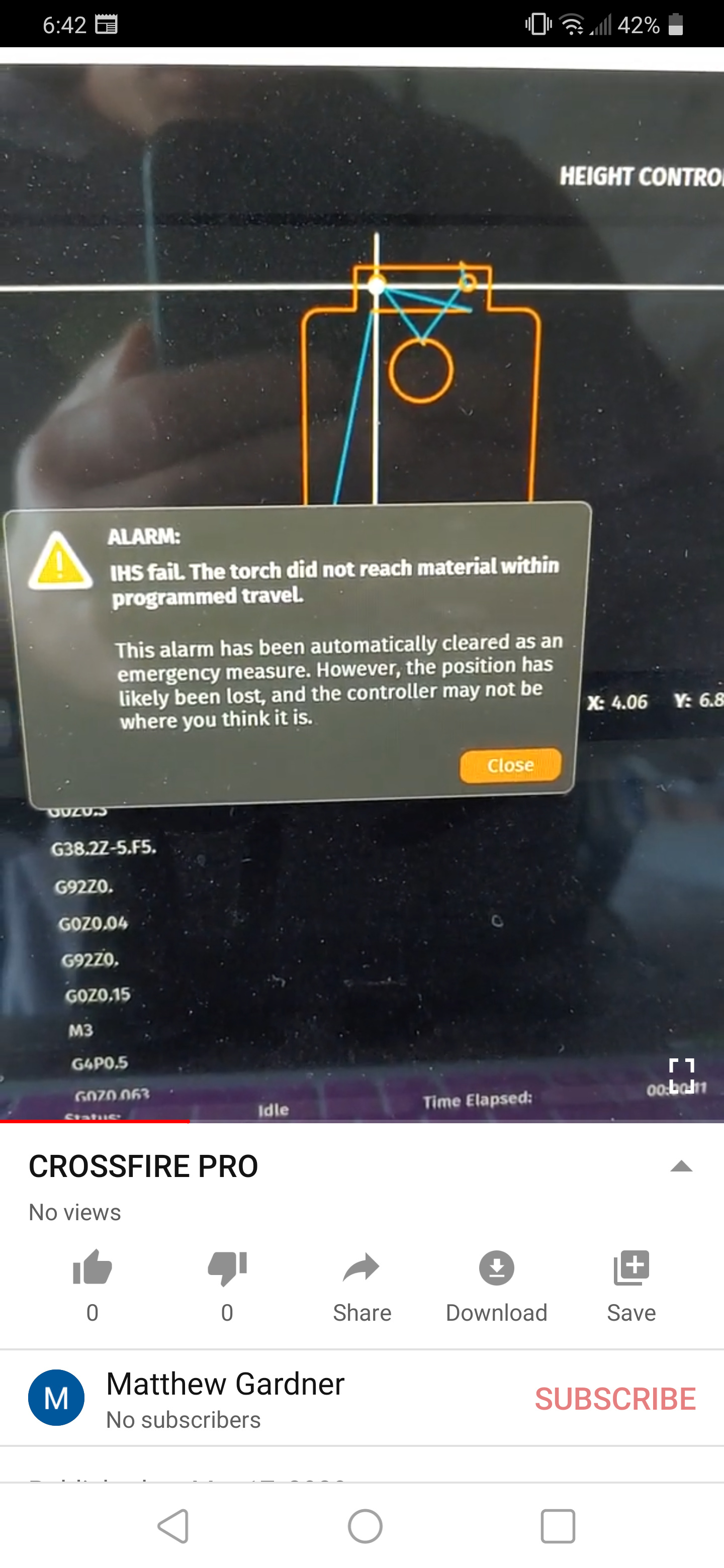

Having this issue when I have 2 cutting profiles and going from 1st profile to 2nd one immediately. Im sure it should be an easy fix, but not sure what to do.

I believe your problem is being caused by a known bug in the post processor. What’s happening if you look at the GCode at the end of profile 1 (labeled (2D Profile4):
H1   (Turn on Torch height control)
G1 X2.8889 F85.   (coordinated move  at 85 Inch per min, this does the first cut)
M5 ( Turn off torch)
Then it does a rapid to profile 2 position start. The problem is that THC is still on, but there was a torch off command. So you get the error. It should look like:
H1
G1 X2.8889 F85.
H0
M5
G0 Z1.
What needs to happen is the torch height control be turned off (H0), then torch off (M5) and the Z raised 1" (G0 Z1.) before rapid move to next profile.
The good news is they are working on a fix. For now if you are comfortable editing the GCode (any text editor will do), you can try adding what I did above and see if you get further. Note you should also fix up the end of your program so it looks like:

@Greg9504 hit the nail on the head. Definetely a post issue that we are aware and working it. For some reason the H0 is omitted after open lop cuts. We will get it sorted an should have the revised post on the website tomorrow. In the meantime if you create any programs that have open loop cuts, make sure to manually add the H0 in notepad.
Looks like a nice splash guard you’re making :wink:
We are trying to reproduce this issue and develop a solution now. Autodesk seems to be making changes on a daily basis to the functionality and UI of Fusion.
Originally we thought this was an issue with open loops (lines without lead ins/outs that don’t pass over each other) but to accomplish this straight line cut with Fusion you need to seperate the open loop into its own profile, enable lead ins and set the length to 0 (as otherwise the latest Fusion seems to put Lead-ins anyway). We haven’t been able to get those lines to not show up.

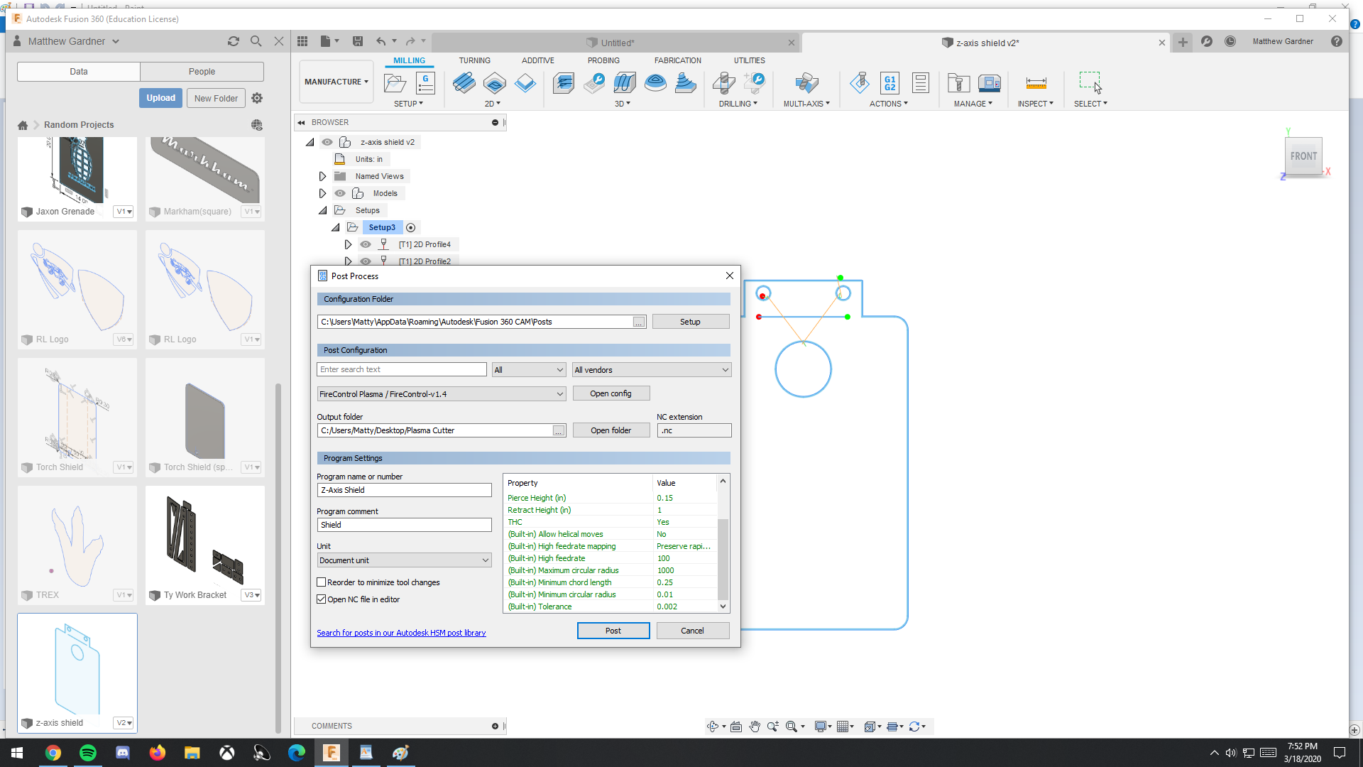

We are seeing the THC Control (H0) and the Z-retract (G0 Z1.) in the outputted Gcode.
What are the Tool/Profile settings you are using in your program? Can you provide the DXF as well? Are you using the default Fusion Post v1.4 values?
Thanks for helping us figure this out!
Attached is straight from fusion
Z-Axis Shield-a.nc (3.0 KB)
I did notice on mine that the H0 and Z retract arent being put in there while post processing. Haven’t changed any of the info on the post v1.4 besides the cut height that I haven’t used yet(too high on my last test piece) Also the first cut of the second profile isnt adding the cut speed on the first G1.
