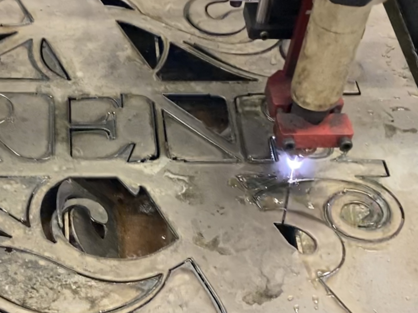

But also notice the torch is not lifting up after the torch turns off.
Mike-- Along this line what happens if your g-code is built with H1 commands but you turn it off in Firecontrol? Does it just ignore them? Also, the second G38.2 touchoff slows the Z axis feed to 14.286ipm. Is this optimum for all X & Y feedrates?
In what program do I add the code? Fusion 360? FireControl? NotePad?
I’m assuming this is something that will be fixed in either a post processor or FireControl update and hopefully soon as tonight, I created an additional setup/ cut for a tiny loop in a monogram name sign and when the first setup completed, the torch stayed down and on and sliced it’s way to the start of the loop in the second setup.

Greg9504,
I’m probably not comfortable editing the post processor but okay with editing the GCode. I figured out Fusion uses Note Pad as the editor and saves any changes to the created .nc file.
One more question. What code should I add after the first proflie cut and before the second so I don’t have the same problem? H0 M5 G0 Z1.?
(heres’s the last four lines of 1st profile cut and the whole profile 2)…

Greg9504, You must be a software guy. Thanks for taking the time to help. I really appreciate it.
Mike, uh I mean Blue_Steel :wink:
I’m starting to miss my original CrossFire…
Sorry, was outside cleaning my garage all day trying to make room for the table…
Can you attach the complete gcode file? Are the 2 ‘profiles’ in one drawing that you posted?
FWIW this is a minor issue with the gcode gen, I wouldn’t worry about it too much. A working THC will make you forget the original in short amount of time.
I’ll attach the file. Ahrens Monogram Final.nc (54.1 KB)
Yes, both profiles are in the one drawing. I create the second with a different small kerf tool to be able to cut the small loops in the design. Not sure if there is a better way to do it but it has always worked for me before.
Again, I appreciate you looking at this for me and taking the time.
At the end of profile one add:
G1 X18.3562 Y4.5462    (existing line)
H0
M5
G0 Z1.
(2D Profile2)  (existing line)
H0 returns control of Z to controller (turns off THC)
M5 turns off Torch
G0 Z1. does rapid move of Z up 1"
