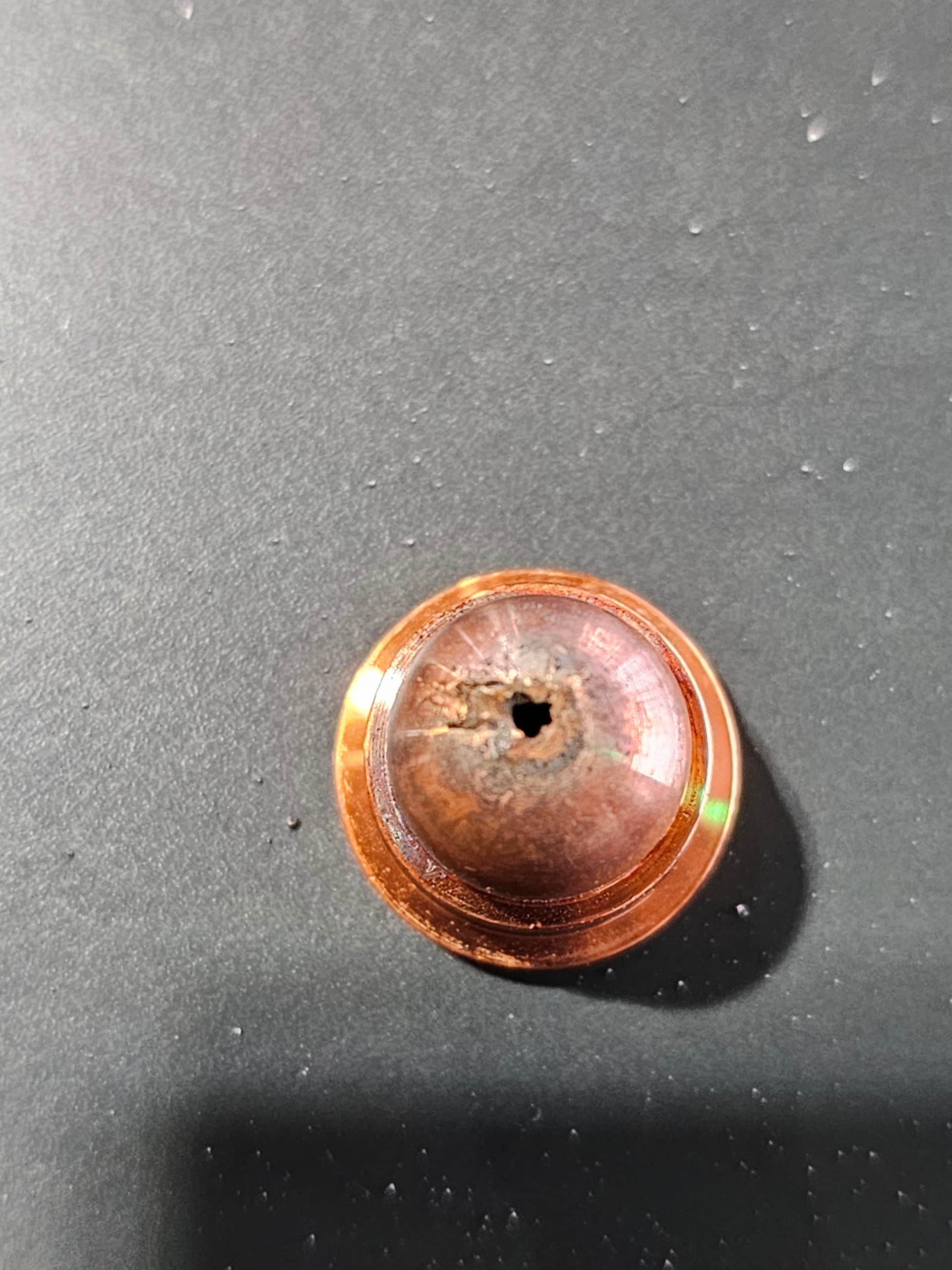

You may want to measure the orifice on the nozzle to ensure it isn’t a manufacturing defect.
Again, assuming installation was correct.
After all the feedback, I believe that I am the issue. Like @TinWhisperer said, I’m just struggling to believe I misaligned them that many times AND can install the regular nozzle/electrodes just fine.
BTW HYP has already replied and I am in the process of responding with pics.

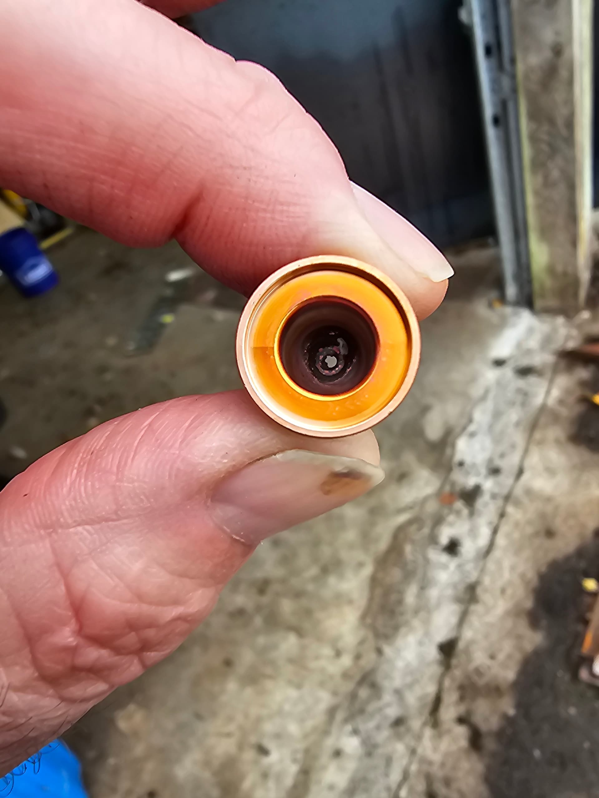

That electrode is bad, it is firing off center. You would have to work at it to install it wrong unless the swirl ring is bad causing that. The swirl ring just slips down in then the electrode slides into the swirl ring. Unless its a bad swirl ring, dirt or something you can’t mess it up.
What do you think of the inside of the nozzle? It’s like it’s showing a contact point on one side. It is possible to put them in crooked if the nozzle doesn’t seat. You’d have to crank on the cartridge though I think and you’d think the machine would throw an error.
Does the electrode contact the nozzle when firing?
The only way to get things off center is if the cutting tip does not fit squarely in the retaining cup. Yes the electrode makes contact with the cutting tip that is how you get the pilot arc.

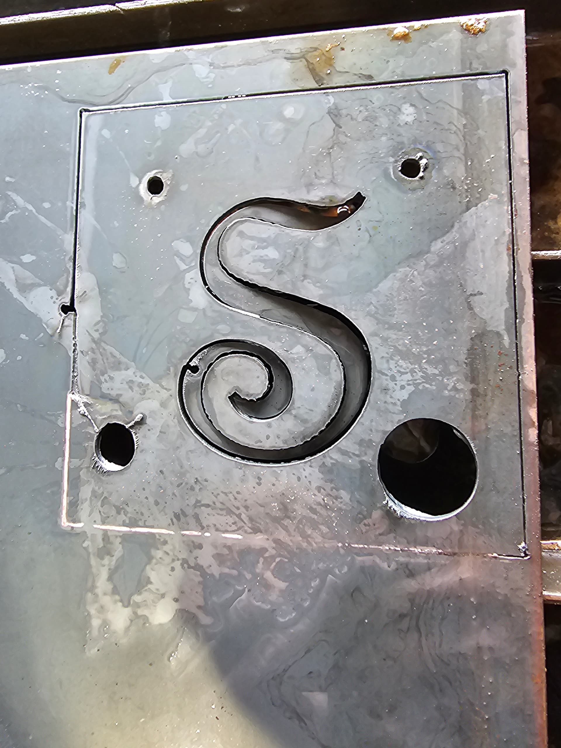

Brand new electrode and tip, again lackluster results, certainly an improvement but still have issues. The torch went out during the cut and actually drug across the steel, fire control didnt detect the flame out. I have videos of both the cut and thc display that I will attempt to upload after this post.

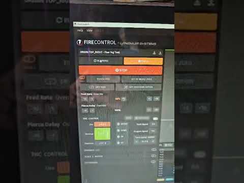

Try this link for the THC status display
no idea what happened with that upload…
Make it un private.
Have you tried with THC Off?
Link updated
Stll can’t see the video on here. I’ll try with thc off now
Video is pretty hard to see what THC is doing # wise but sure looked like the down and up light we’re on for a long time.
Wonder if video would improve if back ground lighting was off. Also a larger view would help so we can see what is being cut

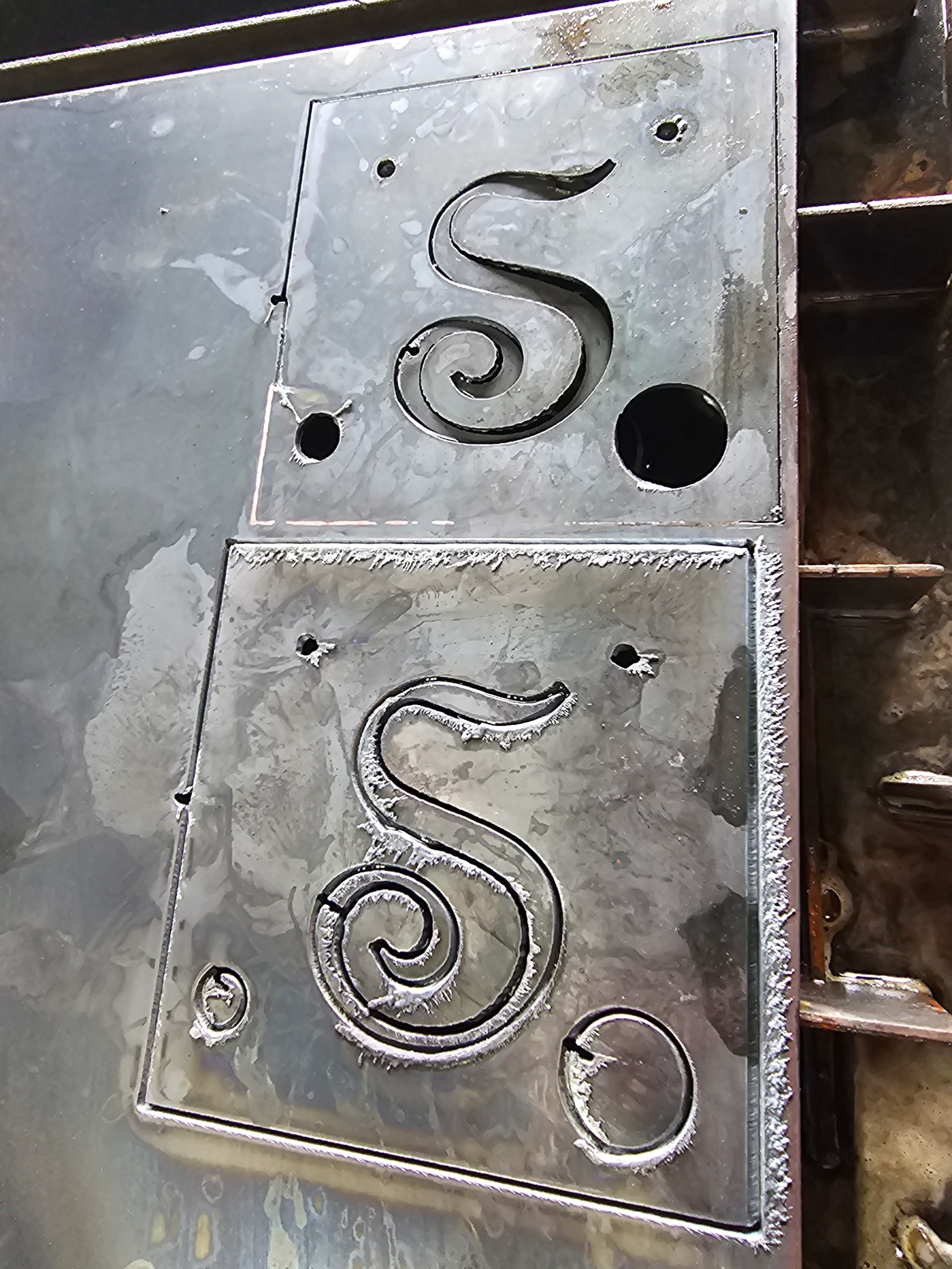

THC off looks like my OP

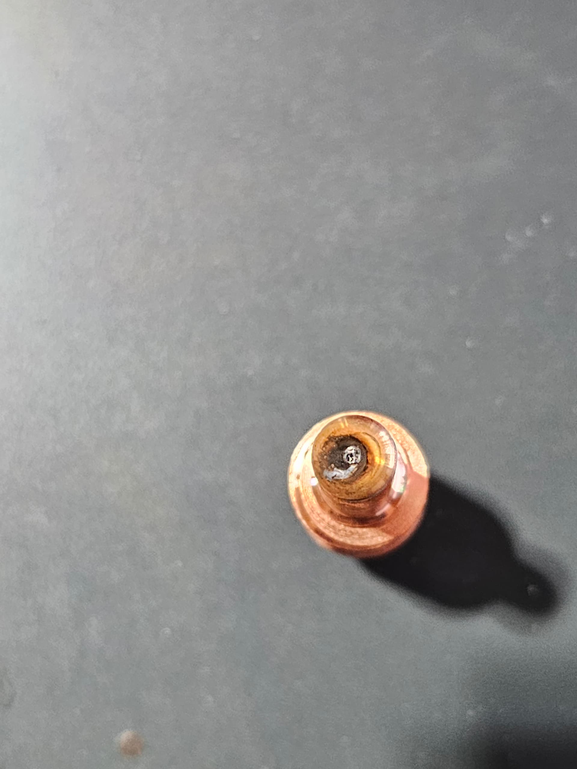

Consumables after those 2 cuts
That’s no good. Not sure if this has been asked “have you verified your cut height?”
I guess you did say you get good cuts with regular consumables right?
