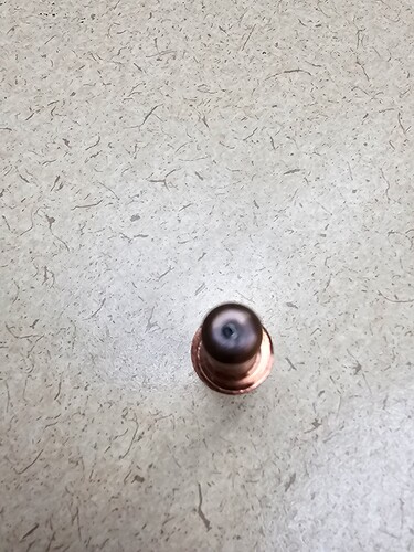

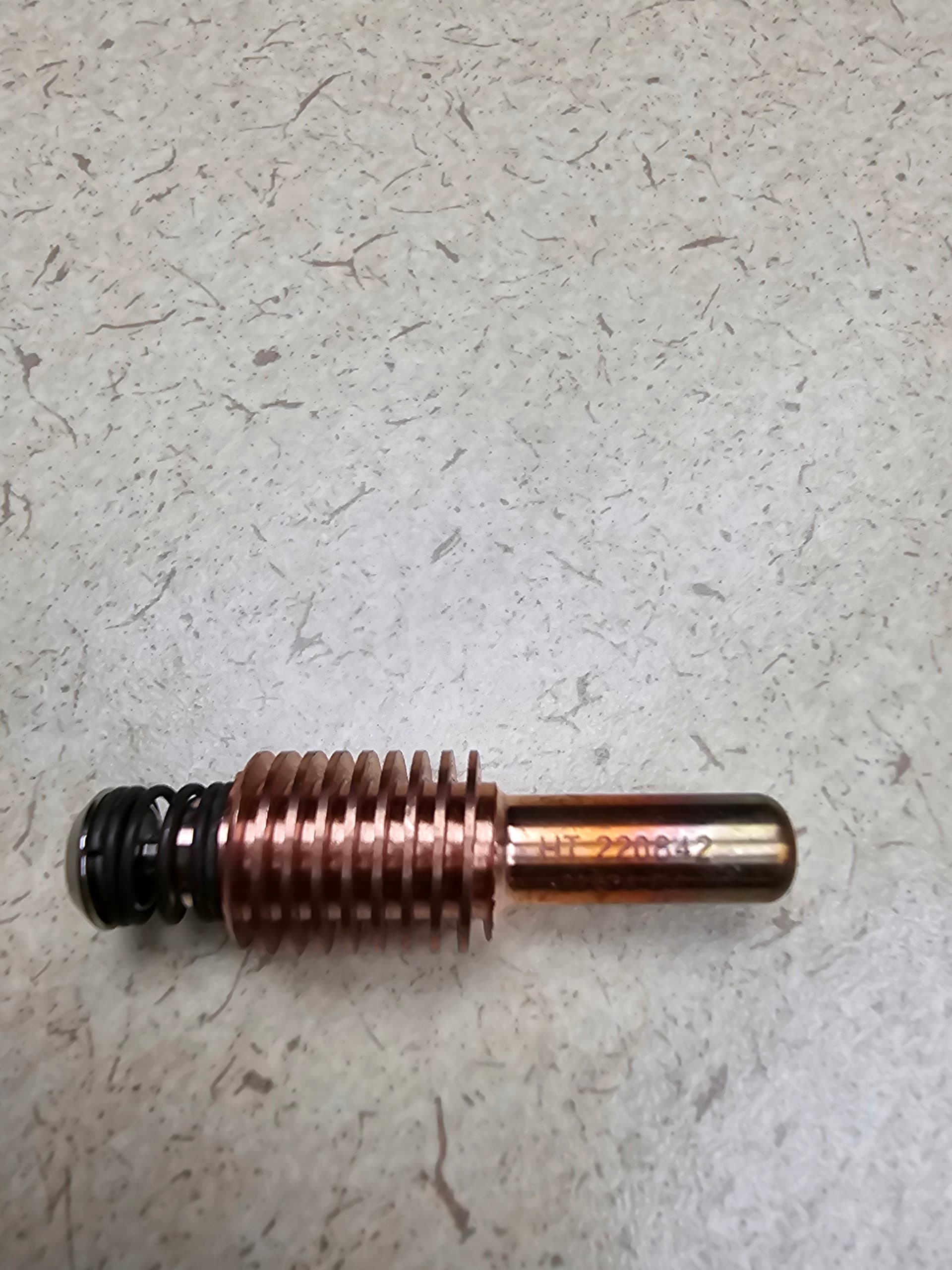

4 times fine cut were installed crooked? you think once out of four he would have installed them correctly.
even a clear photo with better lighting
I also fine it interesting that the misalignment would cut inside paths but not outside paths.
Yeah, I mean this would be a first time for us hearing of getting a faulty electrode from hypertherm.
But also looking at the electrode it’s missing patterns that we normally see. Unless he wiped it off before the photo.
I guess there’s more questions. 4 cuts? 4 installations?
I think you underestimate my ability to mess some s#!+ up…
and you are hitting 1000 when installing anything but finecuts?
He brings up a good point though. I worship hypertherm enough to not even consider a faulty product, but it’s possible. I just see other evidence to support it being crooked. I’d love to hear what @Kwikfab favorite support tech says. Maybe it’s within spec? Tee hee
I don’t recall having issues even remotely close to this with normal consumables. I do recall not having success with fine cuts even once.
I don’t recall wiping anything of before I took the pics

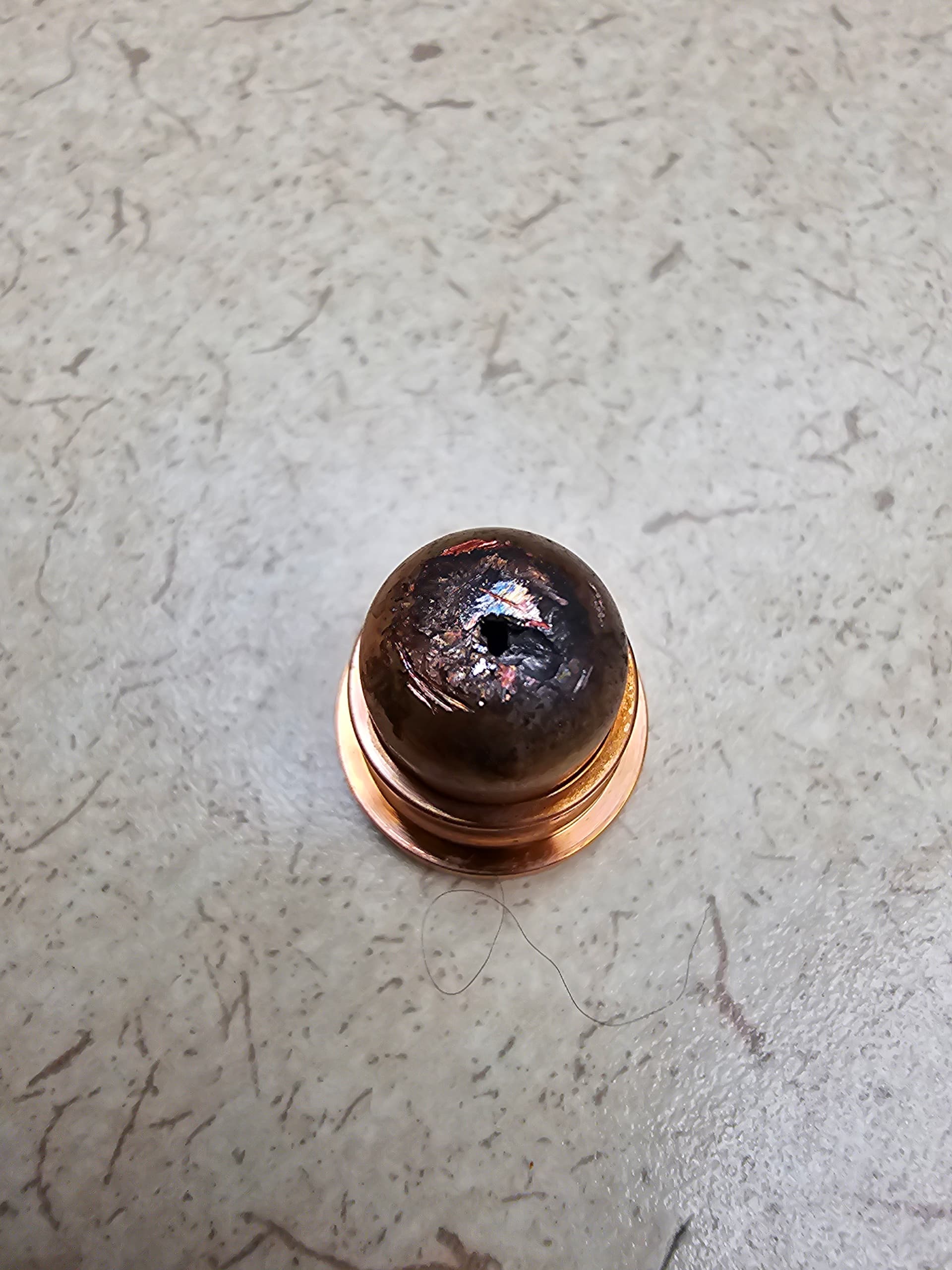

You can see it cut them terribly, tons of top dross and you can see the angularity. I would say by the time it got to the outside the nozzle was sufficiently messed up and was deflecting the arc even worse. Also he changed the speed I believe at some point.
And the nozzle probably dragged over the top dross.
I did mess with the speed. Started at 220, tried as low as 160.

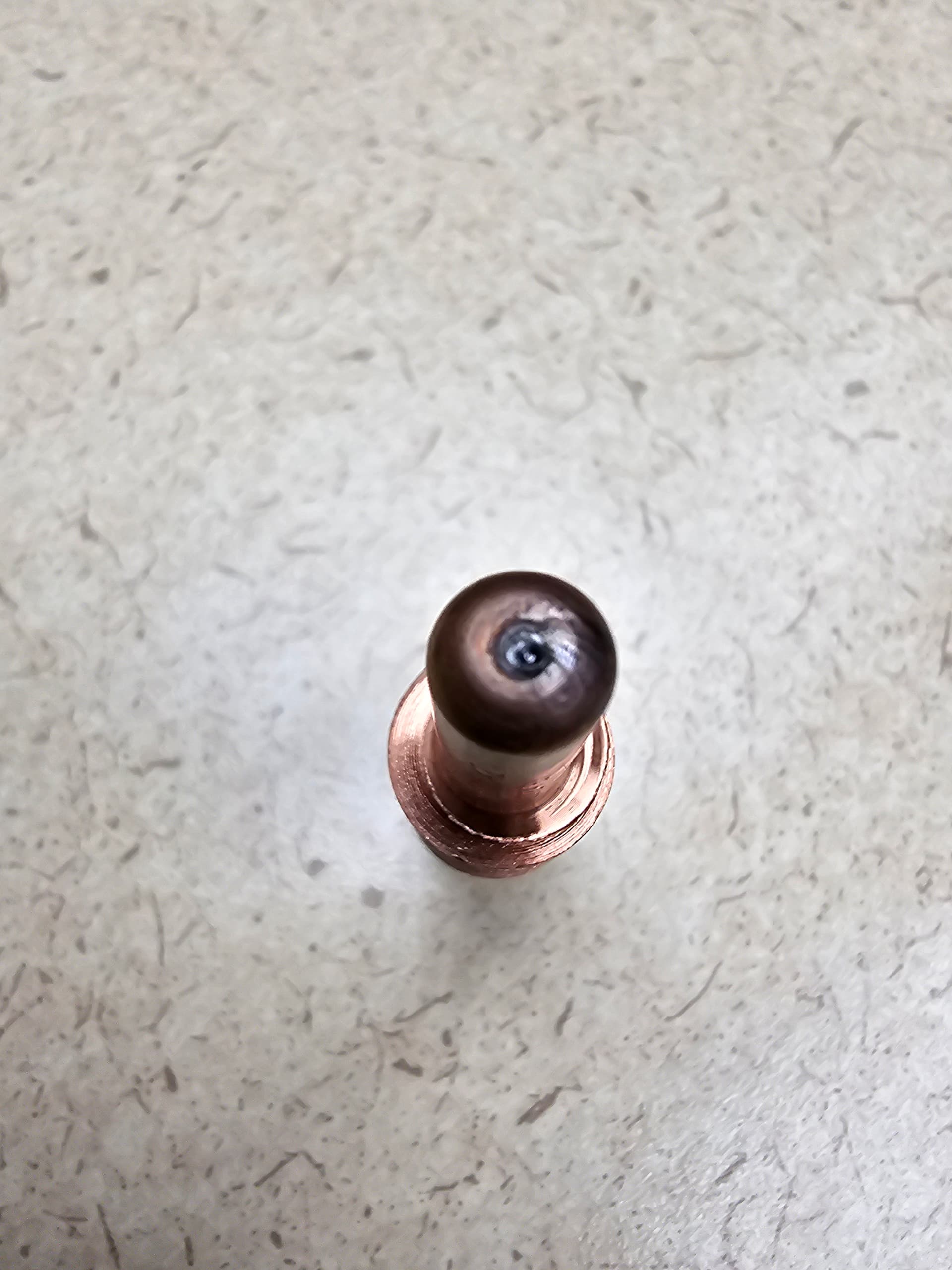

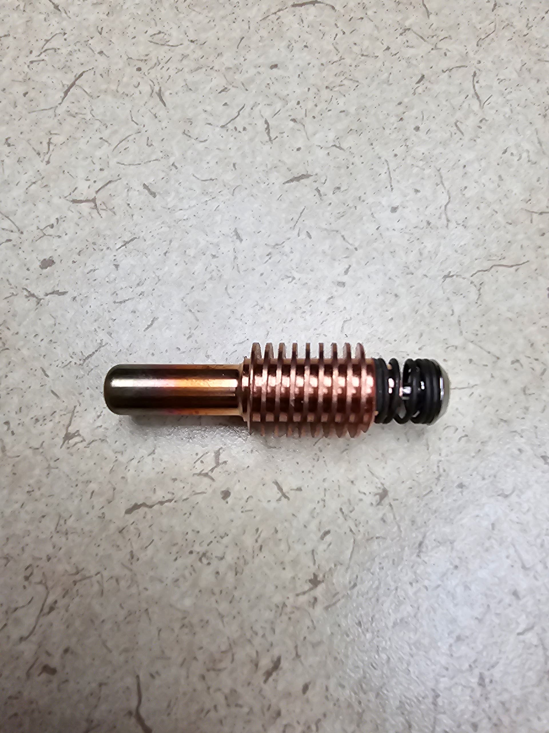

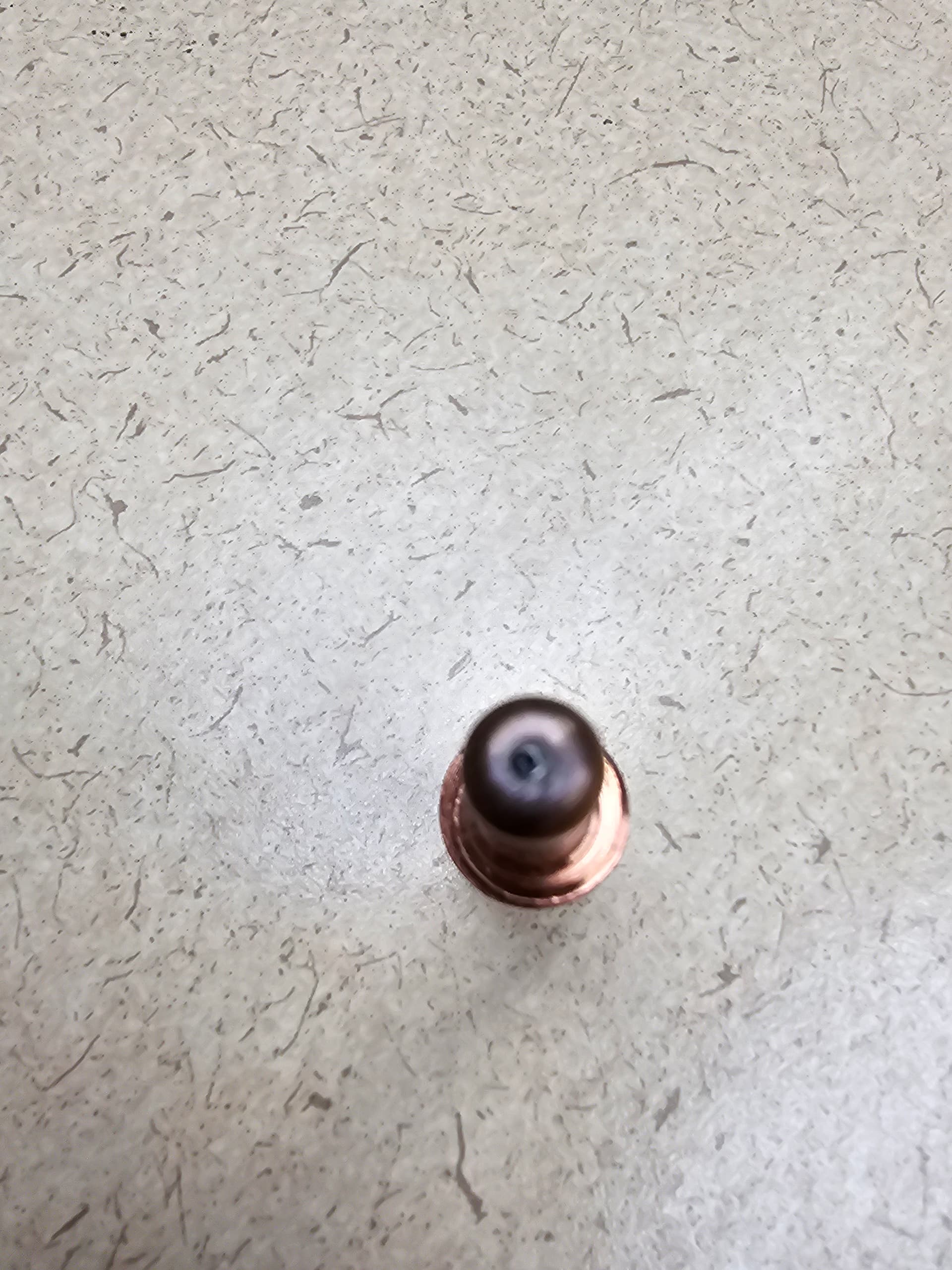

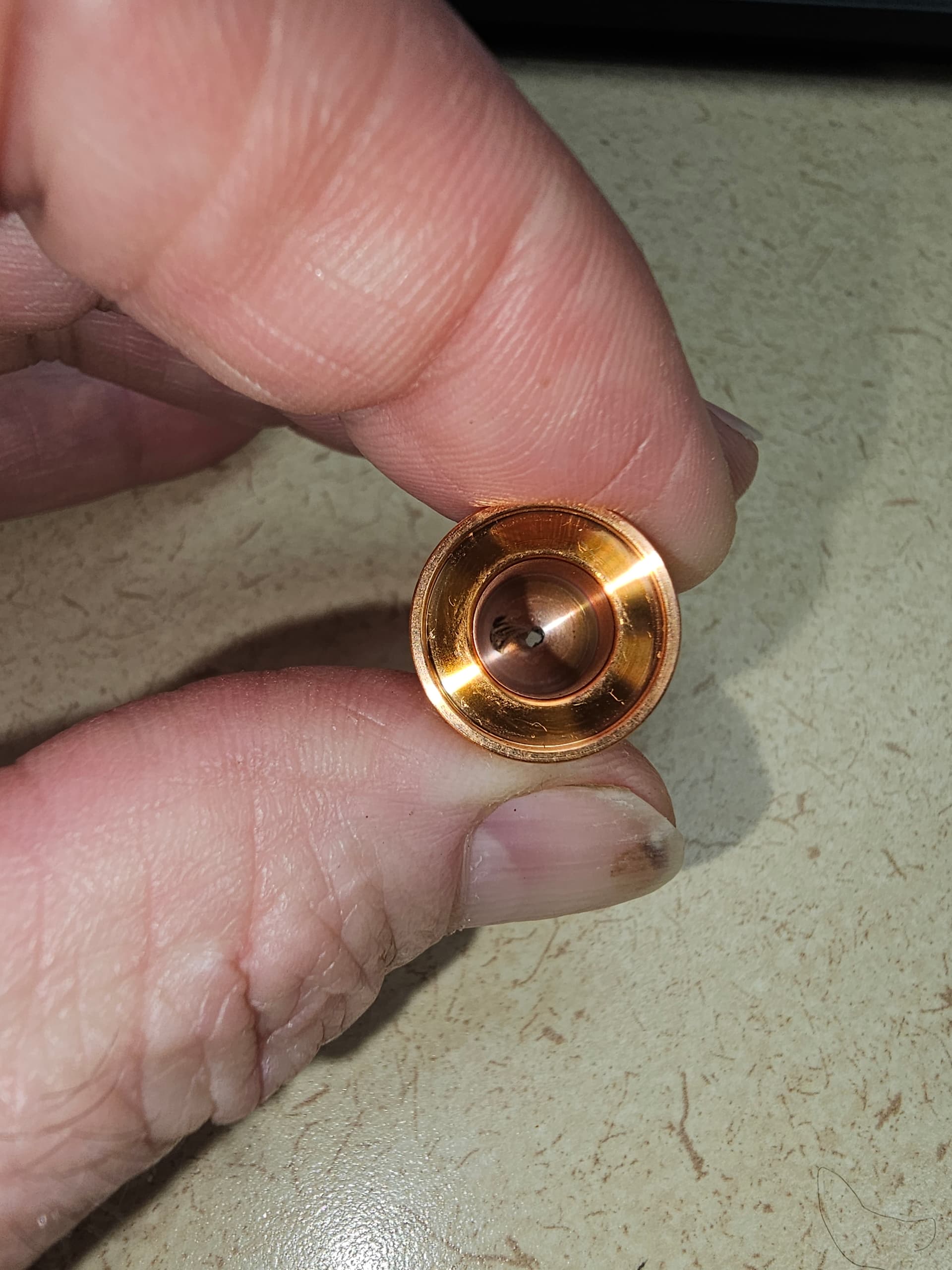

Brought the nozzle and electrode to the office, better lighting
Have we tried a test cut with a brand new electrode and a brand new nozzle. Making certain everything is seated correctly.
It looks like the hafnium is probably gone and it might have been arcing. Catastrophic failure at that point.
Would like to see a focused pic of the electrode end.
It’s really blurry in the above pic.

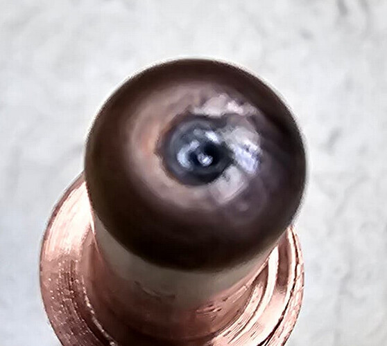

@Kwikfab

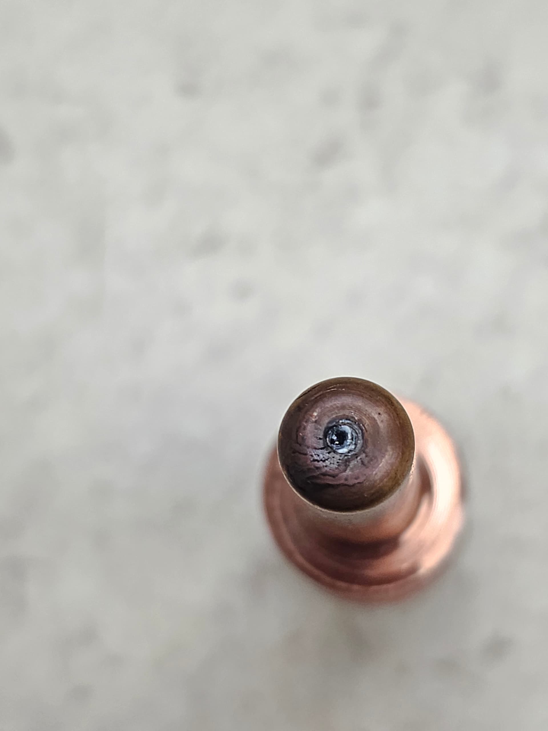

Better?

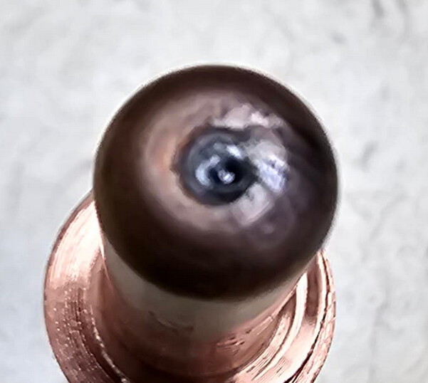

I have the same problem with my phone camera. We need to be able to clearly focus on the tip. This is still too blurry:
Notice the base is in focus but not the tip.

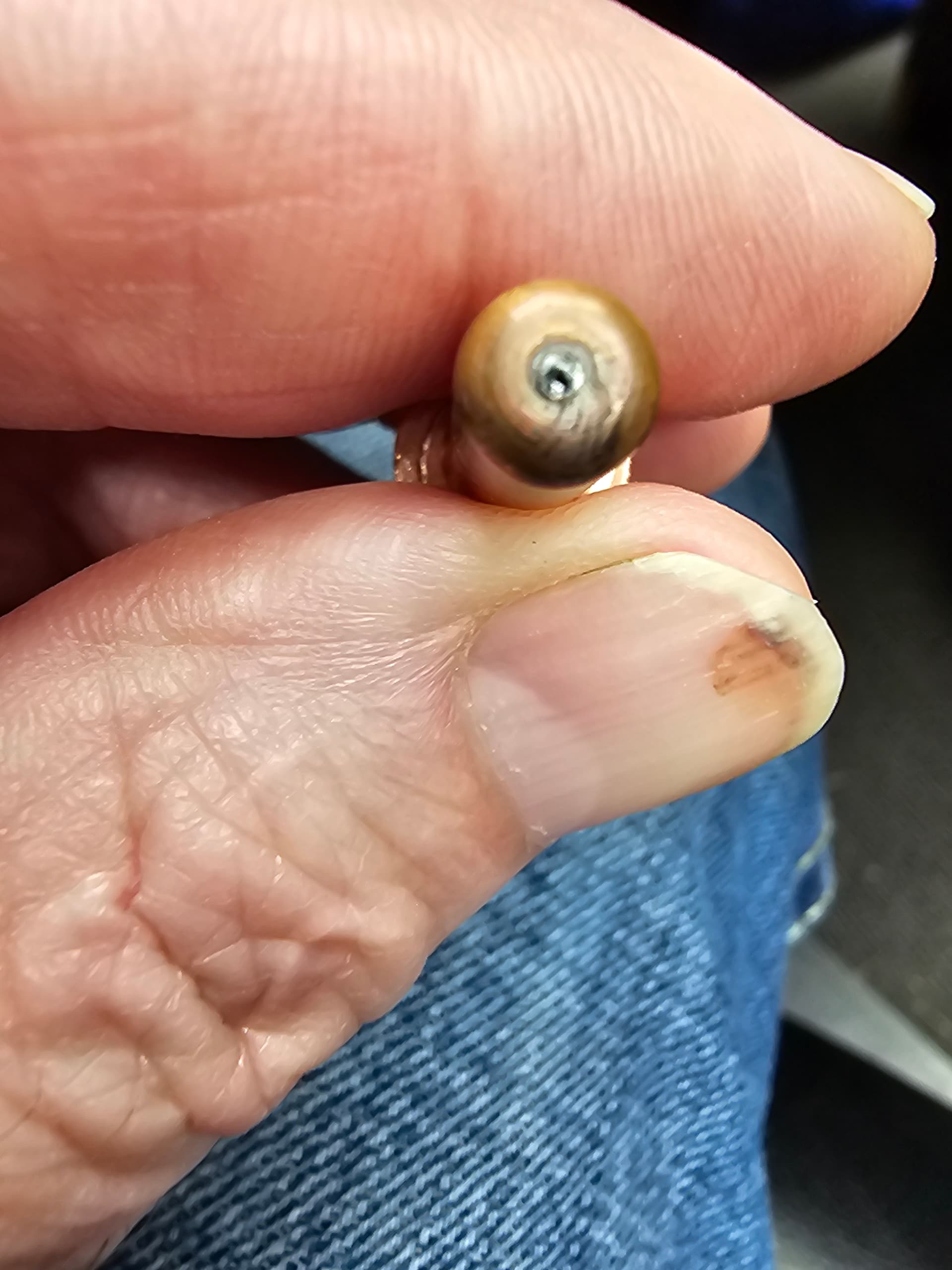

Another attempt
Got it
PERFECT picture. I think I can see the hafnium appears centered. My money is on crooked installation still. I’d send those to hypertherm though just to see what they say.
