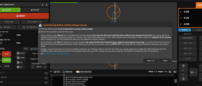

I have gotten a lot dialed in on small parts, 1/8 and 1/4" aluminum and A36 steel. Now getting ready to run larger parts and need to avoid losing material. If your cut starts on a hole, for example .5" hole and the cut starts in the center of the hole as lead in, if you have a problem then you can’t just start over as you can’t run a hole again as the nozzle just goes down inside it. I have been having repeated stalls after the first cut, with error message about the THC. I believe it may be bad connections on the divider plastic box, as I plug the plugs a bunch of times and get past the error. I observed the repeated error today, it will cut the first hole then stall on the second. The first hole shows about 127V and the second jumps to 300 where it stalls. Often I move to a new position to start over. No big deal on a small part. On a large 1/4" plate it will be a big hassle to lose a chunk of material and move over. What can I do to reduce waste on these stalls? I notice the option to generate gcode at the stall point so maybe this will one option. Other than that I can just go to sheetcam and remove the parts already cut and then pick up where I left off. Considering how many of these THC errors I am getting, I feel I need a plan to do large parts as these errors are an expected daily part of life. Any tips?

What, specifically, is the error that you are getting? Can you do a screenshot of it?
Your typical THC popup screen. It gives some basic explanations and causes of the problem and says if you keep getting 300V to call langmuir you may have a bad board. But mine is random. If you unplug your voltage divider box, try to cut, you get this error. Usually I can cut the first hole. But not the second. It is usually not something much later in the cut, usually it is the second hole after a successful first hole. I have seen it stop later in the cut on a rare occasion.

That is why I really want to see a screenshot of the error message to be sure of exactly what it is saying IS the problem and possible remedies. The fact that it is telling OP to contact Langmuir about the 300V at the THC is something different than the torch not firing.
If it was a lack of the torch firing I would expect the error “Torch moved before voltage sensed.” (or whatever the phrase is).

Toady now I cannot recreate the error. I pulled the THC board and plugged it in a few times. Also I don’t trust the divider box connectors at all, very cheap connectors. I will change them out soon. I can create the same error message by unplugging the divider box and trying to cut. However, with this method of simulating the same error message, the torch DOES fire THEN it throws the error. The error I have been getting since I got the machine on a regular basis is the SAME screen as you see here, but the torch does not fire before the error.
Here is what happens on the error:
  1. Start a cut that usually is a bunch of holes first
  2. First hole cuts fine.
  3. Move to next hole
  4. Lower nozzle to touch surface, does not fire torch.
  5. Error then pops up. Shows 300V for a second then goes to 0.
  6. My default Pierce delay is .6. Pierce height, .1181. Cut height .0591. All defaults in SC
