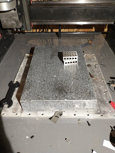

If you have a decent sized granite surface plate you can shim that parallel to the X and Y axis and then check tilt and nod before making any cuts. I then used it to check the rails and coplarity, etc. The one shown is 12"x18".

Is your surface plate surfaced on all 6 sides? I have a grade A 12x18x4 granite surface plate that looks similar, but it is not surfaced to have the top and bottom parallel (and sits on 3 feet).
The plate used was only surfaced on the top, I placed shims under the two back corners and front center. My plate is 3 inches, and does take a lot of height so I’m not sure if a 4" plate will leave enough room to swing an indicator.
How did you verify that you made the granite plate parallel to the mill’s plate? Did you sweep that with the indicator first?
I can see how 4" might be close – I may give it a try if I have time tonight.
Yes, with indicator attached to the spindle I ran back and forth in X and Y and shimmed as needed.
Ok so I took the spindle completely out of the equation today. I also took the Z/X carriage off the X rail completely. Drove around the Y with my 12x18 surface plate and shimmed it to within .001 over the entire surface (to learn I need to lap my dinner bowl of a surface plate some day).

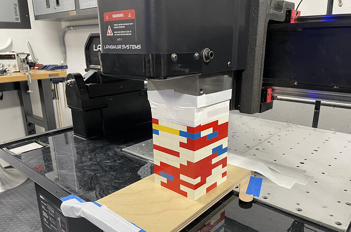

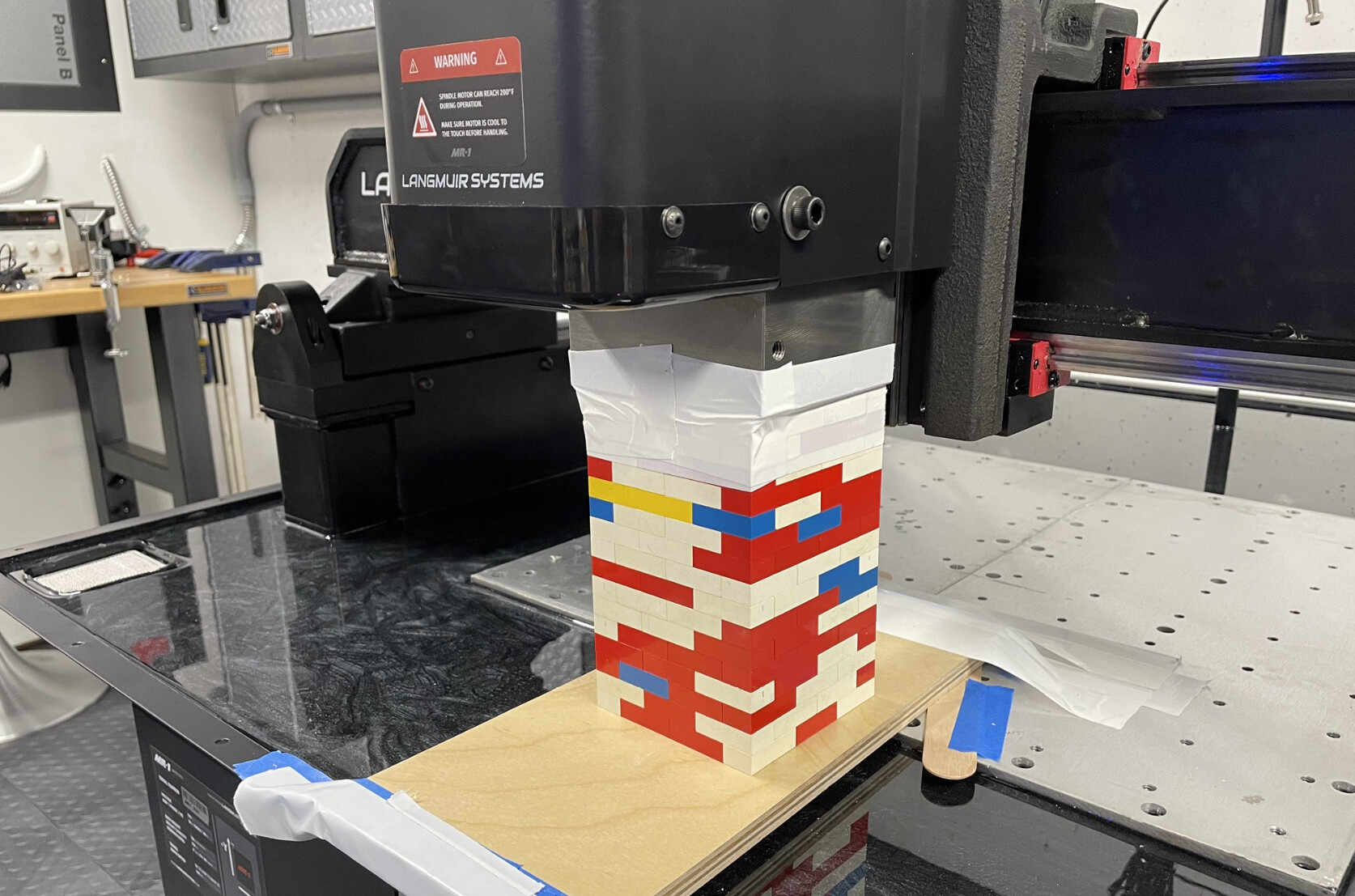

Here’s one more idea that helped me a lot. LOL. I took some old LEGO from my childhood and built a spindle stand/support. Sounds funny, but it helped so much! I was able to build it to the right height that I needed, shim it to align the mounting holes, and protect my fingers, epoxy, and the spindle.
If you build one, keep a notch on one side (not shown in the picture) so that you can slide it out and it will clear the spindle nut.
