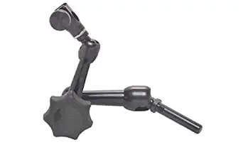

the edge tool makes it easier to read but considering this isnt an adjustment youll make more than a hand full of times youre better off buying a test indicator. which you can use for tramming vices, centering on holes. etc. First link is the indicator and then you dont absolutley need the spindle clamp but it makes tramming the spindle much easier as well as some other operations.
Amazon.com: Türlen Test Dial Indicator 7 Jewels High Precision 0.0005" 0-15-0 : Industrial & Scientific
Indicator Positioners & Holders - Indicator Holders & Bases - MSC Industrial Supply (mscdirect.com)

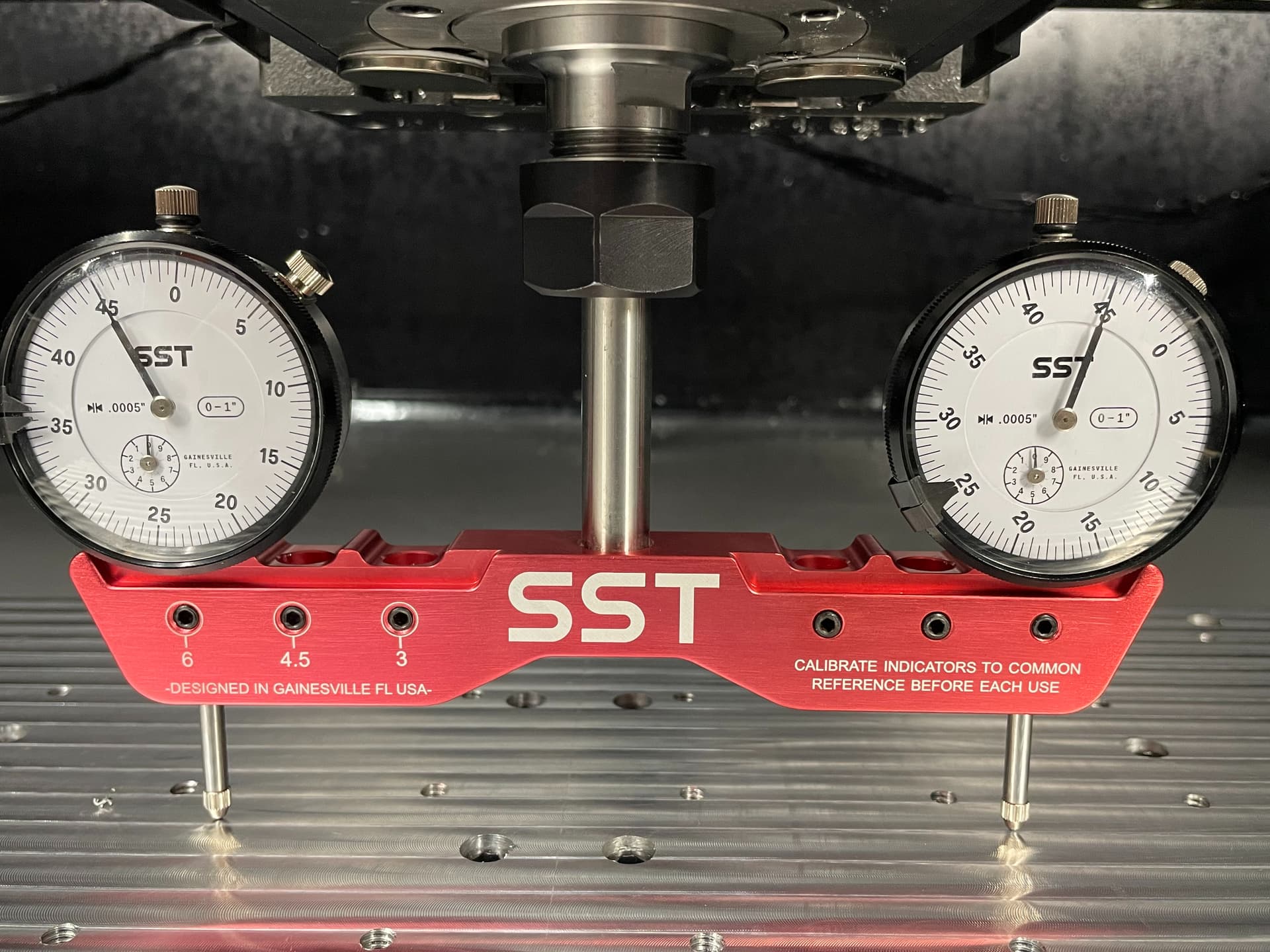

Had the Stupid Simple Tools unit that does over 4.5 inches for my old CNC router. Went with that one because .250 spindle/collet.
Said to hell with it and pulled the trigger on the 6 inch version which is supposedly .0005 capable.
Comes in tonight but extra shim stock doesnt come til this weekend.
Gonna push for Rick&Morty style true level.
Very nice. I have a .0005 DTI so I’ll order the holders, probably both syles are good to have. Thanks!

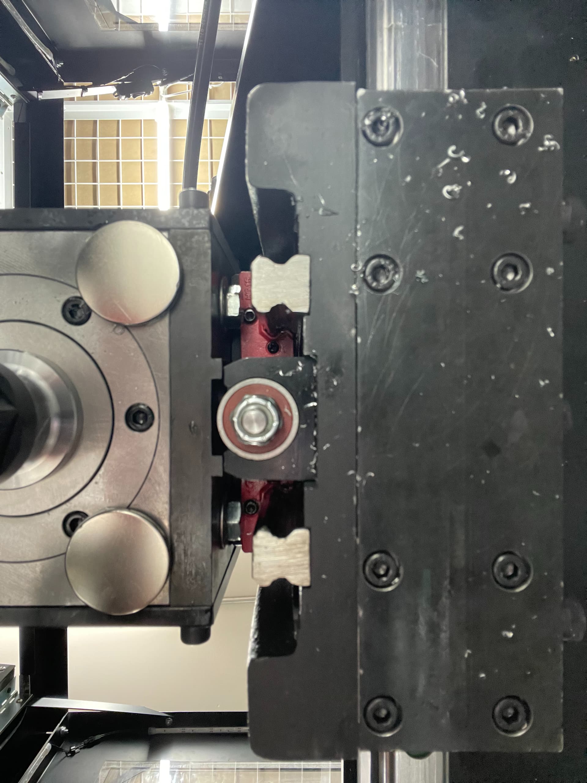

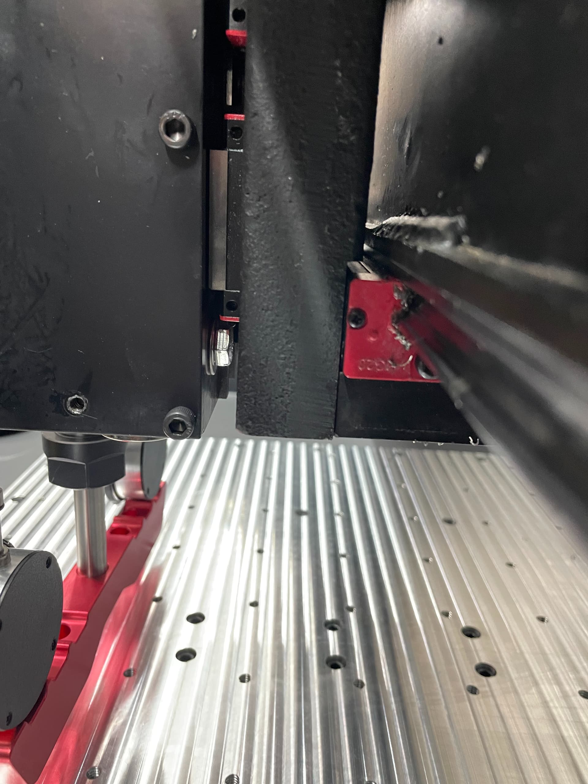

I’m starting the tramming process. Back to front I’m at .0007 which I’m fine with but on left to right I’m all out of whack as you can see in the picture. How do I go about fixing this? I haven’t seen LMS release a video on this yet so asking you guys that have been thorugh this.
Loosen the bolts that secure the spindle housing and manually adjust the spindle alignment so the tram is as close as possible. Then retighten the bolts.

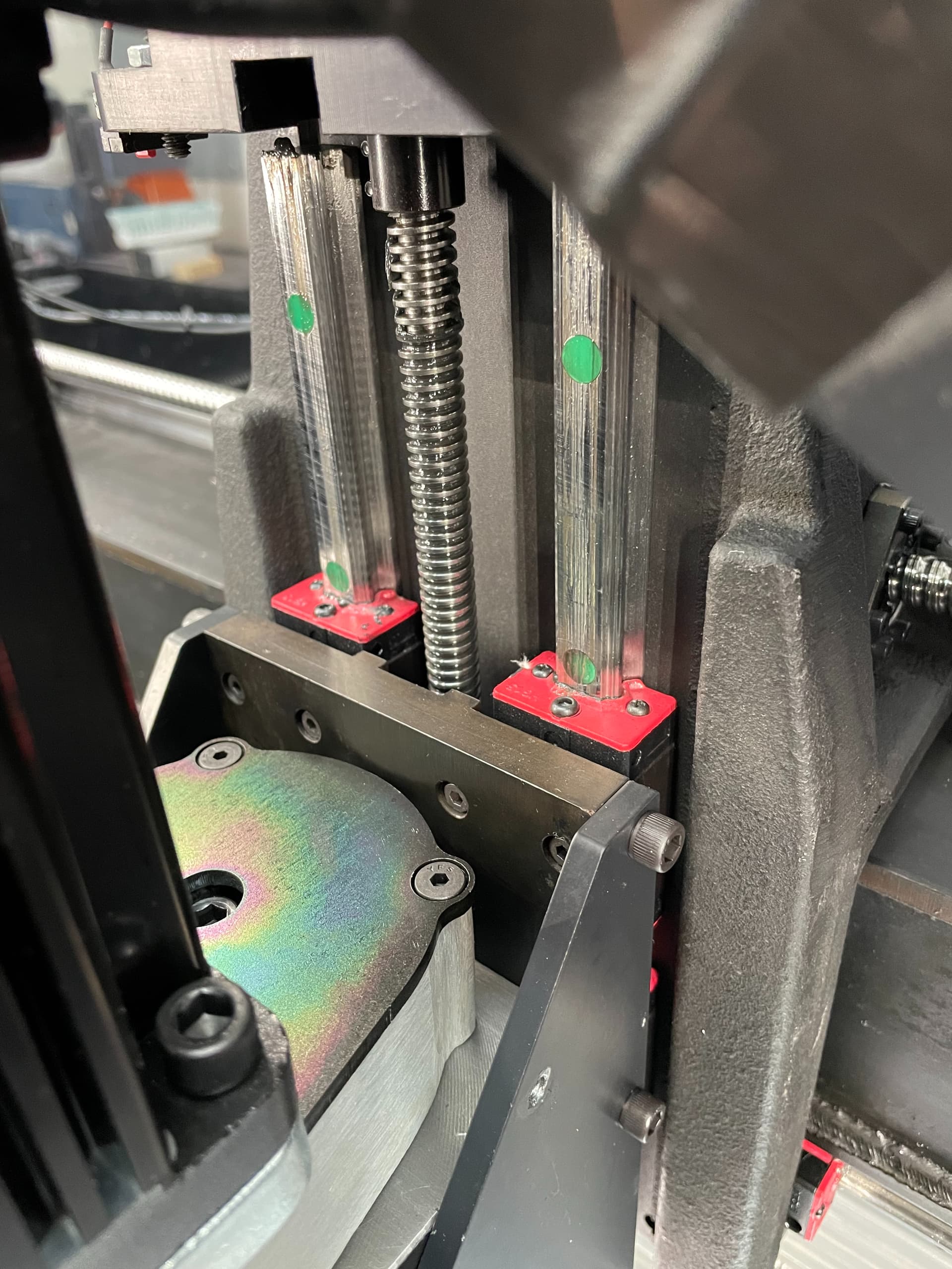

The assembly guide left me with the impression that the only option was to re-shim the X-axis linear rail blocks. It would be greatly appreciated if there was A) STEP files of the spindle assembly and B) mention of the proper way to tram along the X-axis in the assembly guide.
Adjusting the tram in the x direction with the spindle bolts is tricky to say the least. If you’re hoping to really dial it in; you’re best bet is to follow suit of another user here and drill and tap a couple set screws in the side plates of the spindle mount to make fine adjustments with. I tried the “loosen and tap” method and that process was quickly a no-go here.
This sounds like a great idea. Maybe even something LS should consider.

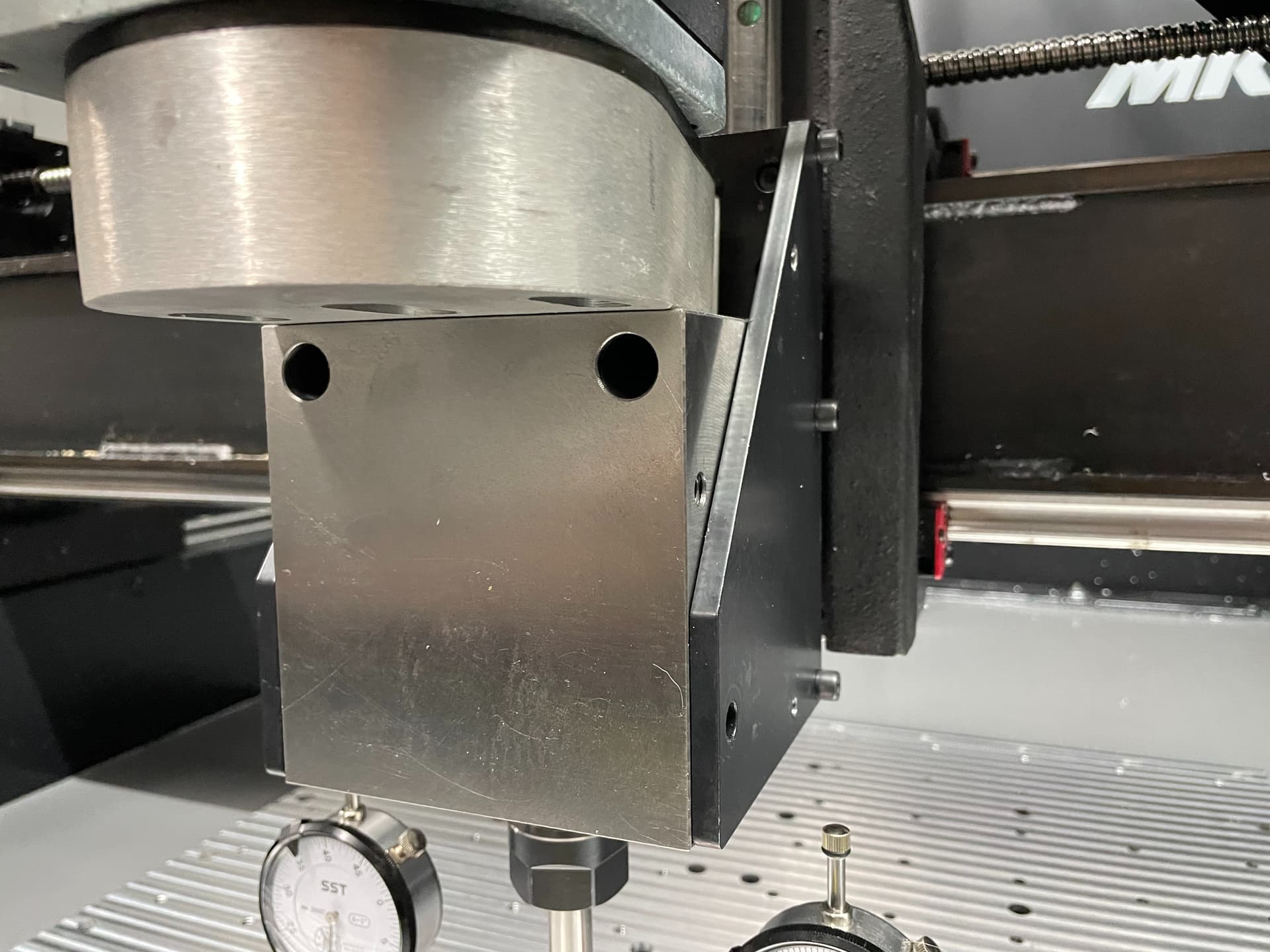

Which bolts are the ones that need ot be loosened?
There’s four bolts that secure the spindle housing. Two hex bolts at the bottom (accessed from the back), and two socket heads accessed from the top front.
@langmuir-daniel - I think I’m going blind, what bolts am I looking for?
Those two hex bolts in the picture.
And the two allen head bolts in front bottom.
They are recessed into the spindle housing.
Thanks @Bigdaddy2166! Any tips on getting it leveled? Some people were saying it’s a PIA.
Loosen 3 of them and tap on the housing ever so lightly with a plastic mallet. If I remember your only out like. 005.

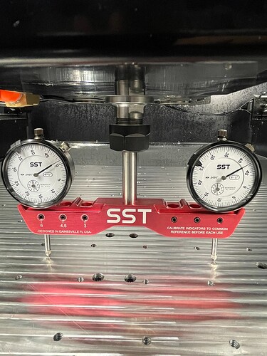

I think I got lucky and took all of 5 minutes to get left/right dialed in. SST tool made this super simple. I can see where the set screw mod will be helpful and will end up doing that at some point for fine adjustment in the future.
