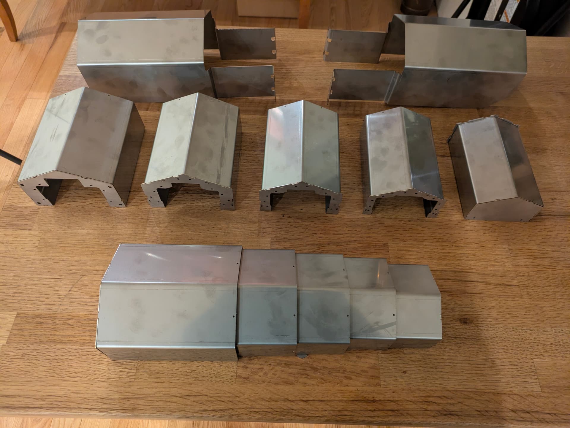

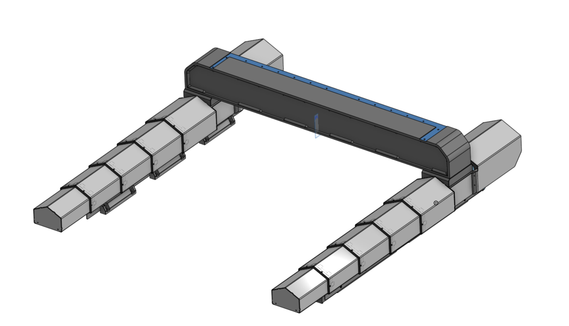

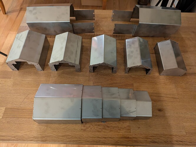

Armored rail and ballscrew covers are happening.
