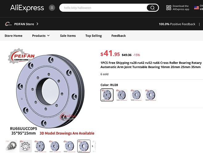

Are the raceways aluminum? I assumed they are, and guessed that they would wear out very quickly as a result.
It looks the same as the lazy Susan I found on Ali Express.
https://www.aliexpress.us/item/2251832649875705.html?spm=a2g0o.detail.0.0.707diR7SiR7SgQ&gps-id=pcDetailTopMoreOtherSeller&scm=1007.40050.362094.0&scm_id=1007.40050.362094.0&scm-url=1007.40050.362094.0&pvid=8f02b2ba-4dc1-4f3a-be5e-8005959bae42&_t=gps-id:pcDetailTopMoreOtherSeller,scm-url:1007.40050.362094.0,pvid:8f02b2ba-4dc1-4f3a-be5e-8005959bae42,tpp_buckets:668%232846%238116%232002&pdp_npi=4%40dis!USD!15.00!12.0!!!15.00!!%402101c59516978609381146887e187e!65083489458!rec!US!!AB
I’ve seen a lot of cross roller bearing turntables for under $500. What size do you need?
55 mm through hole ID or larger, ideally <100 mm OD

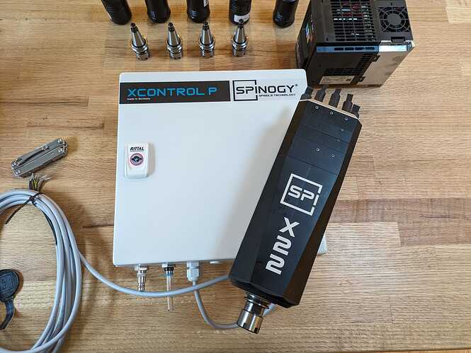

Upgrading to a 4-pole Spinogy X22 spindle. The new unit is ATC capable, uses ISO20 tool holders, but that’s only the start of it.

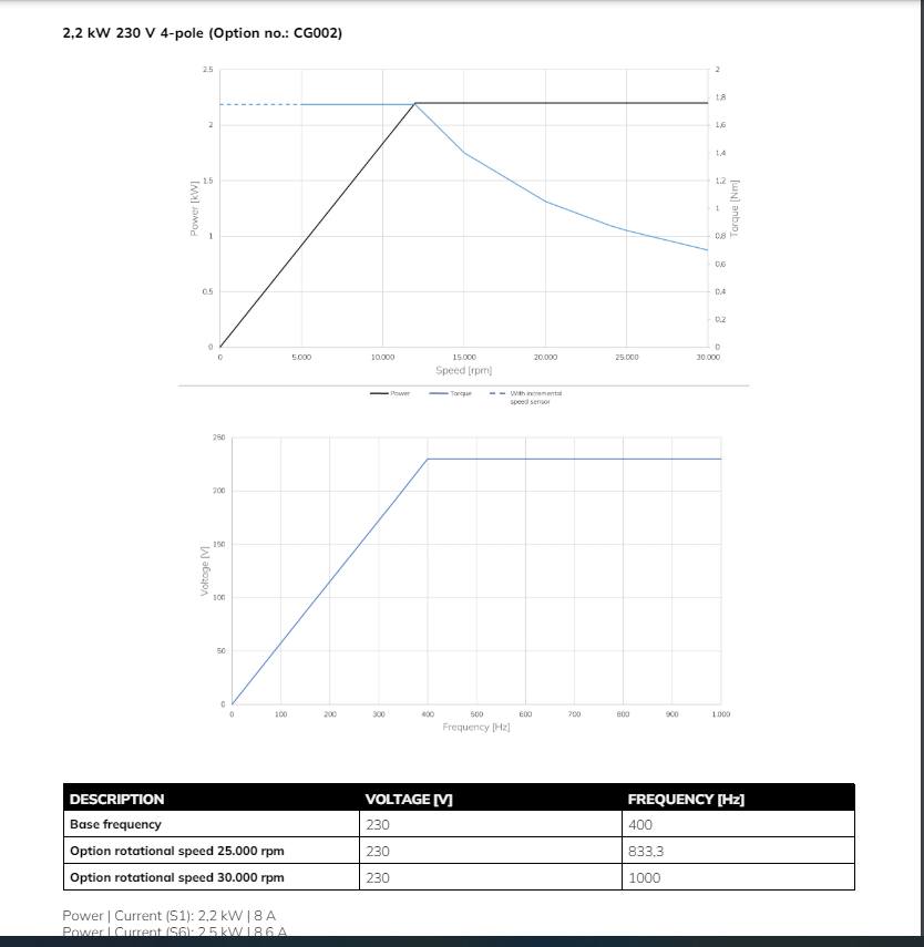

The X22 spindle will take the whole machine in a much more ā€œDatron-likeā€ direction. It’s a bit more expensive than the CNCDepot options (by about $2k, not including the accessory stuff like water cooling hardware), but it can run at 30,000 RPM and still push about 2.5 HP at peak RPM, by running at 1000hz. I really like how small the ISO20 tool holders are. I’ll be able to fit at least 10 of them in a wine rack style ATC magazine.
The other advantage of the X22 is the weight - only 10lbs. This shaves off about 25lbs from the X gantry assembly, which will make a huge difference in how nimble my machine can be. I’m considering adding some of this weight back in as damping ballast inside the X gantry beam. TBD after vibration evaluation once it’s installed.
The Spinogy X22 spindle has somewhat lower horsepower than the Langmuir spindle, but it still delivers about 2.5HP alongside the much faster speed.

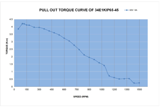

Now, I’m not absolutely certain that the drive motors NEED an upgrade in order to push much faster feeds, but I am certain that I want closed-loop control on my drive motors to help protect the expensive spindle. I know that even closed loop steppers won’t save the spindle bearings if I crash it at full speed, but it might at least help for lower speed scenarios.
I did some price evaluation on Clearpath servos and found them simply too expensive for what you get. A full Clearpath system would cost upwards of $2.5k, and I think I can get most of the benefit from closed loop steppers. So long as they are sufficiently oversized in terms of dynamic torque and closed-loop, the only major remaining disadvantage is stepper vibration. I don’t think much of the idea of precision encoder feedback on the motor end - given that we don’t have proper backlash prevention in the ballscrew, precision feedback from the motor is rather pointless. Langmuir’s philosophy seems to be that as long as the motor is beefy enough it should hold position, and I largely agree with that.
Obviously steppers aren’t great for high RPMs since they lose significant torque, but I think I can also account for that by increasing the frame size.
NEMA 34 steppers are also a bit of a balancing act - you don’t want to go TOO big, because then the inductance gets way too high, and that’s bad for fast moves as well.
By combining the big bertha steppers with a 25 lb weight reduction on the gantry, I’m expecting to be able to push at least 500 IPM on rapids.

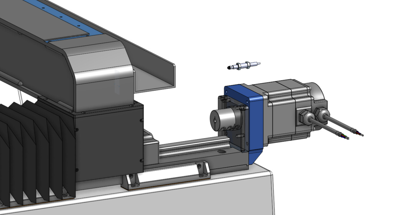

  • Need new Y rail mounts. Still need to figure out how the new Y mounts interact with the new way covers and the precision limit switches.
  • New couplers due to the annoyingly large output shafts. I’m planning to turn some new 14mm-6.35mm couplers out of 12L14 hex bar next weekend.

I would also expect to upgrade to a 48v PSU for the steppers (or maybe even two of them since you are going with large motors). You could even consider 60V. I switched to a 48v/12A PSU and this enabled the fast rapids that I’m getting (300ipm reliably with stock steppers, you’ll be pushing it even faster).

Thx for the interest! Unfortunately I’ve been a bit occupied with other projects and work, and I need to fabricate a few components to get off the ground. Especially new motor couplers and the spindle mount.
That said I finished up design for those new components this weekend, so now I just need to find some time to actually machine them.
